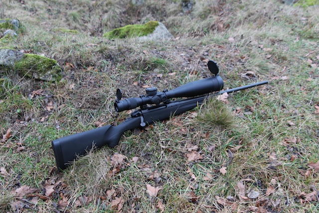

The USO 5-25x58 is such a large scope with a super rugged look to it, so we subconsciously expect something extraordinary… and you get a well performing rifle scope. In ur opinion it is a heavy duty scope, with everything packed with it (ARD, sunshade and flip-up) that does not disappoint optically. But it is not as extraordinary like we had hoped. Unrealistic? Yes, probably…
One regret we had was that we should have chosen another gun for this giant. It looked and felt a little out of place on the Remington (see pic) and it is of course something that affected our impression despite our best effort to just evaluate the optic.

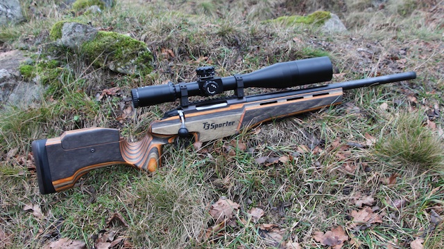

The Tikka T3 Sporter was hard to part with :-( It has a 20" barrel and shoots like a dream. Favorite setup was with Hensoldt "Hubble" Awsome setup and not too bulky and heavy, just a very good match in handling and balance. We will long for this rig when behind our own guns and scopes for sure ;-))

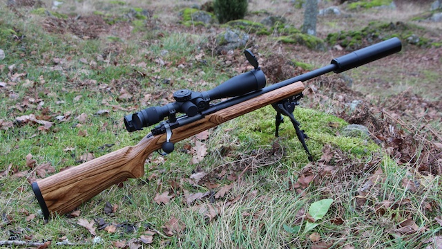

Nightforce 8-32x 56 MLR SFP
Nightforce is known to us for its ruggedness and overbuilt construction. We saw exactly that, a solid reassuring construction with aggressive turrets for good grip in wet and cold conditions. The design signaled ”tactical use” and it had our attention. Although we also had our doubts, good glass usually costs a lot of money and the Nightforce cost less than the ”super glass” from Germany and Japan… What could we expect, and how would it handle the competition? Placed on a Customized Tikka 6,5x55 we set out to find out…
As mentioned the turrets are well made and very sturdy, we got an excellent grip with or without gloves, which were a benefit to us especially at the end of the day when fatigue starts to set in and slippery turrets causes you to miss clicks and get lost. It was simply easy to count clicks without having to grip very hard on the turret, less tension equals more precision and speedy adjustment with less error! Elevation and wind adjustment are generous especially for a 30 mm tube. Clicks were good, easy to hear and feel, although we were spoiled by March and we would like it to have slightly more distinct ”click” if anything… .1 mil increments is a good ”practical” standard even on higher magnification, which we appreciated after the March 5-40´s .05 knob spinning.
