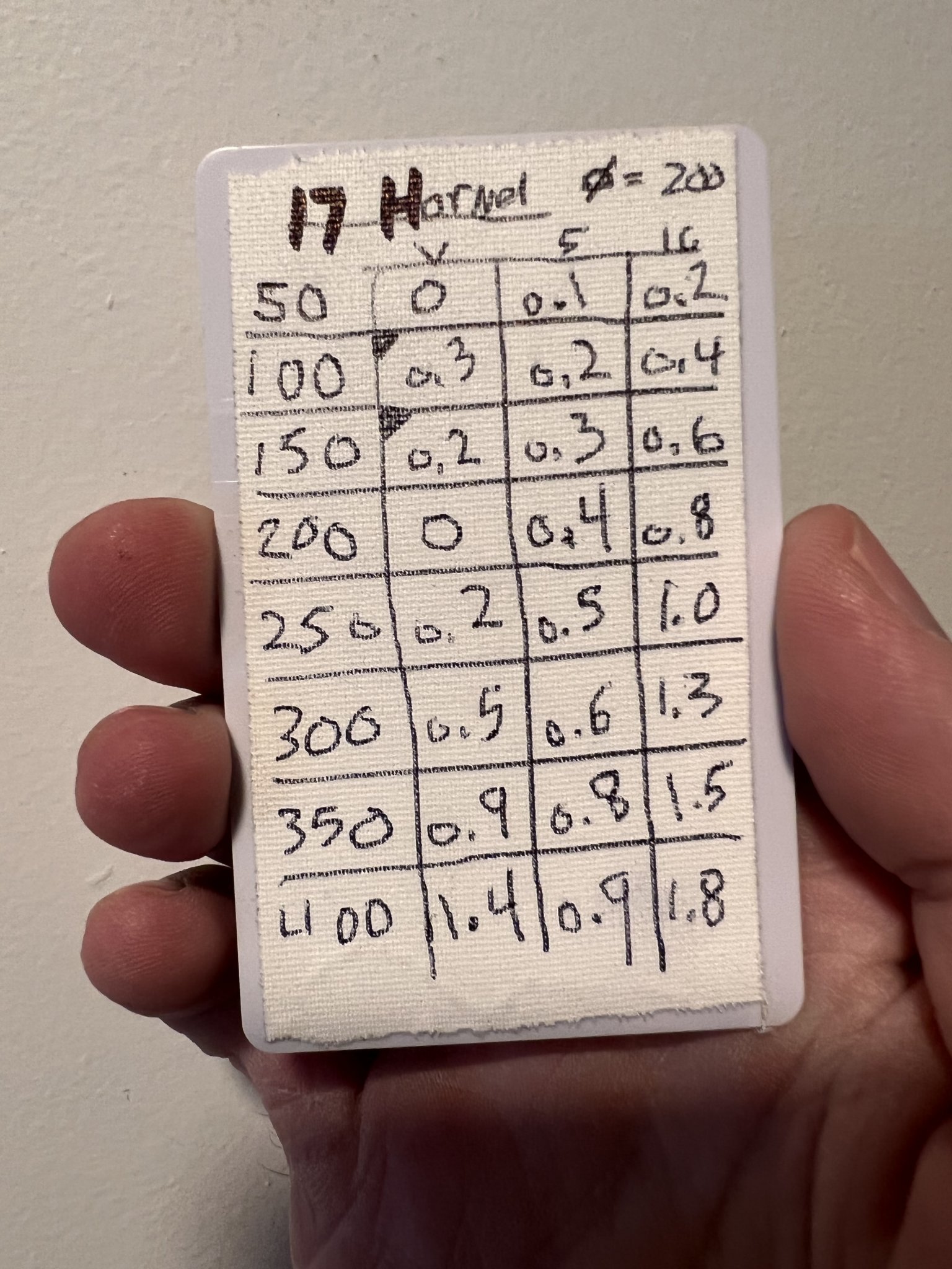

Hi everyone. I shoot prairie dogs from a swivel bench or a tripod out to 600 yds. I am thinking of upping my game and want to know other people’s ideas and workflow, especially during UKD hunting.
My goals here are to increase my first round hit % and to minimize physically writing out dope cards for 3-5 rifles.
Currently we use two LRF binos (a Fury 5000 and Leica 15x Geovid-R) with the 15x replacing the spotting scope and the shooter uses the Fury. My iPhone 13 Pro Max (with Strelok on it) is used for filming the hits on a spotting scope that’s co-witnessed with the spotter’s LRF binos.
For dope display I use a Cole Tac Cheat Sheet strapped on my scope. StrelokPro generates that dope for factory Hornady ammo in 204, 17 Hornet, 22 Hornet, and for rimfire I use CCI 22 LR segmented subsonic.
I really don’t like handwriting extensive dope for 3-5 rifles onto those small (but excellent!) Cole Tac dope cards. See below:
Yes, 350/400yds for 17 Hornet is optimistic. I know.
My research has pointed me towards these general directions below. Keep in mind the spotter will remain using the Leica 15x LRFs and the following describes the shooter’s gear:
  1. The Full Monty: Kestrel 5700x on a tripod with the wind vane, LRF binos (Fury 5000 AB, Sig 10k, or Leica 3200 Pros) linked to the Kestrel, firing solution displayed on a Kestrel HUD mounted on the rifle. Or maybe some binos will display the Kestrelized solution within their display? Then I could skip the HUD.
  2. The Pretty Good: I estimate the wind, inputting that into a new Fury 5000 AB which shows me the firing solution. Or maybe I get the Sig or Leica.
  3. The Cheap-ish No Writing A: I buy an E-Dope display and stick that on the Cole Tac. I believe one can have multiple cards in an app to pass to the unit.
  4. The Cheap-ish No Writing B: buy a cheap wind meter and pair it with Strelok and use its HUD (a feature I recently discovered)
  5. The Dirt-Cheap No Writing: I don’t buy anything except clear badge holders that I affix to the Cole Tac. I print out dope either before the trip (estimating temp etc) or haul a portable printer out to the motel and print there. I drop the dope into the badge holder and done.

That's where a printing solution comes in. To print dope that will stay on the gun's cheat sheet, I am looking at tiny travel photo printers like the Fuji Instax, Canon SELPHY and the like. Some of the prints are even waterproof (supposedly).
Btw, as I am not a competitor nor a military guy, I have never used a range card like you displayed. I like that. Where I shoot is pretty darn featureless, but we identify certain PD mounds and fenceposts (and argue a lot! Like, "No, the mini-cactus patch that looks like lettuce to the left of the big brown volcano-like mound, three fence-posts from the double post!"). Groan.

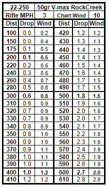

The gun MPH method for wind can greatly cut down on number of columns and simplifies doing wind values that fit into brackets in your head.
Obviously a measured and calculated wind hold from a meter right NOW is going to be best.

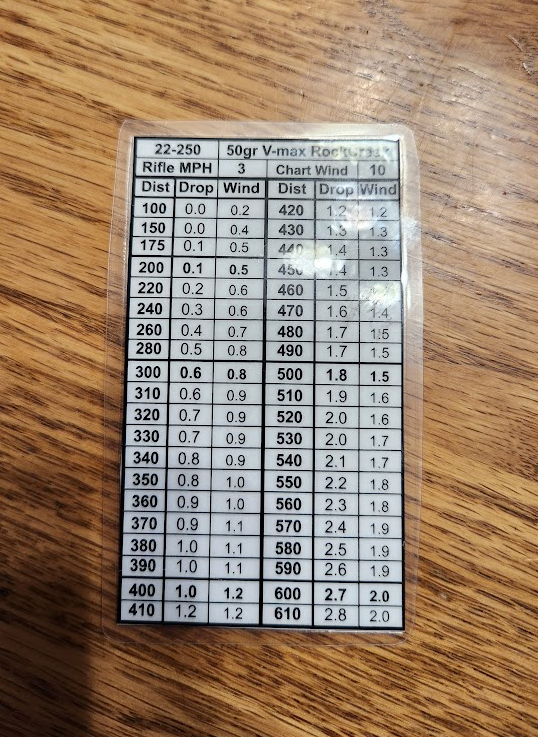

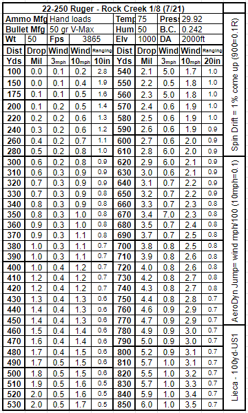

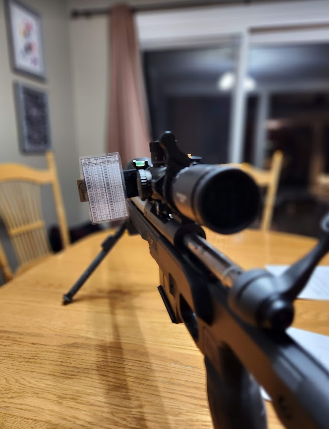

The Ballistic Display: - Printed Dope Cards on the bench or Cheat Sheet.

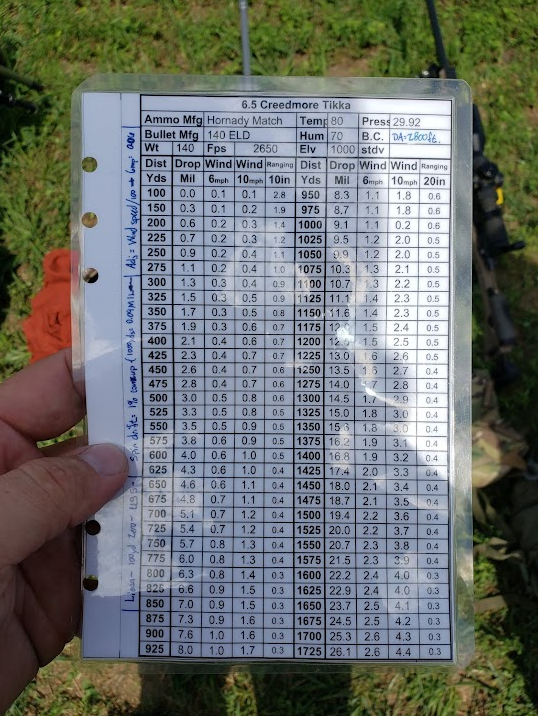

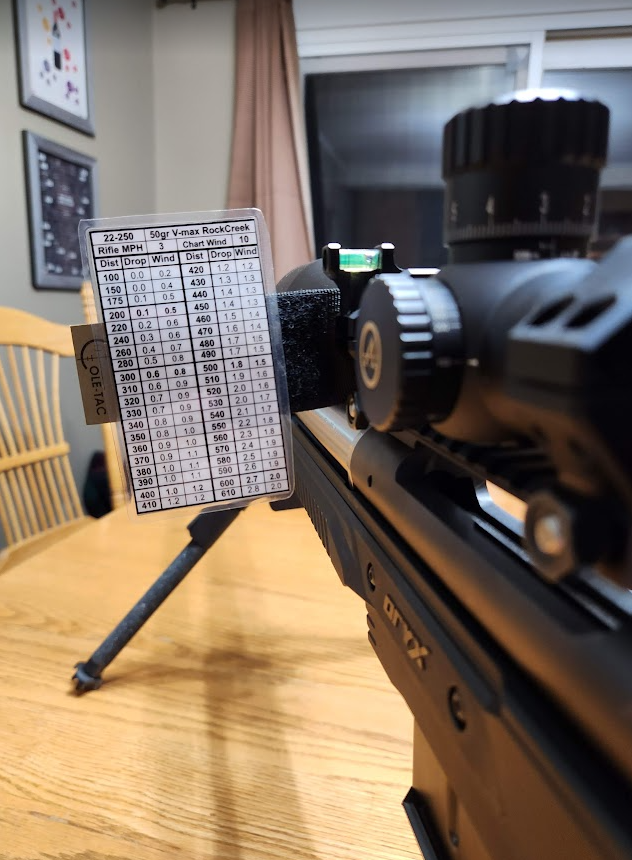

I really enjoy the coletac Cheat sheet. I use printed ballistic cards, laminate them in packaging tape and stick a piece of Velcro on the back to mount them. I don't use thier plastic board, I print my own. Here is a Screen shot of what the card looks like. Its the same size as a business card. I can try to get a real picture of this on the rifle tonight.
Or I place my full ballistic table on the edge of the bench and use a binder clip to hold it on. (because its windy) This is half of a piece of paper (5.5 wide x 8.5 tall) Its also laminated to it won't blow the paper around.
Ballistic Solutions
For most p-dog shooting rifles, I have have found, that with in thier effective range the changing environmentals do not have enough effect to change the Dope. (204 out to 3-400yds, 22-250 out to 4-500 yds, 6.5 creed out to 600yds) At these ranges going from 50 degF to 90 degF will change your drop solution about 1/10th of a mil. If I write my data cards out for the middle of this range (70ish degrees) then the change is only half of a tenth. Inside thier effective distances I am not worried about temp, pressure, hum, elevation. Out to these distances I use what is on the printed dope card and don't worry about the minutia. If I push past those distances I might start referencing a ballistic program. Its usually on my phone but lately have done more with the Fury 5000 ABs and its has been very effective.
Aero Dynamic Jump - Yes this can effect you ballistic solution, and the smaller bullet you go to the worse it can get. 223 or larger I will add or subtract 1/10th for each 10mph cross wind. For smaller than 223 I will add or subtract 1/10th for each 5mph. This is something I do manually to avoid having to run a ballistic program on the bench. P-dog shooting can be very windy, but I rarely find myself adding or subtracting more than 2/10ths, and that is 2.75 inches at 400 yards so I like to hold top or bottom of Dog to account for it when needed.
Ballistic Tip - Dope your rifle to distance. Don't just trust a ballistic calculator. Take the time to shoot your rifle to distance and know what the bullet will drop. no guessing here. Then true the ballistic program to what your rifle and your ammo do. check out Weapoized Math to do this efficiently.

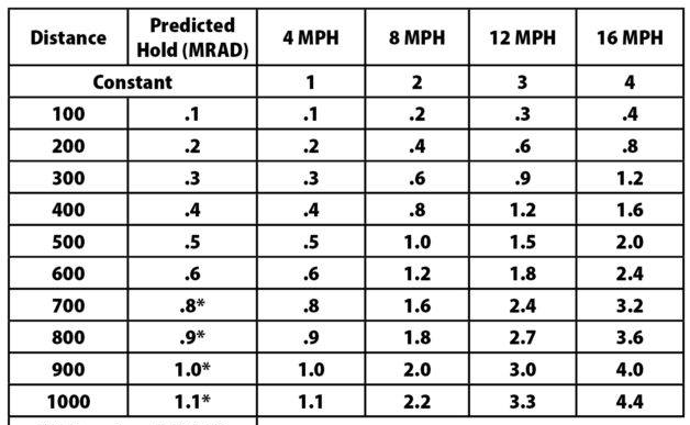

I think there are 2 easy ways to get a wind solutions here (Holds).

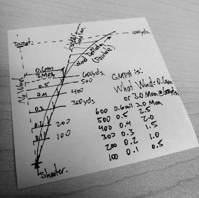

1. Learn the Gun Mile per hour system. Its by far the fastest and easiest way to dope your rifle. This system is difficult to understand and grasp the first time but once you get it, its really easy. You can see in the ballistic charts above I don't have a lot of wind information because I use the Gun MPH system. You have already posted the best sources of information for it. Message me if you have questions.
Here is a graphic "Jist" of it.
2. Large printed wind dope sheets. Just make one sheet and laminate it for each rifle, you could also clip this sheet to your bench or incorporate it into your large format data sheet. Something like this.
For either of these 2 solutions above you will need to use a wind rose to turn the raw wind speed and direction into a cross wind speed. The modern wind rose it the best thing for this. Read this article to understand what this is and how to use it.

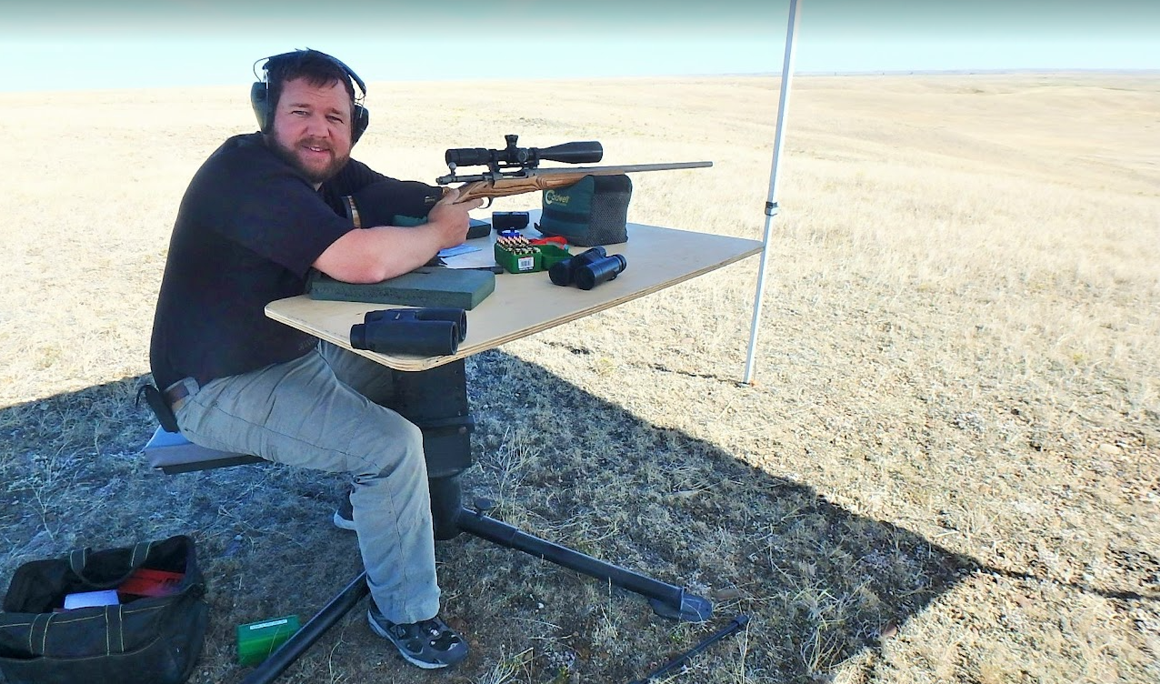

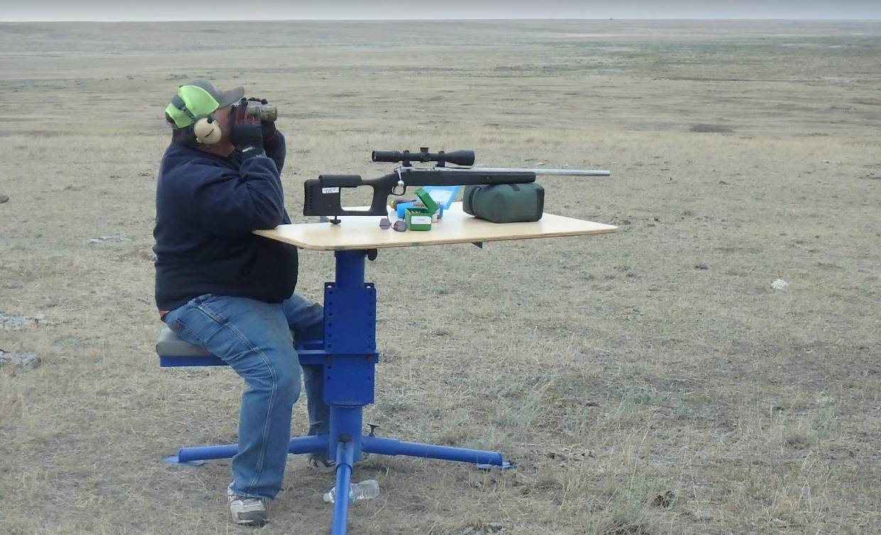

Out typical setup

This makes me excited for hunting next year’s Pdogs! And it’s always nice to find people that don’t just hunt steel or larger game (or other) animals. Pdogs for the win(d)!
@Jack Master are those home made swivel tables? Pretty cool.

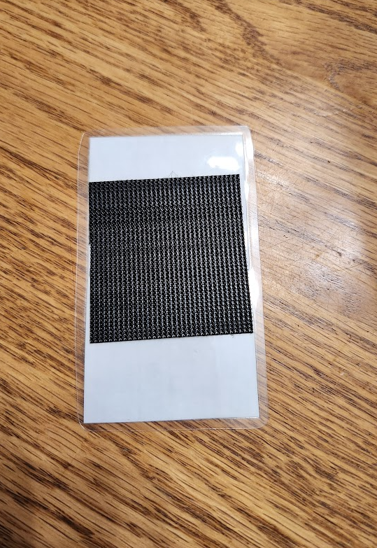

And what sort of Velcro are you using on the back of those small laminated cards? There seems to be a zillion different types. Maybe it doesn’t matter but it’s gotta stick well to plasticy stuff.
Yes. My neighbor and I built custon swivel benches.
2"wide self adhesive velcro. Got it Menard I think. Nothing special about it.
