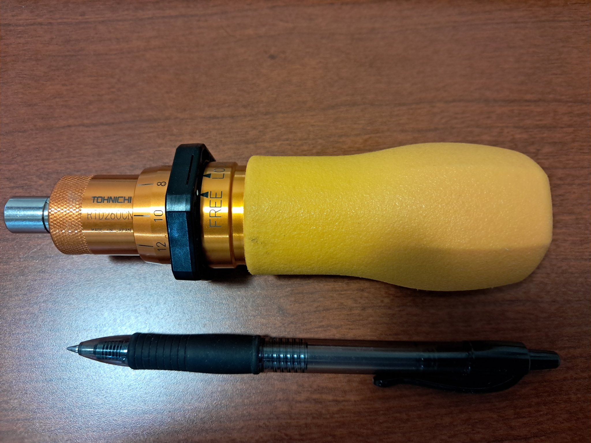

This is a Tohnichi RTD series torque driver. Superior to fixit sticks and chinesium garbage like the Wheeler wrench. If this doesn't fit in your range bag, then you have too much useless shit in your range bag.

What's the max setting on that unit? (my google fu is weak right now)
I still like my fixit sticks but that looks far superior to the fat wrench I have in my tool box
Most appropriate tohnichi drivers for gun work are probably the 6-22 lb-in or 10-40 lb-in LTD or RTD series for the low end and the 20-90 lb-in LTD series for the high end. Those two will cover pretty much the entire range of scope mount and action screw torque.
The RTD is a slip through clutch style and the most fool proof, while the LTD can be tightened past the set torque if you don't feel the set point being reached, but unfortunately the highest capacity slip through RTD series only goes up to 40 lb-in.
A mountz fga80 driver will cover 8-80 lb-in (at the expense of a little less accuracy & repeatability than the tohnichi drivers) so a single driver will work for pretty much every fastener torque on a gun. It's also a slip through clutch style so it's pretty much foolproof. However it's much more expensive and needs a battery, but the single mountz fga80 is about the same price as 2 tohnichi drivers.
Snap On also sells a 4-80 lb-in digital torque screwdriver but it's even more expensive than the mountz, however it offers a little better accuracy and repeatability and can also do angle and torque+angle if needed. It is not a slip through clutch style like the tohnichi RTD or mountz fga80, so you have to pay attention and stop when it indicates or you'll over torque the fastener.
At this point we're getting into rather expensive tools for precision/delicate production work (or for those that just like to spend money on nice tools) but I'm just pointing out what is available. (I'm not even getting into data logging torque tools for full production traceability and SPC, those are several orders of magnitude more expensive and not needed for home use, lol)

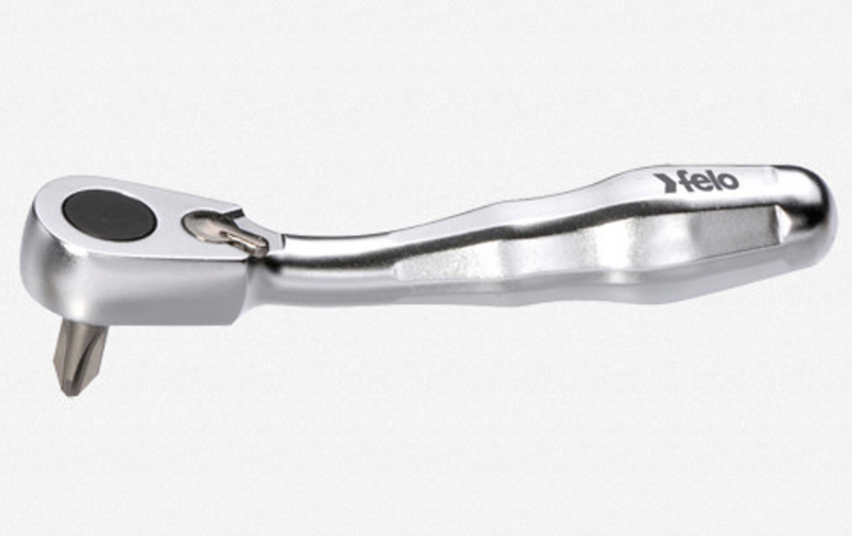

This Felo bit ratchet is the nicest one I’ve come across. Angled to give a little knuckle clearance too. It’s nicer than the Wera one I own.
Might be very slightly bigger than yours, but it’s worth it to me for 55-65 in/lbs jobs. The Wera version is smaller and harder to use in situations like that.

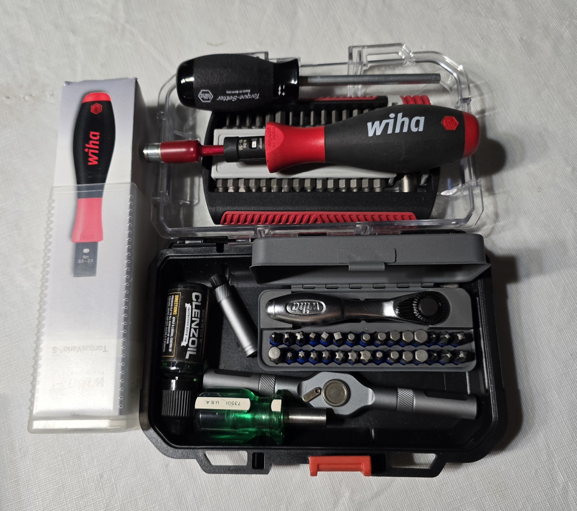

@Highbrass , i like your kit. What is the breakdown since it seems to be assembled not a pre-packaged one. I’m looking for wish list items for a family list.
Edit: also why the three different torque screwdrivers ?
1 torque screwdriver (the red one on top). The black thing is the adjuster. You take out the red bit holder and stick the end of the black thing in to adjust torque. The box appears to be on the left. We use them at work.
There also appears to be a wiha bit set under the screwdriver.
The wrench is just a ratchet for hex bits. Can be picked up from Lowes.
Wiha torque vario 10-50 and wiha terminator blue impact driver bit set.
Wiha 28506 TorqueVario-S Torque Screwdriver, 10-50 Inch Pound https://a.co/d/0fC2W2JD
Reactions: Modoc and Highbrass
Yep Lefty nailed it.
Most of what is there came from Lowes on clearance. The Wiha Torque driver came from E-Bay $40 Prob ..$100 total
