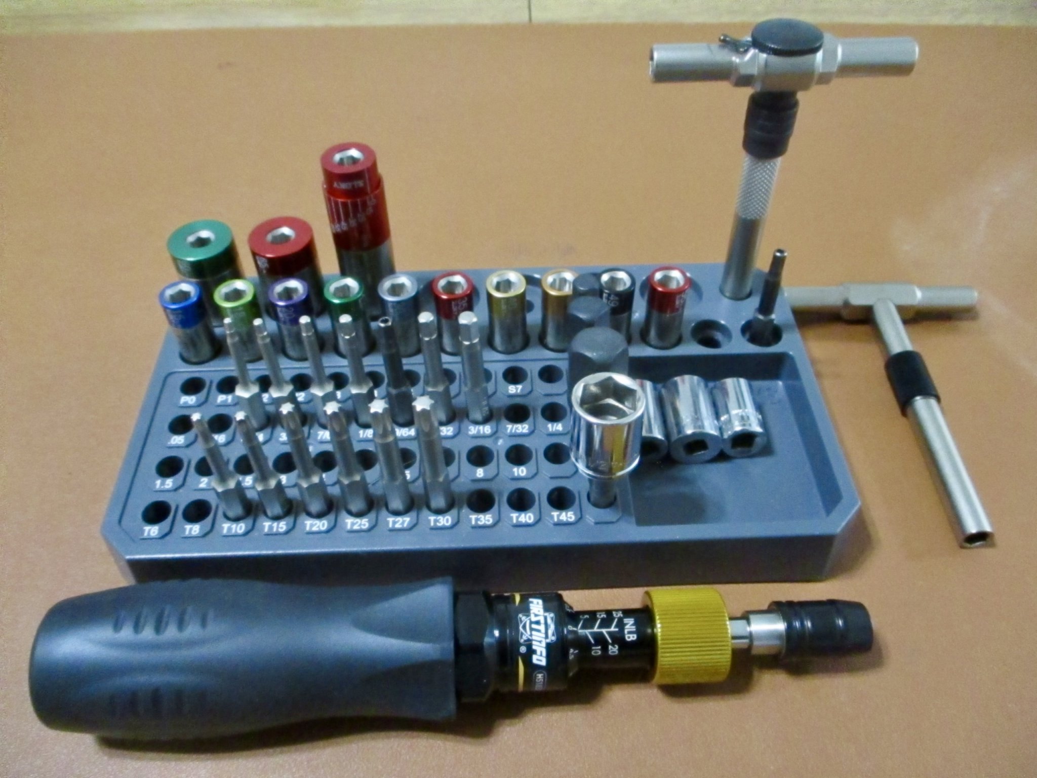

Fix it Sticks are just so user friendly. Seems accurate enough for rifle work. They make preset individual color-coded ones and two general “wider range” ones that mimic a beam torque wrench in function (no clicks, align two lines).

Fix it Sticks are really hard to beat for size and convenience. Their ratcheting bit driver is so useful that I've upgraded all of my kits to have them. You can also purchase their torque drivers and limiters individually if you know exactly what you need.
Fix it sticks are the cats ass. It might take you a few orders to get everything you want/ need.
I ordered this kit, added a few torque limiters and the 2" bits. I also had to get the larger carry case.
This kit is basically everything I need. I do have a few other misc allen keys in a pouch, You know the tiny ones that come with your optics and you can't ever find the right size for.
Fixit sticks. I use the all in one torque driver in the rifle and optics kit. I stitched on a velcro patch to the kit bag and then stitched the other piece of velcro to their magnetic tool tray. I can peel the tray off if I want but that hasn't ever happened. I keep my Arisaka wedges in the kit and a few scope specific allen wrenches. EDIT: I remember that I upgraded all of the torx and driver bits after breaking a torx bit long before hitting the torque spec.

Used a Wheeler FAT Wrench for about 10-15 years, and then bought some Fix-It-Sticks back in 2022... The Wheeler has collected dust since. The Fix-It-Sticks with individual torque limiters is undeniably better and more accurate/repeatable.

This is the fix it stick device I have. I had my calibration techs at work check it out. Every marked setting was within 2 in-lbs of the indicated value. I can live with that. Especially for the convenience and compact size of the the kit.
