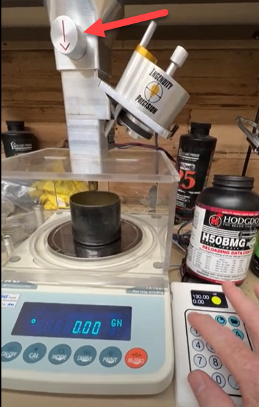

I am not sure he could make it any easier, from the 10-key to the etched arrow (nice touch) showing the boner-lovers on SH which way to turn the little knob. :)

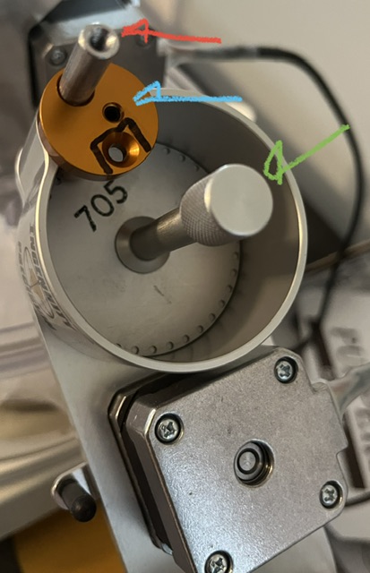

The change over process from stick to ball consists of 3 steps: swap disks (tool-less), flip the “wiper” over (1 small hex), adjust slider to taste, done. Takes only a couple/few minutes.
Wait. Was I supposed to use a wrench on that? I’ve been running it just finger tight this whole time.
Sometimes stick powders jam hitting the wiper (fixed with a quick back spin). Maybe this is why.
Shit, you’re correct, I was going off the top of my head and thought there was a small hex involved.
There is a small hex for the spring tension pressing on the disk… I was thinking of that I guess.
It sounds like you might need to play around with the spring tension for a minute maybe?
Red comes off first, finger tight. Then green to swap discs, again finger tight.
Blue just holds the little detent ball.
Not seeing a spring unless you mean on the underside, and I don’t see a way (or need) to adjust preload on the pulley arm.
Reactions: CK1.0
I’m thinking of the blue one, detent ball. There’s probably not even a spring in there, IDK WTF I’m talking about lol. 😂
