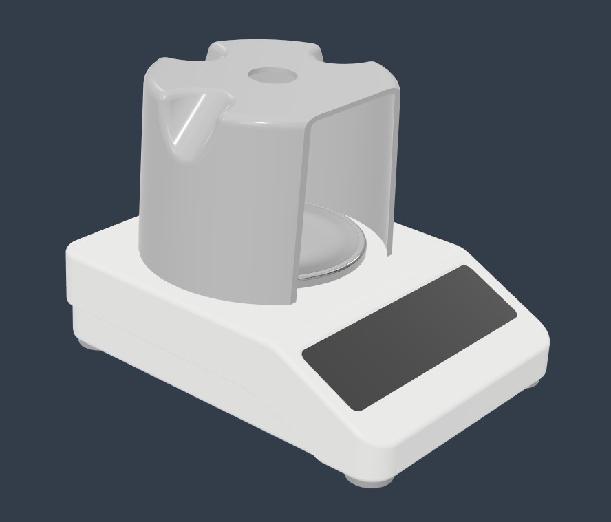

I told everyone I was also working on a new breeze shield that will be available. Thought I would show what that's going to look like. Will have first off samples very soon to show actual pics of it.
I never cared for the flimsy multi piece ones that are factory and wanted one that would be custom to where ever you wanted the window to be. Just simply rotate it as desired! Of coarse it will be clear in real life. The FX120 already has a circular protrusion to self center it and adapters will be made for other scales like the Sartorius and Creedmoor.
