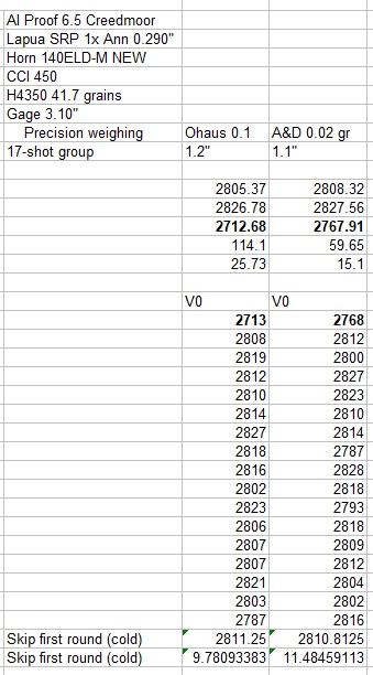

I was curious about the utility and have checked this on two occasions. The first was using a pet Stuteville 6.5 Creedmoor rifle and handloads with H4350 powder, CCI 450 primers, Lapua SRP brass (once-fired and annealed with an AMP annealer), and Redding bushing dies on a Forster Co-Ax press. Velocities checked with a Labradar. I did 20 or 17-shot strings. Thirty would be better, but I get bored easily and if a difference isn't apparent in twenty rounds, I'm sure I cannot shoot the difference. (It's analogous to eating oatmeal daily because it will drop your cholesterol by two points. It's an improvement but not worthwhile unless you enjoy oatmeal).
I took the velocity readings and used Excel to derive the mean and standard deviation. I then used Excel to run an F-test to look at the differences. If you compared the Redding thrown (not weighed) shots to either the strain-gauge or A&D rounds, there was a difference at the 95% probability level. I'm pretty cocky that would persist for a more rigorous 50-shot comparison. But comparing the strain-gauge to A&D weighed rounds showed no difference.
I happened to check this again last week using a different 6.5 Creedmoor rifle, but just comparing Ohaus to A&D weighed charges. When I initially looked at the results, I thought that I'd found a real improvement with precision weighing. The Ohaus rounds had a mean velocity of 2805 fps with a SD of 25.7. The A&D precision weighed rounds had a mean velocity of 2808 fps and a SD of 15.1. I was about to run an F-test but looked at the data more carefully. (The group sizes were essentially identical)
The first Ohaus round fired had a velocity of 2713 fps, well under all the others. It was about 40 degrees and this was the first round out of a cold rifle. Although H4350 isn't particularly temperature sensitive, the other rounds spent a little time in a hot chamber as I aimed. Likewise, the rifle sat and cooled for a few minutes while I fired a ten-shot group with the .308. The first "precision weighed" 6.5 CM round was 2768 fps, also the lowest velocity in that 17-shot string.
I re-analyzed the data, discarding the first "cold" round and just used the 16 rounds that followed. The Ohaus rounds then showed a mean velocity of 2811 fps with a SD of 9.8. The A&D rounds showed a mean velocity of 2811 fps with a SD of 11.5.
Ooops. I didn't run an F-test, but I'm confident that there was no significant difference after excluding that first "cold" round. I'll still keep using the A&D scale, however. First, unlike the Ohaus strain-gauge scale, the A&D never exhibits any "drift" whereas I have to watch the Ohaus and periodically tare it back to "zero" (which is a class characteristic of strain gauge scales). Also, the response and result on the A&D scale is much faster. I don't enjoy weighing individual charges but it is worthwhile for precision rifle ammunition. The speed gain with the A&D/Autotrickler/Ingenuity Precision system is substantial.
It may seem counter-intuitive that precision weighing does not reduce velocity SD. With cartridges in the .308/6.5CM class, I generally find that one grain of powder increase yields about 60-70 fps increase in muzzle velocity. When I check the Ohaus weighed "0.1gr" charges on the A&D scale, I'm decreasing my powder charge variation by about 0.10-0.15 grains with precision weighing, so you would think that the velocity SD would drop by about 6-7 fps. Nope. The trouble is the muzzle velocity depends on other factors also, like the powder temperature, case capacity, exact bullet diameter, primer ignition, and more. The total "error" in velocity is the square root of the SUM of the individual "error" squared for each of these factors. So even if one drives the error in powder weight down to zero, you don't gain measurable benefit from eliminating a powder weight variation of only 0.1 grains. (The mathematical proof is gnarly, but remember that all the errors work in both directions)
Cal Zant's "Precision Rifle Blog" has some excellent essays on these considerations. Improving the accuracy or velocity SD of our pet load can be helpful, but only within limits. One does reach a point of "painting the lily" where further improvement just does not help get rounds on target. At some point, you have to declare victory, push away from the reloading bench, and learn to call that damn wind!

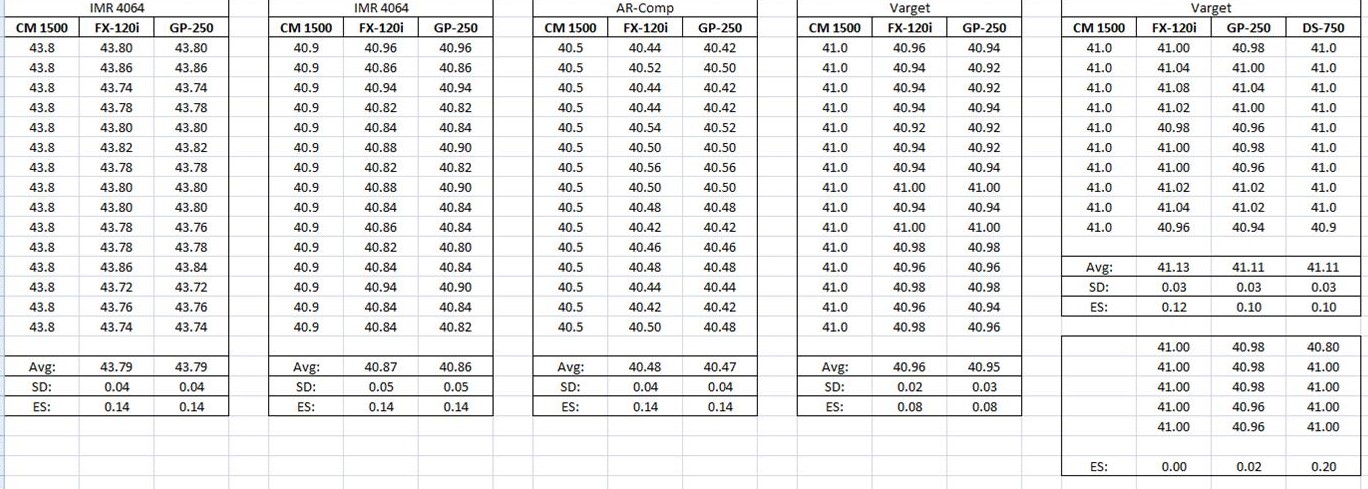

It's well known that the FX-120i is pretty accurate and I was very curious as to how much difference there is between the scales I have )including a small Frankford DS-750) and the FX. The other scales were all less accurate, but not as much as I thought and how much that might make a difference on target, I feel depends a lot on the amount of precision is required for the type of shooting one is doing. Often preferences for the FX had more to do with speed, and ease of use to get an accurate reading (e.g. drifting issues). I've posted this in other threads, but here again is those numbers:
I think owning a good scale that measures to +/- 0.02gn and that allows dropping every single charge to within a kernel is one of the single biggest things we can do to consistently achieve low SDs.
Along with an A&D FX120i, I also have an Ohaus SPX-123 which also has +/- 0.02gn resolution (strain gauge, but fast and doesn’t drift much) and even before I got the IP tricker I had noticed that there was no going back from measuring powder drops to the kernel for me.

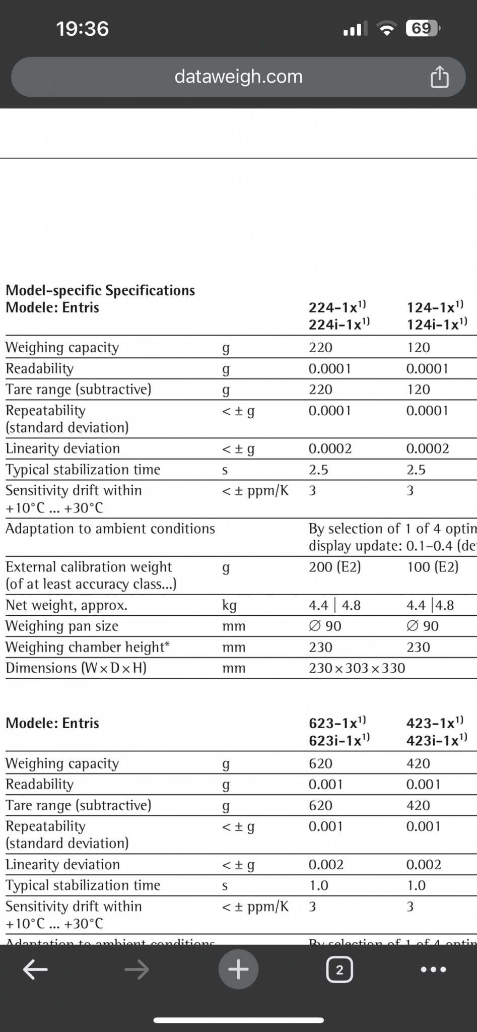

Anybody know which sartorius scale this is?
After hearing Doug Skogman talking about it on the Cortina video, I’m interested in the speed and lack of drift he was saying the Sartorius offers
Paul mentioned the one in his video was discontinued, and recommended the
BCE124-1S​
Looking at over $2,000 for that scale.

Here it is saying three for the sartorius, but I don’t even understand what the units are or what they mean and nor can I find an explanation on the Internet
At one hour and 12 minutes, almost exactly in the Cortina video, Doug says that the sartorius doesn’t drift. Made it sound like it’s night and day from the FX.
When the FX drifts, is it the calibration being thrown off or is it just the way the scale is reacting? Meaning... is re-zeroing the scale after drift enough to give us peace of mind or do we need to re-calibrate?
Here it is seeing three for the sartorius, but I don’t even understand what the units are or what they mean and not can I find an explanation on the Internet
At one hour and 12 minutes, almost exactly, and the Cortina video, Doug says that the sartorius doesn’t drift. Made it sound like it’s night and day from the FX.
That is what I heard also. Maybe this is the wrong spec, or the "drift" we refer to isn't the same as this spec? I wonder if the drift from zero is also somewhat a function of the code in each scale and how the scale corrects to stay at zero?
I found this on the web regarding that spec.
"The thermal coefficient of electrical circuit parts is sometimes specified as ppmC, or ppm/K. This specifies the fraction (expressed in parts per million) that its electrical characteristics will deviate when taken to a temperature above or below the operating temperature."
So, if my math is correct (3/1,000,000)*100. We are looking at a change of 0.0003% for each degree Celsius or Kelvin (same delta, different scales).
The "better" spec would be 0.0002% or 0.00015%. I'm not sure if that small difference matters or not?
