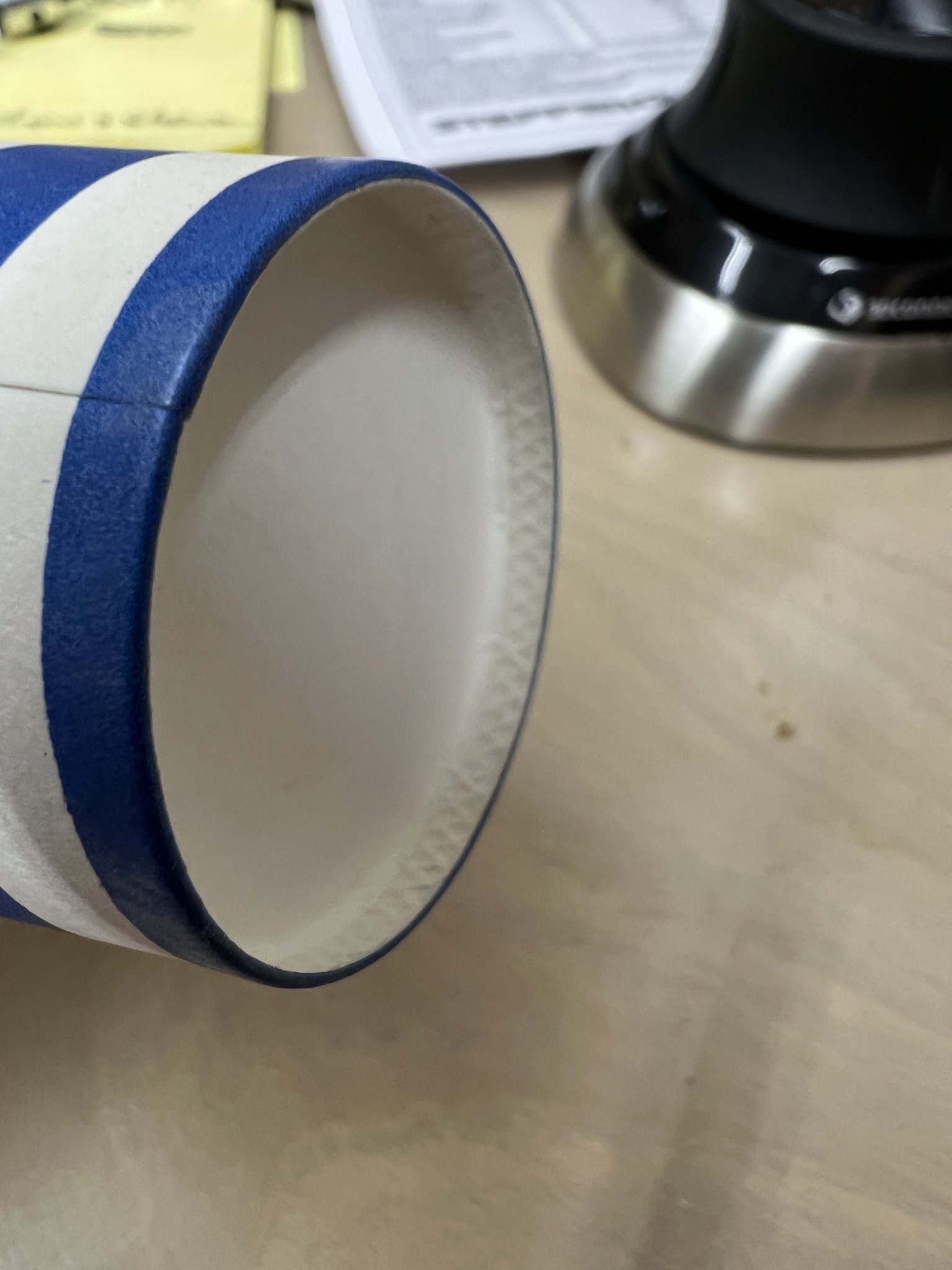

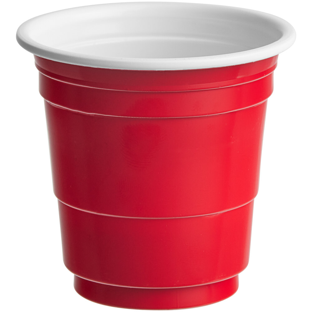

There are quite a few 3oz disposable plastic bathroom / mouthwash cups with elevated bottoms that might be worth testing. Quite a few to pick from on Amazon, provided what you receive matches the pictures...
I guess this is a dumb idea/question but thata not stopped me before...
Could a cup be made that would have an elevated bottom like that but allow for a screw on bottom so that heavy tin foil or something could be used to make the bottom then screw on the bottom ring to hold the foil tight? Seems like that would recreate the same phenomenon that makes the Dixie cup work so well? Or something like that? Probably would need something that wouldn't crinkle up to make the bottom part so powder wouldn't get stuck. Not sure if another material could make the bottom and be flexible enough to absorb the powder energy from being dropped. Just a thought that probably won't work or be practical to do.
These little shot glasses seem to but the bottom has got to be more rigid than the paper cup so don't think it would have the same effect.

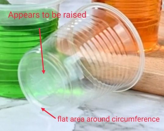

you can simulate the elevated bottom by stacking two plastic/paper cups - usually there will be a small space in between that will effectively raise the inner cup to create the drum batter head effect
Indeed you could use a steel/glass/alloy/plastic/printed outer cup with a dixie liner
This is an elevated bottom. I have not seen this in plastic.View attachment 8275873
I've never seen a plastic cup with a bottom exactly like that either, probably because of the difference in making a paper cup vs a molded plastic cup.
The plastic cups usually have about an 1/8" ring around the circumference that is flat and supports the cup, but inside of that 1/8" ring the bottom is elevated slightly.

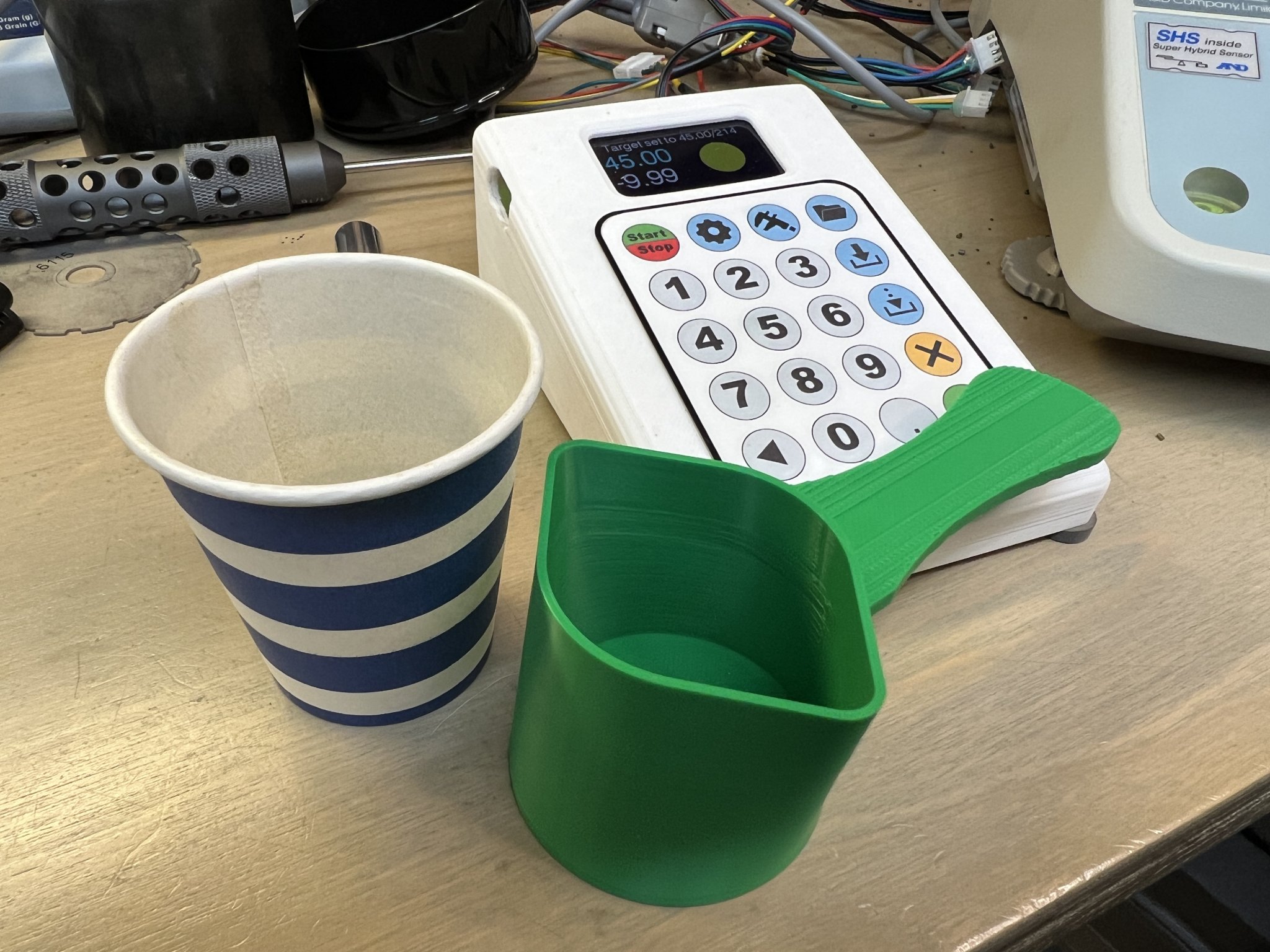

Think I've got the cup design down. Now to send it out to print 1000's. Definitely not green! Probably white to show powder best.
Sweet. I will just take the green one you have now with my kit though..... to make it easy for you, go ahead and shoot me a link and I will pay for the new unit and you can cross me off your list
