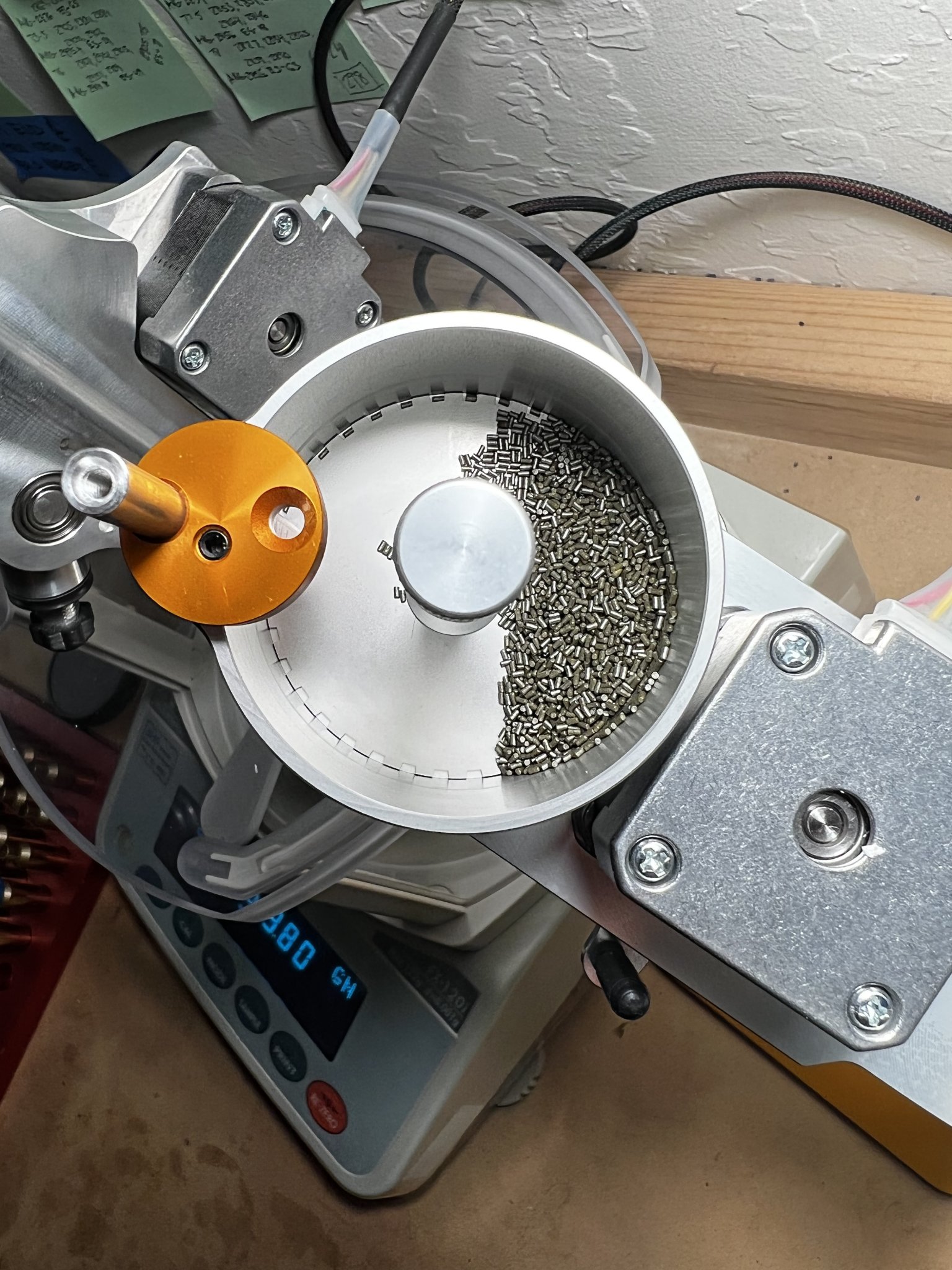

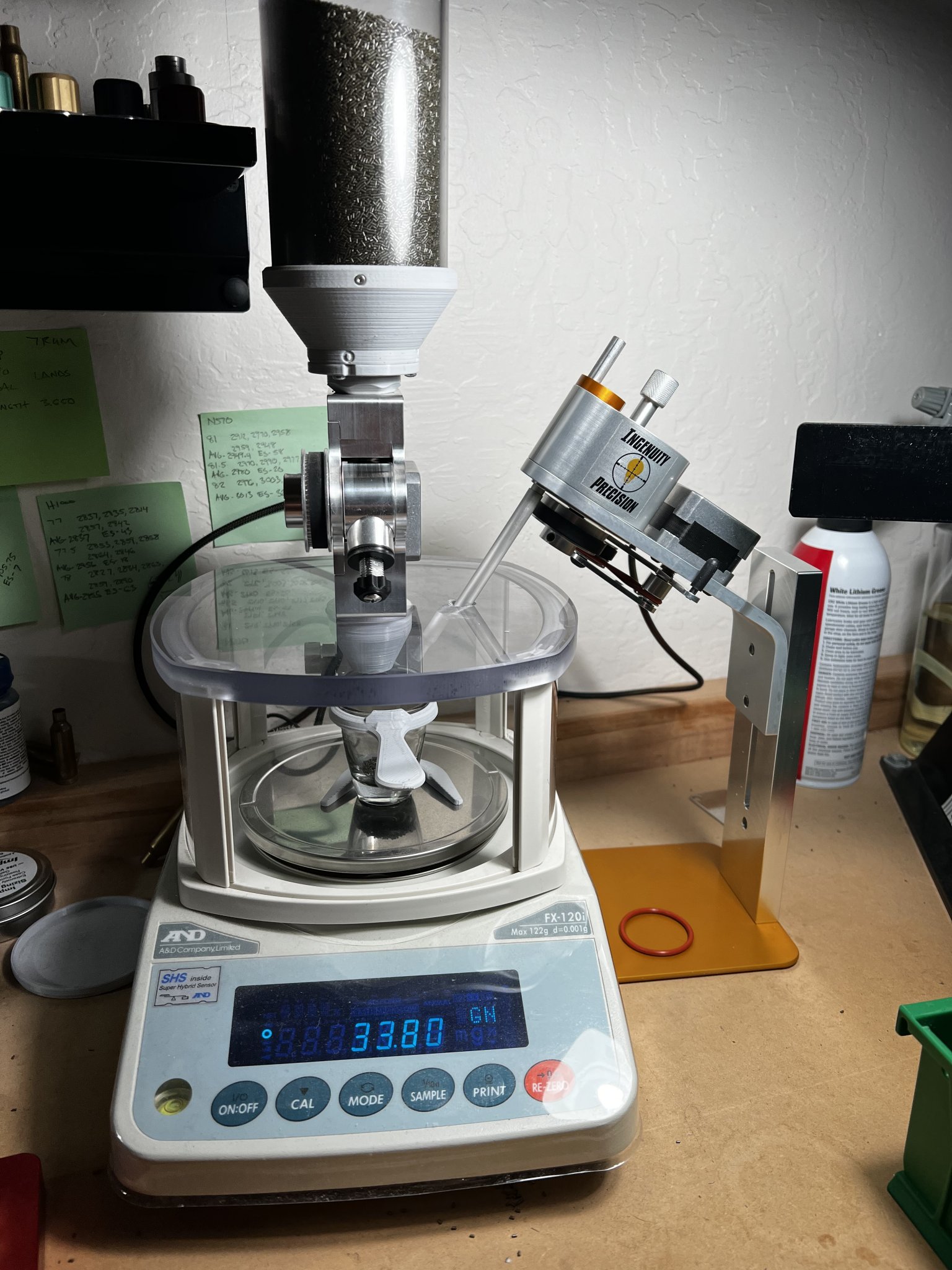

Delivered and setup on Wednesday. This thing is freaking awesome! Loaded 100 rounds with it average charge time of 6.75 seconds with 33.8gr varget and ZERO overthrows absolutely perfect! Best investment on reloading bench since Henderson trimmer

For everyone that's running them now, how are you set up? The video instructions say run the slider full fast, but doing that with 8208 would overthrow. I'm closer to half way. First run, so it may just need to run in some, but curious how people were setting it.
I'm a little over half way with H4350, and it seems to do pretty well there, but I haven't really focused in on tuning it yet, Been too busy..

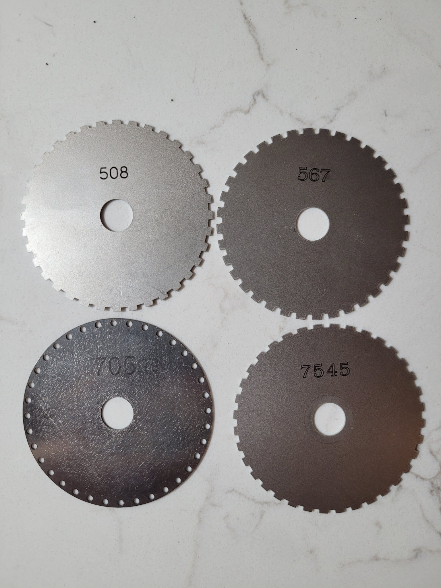

Any chance we could get a quick side by side picture of the standard disc (7574) and the ball powder disc (705)? I'm wondering if I need to get one to run the occasional staball.
Sure. Give me 5 min. I don't think it would work though. I thought about the same thing initially but never tried it. The ball powder disk works so well that it wouldn't be worth it to not have it if you use ball for precision
Here you go. You can see the big difference of course.

Varget and H4350 I run it full to the right. Have it drop 1.2 gr under from main hopper.
I got mine setup today and I'm 1.3 under and slider all the way to the right...super fast and dead on every single time with H4895. Sssoo much better that my Autotrickler
Hmm, ill have to try and lower my initial drop some and push that slider all the way over and see what I'm getting. I agree, way better than the OEM trickler..
Took me a few minutes to dial it in. 1.3-1.5 under charge weight was the sweet spot. After watching setup.video, key is to have the IG running full speed upon drop then let ramp down do its thing..
I found if you drop much under 1.3 the trickler isn't running upon drop...delay a few seconds then the IG motor kicks on... per the IG video....key is to have it running full speed upon drop. Once I found the minimum I could drop with IG full speed it was perfect
I tinkered with mine some more, took it down to about 1.5 under and it started running pretty good, still had to slow it down a little though cause she wanted to over shoot about .04-.06. When I slowed it down just a little, she's landing on setpoint almost perfect every time. It may be .02 over after several throws, but honestly I could probably adjust that out with the speed. This thing is awesome!
