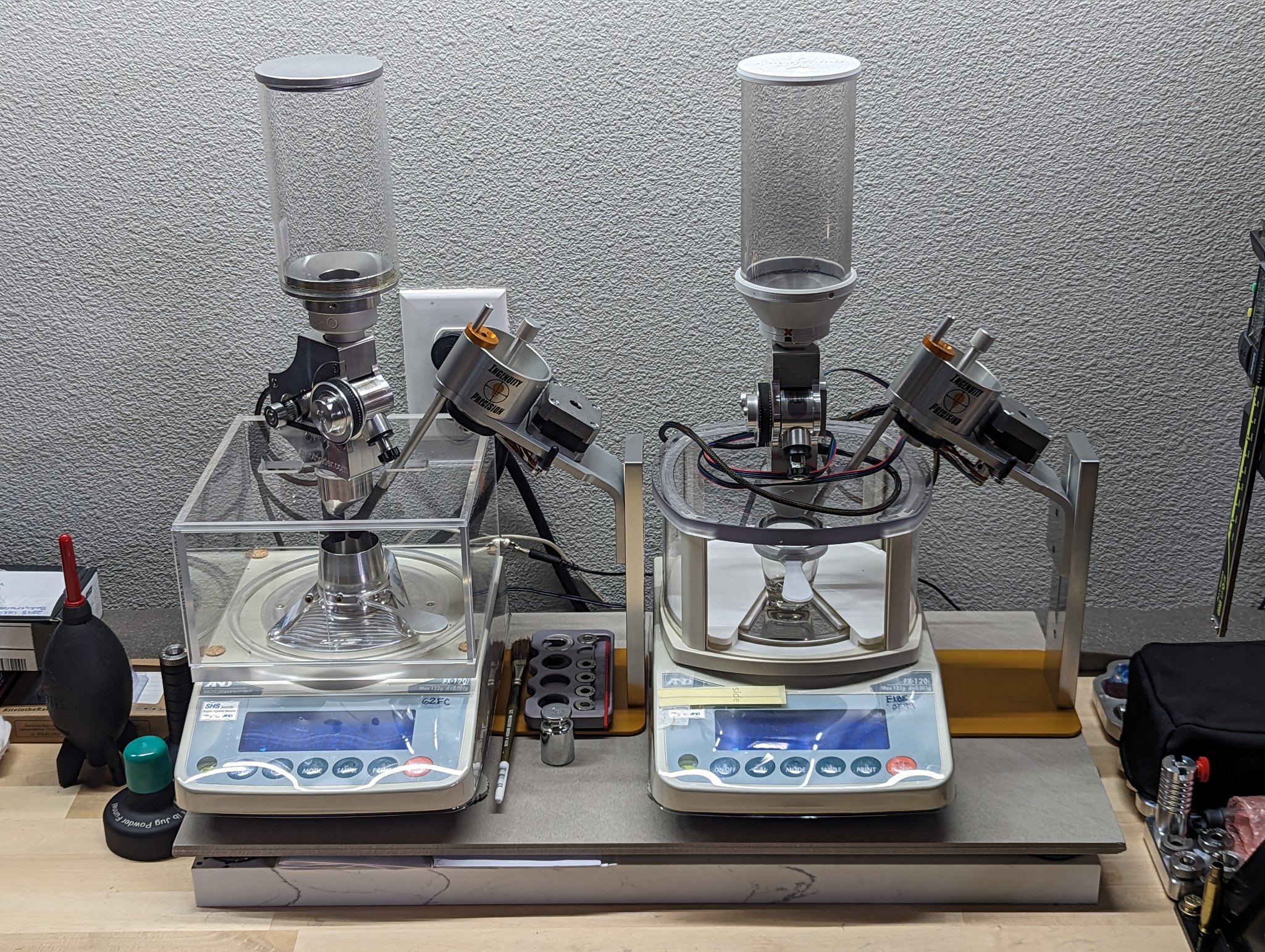

Mine showed up today. I freaking love this thing. Insanely fast and very accurate. I did have a few times where the trickler got bound up throwing N150 but otherwise a huge improvement over my area 419 upgraded v2.
I threw around 50 charges of n140 and 50 charges of Tac. Only a couple overthrows once I adjust the ramp down controller. And the overthrows were .02gn. Speed was amazing too. I was throwing about 1.5gn low and it was done trickling about the time I got the last case into the shell holder and started to seat a bullet. With my V2 trickler and it’s slipping belt I would many times be waiting for it to finish after seating the last bullet.
If you have a little binding, recommend just wiping the discs with a little isopropyl alcohol. Sometimes it's the manufacturing process.

I will give it a wipe down thanks for the tip. And i was running the 7545 for the n140 and 567 for tac
I have a sartorius entris 64-1s with Paul's ingenuity precision trickler. Does anyone have a side window available to purchase that would work with my setup?

Been loving my IP but ran into some issues with it jamming up trying to run pistol powder. W572...it's considered a ball powder but is more like a smashed ball or flake powder...
Totally forgot I had to flip the wiper around to the non-notched side for ball powder. Running excellent now!!!
Mine does not like N555 it jams up a lot. not sure what the solution is. I've tried flipping the wiper and running with no wiper without great results.
