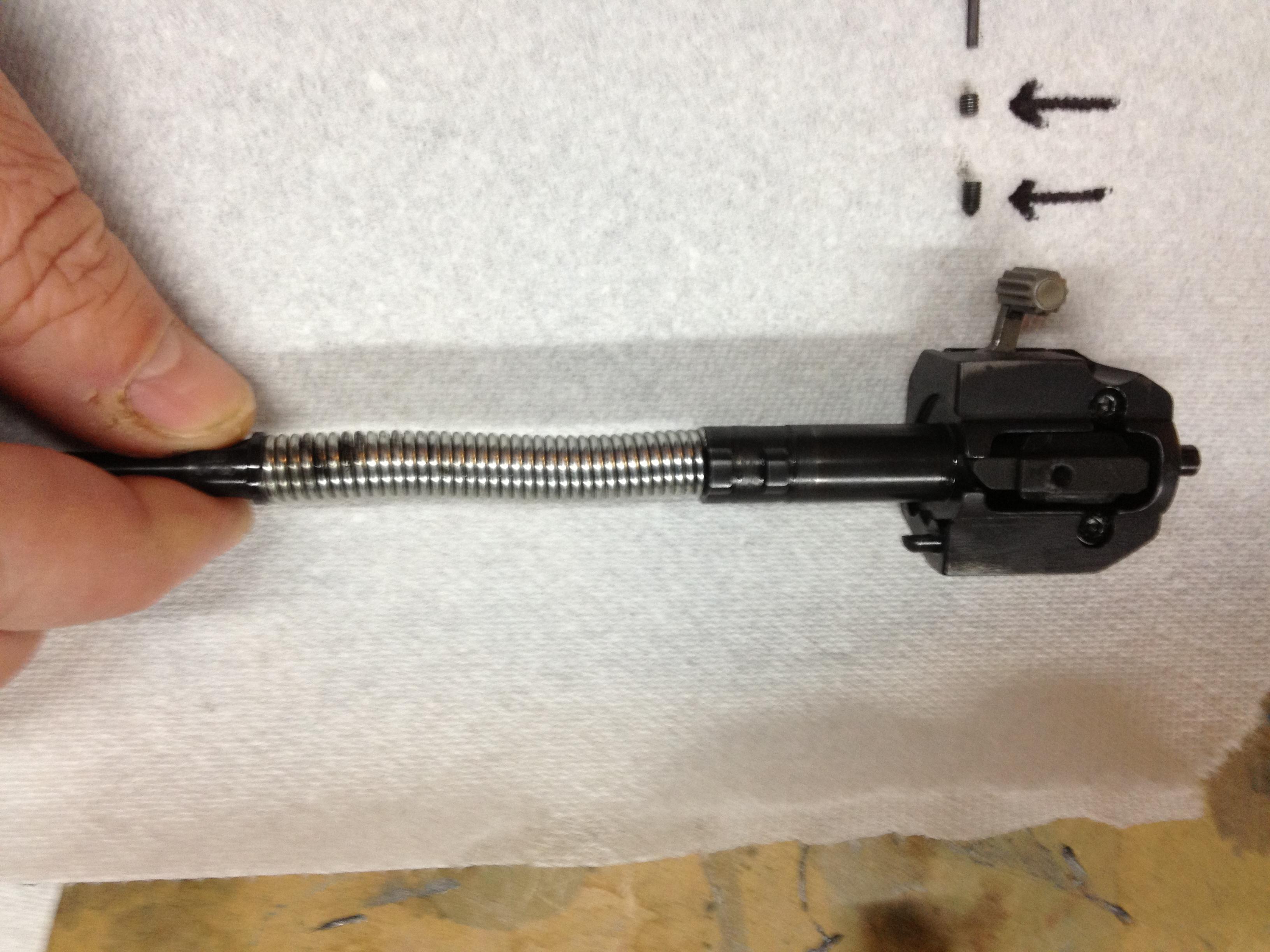

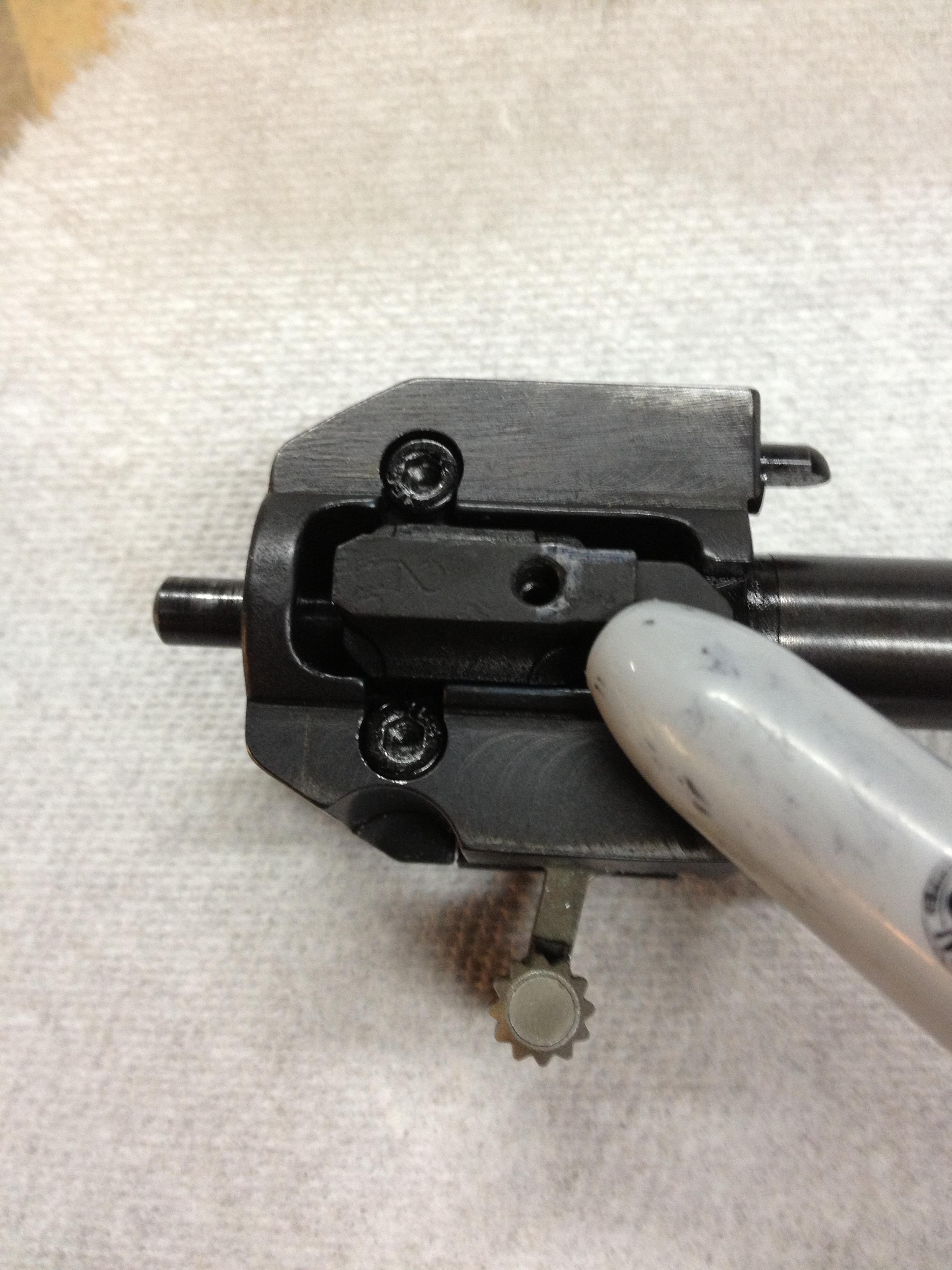

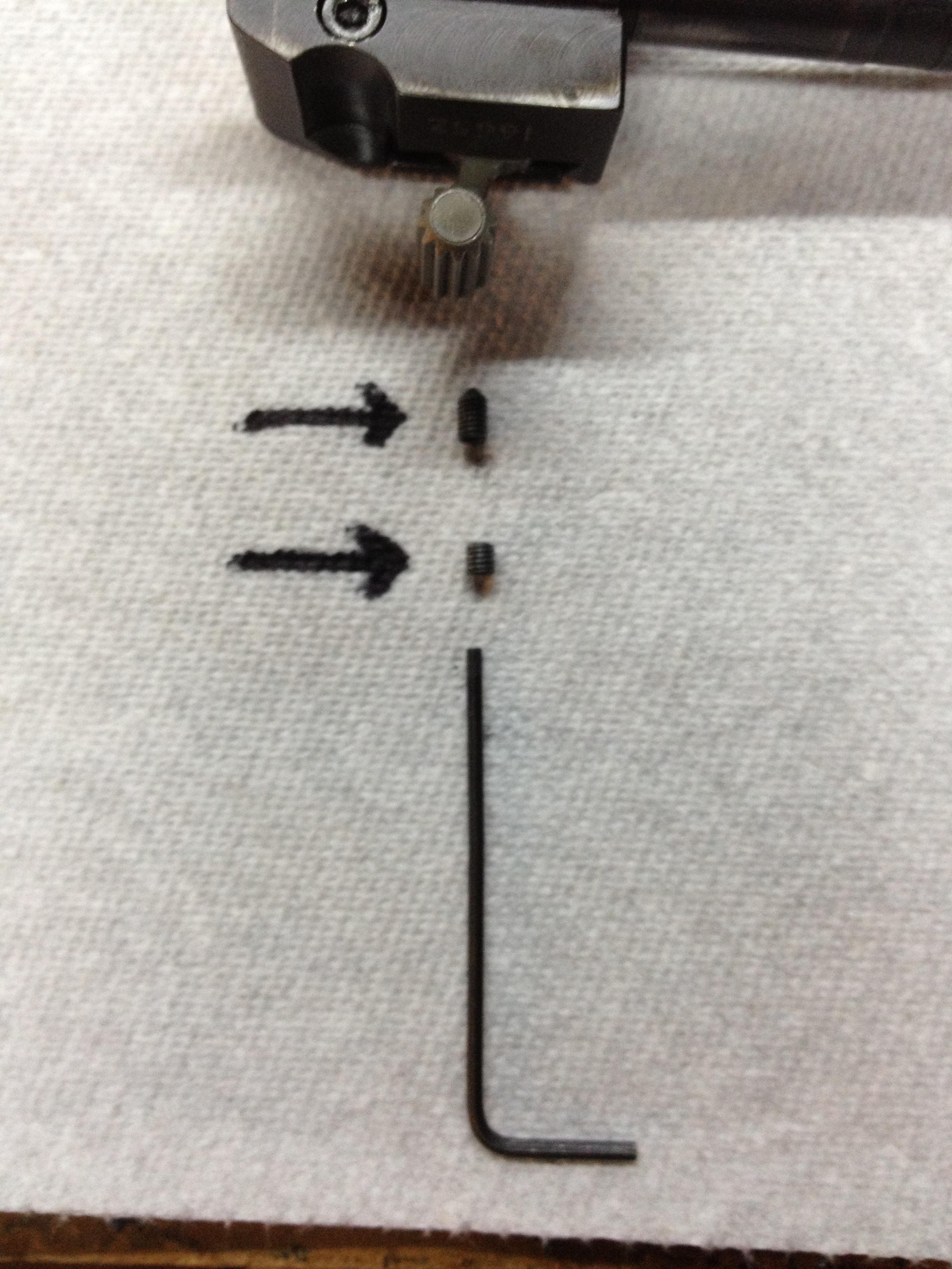

All,
I figured out how to adjust the firing pin protrusion between information that I received from Lowlight via PM and another source. I searched around and couldn't find directions, so I'll supply them here. The setup that AI has is really quite elegant. I'm told this procedure is outlined in the armorers manual which I would like to get my hands on. We'll see if this addresses my issue. Along with any unauthorized adjustment to the rifle, you perform this at your own risk.
There are two set screws (one of top of the other) in the cocking piece. They take the same size wrench. The longer pointed one goes in first.
The firing pin is threaded through the cocking piece and you can turn it to adjust the protrusion. You can turn it by placing your fingers as shown. Half a turn will adjust protrusion by approx .010 - 0.012. You can remove the firing pin entirely by simply screwing it out. By removing the firing pin you will understand how the set screws work and why you have to adjust it half a turn at a time. In addition, you can't turn the firing pin more than one full turn past the factory setting or else the set screws will not work properly. You'll understand what I mean when you take it apart and examine it.

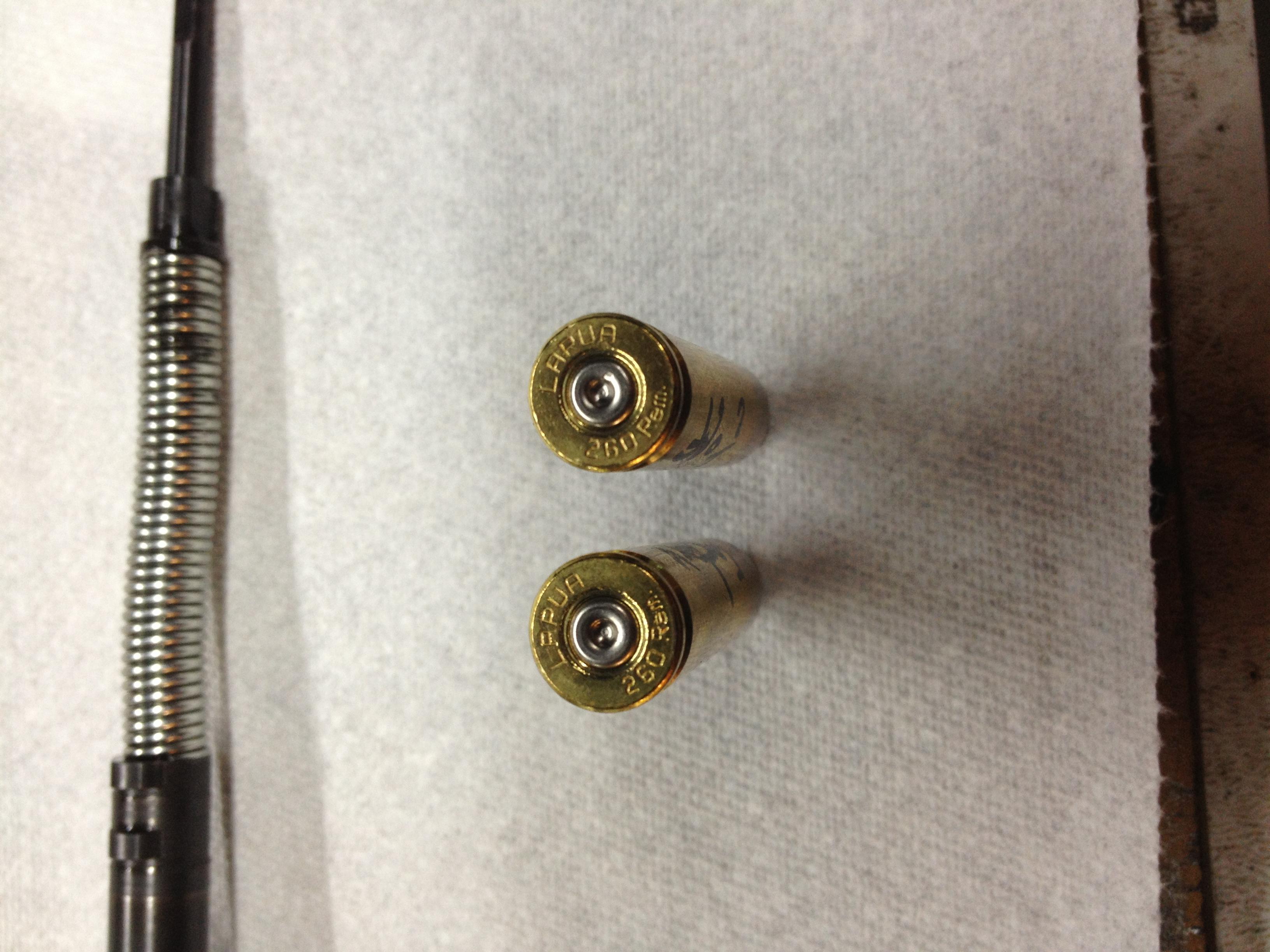

I took two pieces of virgin Lapua brass, primed them with CCI BR2 primers, and then fired them. There was NO powder or bullet. The cartridge on the bottom represents the factory setting. The one of the top represents one half turn of the firing pin inward. It's hard to see in the photo, but the factory setting really stretches the primer cup almost cutting into it where the tip radius meets the shaft. The adjusted setting looks more than adequate. If I turn the firing pin another half turn inward the primer will not fire.
I wanted to make sure that the reduced protrusion would not cause ignition problems. I took primers and seated them hard to the point they were flattened out and were .010 - .012 below flush. I used virgin brass which is set to minimum headspace. It fired using a CCI BR2 and a CCI #34 which is considered a less sensitive military grade primer.
I do not know which setting meets factory specs and AI will not share this information. That's their right. To their credit, they said they would examine the bolt and adjust protrusion. Personally, it's nice to have the flexibility of making these adjustments in the future.
Update: I found out from a well informed source who shall remain anonymous that the firing pin protrusion spec is .042 - .058. When you take the measurement make sure the bolt shroud is hanging in the air and not pressed up against a table.

All,
