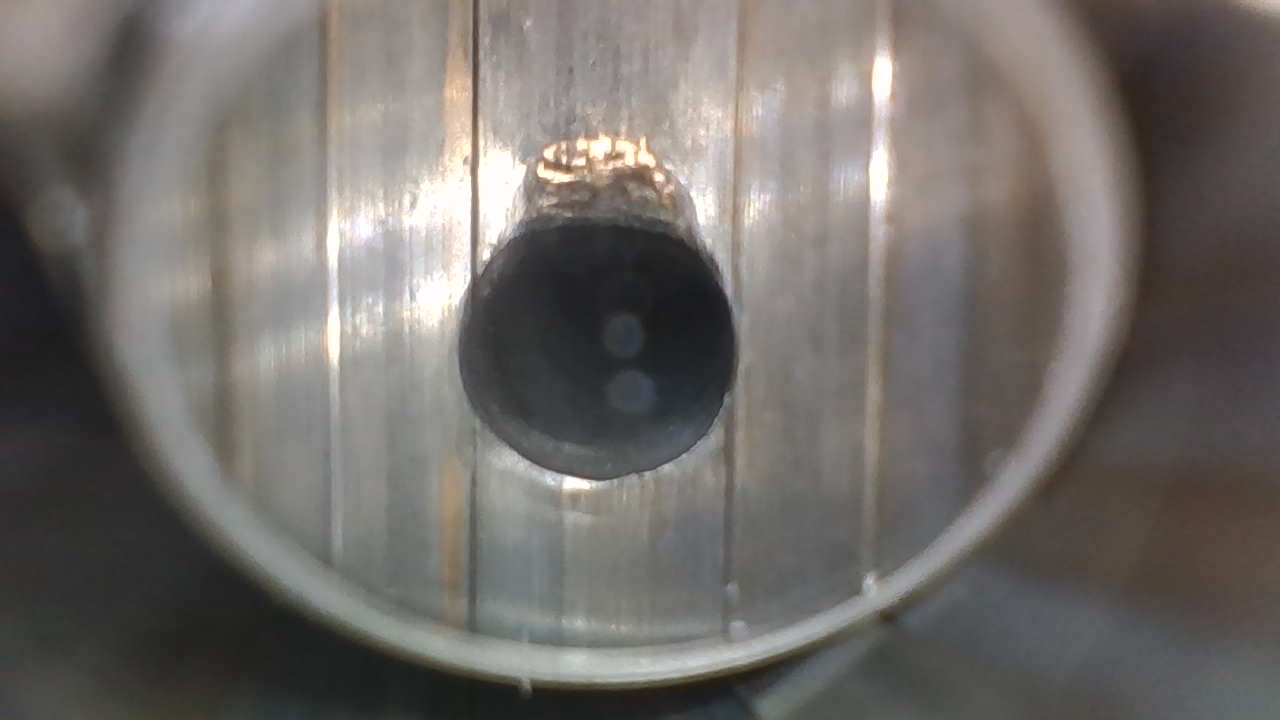

Still searching to solve my .224 Valkyrie "3-MOA-Mystery" ... used an endoscope and saw something I've never seen in my limited experiences. Gas block holes are always pretty "crisp" on my other rifles, but this one looks different. The imperfection is on the bolt side. Rest of the barrel looks fine. It's on my relatively new WOA barrel ... only 40-ish rounds through it, and after solid barrel break-in cleanings.
Should I be concerned about this? Or is it a "Nothing-Burger"?
I've seen that on numerous gas ports...thats not abnormal from my experience. I have a .5moa 6.5cm cut rifled barrel from a top smith with a gas port that looks identical to that. It's a fucking lazer.

Totally normal. I’ve had wear twice as long as the diameter of the gas port and the barrel still shot.
Well, maybe...................but that's a new barrel with 40 rounds down it, so that's not wear...............that's a burr with copper now attached.
Not an unheard of thing for a barrel to have a slight burr on the inside of the gas port but truly, it really shouldn't be there, but I can't say it is or is not affecting accuracy since I've never done an A/B test on that condition.
But I'd remove it by using a bronze brush & then lightly polishing the bore with JB.....................or since it's a new barrel / upper, then just send it back if you choose to do that.

I about fell outta my chair when I saw this. Just bore scoped my 22" JP Supermatch barrel; that I have had for 3 weeks and am getting really bad results with, looks exactly like this picture at the gas block. Not sure if this is an issue but definitely interesting.
Anyways I emailed Dave at JP today to ask him about my issues. Will reply back when he does.

Mine looks just like that. Shoots half MOA.

Our 6.5 large frame barrel had a burr at the port and it definitely mattered. When I first got it it shot 1/2 moa with random loads. Cleaned, tuned a load, shot, and then it started throwing flyers. Chased my tail a bit and finally borescoped and found a large chunk of copper stuck to the far end of the port. I cleaned and pushed a soaked patch to it and left it for hours, repeated and finally got it all off and it was back to normal. Kept the copper cleaned off for a few hundred rounds and now it’s smoothed out and hammering. I posted a thread about it I’ll see if I can find it. I won’t say it always matters but it definitely can matter.
It's just erosion from the gas, all barrels get it but stainless gets it a lot faster.
Erosion is standard for sure but when a burr on a newer barrel starts dragging copper it’s no bueno. That’s what his pic looked like to me. My guess is it would eventually work itself out but it was nice to find mine and fix it overnight.

The photo I was talking about is 7216100 that rustyinbend posted, that is erosion.
If we’re talking about the same photo this one looks like erosion with a blob of copper on it to me. There’s definitely a gold color to it. Either way if I was having issues I’d be pushing a patch to it to make sure!
