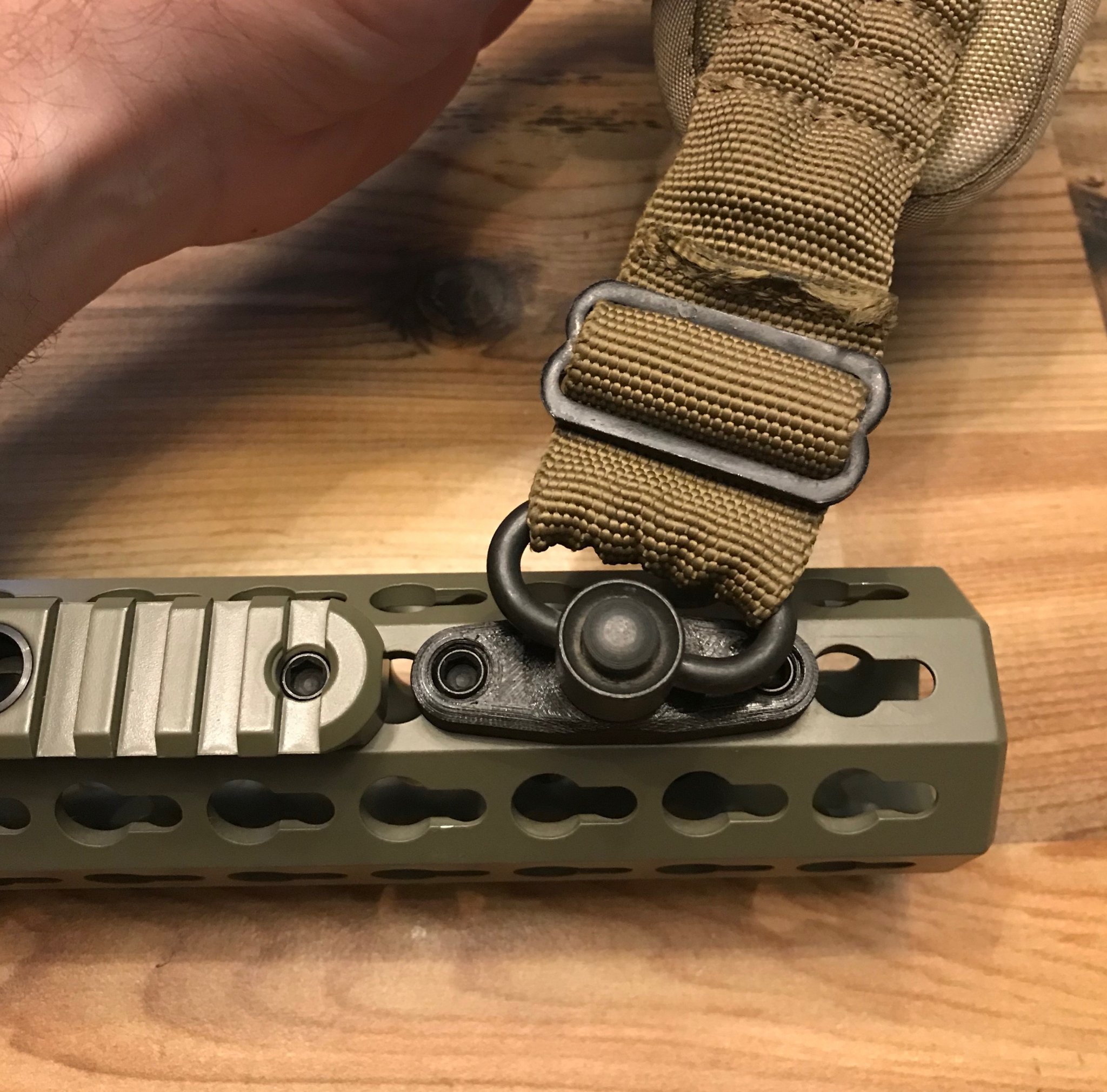

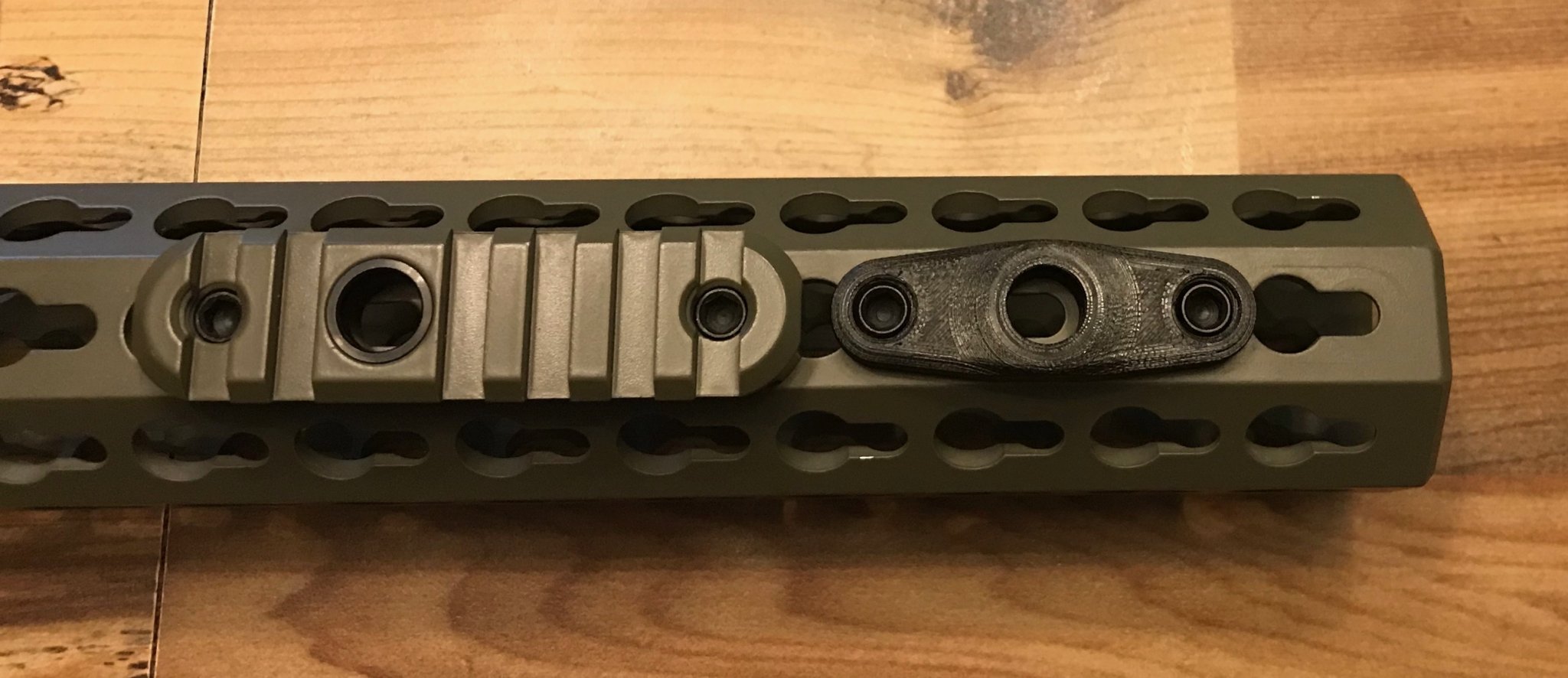

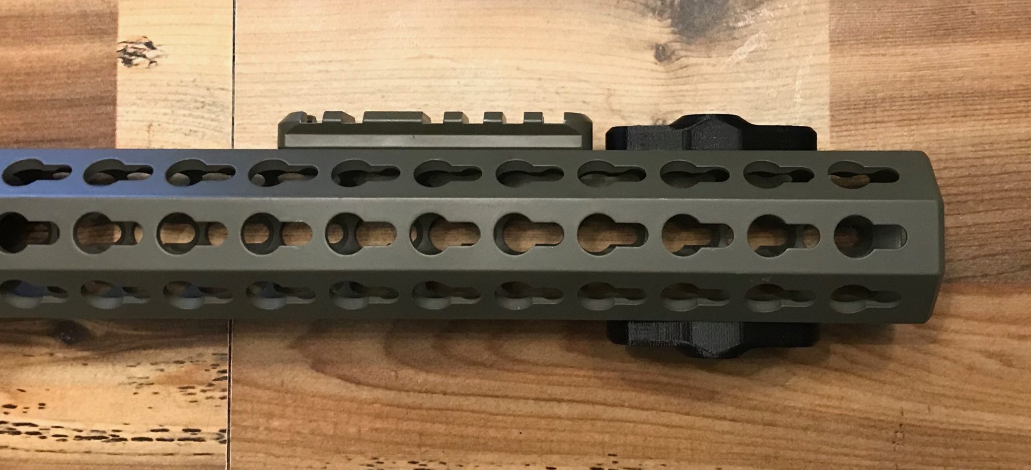

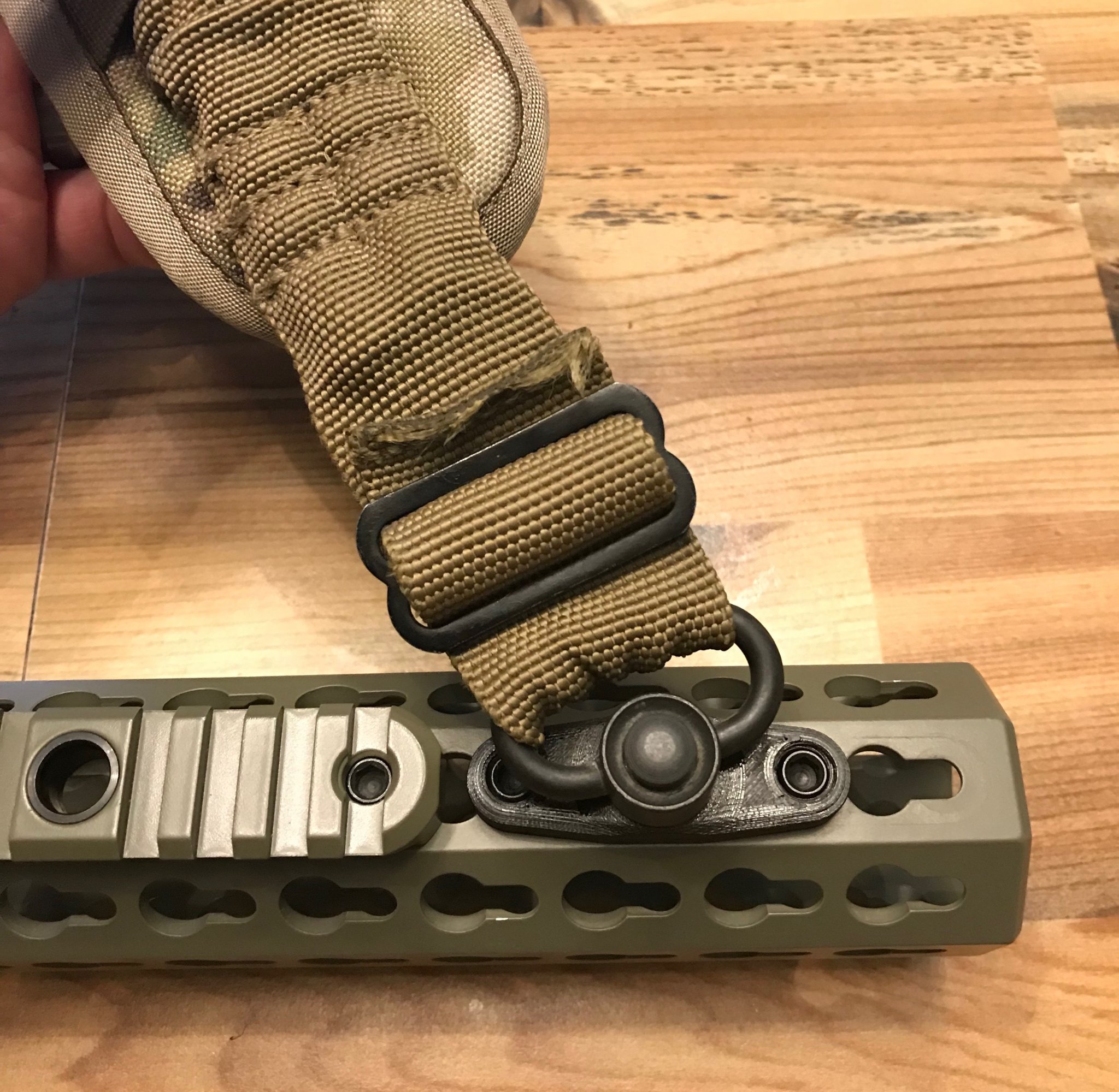

Just a heads up, I've got another cool product I've been working on! If any of you AX shooters have been wanting an anti-rotation QD sling mount, I've got the answer. This will work on all pre-14 and post-14 AX forends (AX, AX338, AX308, AXMC, AX-AICS), all you'll need is the correct mounting screw for your variant. Mounting screws will be available at the time of purchase if you need an extra pair.
The mount will be Black Nitrided steel, and comes in at only 0.36" H x 0.66" W x 1.85" L. It's super snag-free and much lower-profile than the factory picatinny/QD combo. It is anti-rotation, with sling positions at 12, 3, 6, and 9 o'clock. Each position has about +/- 15° of rotation built in it so the sling isn't too locked into place.
These will be an Anarchy Outdoors exclusive product, and the estimate I've been given is 8 weeks for availability. Let me know what you think!

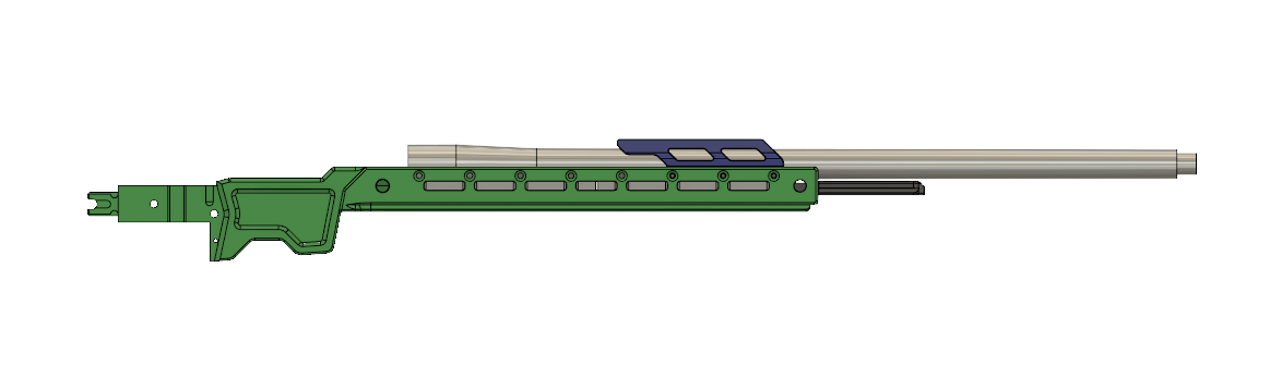

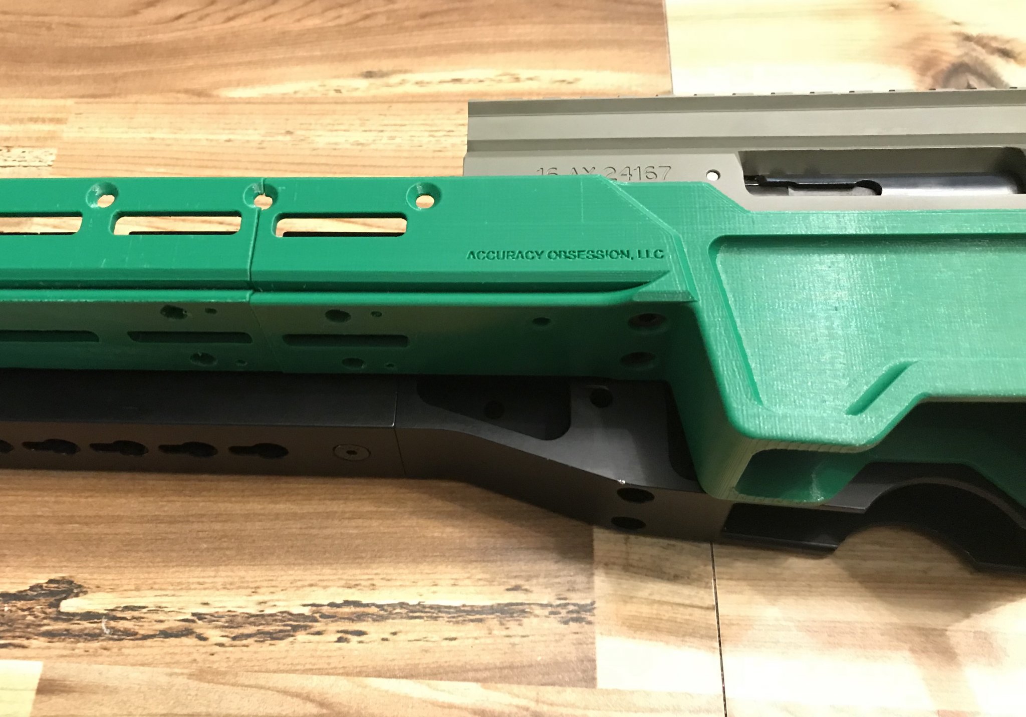

Update for everyone:
- CAD files are complete
- Files and drawings sent to machine shop
- Full 3D printed prototype of chassis and all accessories sent to machine shop
- Order is in for 3 complete chassis builds with accessories
- Timeline estimate is 8-10 weeks. Likely have to add another couple weeks for post-machine coating and painting
I'm excited! At the end of the day, even if I don't make any more than these 3, I think the work will have been worth it. And hopefully if people see the benefits and functionality of the new chassis outweigh the hassle of de-bonding/re-bonding their factory rifle, then I'll have a production batch made.
Thanks,
Sam

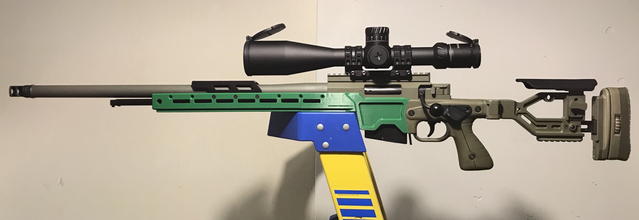

Took the newly RE-bonded AX out to the range last weekend. After removing the scope rail, Razor in Spuhr, barrel, buttstock, and de-bonding the chassis...once re-assembled and re-bonded, it shot within 0.2 mil (straight down) of my zero from last year. The AI system is ridiculous, and this at least proves there is no ill-effect of re-bonding the action back to the chassis. I have a lot of faith that my new chassis design will perform the same when assembled.
I then used the AX in a local match here in WI, ended up in 7th out of 80 shooters, a pretty good day overall for having taken 7 months off (4 of those months with the AX completed disassembled haha).

What is the issue with the MPA-AT?
The AI trigger is installed into the chassis via two large vertical cap screws, vs the typical two horizontal small pins on R700 actions. It is designed to be serviced by removing the stock skins first and then removing the trigger, while the bonded action remains in place. The MPA-AT functions like a typical stock, where you have to remove the entire barreled action to access the trigger. Therefore you cannot approach it this way if you want to bond the action to the chassis. Having the action/chassis bonded together AND utilizing an AR trigger tang would be really hard to get to work (believe me when I say I've spent a lot of time thinking about it haha).
The AI folding stock hinge is peerless, there's no debate there. And I think the AX buttstock is miles ahead of the MPA buttstock (tiny set screws, anyone?). So utilizing the existing AI backend - including the grips, love them or hate them - made the most sense. My intent was always to design a chassis that represented what AI would do if they made a competition oriented front end. Going back to my "AIAC" concept from a couple years ago, my plan was always to have a bonded system just like AI has been doing, but with a forend that was in line with current competition design trends.

The chassis as it is now is 12.75" long from the action face, and approximately 14.75" from the front of the magwell (this is NOT including the 3" long spigot). The ACC is 18" from the front of the magwell, so roughly 3" longer. Honest question - is this difference meaningful and will it cause one to lose points at a match?
The main reason it is this length is so a user with a bonded action could still install a 16" barrel. Since the handguard would be fixed, this would leave 1.5" of barrel in front of the chassis to tighted by hand. Anything longer and it would preclude the user from shooting barrels they already have. I could make it longer with the disclaimer that only 20"+ barrels will work, but it was a conscious choice to not do that since so many people like shorty 308 barrels.

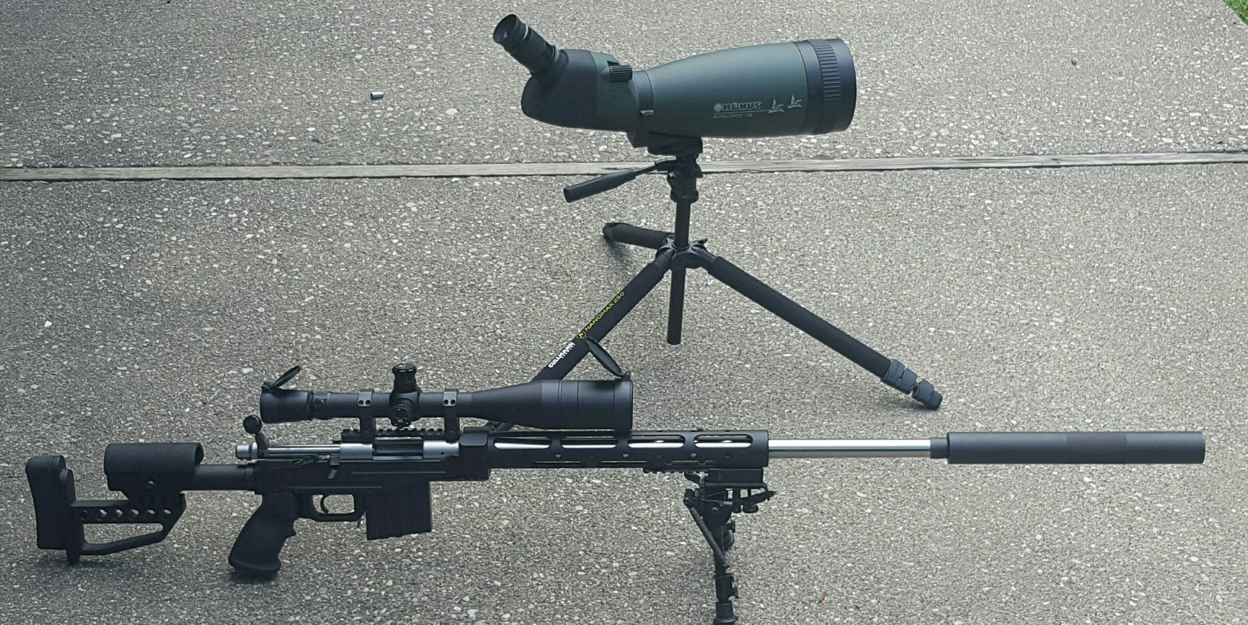

Even though I have an MPA, MDT, AXIS and stocks.... we all want the best and no, 3" will not be the end all deal killer. Either way, I personally do not use the spigots.. Just do NOT see the benefit over a better designed forend where the rail is continuos and fast.. Miss judge the location no worries, speedy adjustment.
Any yep, shoot of the side or with a GC all work.. BTW I just tossed the first image I had of a big tire. Usually when I've shot a tire like in the picture above, there is one or more vertical; or a barrel etc as part of the stage.
Currently my beef is that the LOPs on most chasis are to long. The MDT as an example is 14" compressed.. The guys out at Foundation Stocks seem to have paid attention and start their's at 13.5" My AX run in to <13.5", we are not pressing into the guns as hard and when you couple that with the support hand often way up front; shorter LOPS help at least me, help me stay a hair more square. So, when I get a new stock I want to check as many boxes as I can, because like a lot of others, I have a lot of almost perfect stocks now...
If I could dream, it be your front end slightly longer, with m-lock, a vertical grip like the MPA and an AX-folder.. The biggest beef I have with the current AX-AICS, even using the RRS flat dovetail is it adds 2" to the stack height on a barricade and I have no need for the enclosed hand guard..
Heck I think your idea is really slick
I hear ya, you make a lot of good points. I agree on the LOP, I’m 6’0” and generally have the AX adjustment only out one spot from the minimum LOP, and two out for prone.

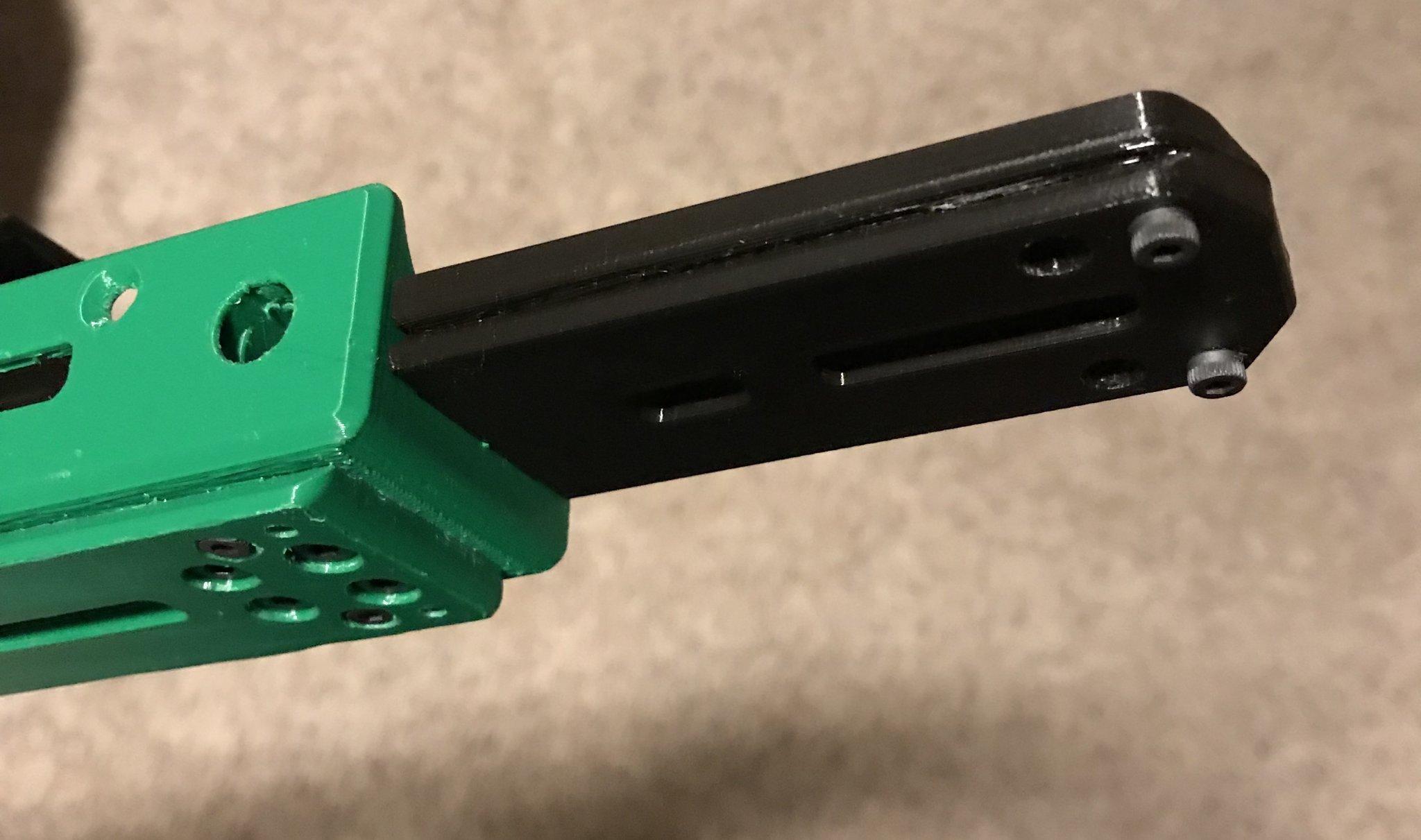

An AR grip tang is a real challenge with the bonded action, if not bonded it becomes easier to integrate like how the MPA-AT does is.
My chassis is a heck of a lot lower than the AT and AX forends, that’s a big reason why I pursued it in the first place.
I could also design a spigot mount to be flush with the bottom of the forend, and kill two birds with one stone. Still allow 16” barrels and have one continuous RRS dovetail rail.
Duh, not sure why I didn’t think of that option before!
