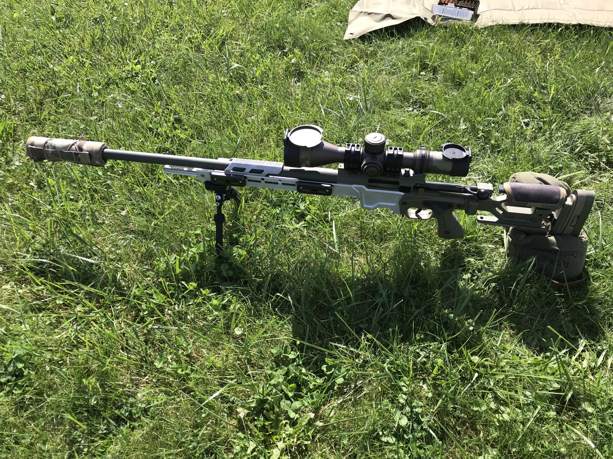

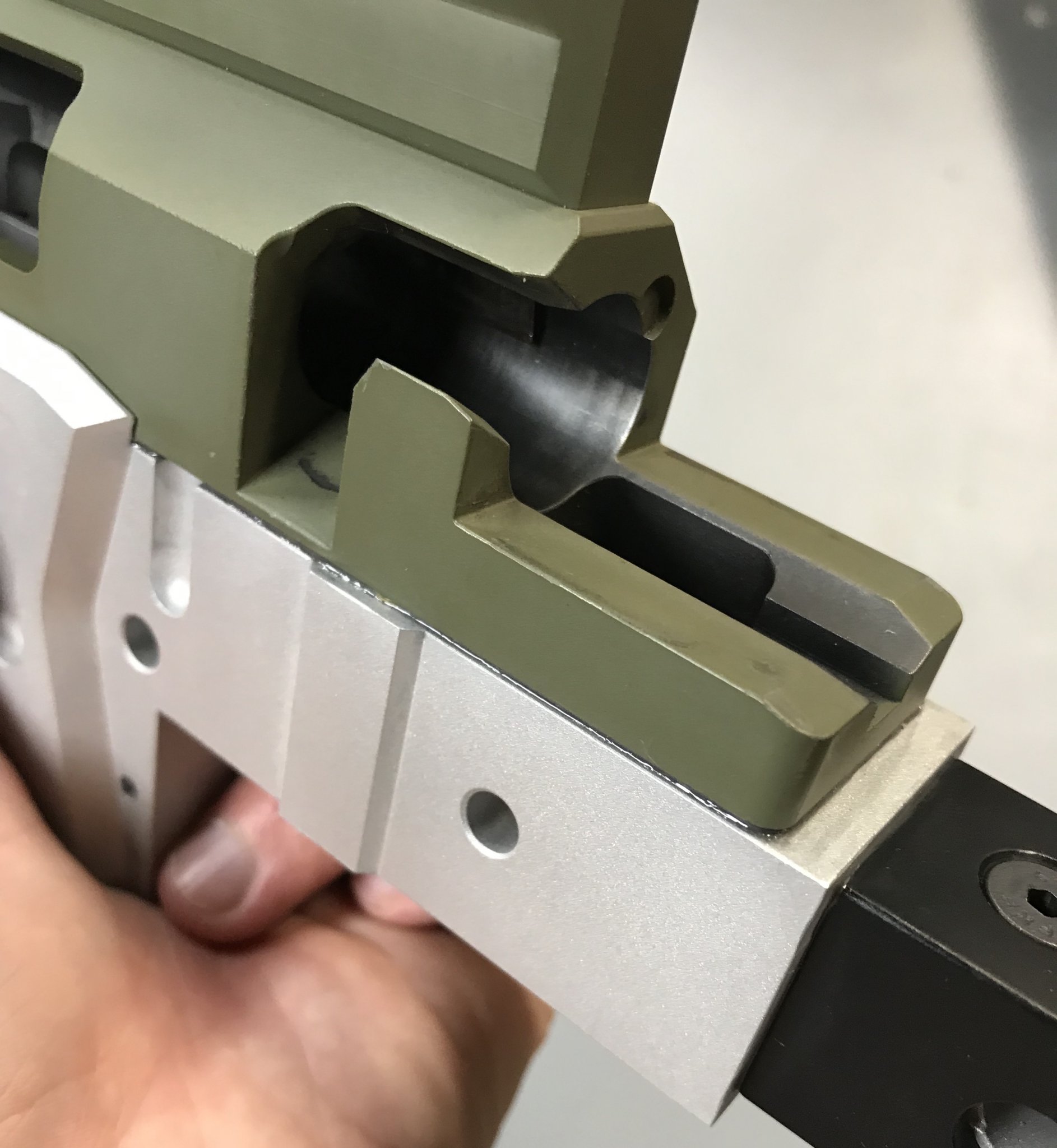

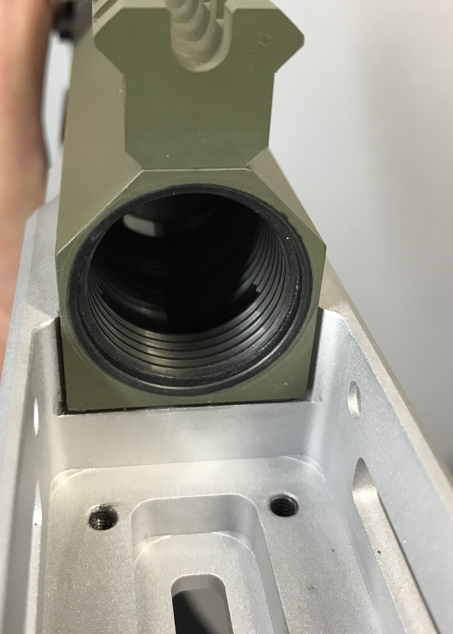

@THEIS This is what I used. It's what comes with the AX buttstock kit for installation on the AT chassis. I've also heard to use the Devcon aluminum putty, but it's $60/tub so I went with the $6 epoxy haha.
I bought some dual-tube syringes with mixing nozzles for the application. It's way too fine of an area to mix the epoxy separately and spread on with a stick or q-tip. Plus the mixing nozzle ensures a perfect 50/50 mix. Each chassis will come with epoxy and a mixing syringe for the installation.
That is impressive. I look forward seeing the video. I’ve recently bought a AT and am keen to see how your project turns out as the AT in MPA chassis doesn’t quite do it for me....
Sounds like you're already halfway there ?
What don't you care for on the AT-MPA chassis?
Bonded. Cured. Ready to rock.
I’ll do an assembly video next, and another video going over the features of the chassis. The features video I’ll hopefully get to this weekend; the instructional videos will take a while to edit.
Looks great but could do with some cerakote! Looking forward to the range report ?

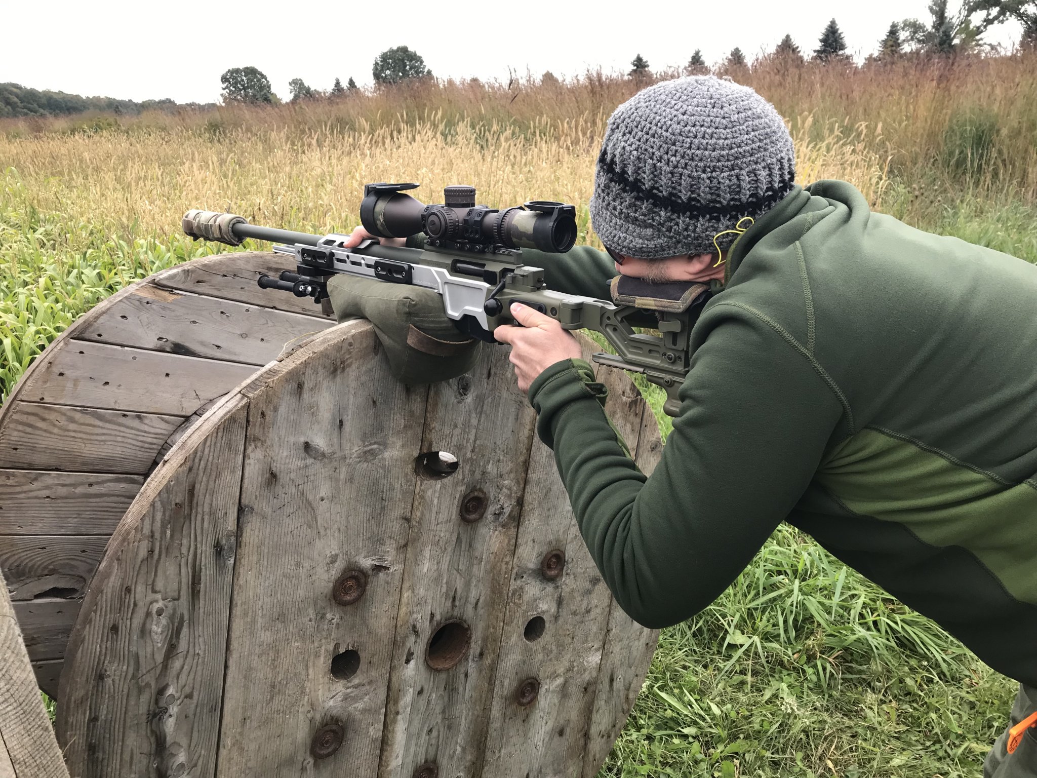

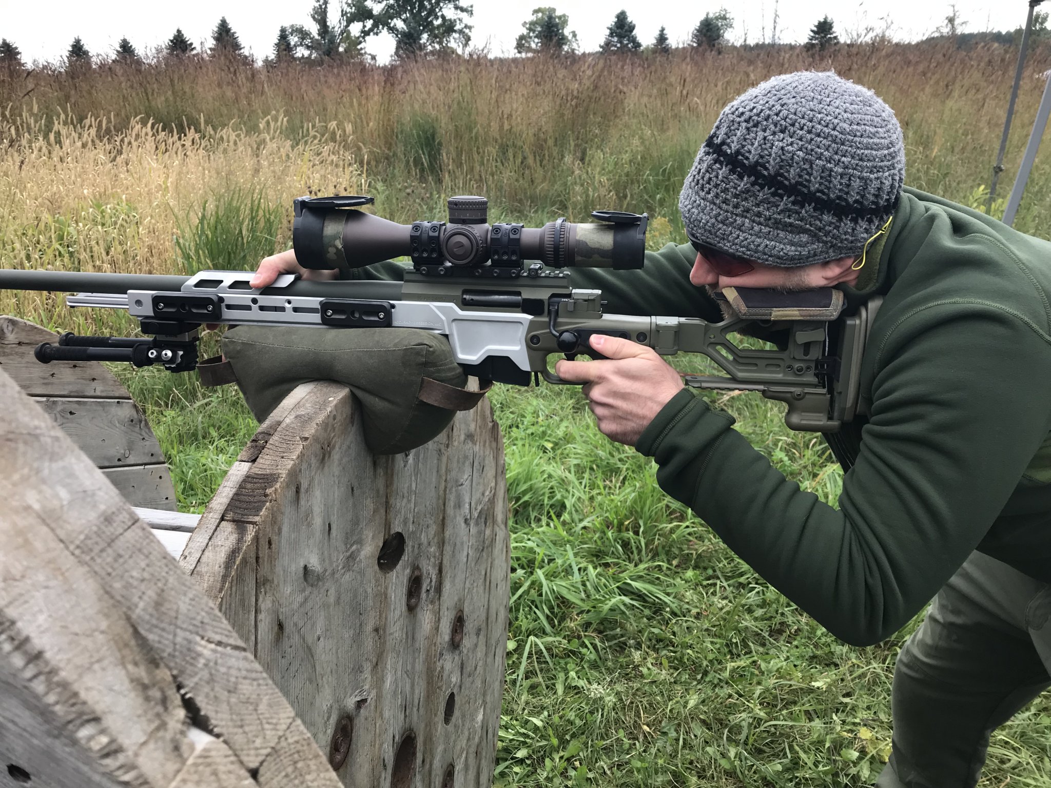

I shot my local WI club series finale, the new chassis was amazing and helped me make hits I haven’t been able to before. Especially in stages like our “doghouse” which is a cramped doghouse shed with small port hole windows.
I got 2nd in the finale, and ended up moving from 11th to 3rd overall for the season standings. I shot well, and the chassis was a huge part of it since out of 9 stages, only 2 were prone.
Feeding, firing, and ejection was flawless with my tried-and-true 6.5x47L shooting 140 ELDMs. Even suppressed I was able to hold my own against all the braked 6mm’s out there.

that chassis sits so low on that gamechanger bag. i bet it feels super stable vs sitting on the original AX chassis.
Yup, feels like a totally different rifle. I have shot AI’s exclusively for the past 4 years; an AT for 2 years, then an AX the past 2. After one match with the new chassis I have a much better understanding why guys love shooting and do so well with MPAs, ACCs, KRGs, etc. This style of forend, magwell, and rifle balance just works so much better as a dedicated comp gun.

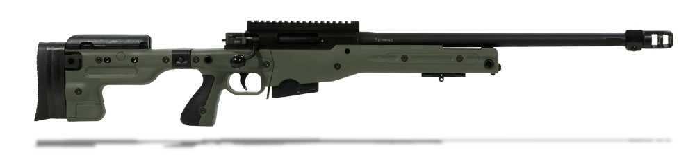

As long as we're in discussion of AT vs AX conversion... Anyone confirm usage of AW mags with AT? I'm assuming no AW cut on AT so limited to AICS mag??? Hence only the double stack AW's on the AX?
This ^^^.
The Obsession chassis has the same magwell dimensions as an AT, but has a much larger flared opening for easier loading. It will use standard AW mags without issue.
The AX uses AX magazines, which are essentially an AW with a small metal lip on the front face to facilitate rocking into the magwell. Loading an AX into the magwell is amazingly easy, but I abandoned that design for this chassis because it takes up precious real estate in front of the magwell, and makes it require RH and LH specific chassis.

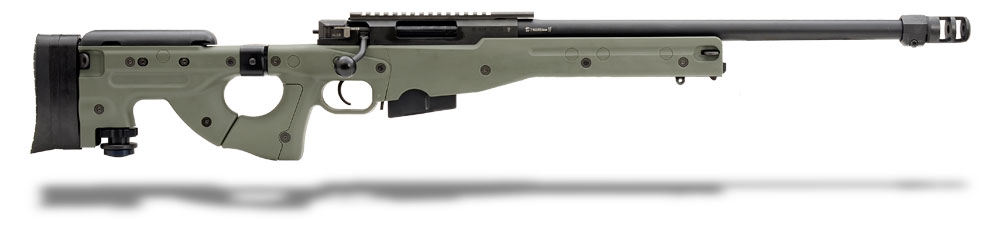

Wonder if the foot print from the AW changed going to the AT... I've got an AW that sees less use these days but is a fantastically accurate rifle.
I’m pretty sure it’s the same. Main difference is the AW doesn’t have the quick-loc barrel change feature, so barrel swaps would need to be done with a barrel vise out in front of the forend (basically the same as you would do now anyway).
AWs have a 3 lug bolt, whereas the newer AT (almost always) and AX have 6 lug bolts.
AWs have the older style trigger:
AW:
AT:
AW:
AT:

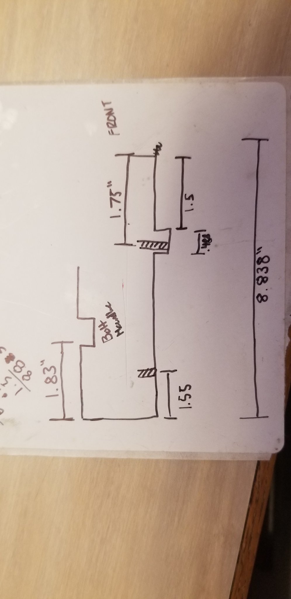

Yup. I’m talking about the action to chassis interface; i.e. recoil lug and dimensions of the four action screws. I believe the AW, AT and AX are the same, but I haven’t had an AW in hand to confirm. I think the Comp Trigger is even a direct drop-in to the AW.

If I take some rough exterior dimensions like action face to lug and screw distances, would you be willing to compare and estimate compatibility?
Exactly, the "footprint" if you want to call it that. From pics it looks similar in arrangement and roughly speaking dimensions. But once they change it to add the quick lock tensioning system they might have altered other aspects. I
Definitely. Let me know some numbers when you have them in hand and I’ll be able to tell you really quickly if they’re close.

Quick measurements on an 09 AW
I'm 99% sure that's the same. The front recoil lug and screws are looking good. I don't have that measurement from the rear of the action to the rear screws. It's a bit tough, but can you measure the distance from the front action screws to the rear ones (center-to-center)? I've got 5.5" for that distance. If that's the same then I think the AW is good to go.
EDIT: Derp, did the math from your print, that distance is 5.538" so I'm guessing that's close enough to count.
Could the dimension be 5.512” (140mm)? That seems to make the most sense.
Yep, action screws are exactly 140 mm between centers the long way. Front are 19mm apart and rear are 23mm apart width wise
You’d think so, but detailed inspection of multiple stripped chassis with pin gages would suggest it’s not all in metric whole numbers. There’s enough clearance that 0.012” gets lost in the fray, but it’s really hard to get a perfect measurement from a screw in a countersunk hole.
Ya I've run into weird mixes of dimensions on products I know are metric being right on an inch even/whole number. Not fasteners, but spacing and thicknesses etc.
