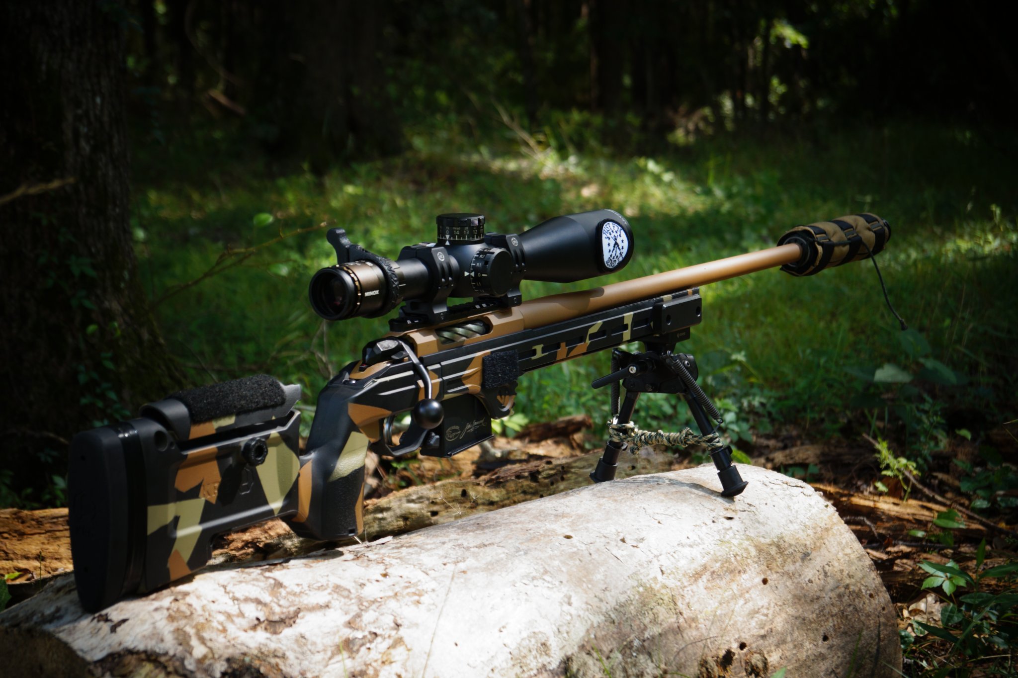

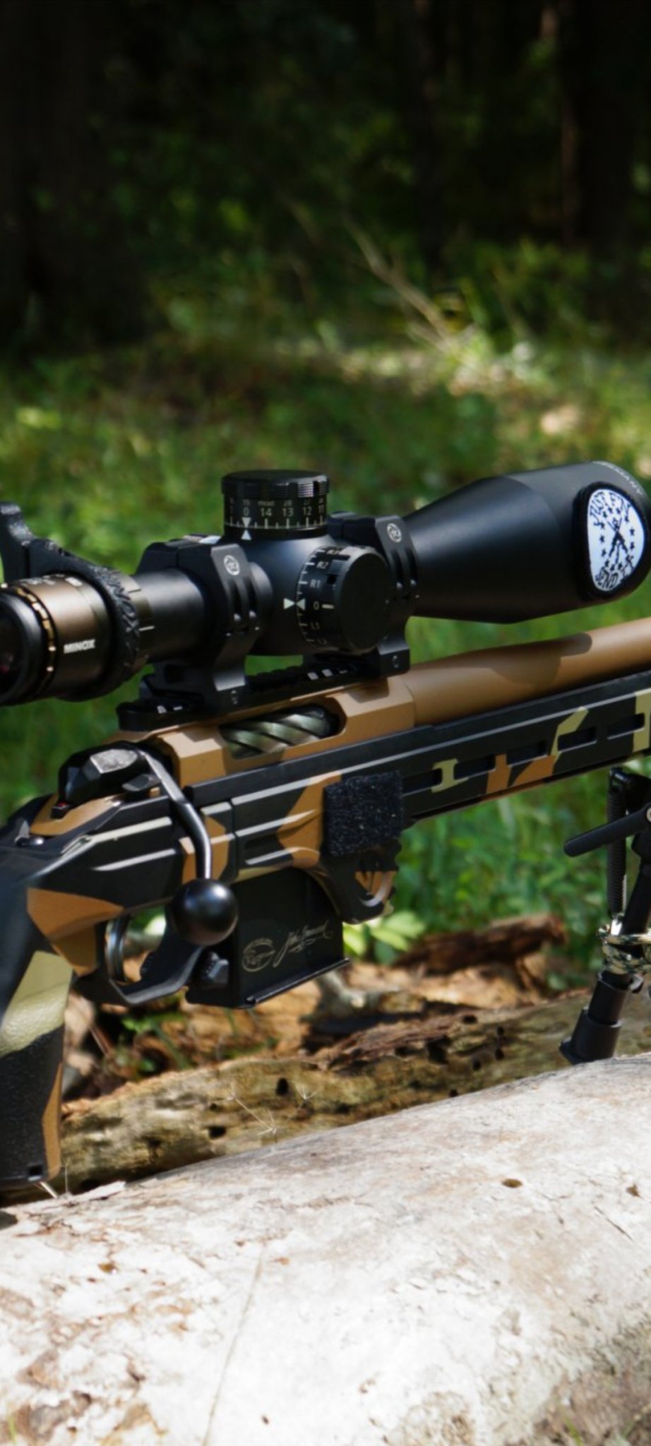

Since we're talking Vision/KRG shit, I realized I never posted these pics in this thread.

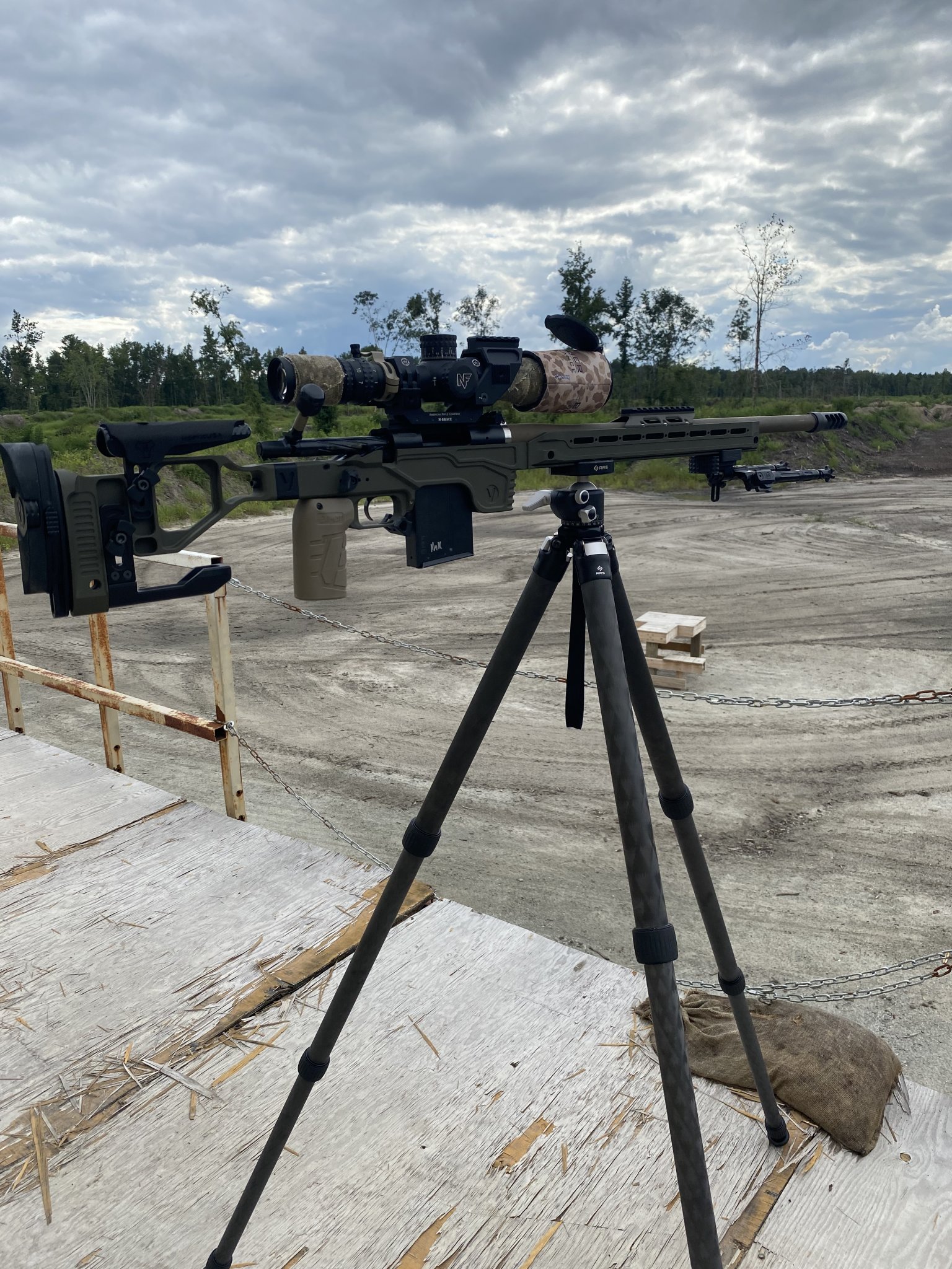

This is hands down the most comfortable and ergonomic chassis I’ve used. It checks every box modern chassis should have. I was waiting for the AT-X chassis but in my opinion this does all the same things and then some. Definitely going to pick the folding hinge but overall very happy.
