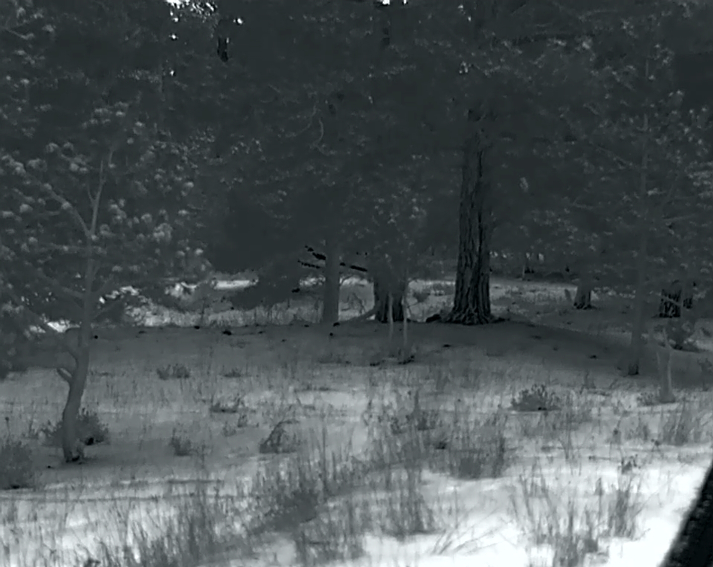

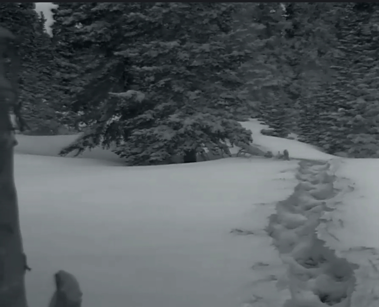

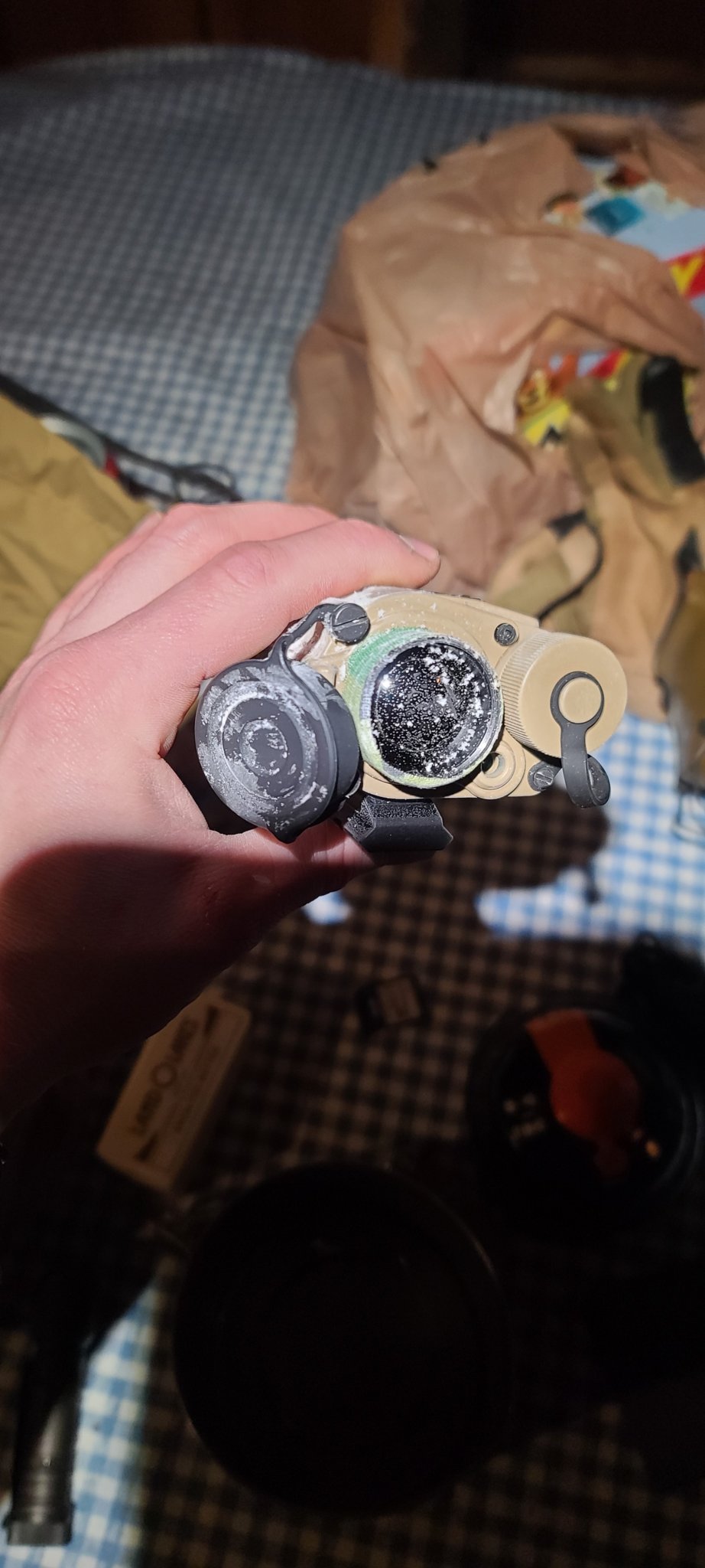

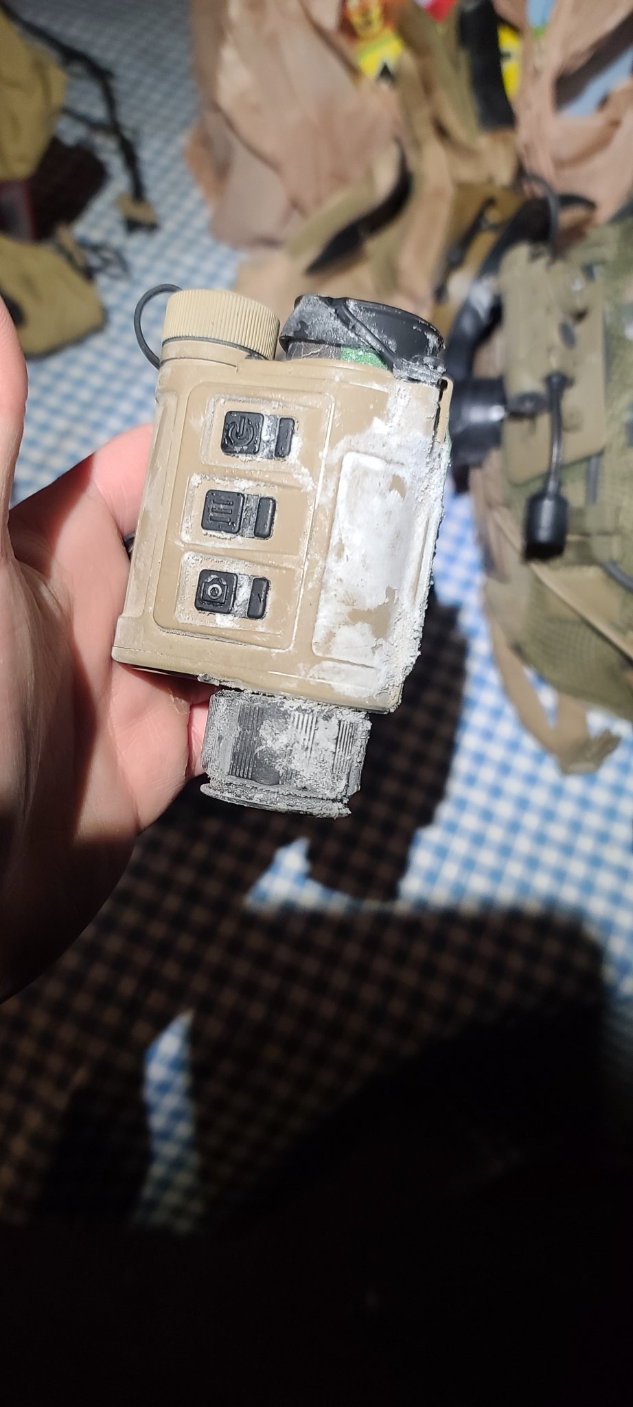

Did some cold weather testing of the RH25 last night as part of my review I'm working on right now. Everything worked as it was suppose to when other piece of kit failed at those temps (below -30F). No stuttering of the automatic nuc'ing, no screen flickering, no weird abbrations...nothing. I have seen cheaper Chinese units fail in these conditions myself (even more expensive units too), but this one held its ground and worked just as well as it would have at room temperature.
I included a picture through it showing the image quality at that low of temps and with a frosted up germanium lens as you see in the other picture.

The display will be filled up completely at around 1.75x optical, and heavily degraded past 4x optical in my testing with a Vortex 1-10 Razor. You'll see between 1.5 and 1.75x optical with most LPVOs with varying FOVs for all corners of the display to dissappear.
Hecque, I'm more impressed that you didn't fail. (y) :oops:
-30, nah, I'll take a hard pass and sit by the fire drinking some coffee. :)
Good layering systems and some grit goes a long way 🫠. Figured thr best way to test the lower temp ratings of these things...is to use them at those temps 😀.

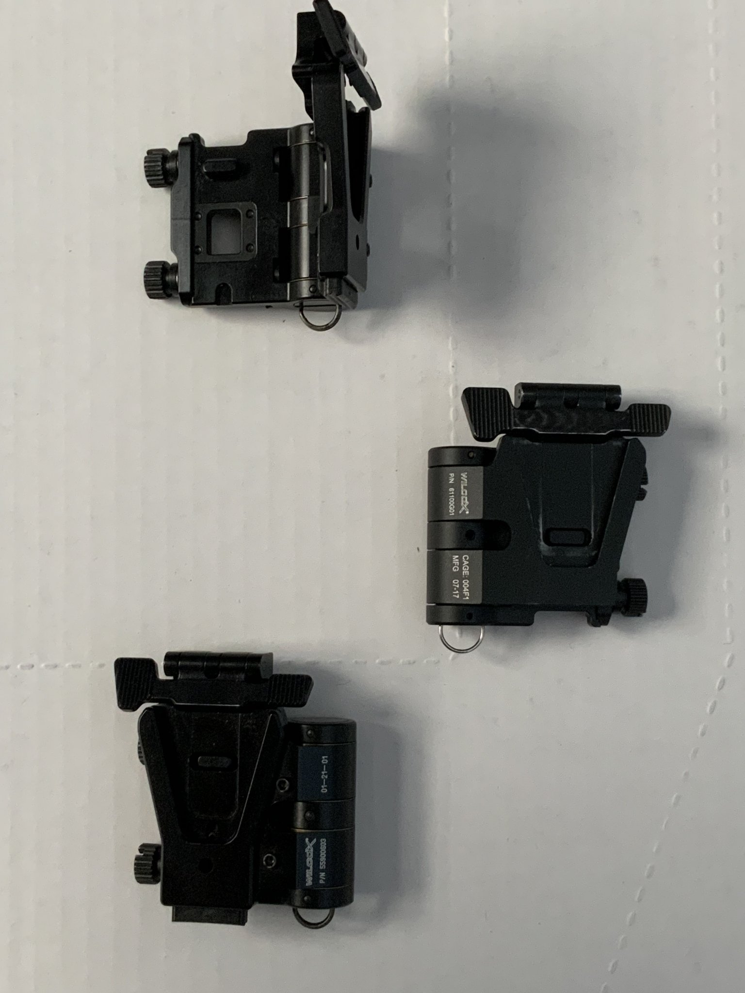

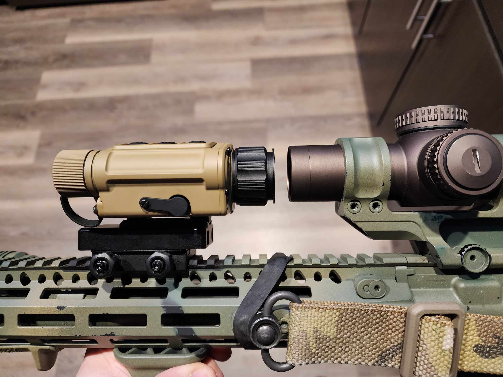

For those that have used a Wilcox FTS mount with the RH25, I have a question…
Say you’re walking a creek for raccoons and using the RH25 as a scanner, is the return to zero of the FTS mount sufficient enough that you could clip the RH25 into the FTS mount on a rifle to shoot something? I know that’s not the whole purpose of the FTS mount originally, but I didn’t know if it was rock solid, or just not usable in that regard. A QD mount would be fine, but in the dark it would just be easier to slide it in a mount rather than finding the correct pic slots
I have and do use mine as a scanner then throw it back into the FTS and make neck shots on deer at 400yd regularly. same as I did with the ADM mount. My current use is on a 13.5 .308 MWS in front of a Razor 1-10.
In my testing, I don't fully trust it to return to zero. I tested the FTS mount with the RH25 in it (with an experimental prototype interface) and it did lose zero unlike the voodoo s.
Good info. I’ll maybe just have to test it myself and see. The more digging I do, the more I find about slight variation there is in FTS Mount tolerances. Some guys say theirs is tight, some guys say they can tell it’s a little loose.
The annoying thing is that there are a number of sources for this potential return to zero problem:
  1. Picatinny to FTS mount: if properly tightened, there shouldn't be any play in this interface. Since the FTS mount is not removed during the testing, this interface shouldn't affect return to zero.
  2. FTS mount mechanism: there could be play in the FTS pivoting mechanism, but it's hard to diagnose. If the identical mount has no issues with one thermal but with another, it might not be the mount.
  3. FTS mount to RH25 rail: this is a dovetail interface with conical surfaces in two dimensions. Unless there's dirt/debris preventing the dovetail shoe from seating properly or if the dovetail shoe is too small and the FTS locking lever bottoms out, this interface should be self-adjusting and always tight.
  4. RH25 to rail interface: if properly tightened, there should be no movement here either. The conical shape of the threaded bosses on the RH25 body always centers the rail when the body screws are tightened. Additionally, recoil is absorbed through a proper form fit with the housing, not the screws.
  5. RH25 internals: hard to diagnose.
