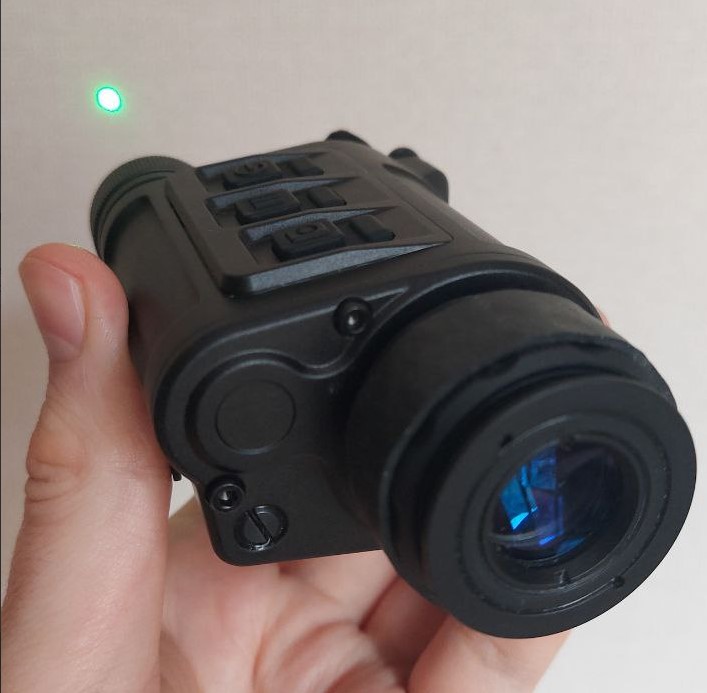

OOO!!! It works!
Very cool green laser

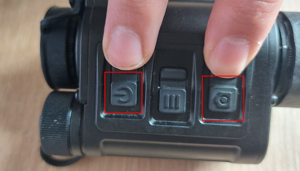

I found out how to turn it on; you have to press the power button and photo button at the same time when you are NOT in the menu.
I took a picture of the buttons to press and hold at the same time.

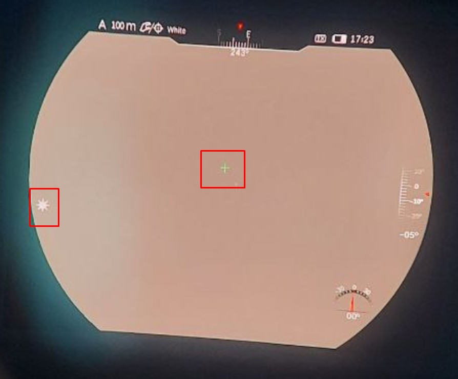

Also attached are a picture of the laser crosshair display and the indication of its work in the interface

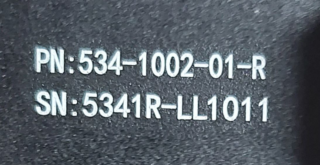

what is the part no. / sn etc on yours ? some must have laser and some not i guess
pn:536-1001-01-a
sn:5361a-li1008
from european supplier wonder if there are other differences ?
