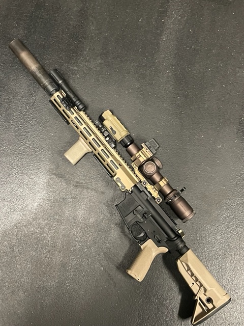

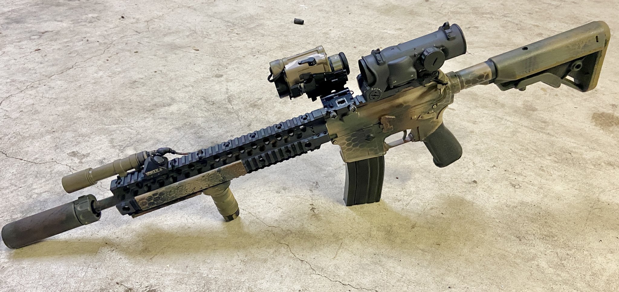

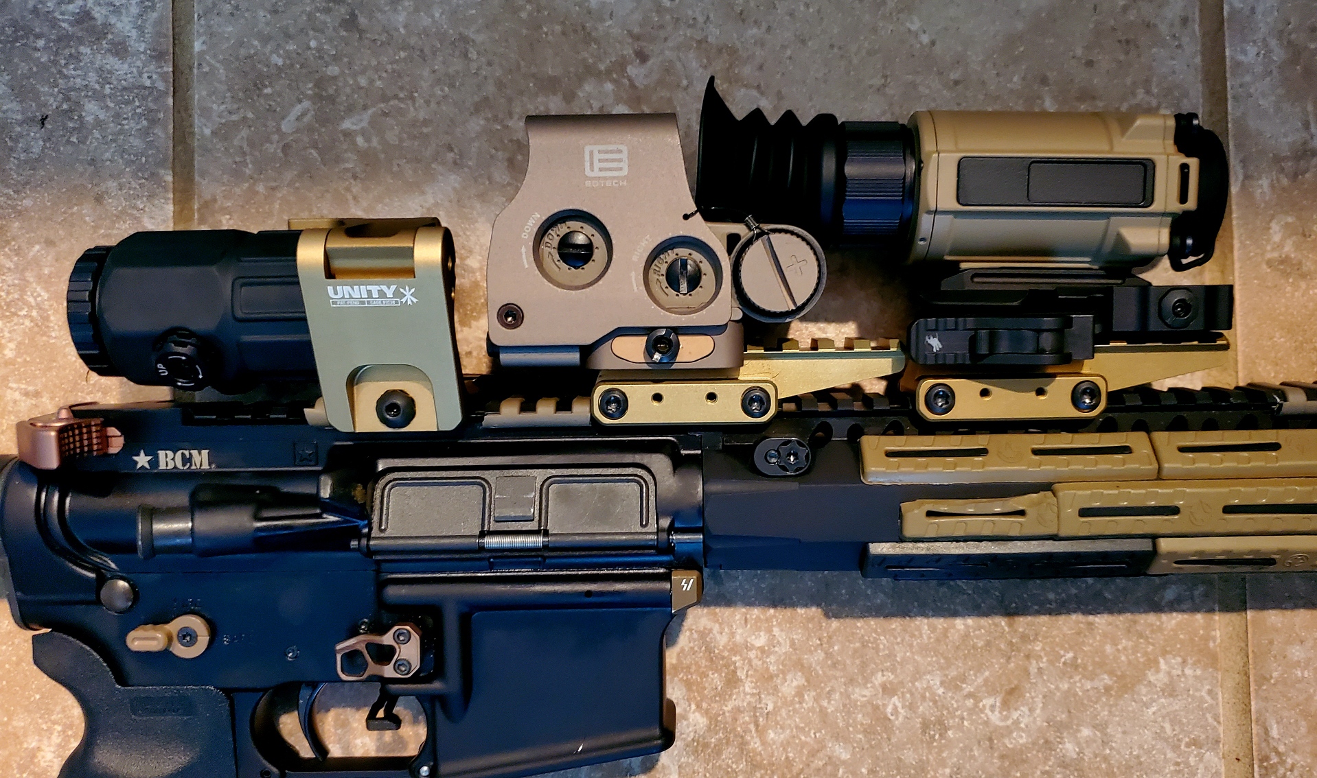

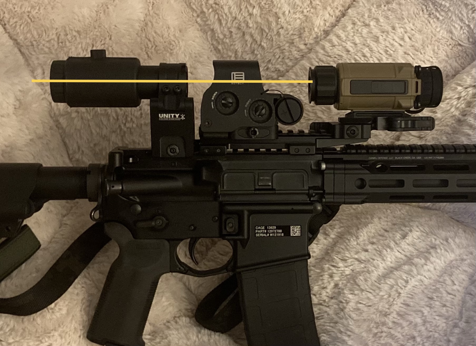

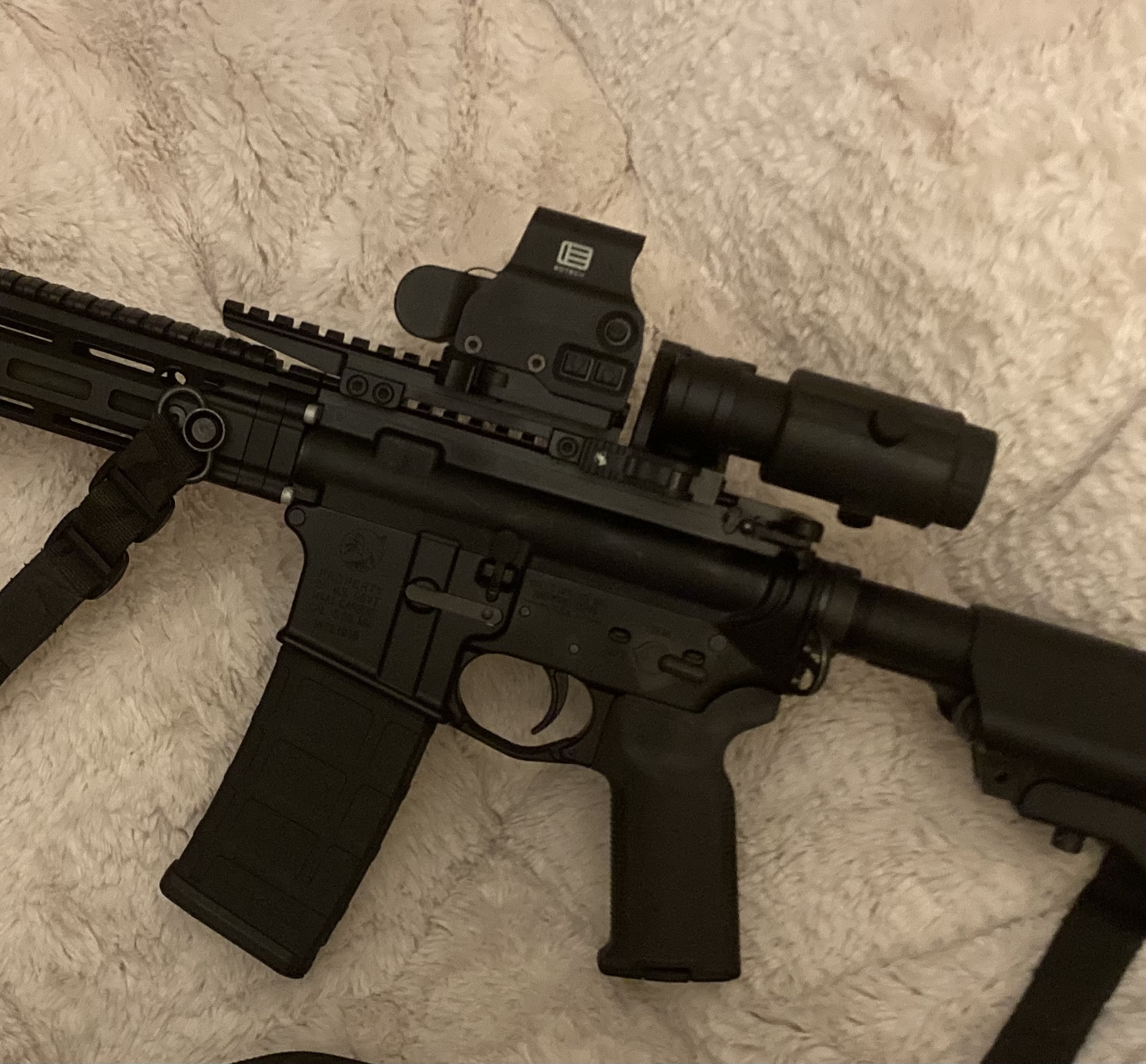

Here’s the best mounting solution I could figure for Clip-on in front of EOTech/Magnifier on Unity 2.26” mounts.
Is there a better solution?
I used a kinetic development group sidelok riser (0.62” riser) below the RH25 ADM mount.
Fit without a single rail slot to spare (LMT 9.25” MLok rail/monolithic upper)!
it’s usable but its obvious an LPVO would be better.

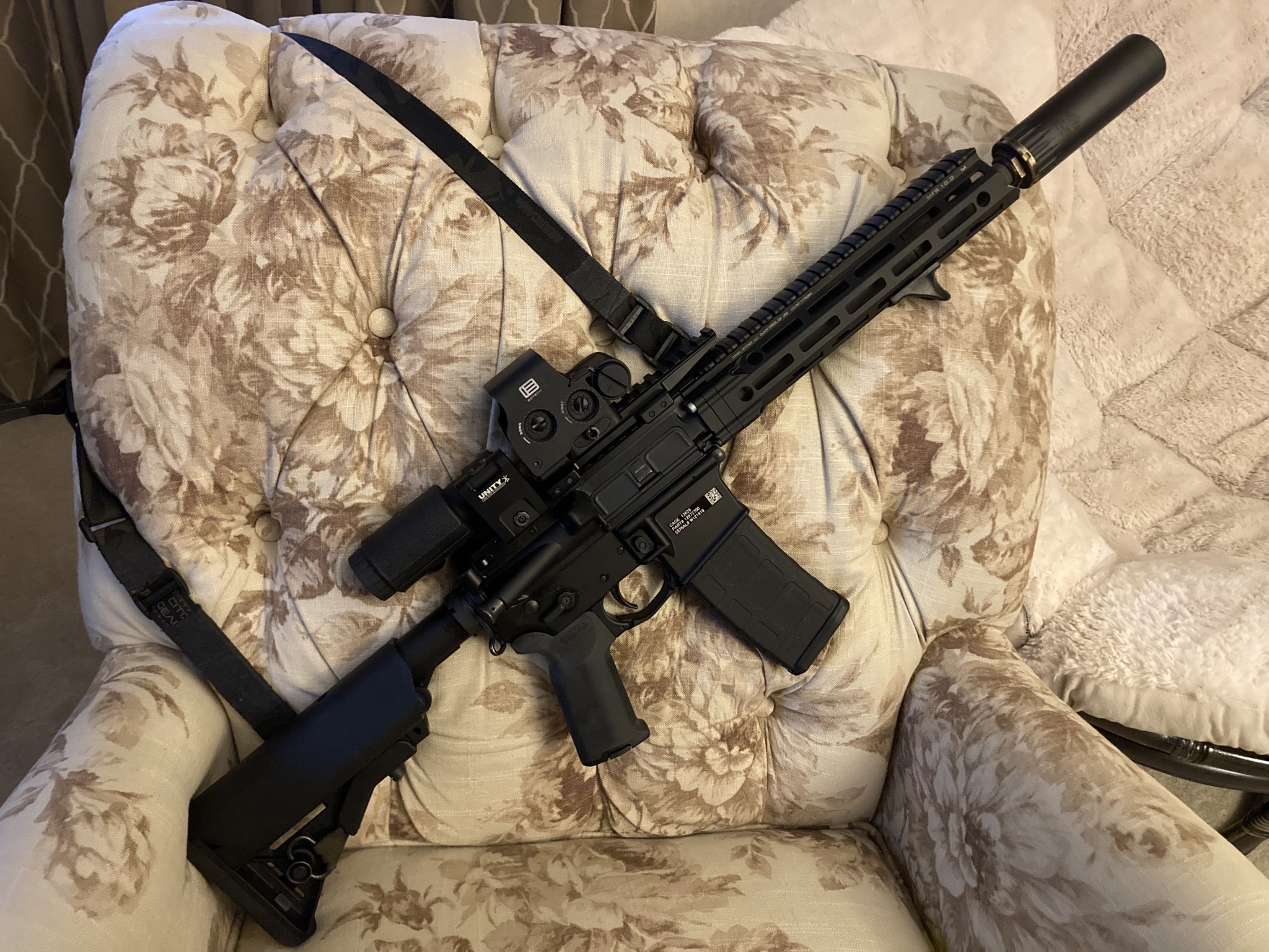

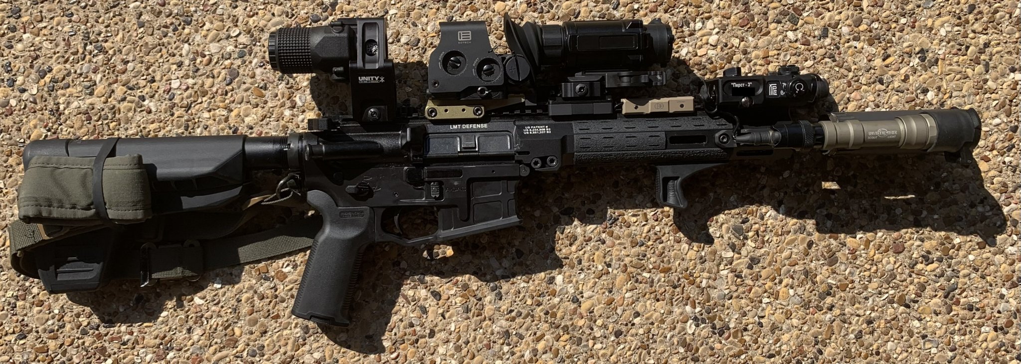

@thorium
Bobro double decker is just long enough to hold an EXPS & RH25 and lines up awesome with a 2.6” Unity FTC magnifier mount. It fits an AR15 upper with the Unity magnifier and no slots to spare. The Bobro DD is technically 0.625” instead of the 0.665” on the Unity riser, but since the EXPS is notably taller than most every other “lower-1/3” optic it’s a perfect match. The EXPS+DD is ~2.31” to the window center and the RH25+DD is 2.24” to the ocular center… so within about 1mm of being perfect for a 2.26” magnifier.
You might be tempted to use a LT-101 5/8” riser because it’s cheaper, QD, and has lugs… but it’s not long enough. It got 2 fewer slots than the Bobro so the EXPS and/or RH25 hangs off the end(s) of the rail.
It’s very clean and purposeful looking and puts everything on the receiver so there’s no rail flex to worry about messing with zeros. I’d like to switch to a newer-style compact magnifier because mine hangs off a good bit, but the PA Gen IV LER 3X magnifier is pretty hard to beat for $99. It’s worth noting the Bobro Double Decker lacks true recoil lugs on its underside… then again it’s got 4 screws. It just seemed like a pretty basic design oversight (or lazy) for not a cheap part. But I’m not worried because once torqued properly it’s not going anywhere with just AR15 recoil.

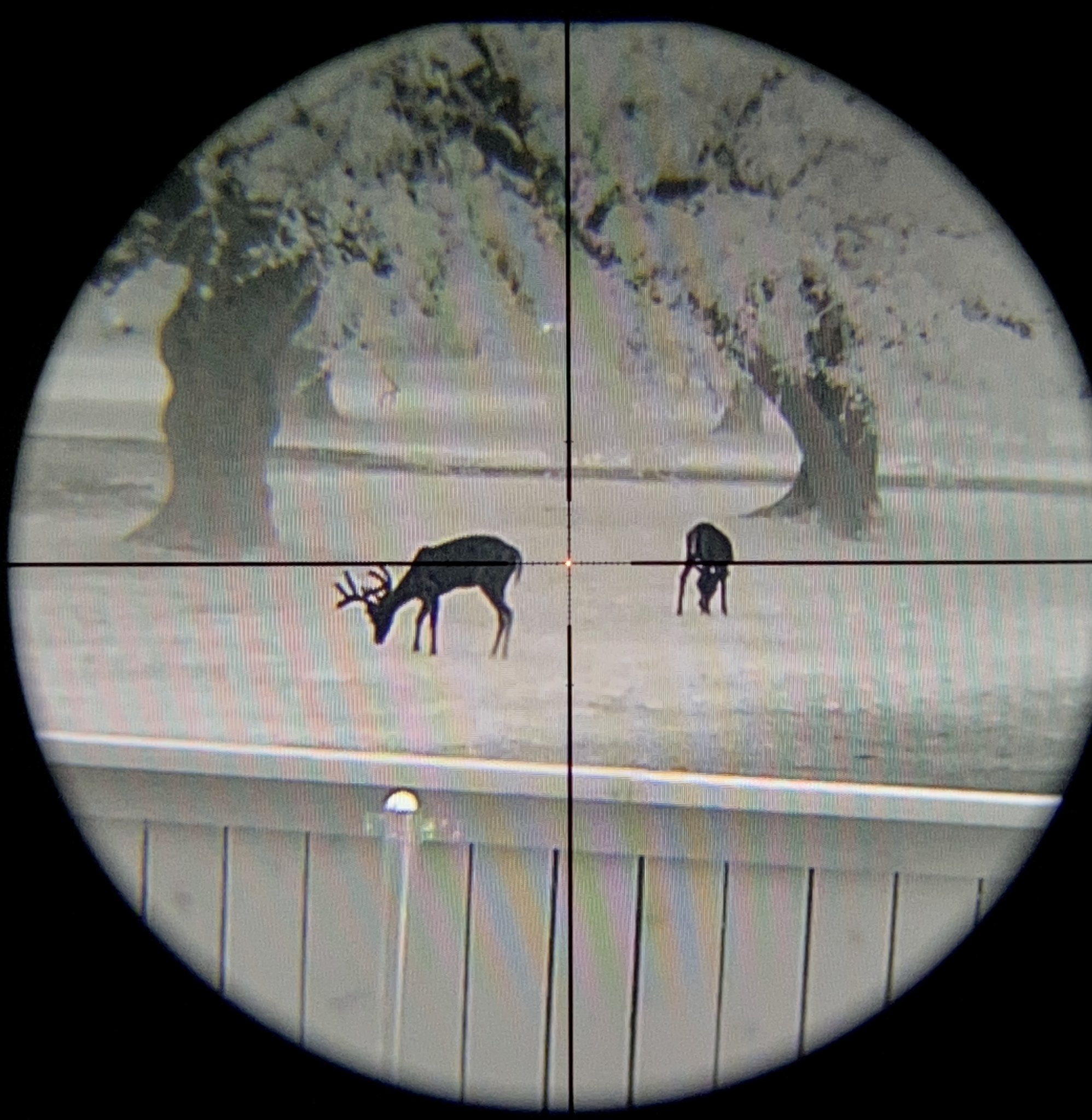

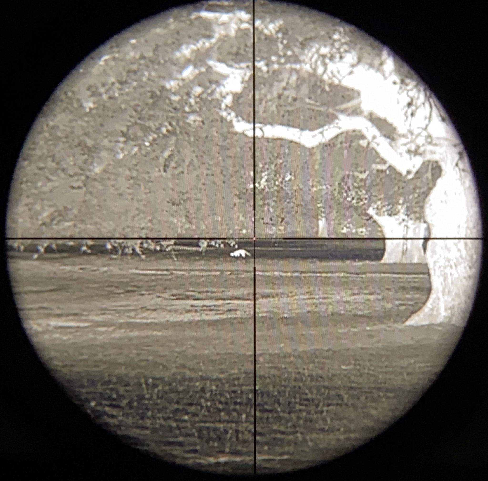

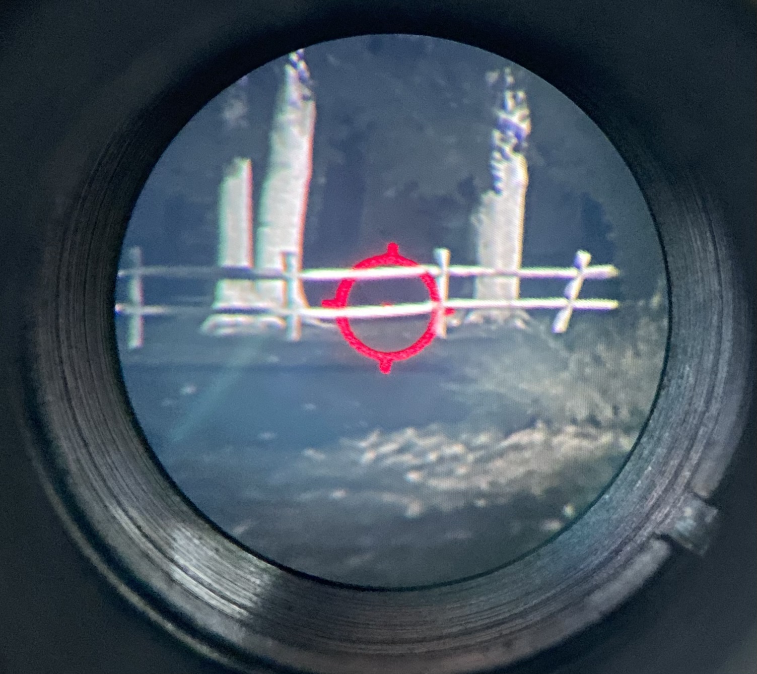

Excuse the blurry scope view, the camera was focusing on the eyepiece. It’s really crisp an you can even see the tree bark clearly with your eyes.

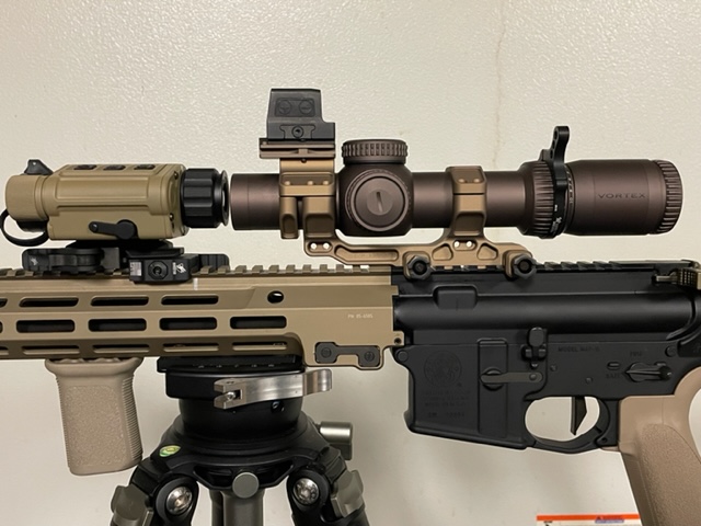

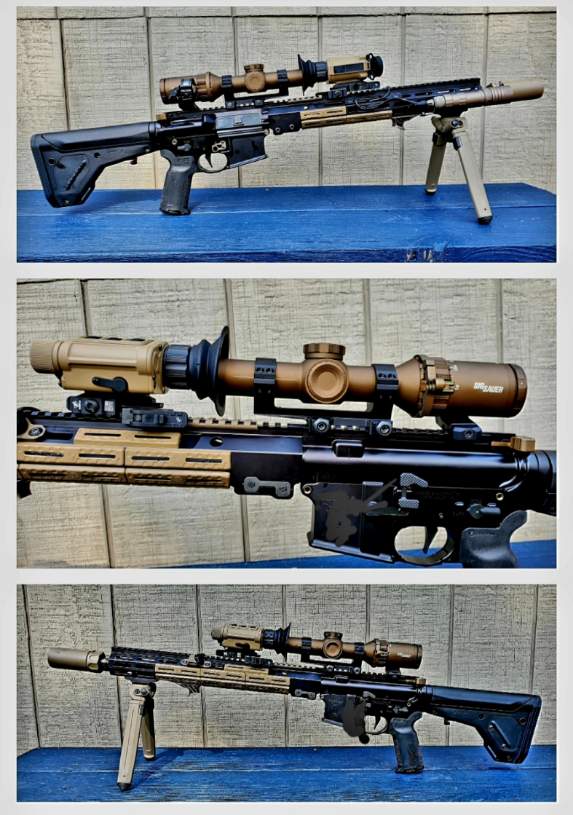

Thinking about buying one of these as a clip-on in front of a LPVO.
I have a VX6HD with the cds-zl and a burris 1-8 XTR II with the mad turrets so that I can dial but I'm thinking about getting a vudu 1-10 since it also had expose turrets with zero lock.
Would it really make a difference to go to a 10x top end behind the RH25 or not really since it'll be blurry past 4x anyways ?

I have the Vudu 1-10 that I use with mine multiple times a week. I love it. Obviously anything past 4-5x isnt useable.
Sounds good. I might just keep my VX6HD then since it’s pretty flat, light weight and has 120ft FOV at 1x.
I’ll get a Vudu 1-10 down the road for sure
Is is really that blurry past 4x ? Like I understand that you’re zooming on pixels and that it gets pretty dark past 4-5x on a 24-28mm tube but I thought you could still shoot at like 8x, just that’s it’s blurry. Is it truly unusable ?
I've used it on 10x at 500 more than a few times but your shooting at minecraft animals lol
If you want a clip on that supports 8-10x, the Steiner C35 has a much more narrow FOV (tighter pixel density) and I think it’s been on sale recently for less than half the RH25.

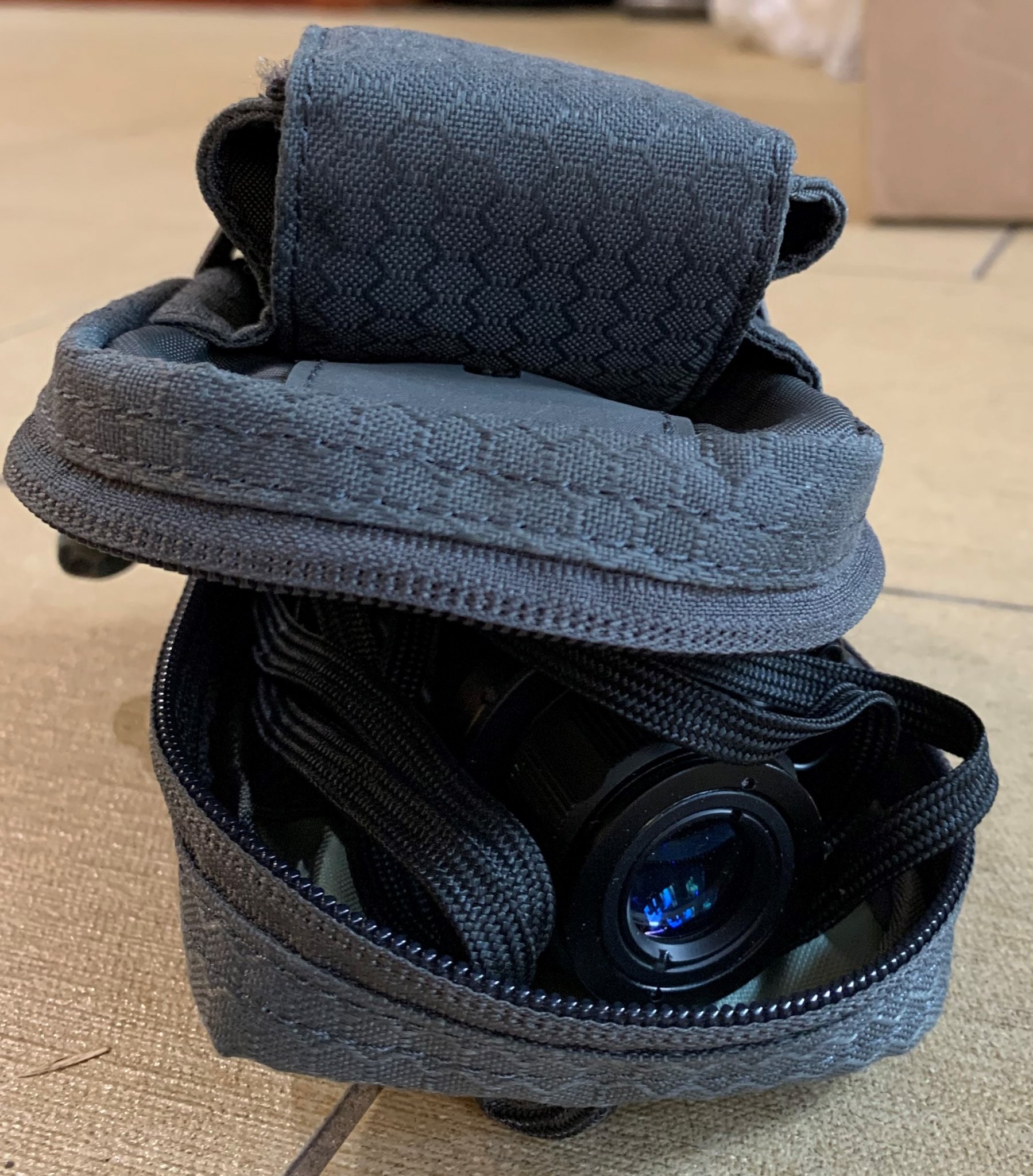

Exactly… I want a MOLLE pouch that fits the RH25 or PVS-14 so I can swap units and stuff from running dual -14s to dual band. Maybe like 1/4-3/8” padding with a stiffening liner. And snap or buckle closure.

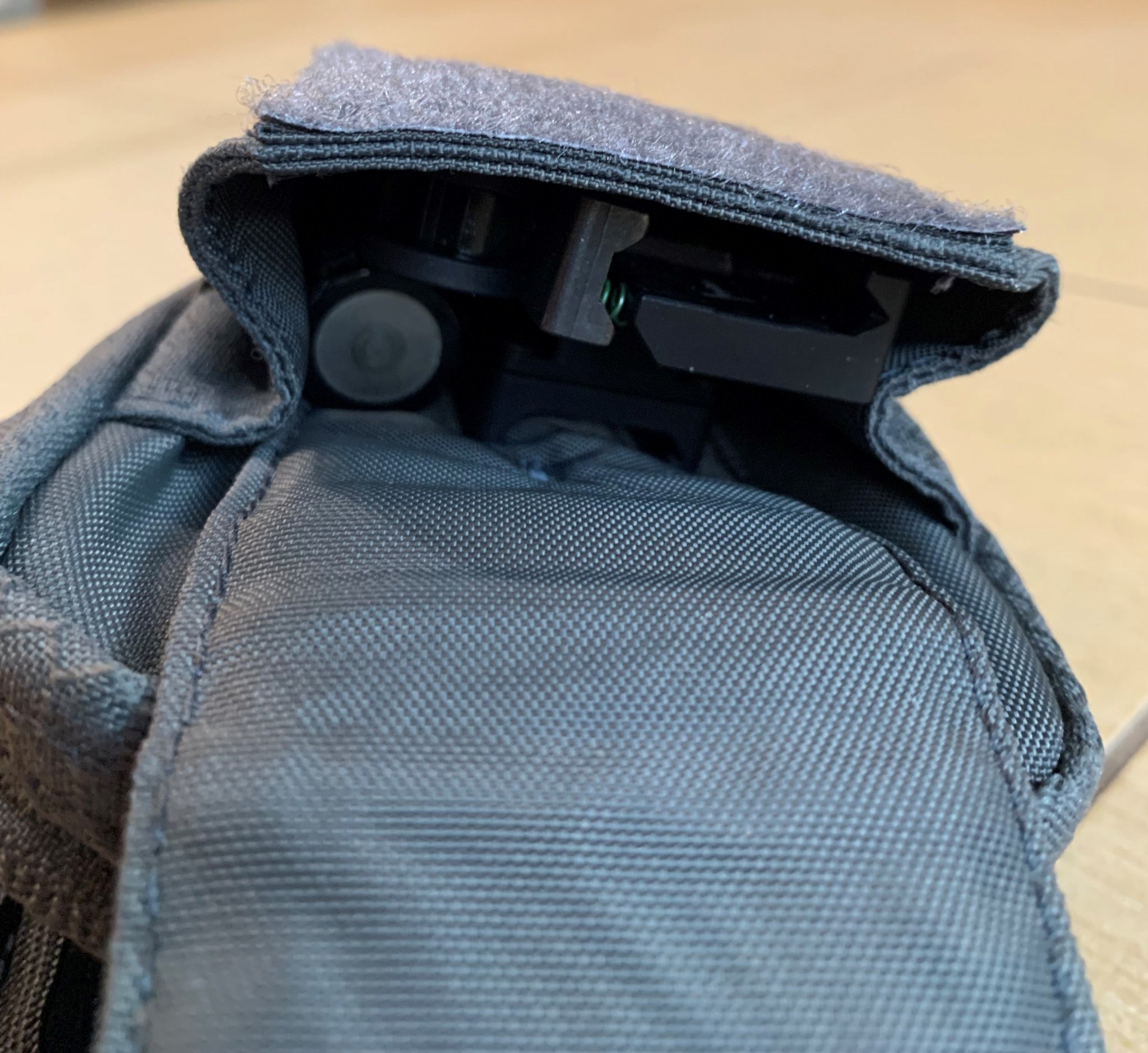

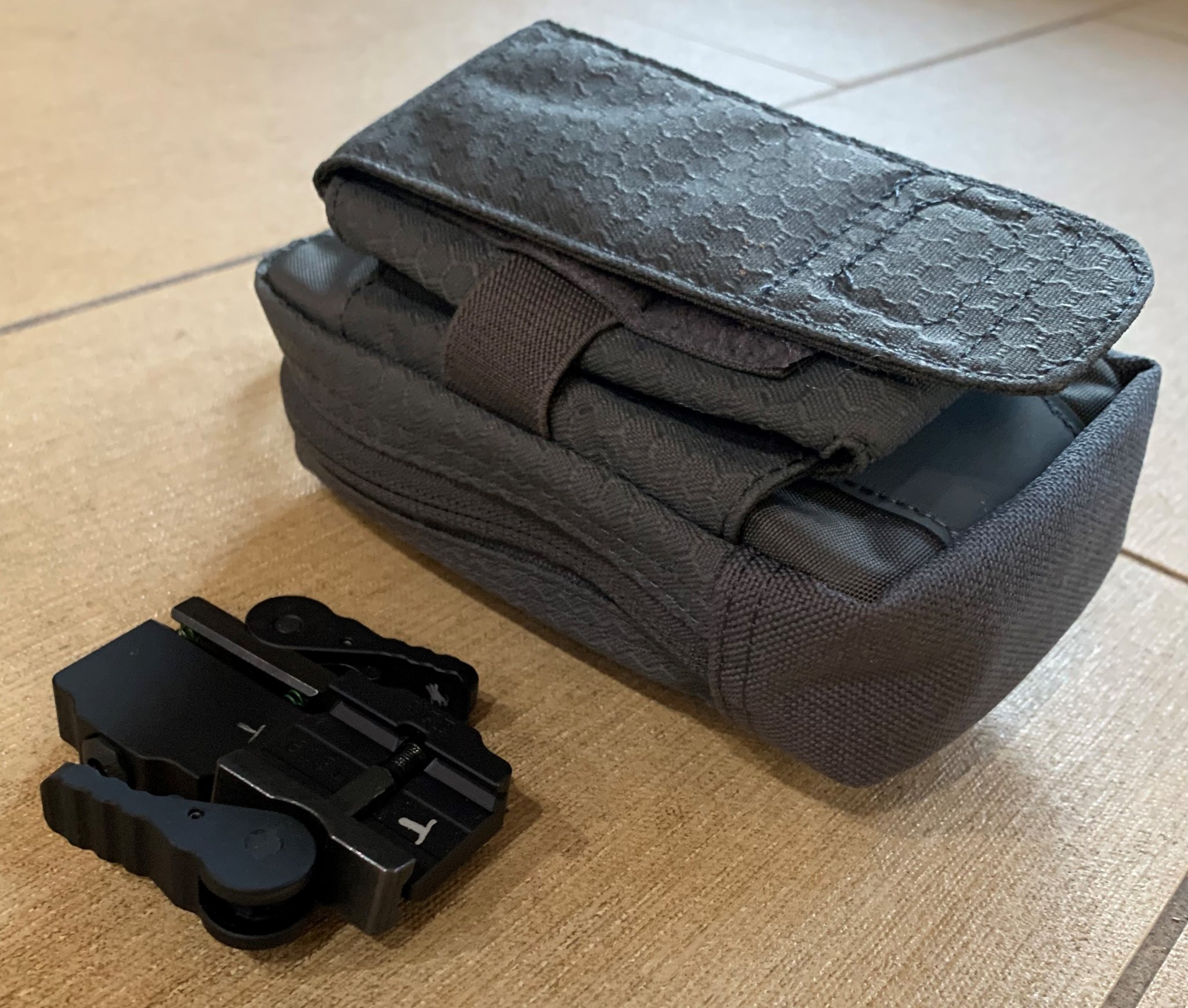

I got a couple pouches to try and the Maxpedition PUP (phone utility pouch) is working pretty well for me (~$30 on amazon).
The RH25 fits snugly, the main pocket has a small amount of padding, the outer pocket (designed for a smart phone) works to store my MDQ (pic mount) and an extra 18650 battery.
I also tried a Maxpedition MPP (medium padded pouch). I use that pouch for binocular night vision (DTNVS) which will barely fit into MPP. Its a big too big for RH25, it will move around a bit. But if you wanted more stuff than just the RH25 in the main pocket its an option.
Maxpedition PUP Pouch w/ RH25 in it and nothing in front (phone) pocket. MQD mount for size reference.
MQD (clip-on picatinny mount) & extra 18650 in front phone pocket
RH25 fits good won't flop around.
You can fit it with rubber eye piece, but the rubber eye piece will get squashed in so you wouldn't want to store it that way long term.

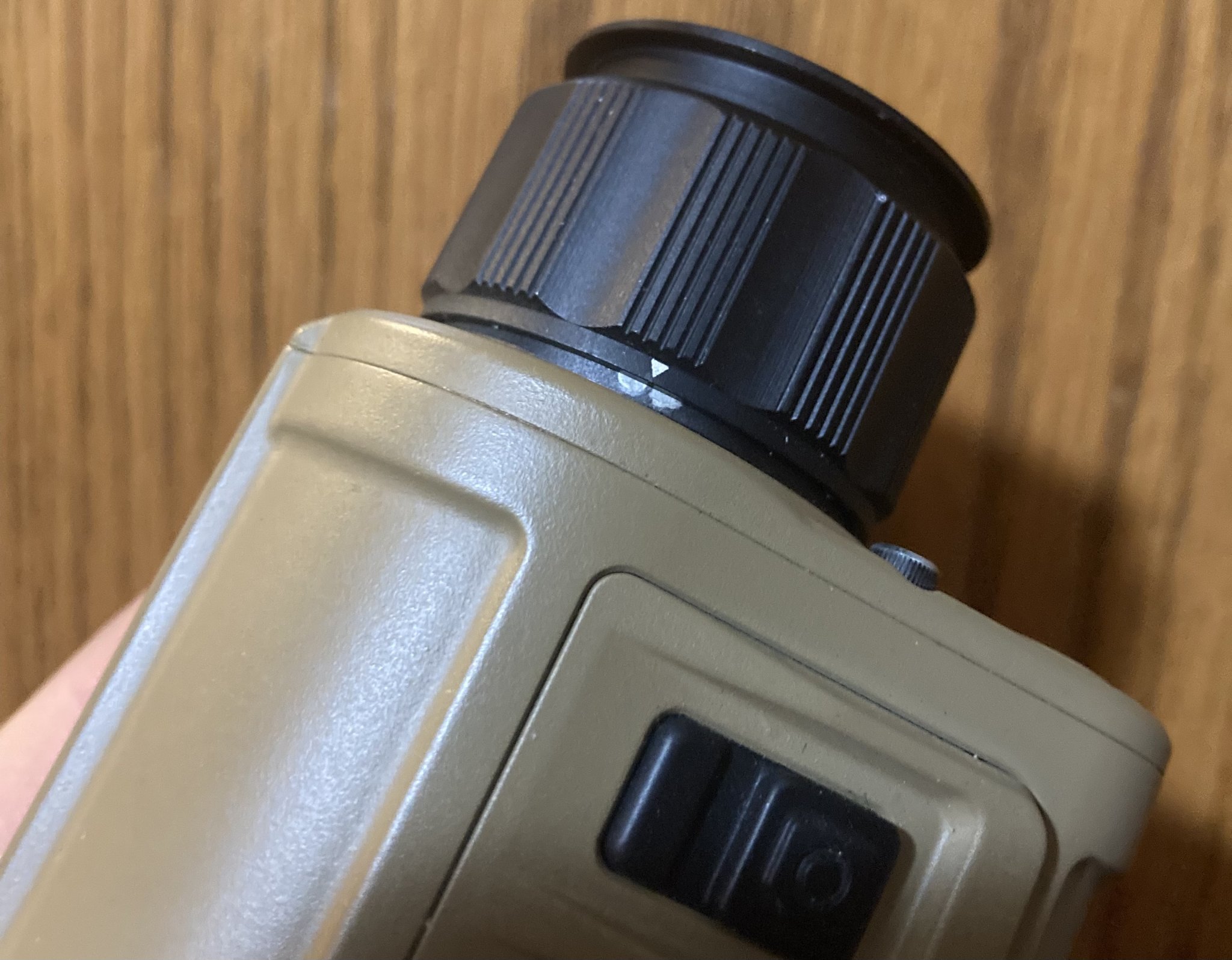

Currently have the RH25 for evaluation through the weekend. Definitely having some trouble getting the clarity that I see you guys are getting.. I'm running it in front of a 1-10 Razor and 3x Aimpoint magnifier through a T2. Might I have to adjust something in Clip On mode? Brightness or contrast setting?
Any thoughts would be appreciated. Need to decide this weekend if she stays or if she goes.
Reactions: mikefraz

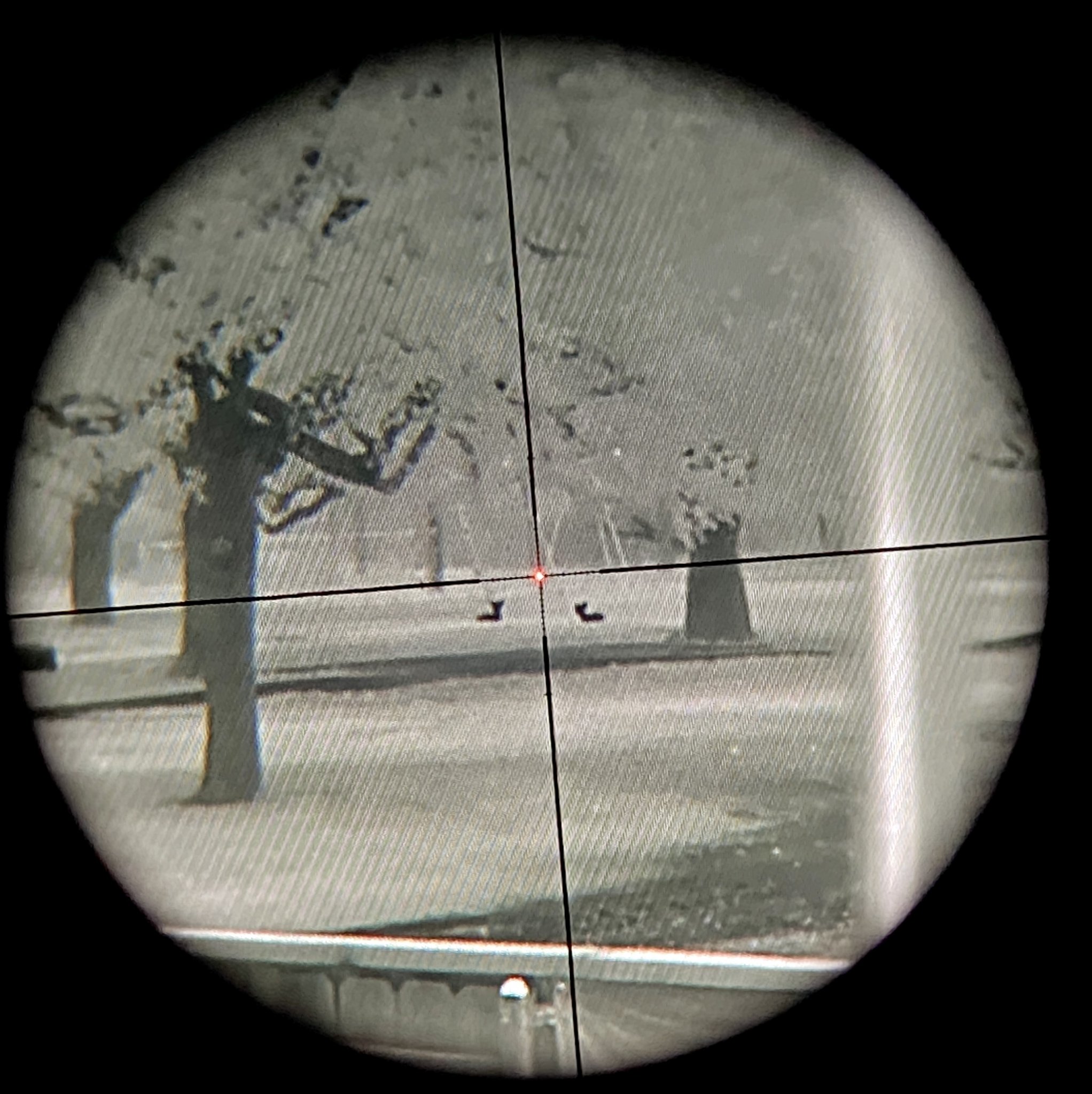

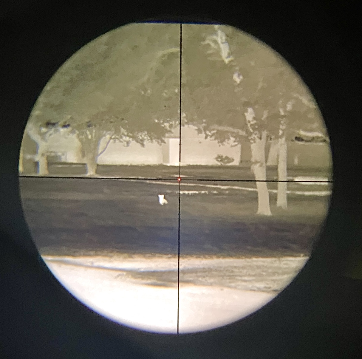

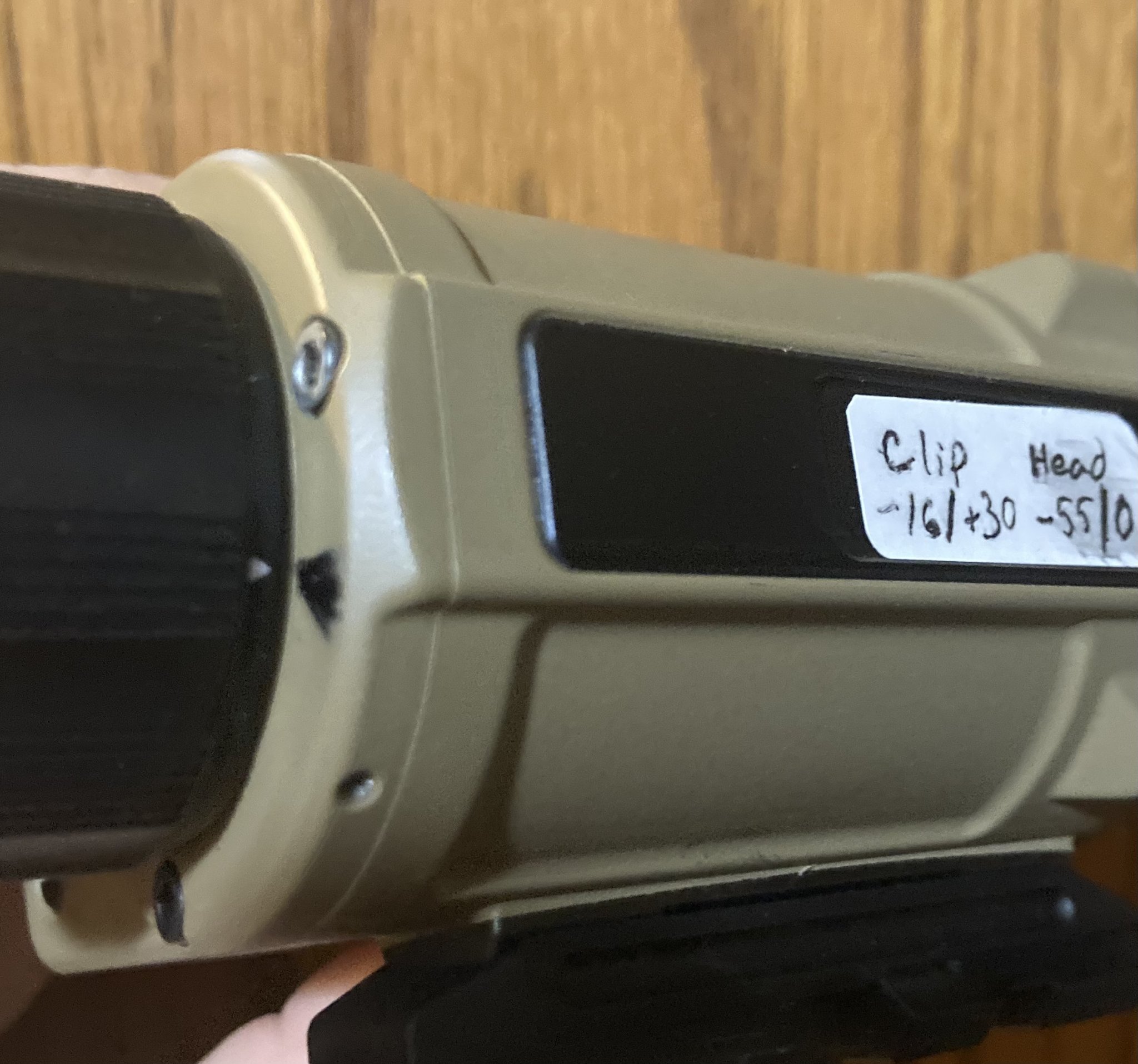

Firstly you’ll have to have your scope diopter set for what your eyes need. Also keep in mind you have a 1-10x… you really start to feel the pixels around ~4x and by 5x/6x I don’t think you’re getting much more if anything from extra magnification. To leverage 10x you’d need a clip on that offers significantly higher pixel density (like a C35 or something) at the expense of FOV. That being said, an FFP 8x or 10x LPVO is just fine because you’ll get the full range in the daytime and then when you limit mag with the clip on the FFP holds true. For my SFP 1-6x razor if I want to use the BDC I have to tolerate pixelation - which isn’t unusable at 6X but the clarity is well past gone away.
Next make sure the diopter ON THE THERMAL is set correctly. If you have imperfect vision and use the RH25 eyepiece to correct it when using the thermal handheld or helmet mode… don’t use that ocular setting. There is a white dot and and arrow on the eyepiece ring of the RH25 that should line up (or be petty damn close to perfect) for focusing the eyepiece for scopes. When it is dialed in just right, the image will be sharp AND parallax free. When it’s off even a little, it’ll be sharp but you’ll see a small bit of parallax shift between the scope reticle and the screen image/pixels when you move your head around behind the scope. For lack of a better way to put this… the RH25 diopter is essentially putting the LCD screen at the scope’s focal distance. I like to open the menu of the thermal and stare zoomed-in at those pixels/icons at like 6X and move my head around while fine tuning the RH25 diopter until no shift is observable… bingo… that’s your ocular setting for that scope. I marked my eyepiece with sharpie for both “eyeball” and “scope” positions so when I pop it on and off the gun I can just twist the eyepiece and be set.
I also wrote the XY offsets on a sticker on the side of he unit for my clipon zero and my “fusion” settings to align the image with a PVS-14. I run my RH25 in a bridge with a PVS-14 and if you want to align the RH and PVS images, your eyes might need the image shifted or you’ll see double. If you don’t plan on bridging it with a PVS, don worry about that multiple XY offsets crap.
Lastly, like any night optic, it does not have a large depth of field. Just like a PVS14 you have to notably change the objective focus for arms length vs room vs 25yd vs 100+ yard things. Also very important to note… when you “zero” the X/Y offset scope in clip-on mode or reticle stand-alone mode, that digital zero setting only holds true FOR THE OBJECTIVE LENS POSITION IT’S IN. It’s helpful to put something like a flip cap (30mm) on the objective that repeatably indexes the position against the battery door for repeatably setting your focus to it’s “zeroed position”. iRay is aware of this (so it’s not a “defect”… but rather more a shortcoming) and has an objective cattail throw lever that works well for indexing your objective. So yes, if you zero the X/Y offset or reticle at like 200yd focused sharply and then resharpen up the focal distance to shoot something like 10yds away it will shift the zero … on mine a focus ring rotation of 120 degrees shifts my POI about 6 MOA to the 5:30 position. It’s repeatable and can be worked around as long as you police your focus distance repeatably. Best to just leave it at your zero-focus at zero distance and shoot really close things with it a tad bit fuzzy.
Hope all that helps. It should be pretty darn clear though. With my 6X razor I can see tree bark pattern at ~100yds.
See images below of the cattail indexed to its zero position, the “scope” ocular zero position, and the diopter setting markings for my shitty eyeballs.
033A352C-4907-49F5-96C3-F5D80D2977C6.jpeg2C5C73AC-76B2-4BC1-AE20-663F4F99A6FF.jpeg60B861A8-2A17-4B18-A22D-42E7C194BD9C.jpeg
Joey I truly appreciate the support and direction. Let me get behind it this evening and tomorrow during the day so I can see what is actually going on. As a NVG dude its a bit of a strange concept that I can use/do this during the day.
I will work it step by step as outlined and report back. If anyone else has anything to share please do. Thermal is totally new to me. My primary use will not be hunting but rather more detection and then having the ability to sight and fire. I think that is what is most appealing to me that this unit can fill more roles knowing that it might come at some cost to dedicated performance.

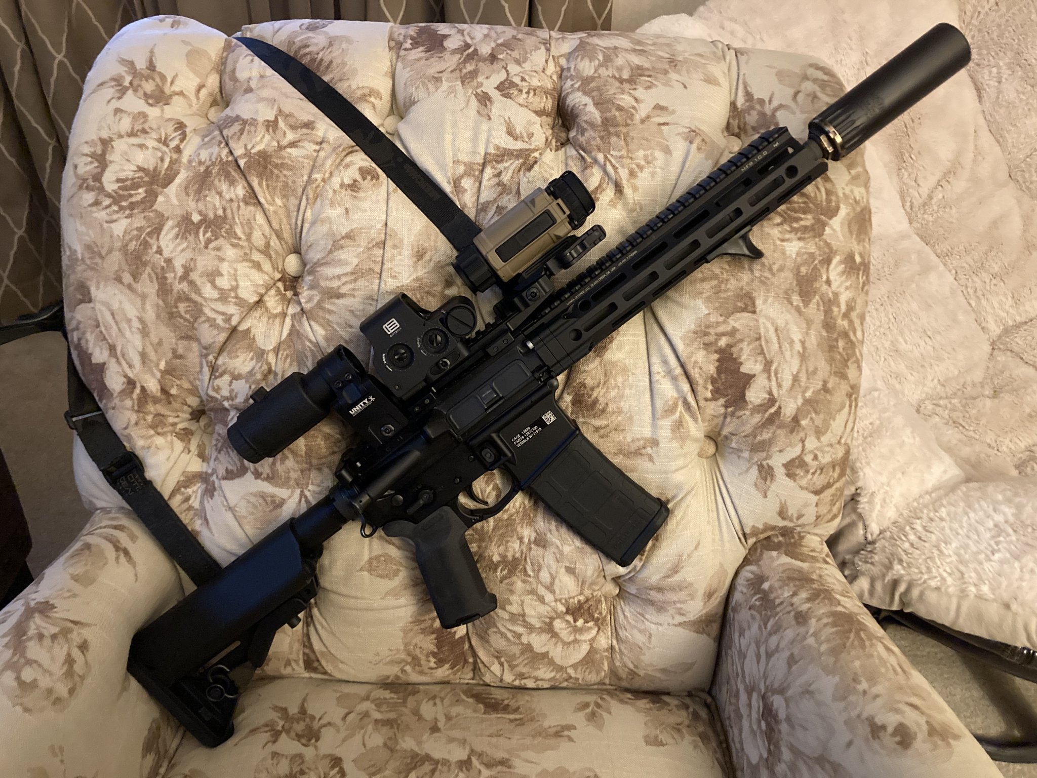

I was also curious and took the plunge. No doubt a BIG decision. I was looking to fill a gap that night vision couldn't fill. The RH25 checked all the boxes for me in that I could use it as a handheld, helmet mount and clip on. I will not use the unit as a dedicated thermal optic on a rifle as I just don't have that need and if I did there are much better options. Special shout out to French1966 for helping me understand this unit much better.
I have shot it on two differently configured AR's and I'm very pleased with the results. Got lucky in that I didn't have to adjust the margins that much and that adjustment will work well enough for both rifles. Zeroed during the day and was holding less than 3" groups on both at 100 yds. That's more than acceptable to me seeing I just cant aim any better with 3x.

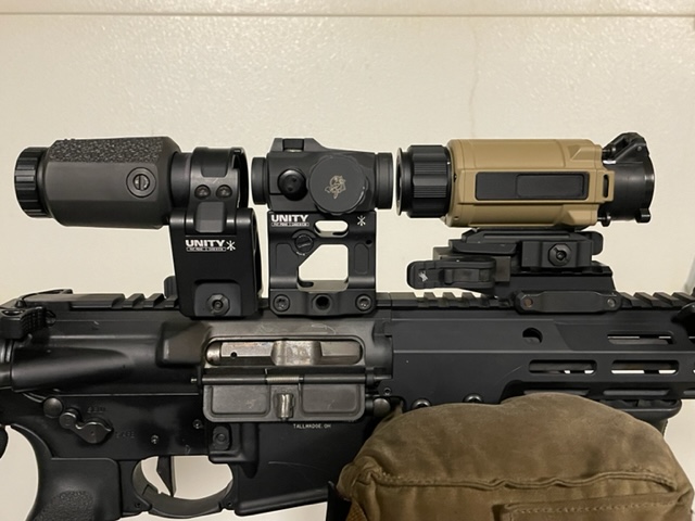

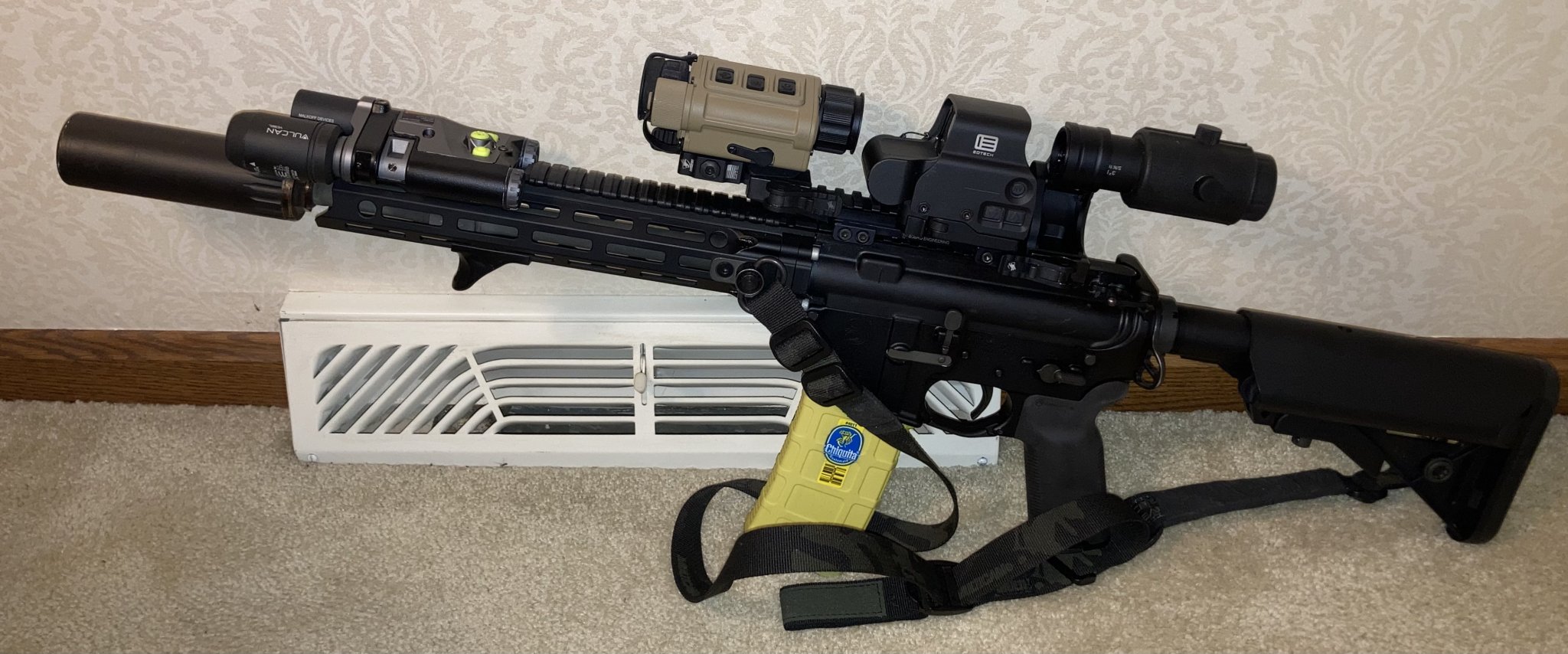

Currently set up to run the RH25 in front of an Aimpoint T2 on UNITY Micro Mount with 3x magnifier mounted in UNITY AP Mag Mount. The unit aligns perfectly sitting on top of a UNITY Riser along with the ADM Mount. Also set up to run it in front of a Vortex Razor 1-10x.

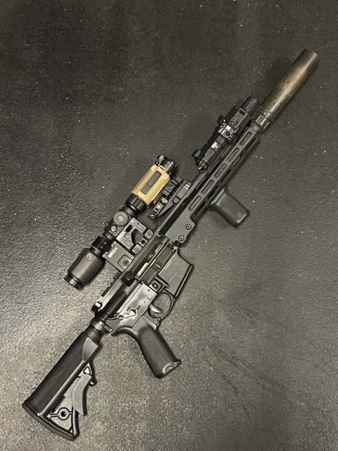

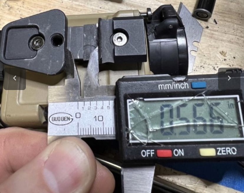

Does anyone have any pics of their RH25 in front of a 1.93" height scope? All of my optics are this height and I'm trying to figure out how to do that. It seems that I can maybe use the (included?) recoil-dampening mount to get that height, but I'm not sure if that keeps the unit "quick detach" or not and if I need to buy one for each gun.
Reactions: Hksigfn
Thanks for the BoBro info for using an Eotech with the RH25. It obviously doesn't like to line up.
Didn't do the math but figured you'd know. Is the GBRS Mount identical to the BB Double Decker? If so, I have an alternative I won't mention.
By playing around with things on both rifles I was able to line it up with a Sig Tango adequately though.
Thinking about getting one. I need some help though. Does anyone have any experience using the unity tactical lpvo mount with a razor 1-6? Wondering if I could maybe get by with using the ADM mount but going from a 2.04 optics mount to the thermal being at 1.54 seems like kind of stretch. Let me know what you guys think
I’m pretty sure a unity Eotech riser could be used to get a RH25 up to a tall mounted LPVO (roughly 2.24 for thermal, 2.05 for scope using unity mount). I would have to look around at listed height measurements online to confirm but I’m too lazy to do that for you. So let us know how it goes 😁
In the meantime, feast your eyes on this Wilcox Oasys mounted RH25. I recently modified my pictail for it. While the ADM is a solid product, I find the Oasys mount to be light years better for my uses:
When I saw that rifle I immediately knew who's it was!
Your ARF posts on this mount are very intriguing Frenchie. I'd like to get my hands on one of those flip mounts to try on my rifle above. If I find one at a low price point, or second hand it would make my day. You always get your setups looking both sharp and functional buddy. Kudos...........
Any chance you can drop a link to that Oasys, or is that verbotten?
Both you and JoeyMac have some killer setups and sure know your shit when it comes to the RH!
Reactions: Gunny Fitz
When you say you modified the pictail to work with the Oasys mount, you mean you widened the gap between the dovetail shoe and the Picatinny rail section so that the Oasys mechanism fits in there? Can you post a picture to show how much material had to be removed? Is the Picatinny portion still usable? I'm currently working on a pictail design that ideally incorporates this compatibility.
Reactions: French1966
I didnt retain the pic raíl section because I no longer need it.
But I do know someone who made it work (allowing ADM & Wilcox mounts to be used). Photo below 👇
Reactions: WhereNow&How

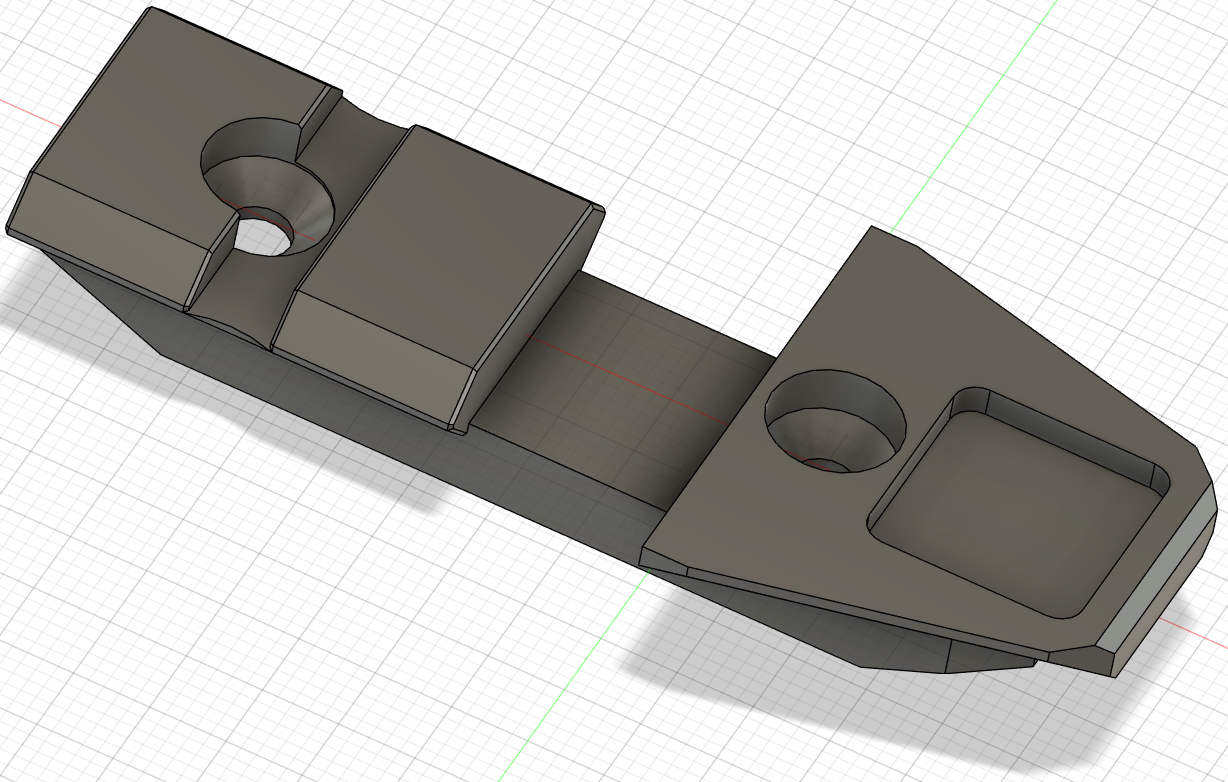

I've designed some pictail alternatives in CAD if anyone is interested. They have not been prototyped with a 3D printed version, I will do that in the next few weeks. So currently a few things are still not perfect:
- can't guarantee that the dovetail locks into place properly
- not sure about the height of the optical axis
But if some people want to try them out, feel free to let me know. For example, here is a version that allows you to mount the RH25 to a Wilcox FTS mount and still use the Picatinny rail attachment. I'll update the designs as I go along.
Reactions: Jcarpenter223
