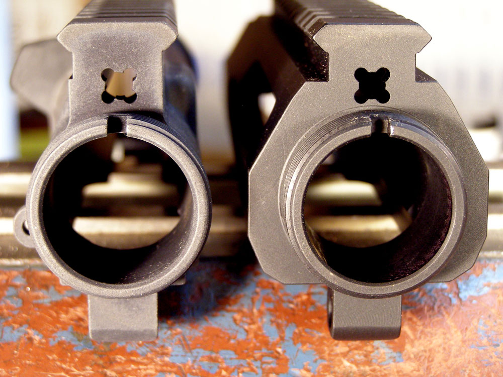

Put me down for 2 x steel uppers. If they were straight up same dimensions as a std upper I'd be happy. DLC on a steel upper would be tits.
If your buddy is all set up for Aluminum I'd gladly take a heavy wall 7075 like the old Mega uppers.
Mega 3/8 heavy walled upper below right. These were like 2013 I think.
