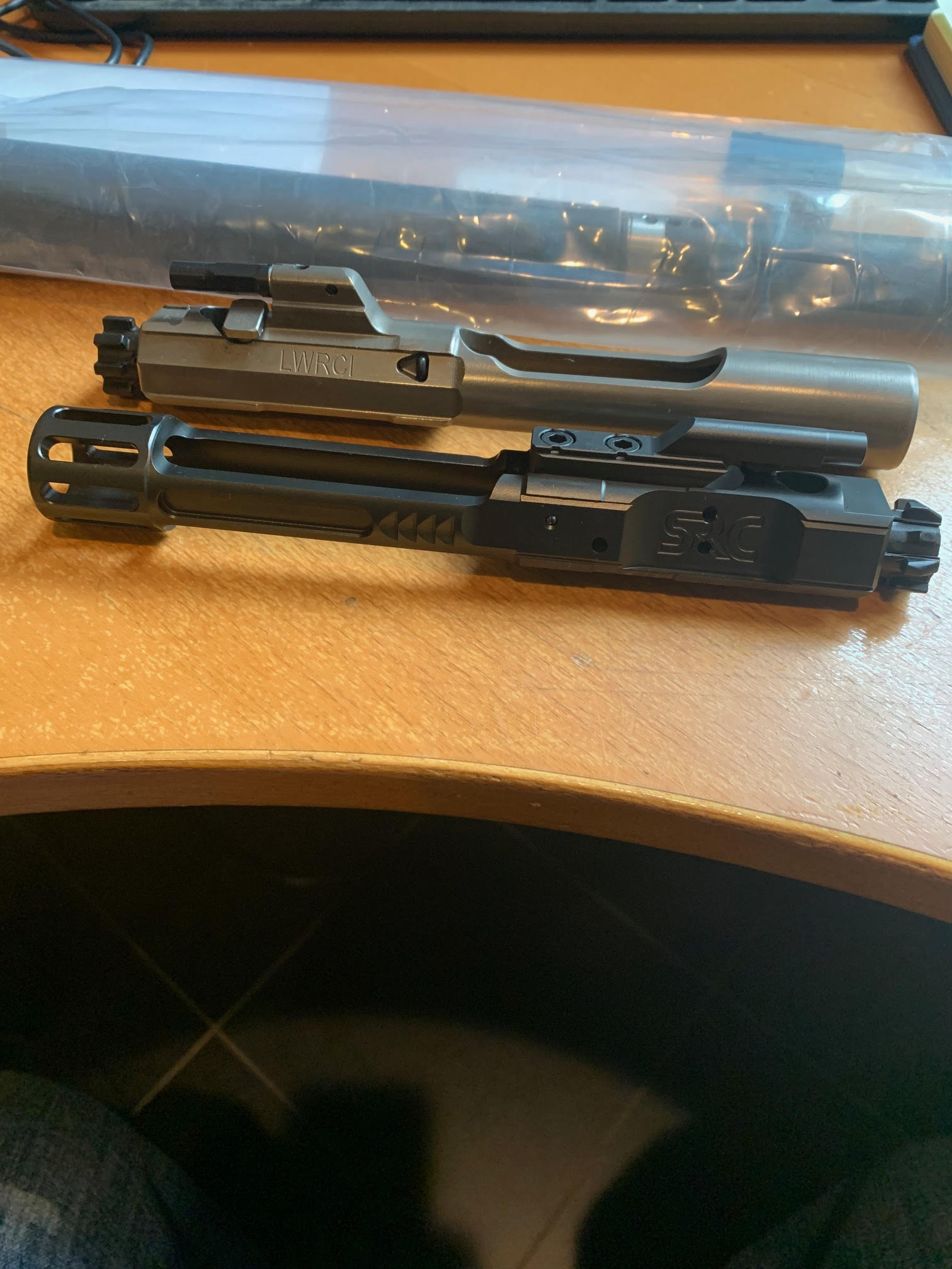

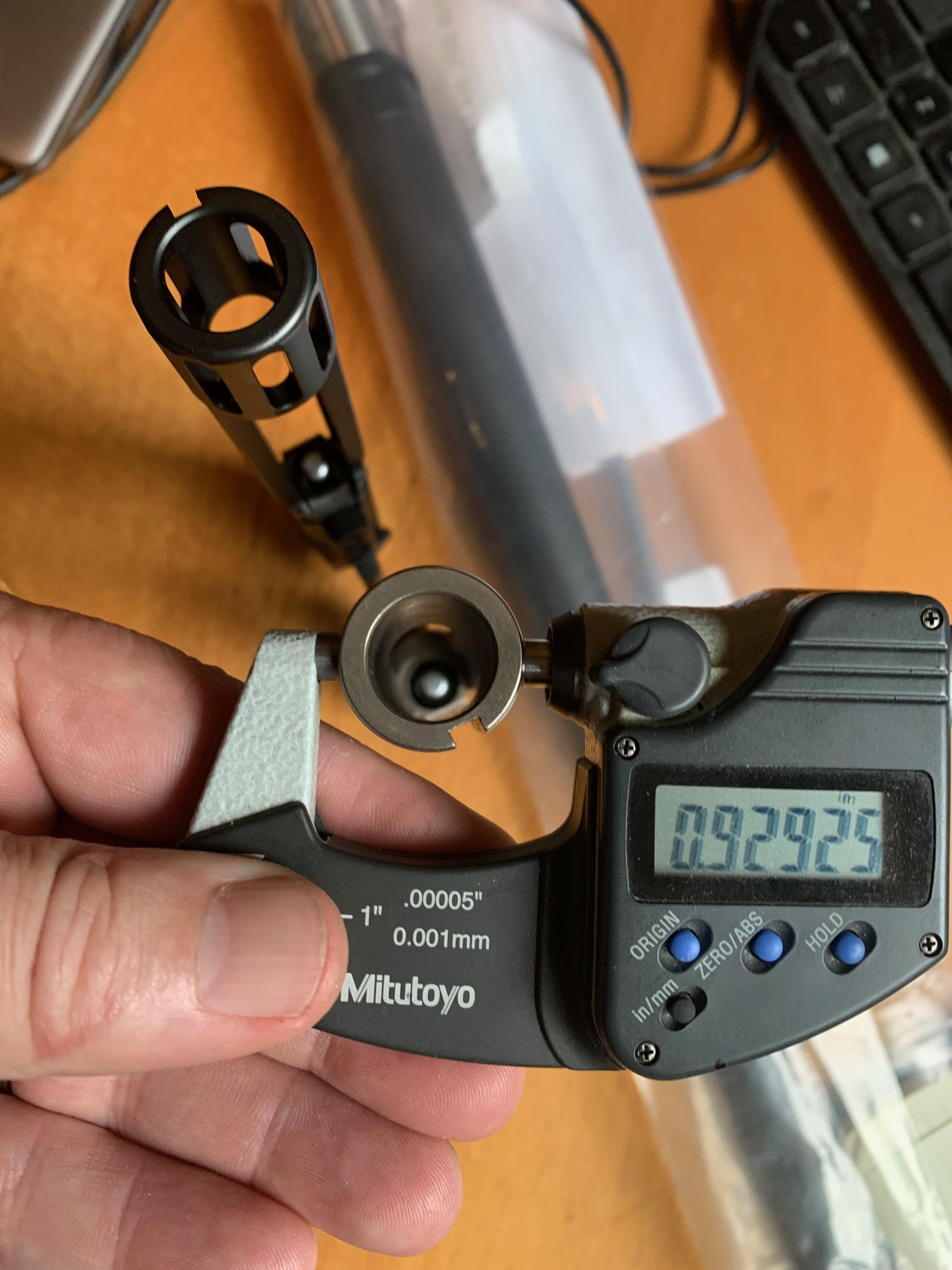

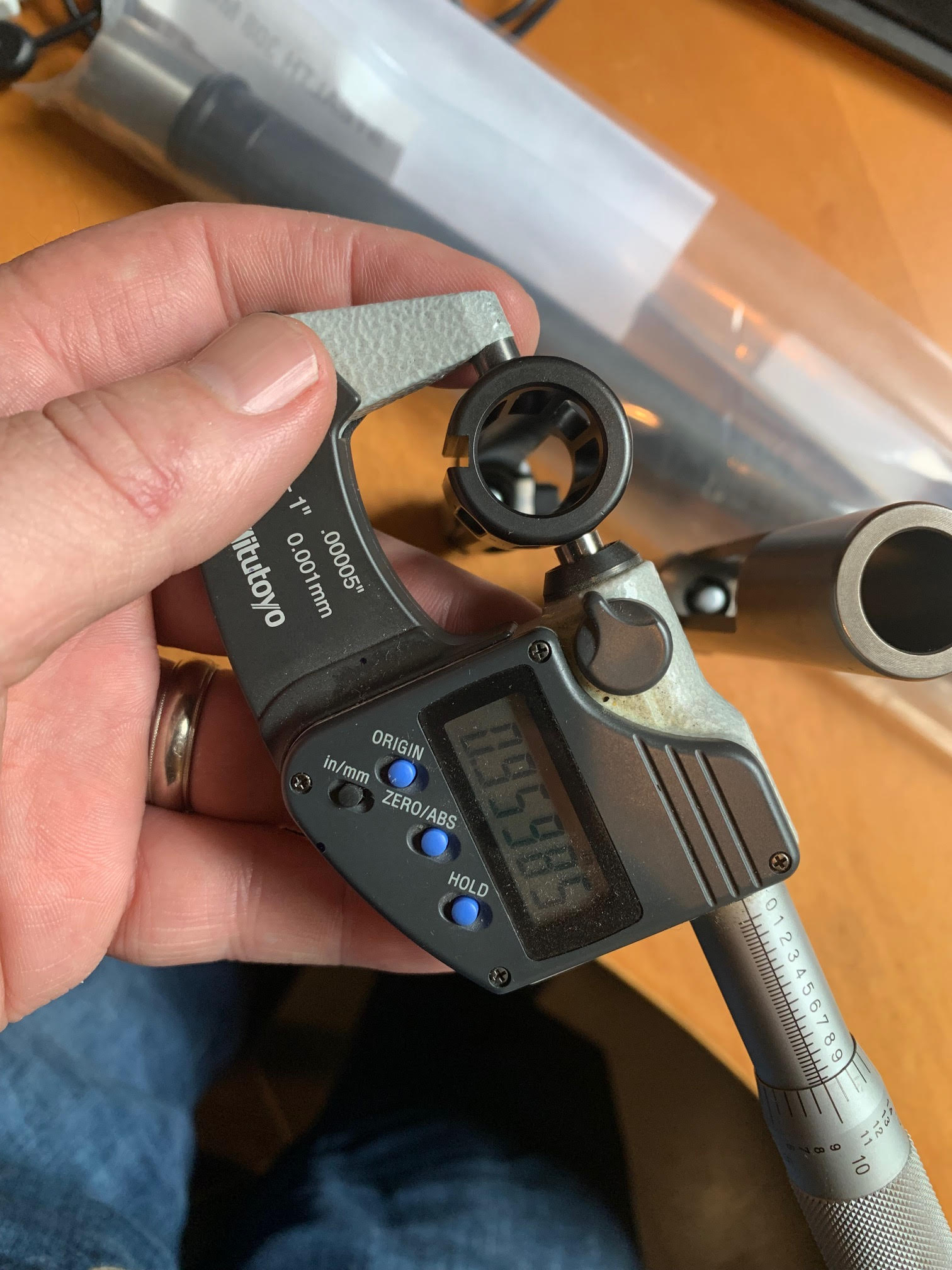

Ok talk to me about centering the bolt carrier. I'm rebuilding my Grendel which is not giving impressive groups, and I'm planning on loctiting it, but I'm curious about how you go about centering a bolt?
It's centering the bolt carrier, along with a good to top quality barrel, plus all the other procedures one can have a very accurate AR style rifle.

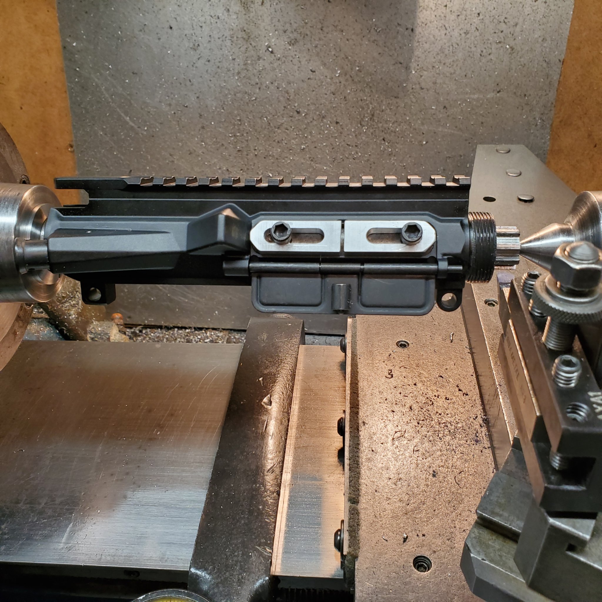

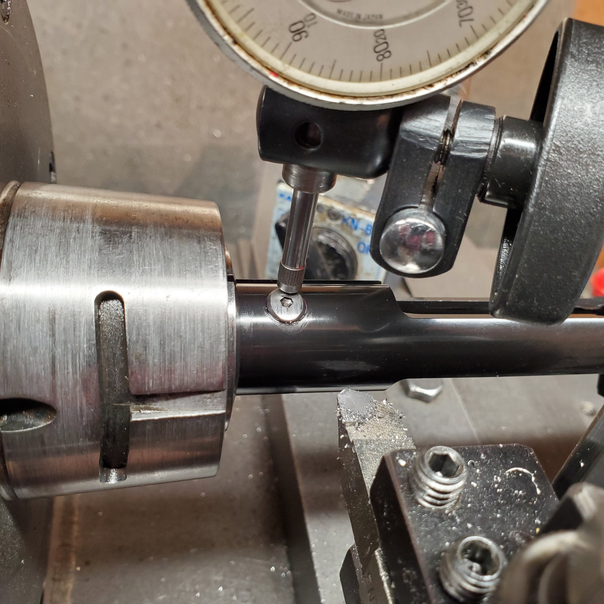

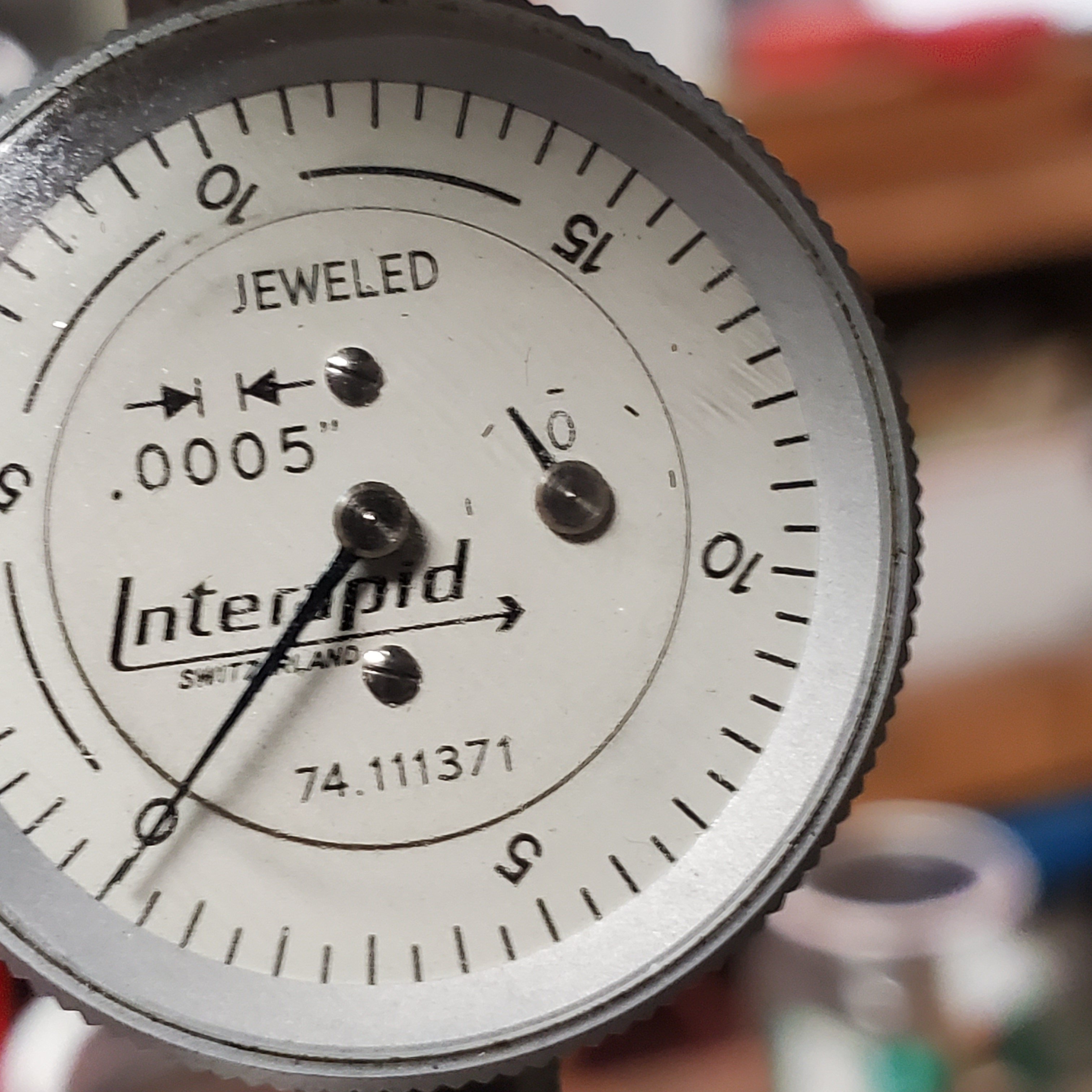

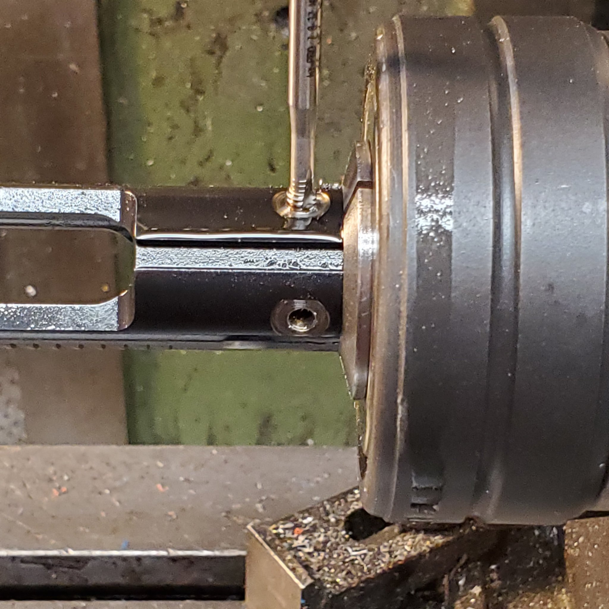

This takes machine tools and precision measuring equipment...not for the average builder.
For those curious, there are videos from AR Armors to help one with understanding the steps, in accurasizing...it's where I learned, buying books, and videos, plus being a machinist with a home machine shop. An advantage most do not have...but one can learn.
If you have access machine tools, and do fixturing, or have a machinist friend show you. It looks something like this.

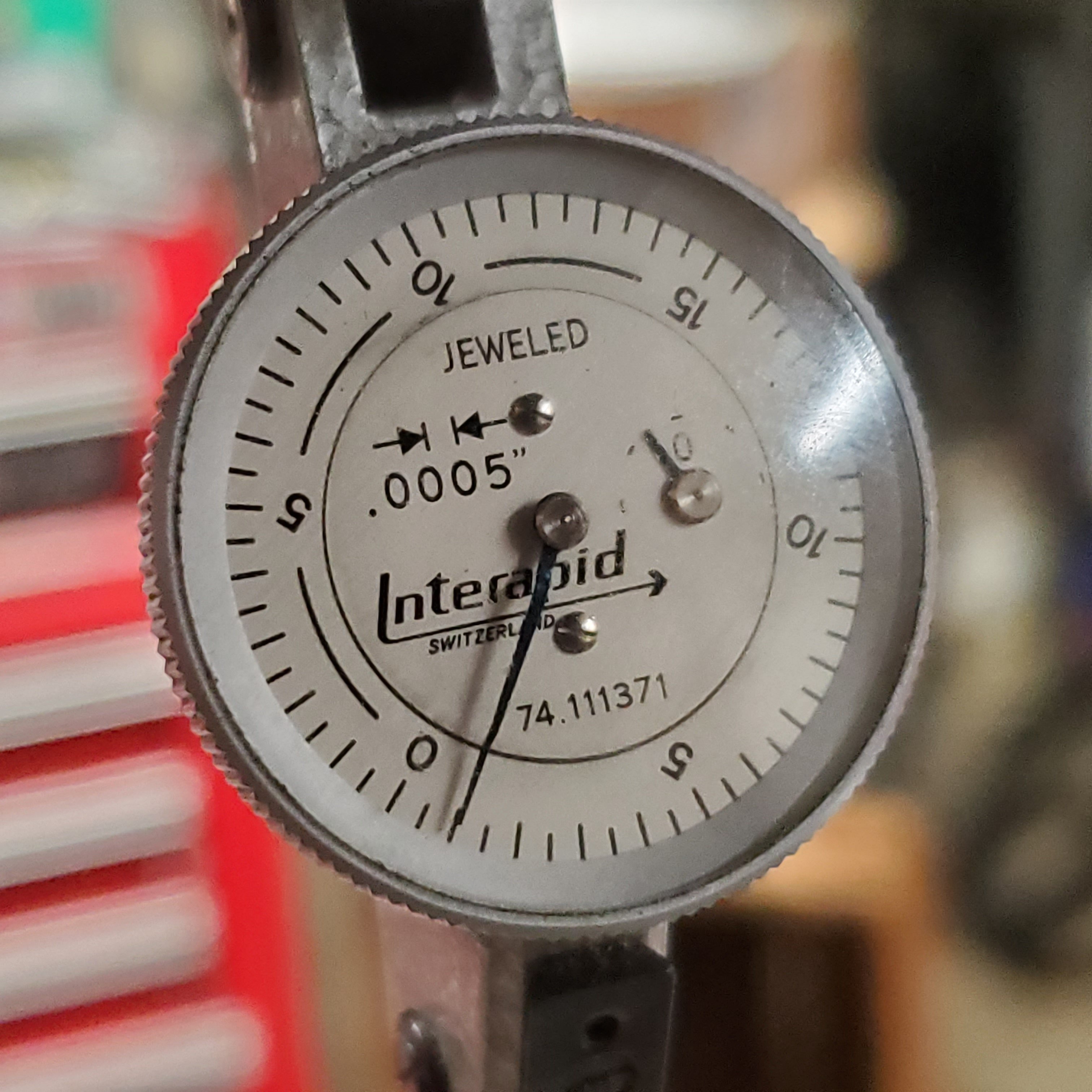

About 15 years ago, I ran into a gunsmith at a local shooting range who had squared and trued-up everything he could think of for a Grendel build.
He squared the barrel extension, the receiver/extension/barrel nut faces and bearing surfaces, trued-up/cut the threads himself, and de-edged/blended/polished his feed ramps.
He was shooting .5” groups out of the gate with it. I think he had a 22” barrel of one of the pedigreed barrel shops, maybe a Shilen.
He’s where I got the idea for the barrel extension work I do for reliability/feeding/babying brass.
As to the question about bolt carriers, most people don’t realize the bolt carrier actually rides high inside the raceway due to cartridge stack upward pressure from the magazine spring. The rails-in-contact are the top rails on the carrier, while the bottom rails kinda bounce off the inner lower raceway track. The initial contact area for the bottom of the carrier is the center spine at 6 o’clock that rides on top of the cartridge in pre-presentation.
Once the carrier clears the cartridge stack, the bottom rails are free to fall into-position with gravity, then they lift above again once the bottom spine rides over the next cartridge in the magazine and the stack lifts the carrier back up into tension against the inner top of the raceway.
What 45-90 is doing with the 4 hemisphere bolts on the carrier tail is controlling some of that banging around that happens normally with AR-15s, centering the carrier tail throughout its travel inside the RET, if I’m interpreting his placement of those bolts correctly ( I might be totally off my rocker as well.)

Yes, it all makes a difference. Unfortunately some of it requires machine tools, and specialized equipment, but do everything you can with hand tools and glue in or shims to improve accuracy.
There are other things never discussed but were taught, that do not require machine tools to improve accuracy.
I do not use them in my build/ assembly, but others might. ARs are accurate.

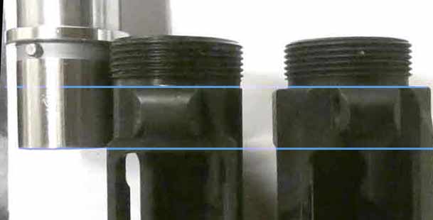

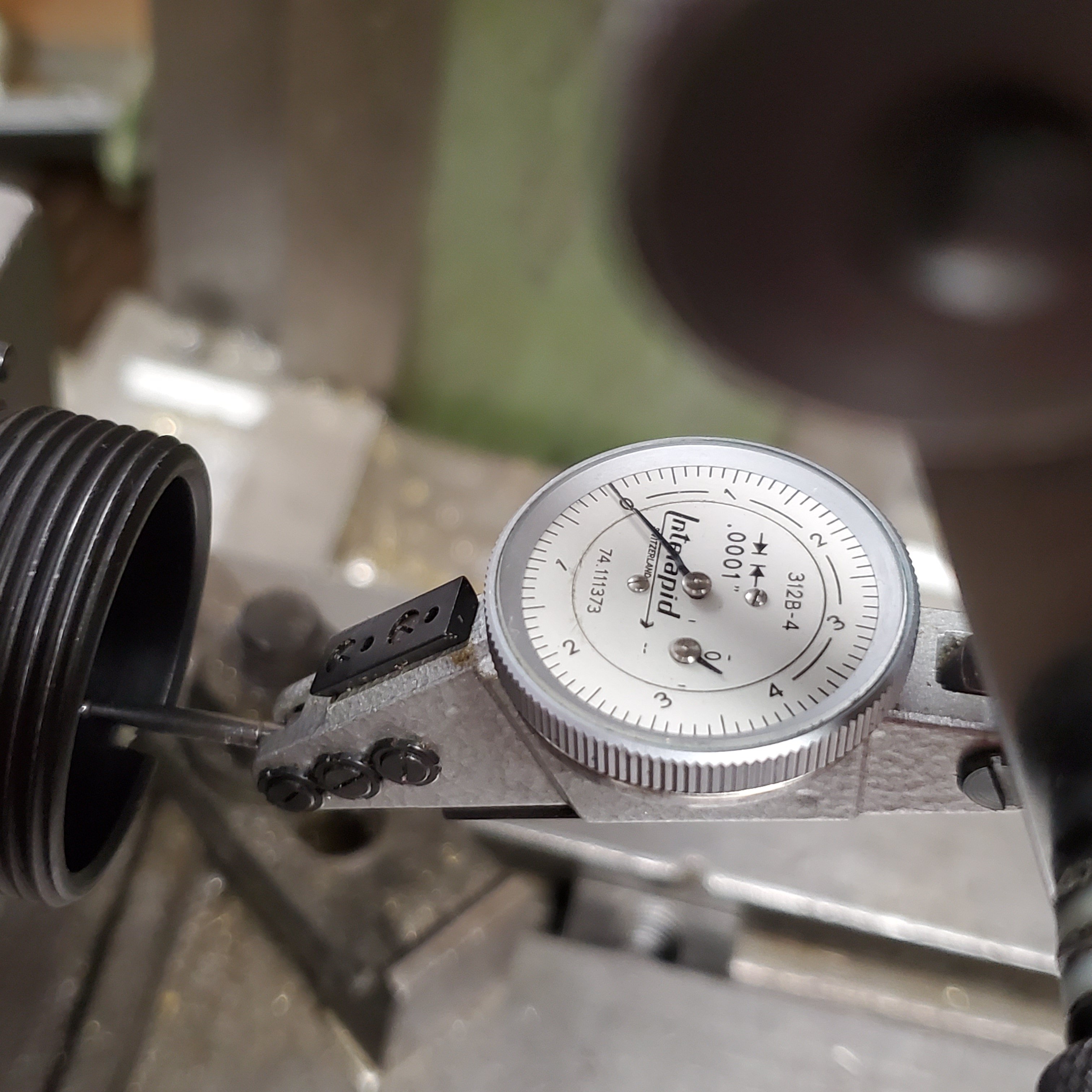

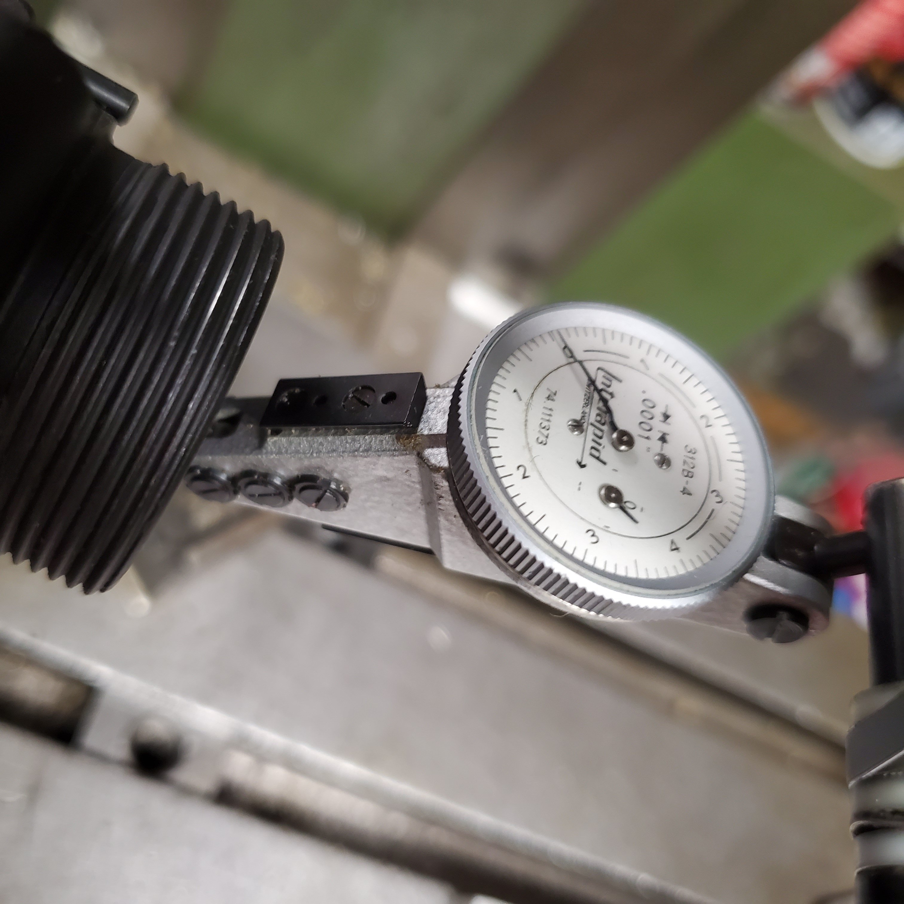

The barrel extension spigot
Odds are that even after truing the face the bore is conical. It's pretty unlikely the face looks like that and the bore is strait.
The bore is straight... a precision ground rod passes through, and is used to make the face perpendicular to the bore...a .001" finish cut is made to clean up all around.
It was stopped and photographed to show the that CNC machining is not perfection in much of today's production...
This is an example of bad programming, and untrained operators running them.
And depending on deburring machines to cover up slight imperfections, so the average guy doesn't know, as the anodized finish looks pretty good to the untrained eye.

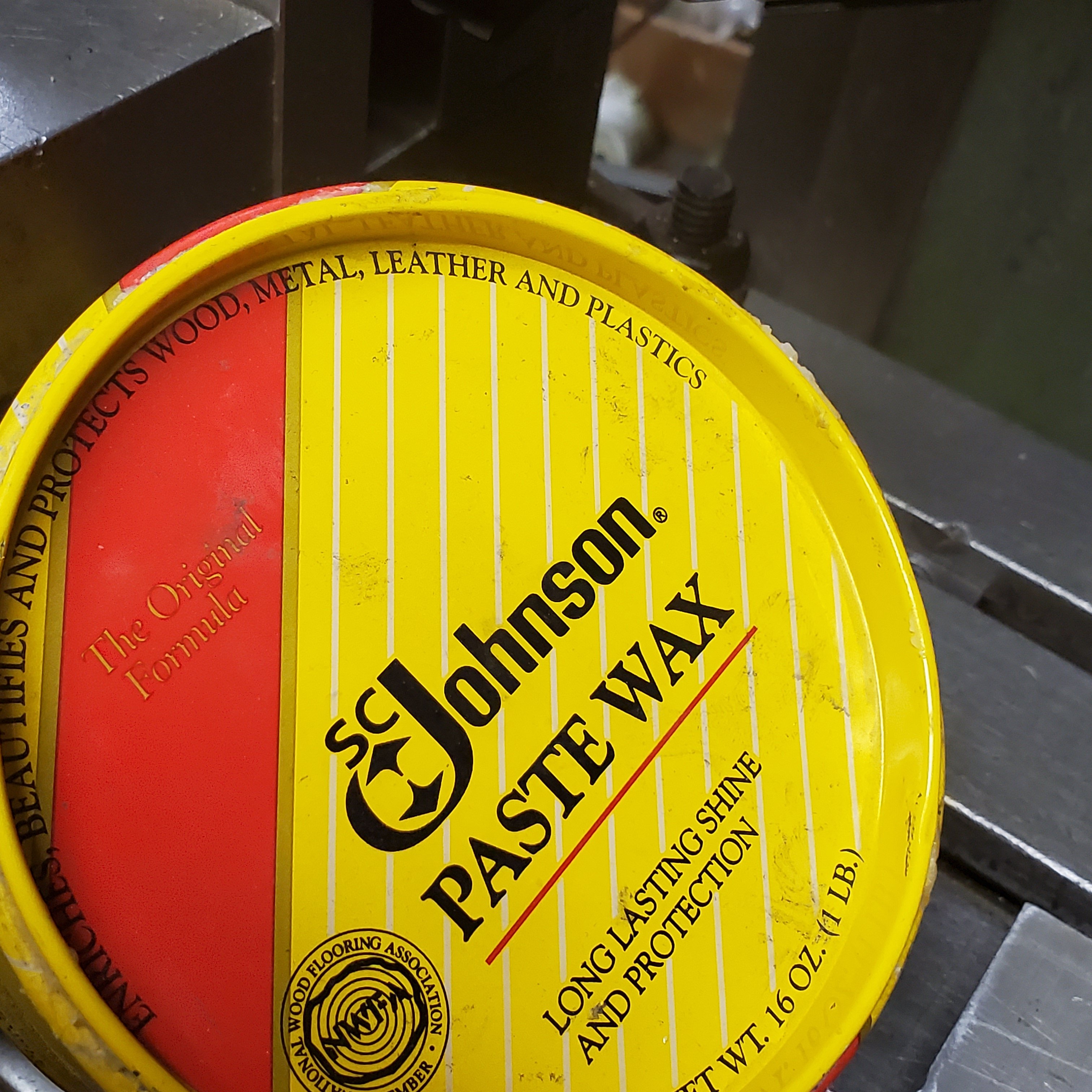

Do you apply any kind of release wax/agent on the inside of the upper receiver before getting any JB on it?
Reactions: PappyM3 and 45-90
I use Johnsons paste wax to the upper's bore, where the barrel extension fits into, and buff ...leaves a slick finish for disassemblely.
To remove:
Get an oak dowel from home depot to make the high temperature bering sleeve loctite easy to remove.
Turn down or sand the front of the dowel to hit the back of the barrel extension.
Leave it about 18" long or a bit more.
Slide the dowel up the carrier raceway against the back of the barrel extension...and smack the back of the dowel fairly hard on the concrete floor...hang on to the barrel! Notice as it seperates tap lighter.
Barrel is out in a few seconds.

Just for clarity, it's JB Silicone, not any epoxy stuff.
Using a Silicone product, no release of any kind. I clean the surfaces with rubbing alcohol. You want the Silicone to latch on (stick), which helps reduce movement. The thin layer of Silicone will still shear loose when you pull barrel out, but it requires a good pull (no heating or anything), but nothing like using a 680. Think of Silicone like head gaskets that have a silicone layer on them, the thin layer compresses just a smidge, but it also starts to act like a incompressible fluid when it cannot squish out.
And yep, when you remove the barrel you'll have some cleanup work to do, but it's very thin and can be buffed off rather easily.

Lots of speculation, misinformation ...but no actual measurements.
I did the Johnsons Floor Wax for a release agent and put on a coat part way down the reciever extension bore.
Then buffed it after drying.
Measured with a 10 thousandths indicator.
No movement of the dial not even .0001" thick. That's not even 1 ten thousandth thickness added...no discernable measurement...so it does not interfere with any fitment. If it was to melt away, no measurable difference. If it hangs in there it helps with removal ...as a slick surface.
Green 620 Loctite high temp bearing sleeve , is not only good for high heat applications...but "expands" as it sets up to fill voids up to .007" ...according to the manufacturer.
Which is good because a larger problem is the reciever extension bore is likely slightly out of round.
A half to one thousandths of an inch out of round in many cases.
The one I just measured is close to a full .001" out of round.
The extension is ground but is then threaded on, and torqued down... and it too is most likely not running true ...I have noticed this before, when rechambering AR barrels.
The Wax thickness test ...nothing measurable with a 1 10 thousandths indicator.
This is the product used.
Change to a half thousandths indicator and measure the out of roundness.
This reciever bore is close to .001" out of round, 3 sides being pretty close to zero, but one aide goes slightly high, about .0009".
It is what it is...those are the facts I found when actually measuring.
Do whatever works for you ..
I'll keep doing the same procedure until I find something better.

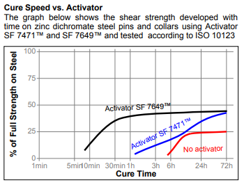

One thing I missed about 620, is that the substrate matters.
620 on mating aluminum, it only gets to about 50% of full rated strength.
620 is designed to achieve the 100% rated strength on clean steel mating parts.
So I wonder what the final cure strength of 620 is when the mating surfaces are waxed, or just OD steel and ID anodize? Not that a lower cure strength makes a big diff here, but still curious.
It cures just fine. When you pop out a barrel bedded with 620, you’ll notice that the hardened 620 stays on the steel barrel extension and is minimally on the aluminum receiver. So it adheres to the steel, but it fully cures.
Just looking online you could get more strength on aluminum with a primer. LOCTITE® SF 7649
Haven't heard of anyone using it on a AR though
Henkel recommend the use of primers such as LOCTITE® SF 7649 & SF 7471 with most anaerobics where both parts are classified as "inactive" metals. These metals lack the presence of iron or copper content and thus, lack the "active" metal ions required to fully cure the anaerobic product in 24 hours. These metals include plated parts, stainless steel, galvanized steel and anodized aluminum, to name a few. If, on the other hand, both or at least one part is an "active" metal, such as plain steel, brass, bronze, copper or iron, there is no need to use a primer to ensure full cure in what is typically 24 hours at room temperature. A primer will also be helpful to accelerate the cure in colder temperatures or where there are larger gaps between the metal components.
Reactions: PappyM3 and WeR0206
Good to know and thanks for the research, but I don’t really see a need to do that with AR bedding. The purpose isn’t to glue the barrel extension there, it’s just to fill the gaps so the barrel can’t move.
Like I said, Pros & Cons.
1) If you wax both ID and OD, then the substrate is wax and wax. Are people only doing a release wax on the ID? How then do you get the 620 off the barrel, or is the barrel now a throw away item?
2) 620 is expensive, has a short shelf life, and most won't use much of the tiny bottle.
3) The use of an activator is mostly for speeding up a "set" time, but it impacts strength of the 620 final cure. I have email somewhere from Henkel stating the activators in general reduce max strength of the anaerobics. The anaerobics work best with active substrates. This graph is similar to wax-wax substrate setup, be lucky to get 50% of what the 620 has to offer, which however may still be enough, maybe that's why it knocks out so easily?
