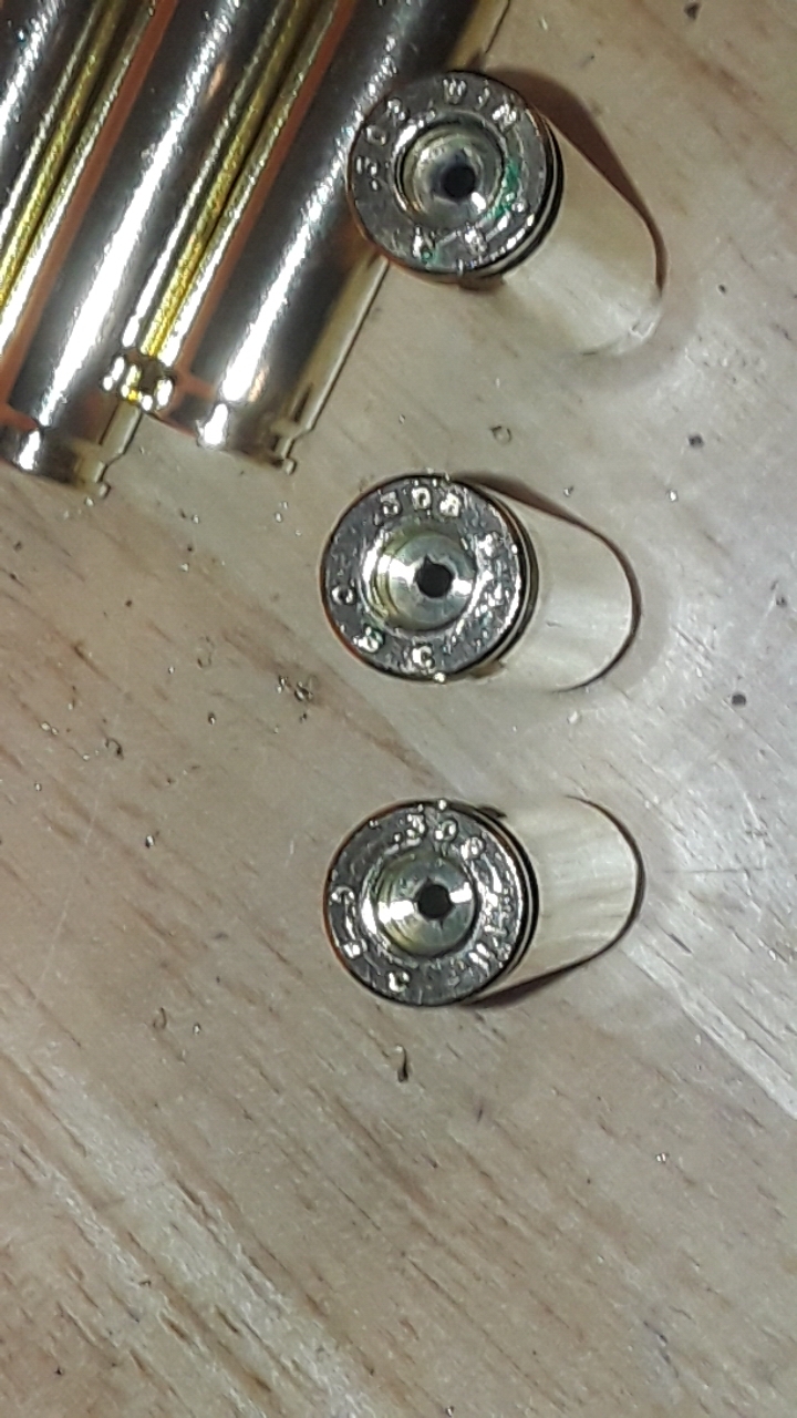

I don’t even know how to clean primer pockets. But I do deprime before going into the wet tumbler with stainless media.
If you're wet tumbling with Stainless Steel Media AFTER depriming, your primer pockets will be clean. The wet tumble / Stainless Media does an excellent job in cleaning those. You won't however, have the deburring that takes place when you use the tool, which removes the burrs inside the flash hole. That is a one time process for the life of the case.
I am jealous of the cleanliness on the wet / steel media results for the pockets.
Processed pockets may be a better term for my work flow.

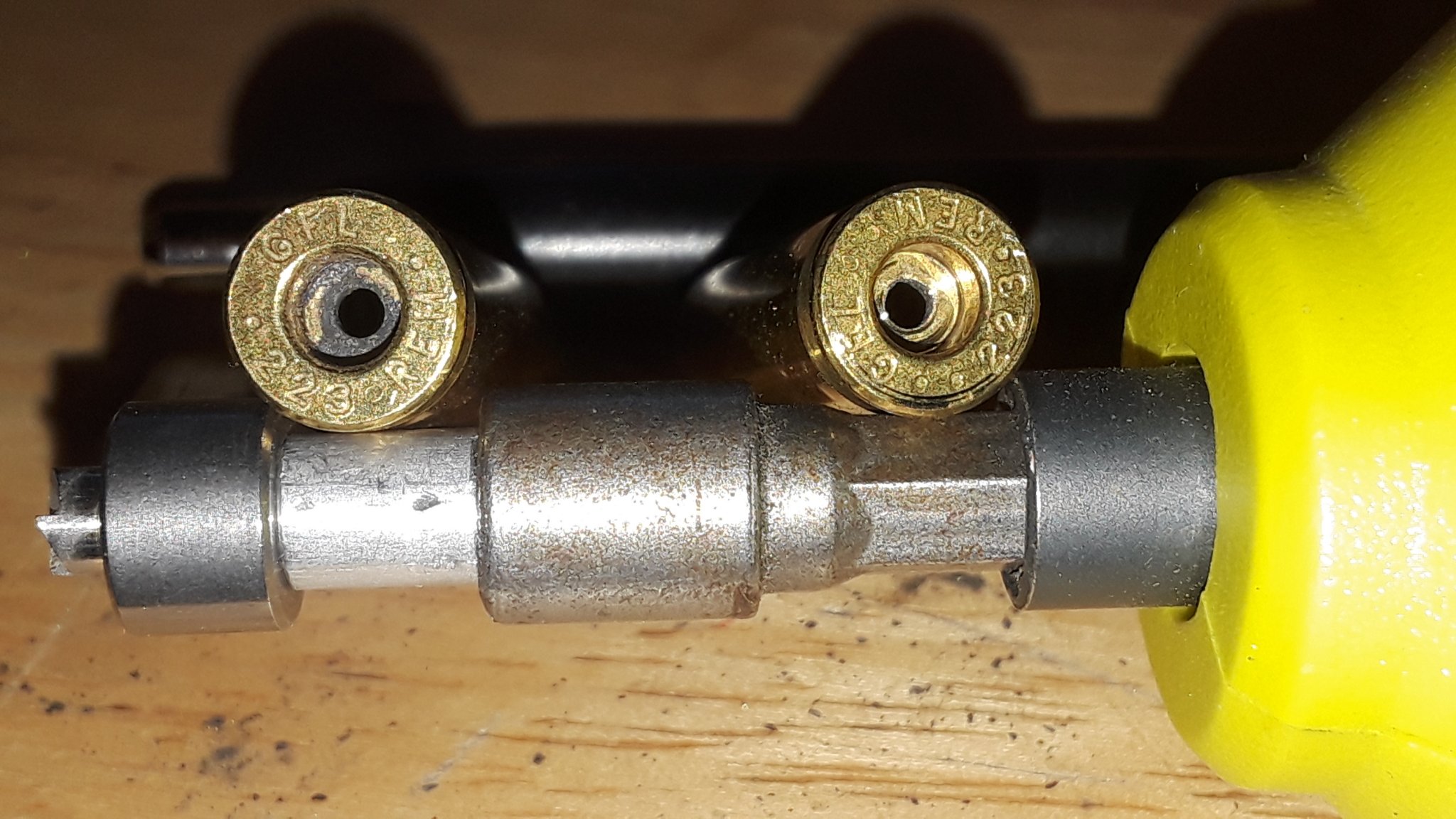

I do a lot of reclaimed 223 range brass and then load it on the dillon. I headstamp sort deprimed and tumbled brass. It gets checked with a pocket gauge.
Other than swage process, the rest is done in front of the idiot box using hand held strait cordless screwdriver and the cutting tools.
A small patch of carbon that was left by the uniformer in a low spot is not cause for rework since next tumble will get most of it.
Reamed / swaged and uniformed the dillon won't hang up a primer.
That infuriates me in the middle of a batch. Un crimped bolt gun loads normally just get hit with the uniformer to take out the carbon quickly.

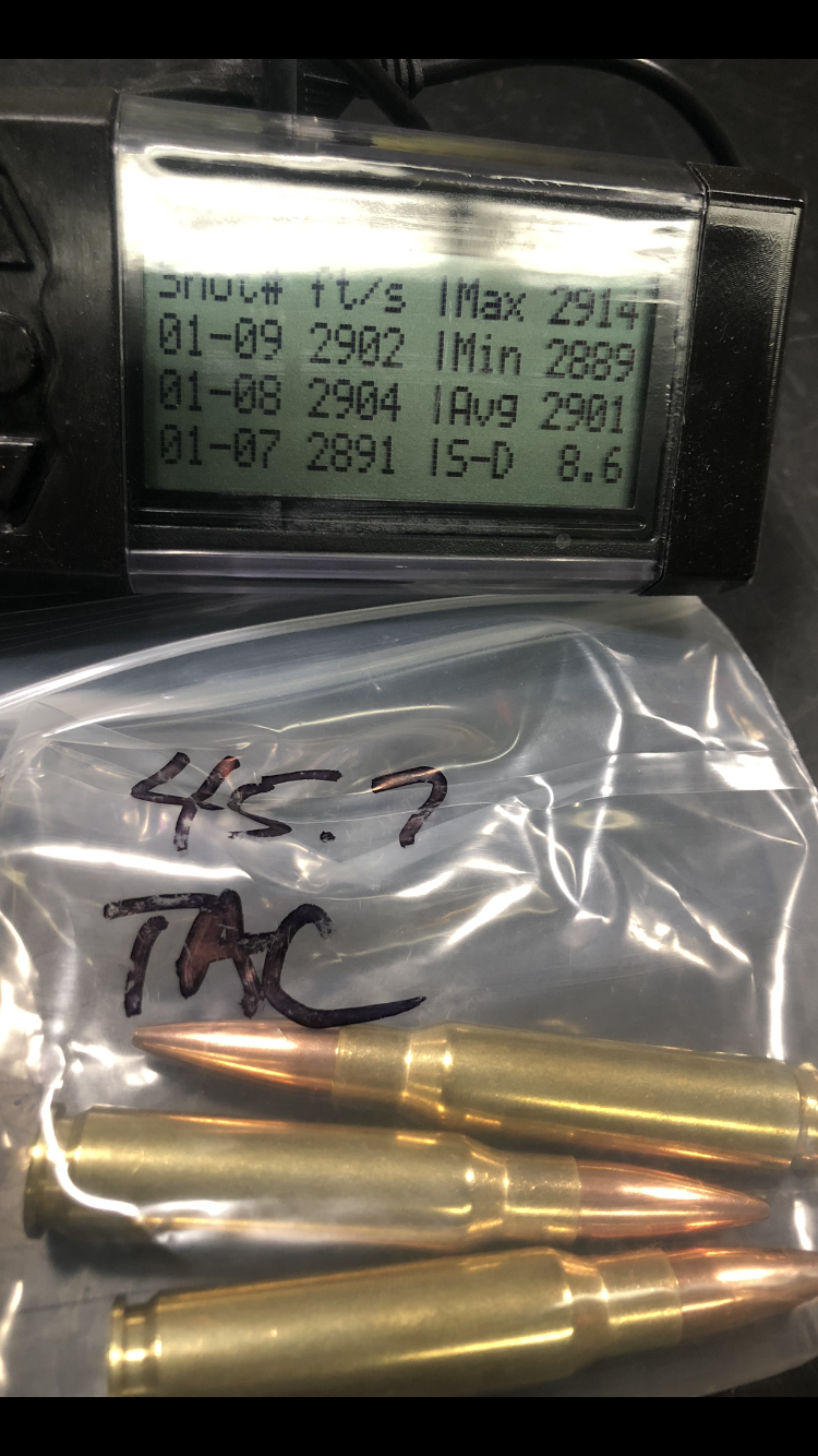

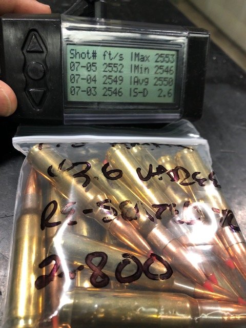

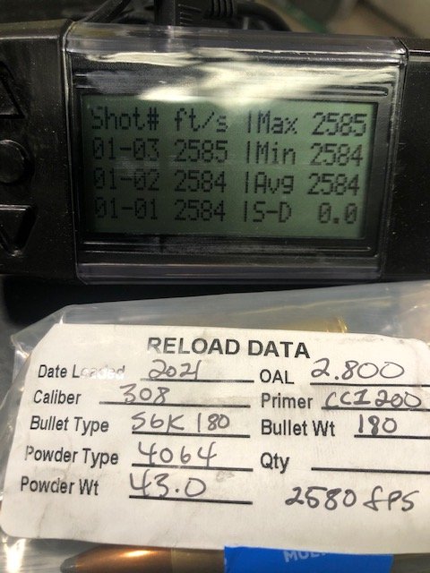

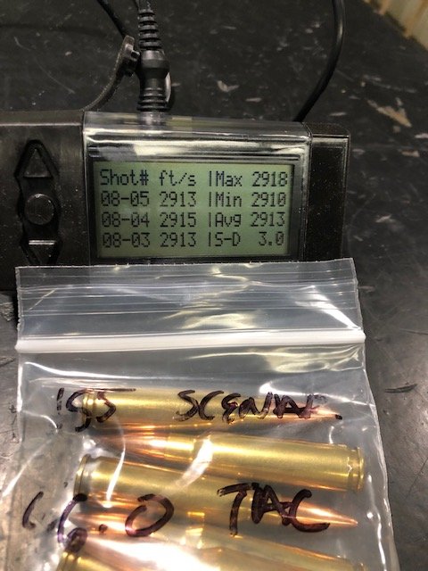

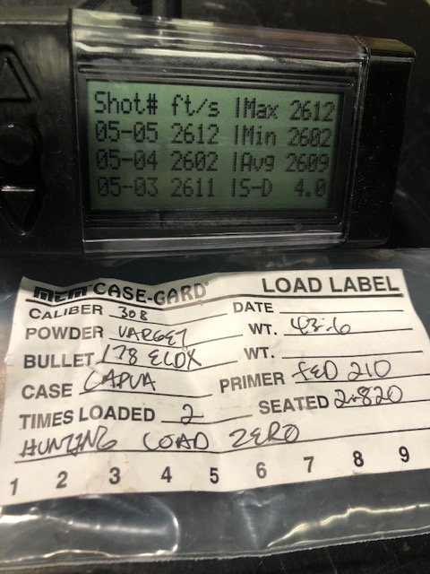

LOL. Do you have any idea of how many rounds you’d have to shoot to know if there were a difference that small?
That is pretty funny! Was speaking more to adding that step plus others like a good sizing die, cleaning the necks with a stiff bristled or bronze brush, mandrel to the necks etc. I went from teens to 0-2 SDs total on some of my loads.
And what makes this funnier is that I dont think Im a good enough shot to tell the difference between a 10 SD and a 2 SD load.
All of these loads are absolute hammers!

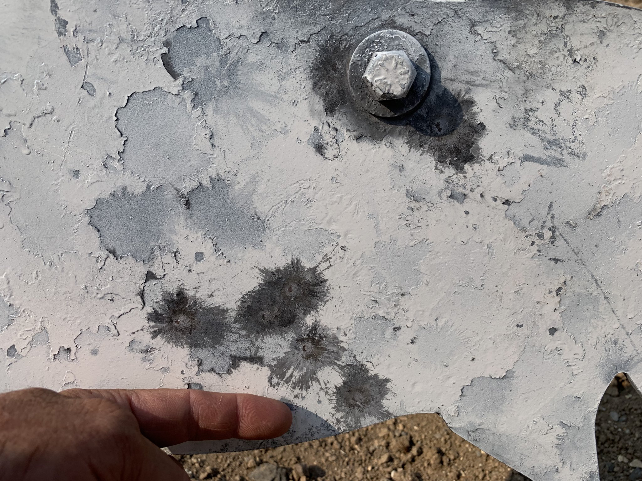

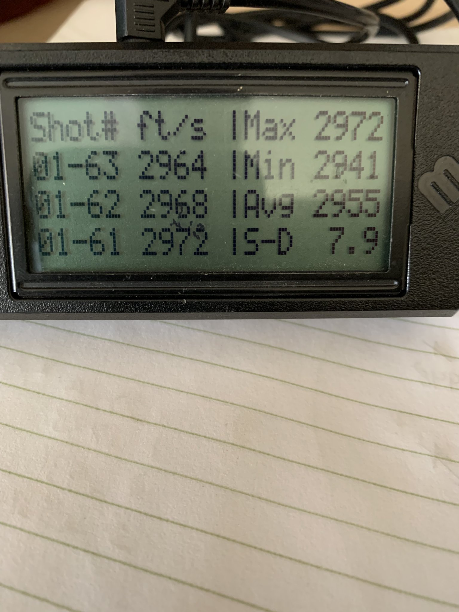

i shot 3 6.5x47 barrels that produced several 10 shot groups with 1-2fps ESs and I don’t remember how many 5-6 shot groups with 0 ESs…1 10 shot group that I really remember was 1 thru 9 at 2750 and number 10 2751.
that said no matter what I do when I take a large sample it ALWAYS ends up in the 20fps to 30fps range…I’d like to see you take a 30-40 shot sample and see where your numbers end up.
This is a 63 shot sample with fully prepped brass and a 5 shot group at 850yds from that 63 shot sample.

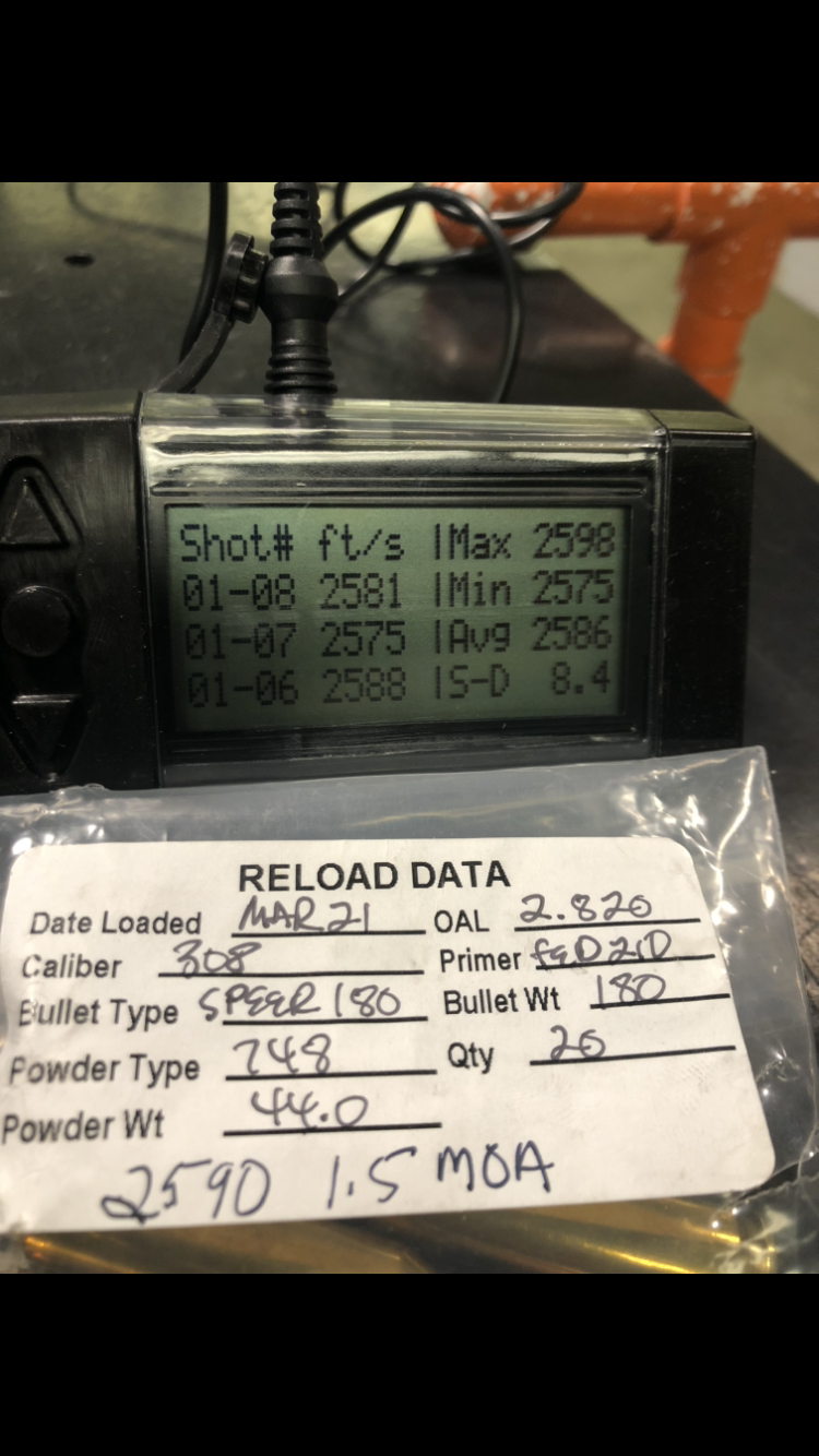

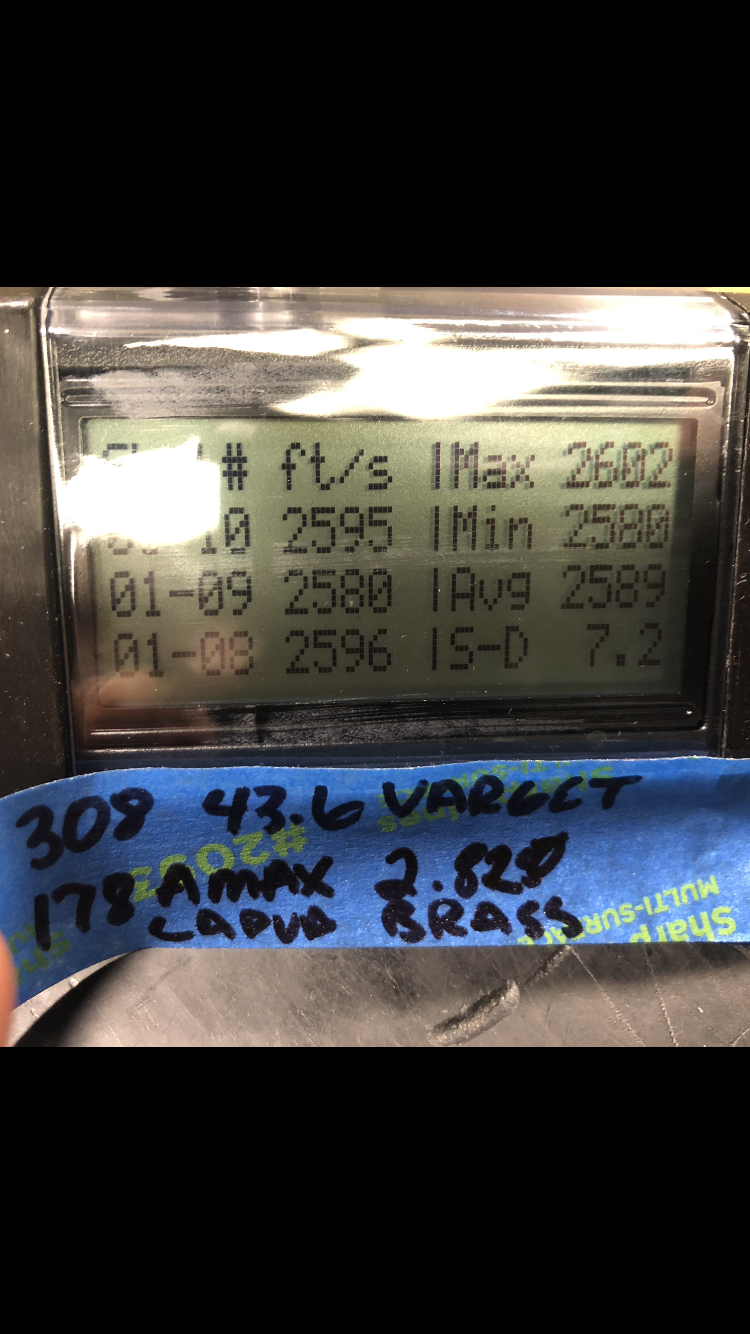

@LR1845 I’m a hunter first and foremost. Yes I owe it to the game to know what my loads are doing but I’m not sure why I would need to shoot 50 rounds to test consistency. How much difference did you see from the 10 shot to the 67 shot numbers?
I shoot longer strings with ball powder that were thrown charges to see if a high or low throw would pull one out of the group. I had a few rounds hang loading on the bottom edge of the charge range.

As a hunter I guess a few shots over the chrony tell you what you need to know as your not shooting longer stings as a lot of guys here do…the point of my post was that these low ESs and SDs do not hold up as you shoot more rounds over the chrony.
my typical practice is 30-60 rounds and matches I shoot are from 50-90 rounds so I like to know how my loads preform over a larger sample.
as far as what I see from 10 to 30-40-60 round samples is 10 rounds normally produce low numbers and as the round count increases so do the numbers.
if my numbers are 30ish FPS or under I don’t worry about it if much over 30 I start looking but like I said i always end up between 20 and 30fps.
