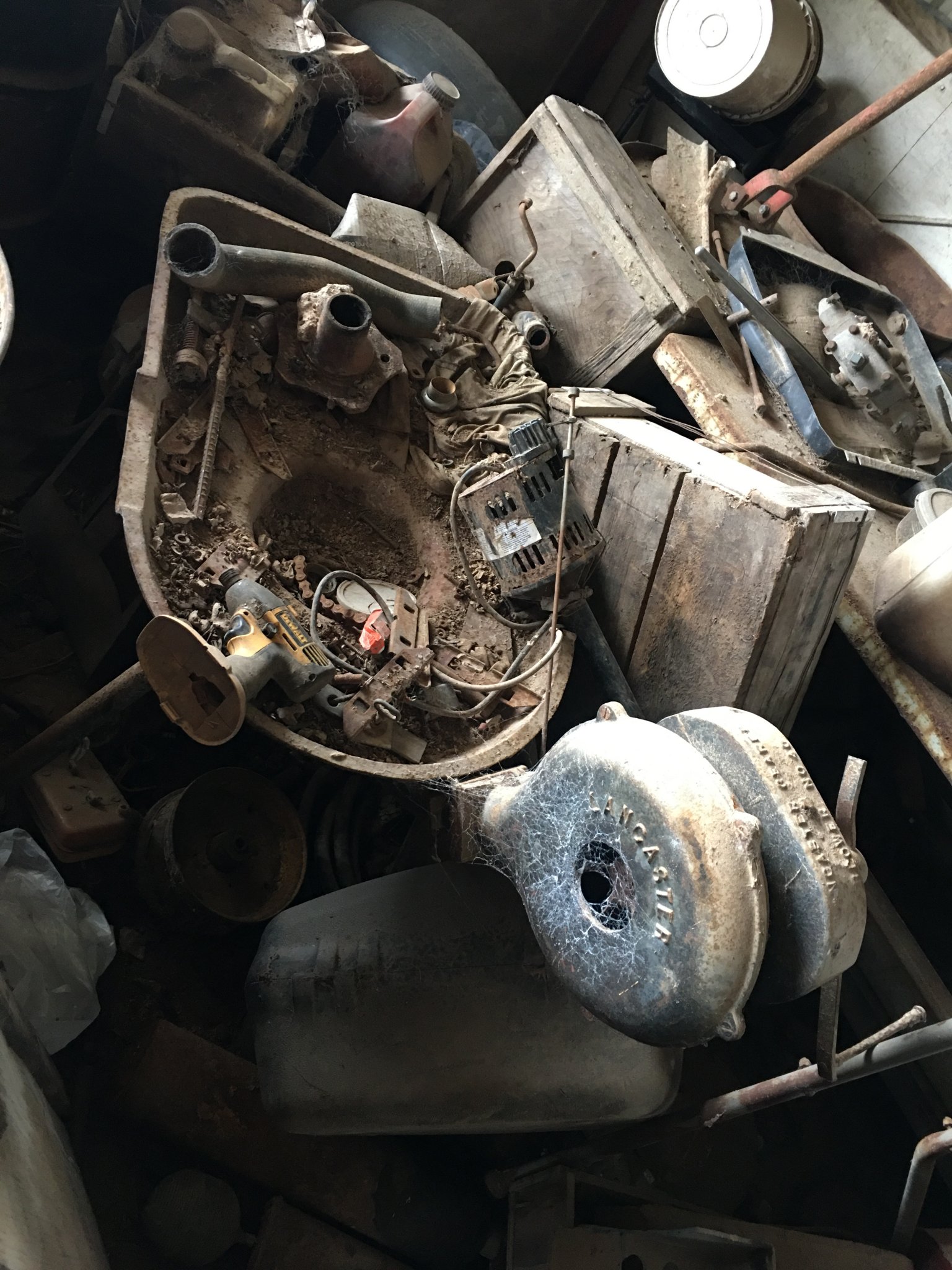

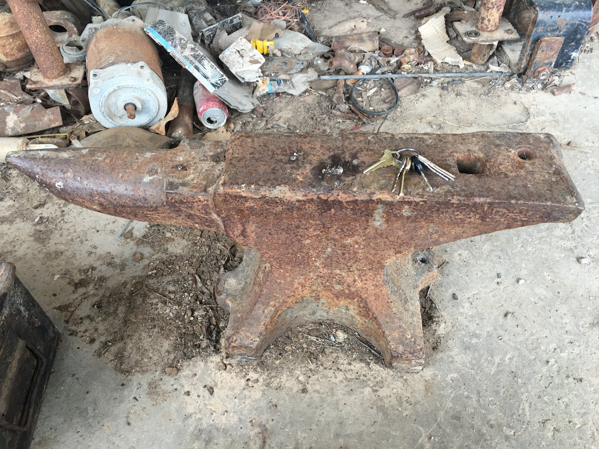

    My Father in Law, who was a farmer all his life, passed away a couple years ago, and we are still, slowly, going through his stuff. My Mother in Law told me to go through his shop and see if there’s anything that I’d like out of it. Most of the tools have been since stolen, by a POS that was one of his helpers, but there is a couple things I’m thinking of keeping and trying to save, his forge and anvil. This thing is probably older than I am, and he used it when he was younger. It was probably his father’s and maybe even his grandfather’s. He even had a blacksmith shop, that has long since deteriorated and collapsed.
    What do y’all think, is it worth trying to refurbish and get back in working order?

    See if you can find any forge markings on the anvil. It looks good and if it is a true forge and not a cast anvil it can be easily be resurfaced and the edges cleaned up.

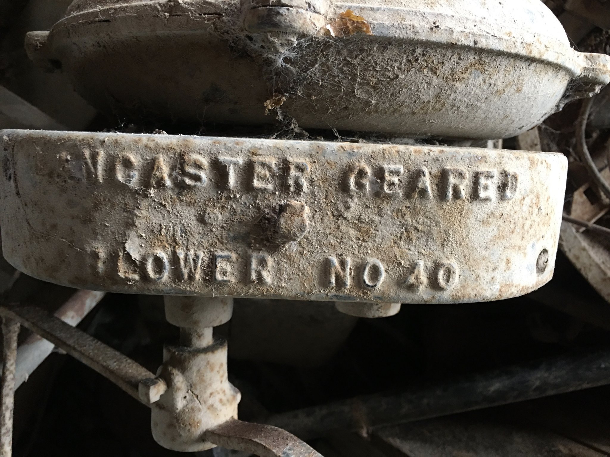

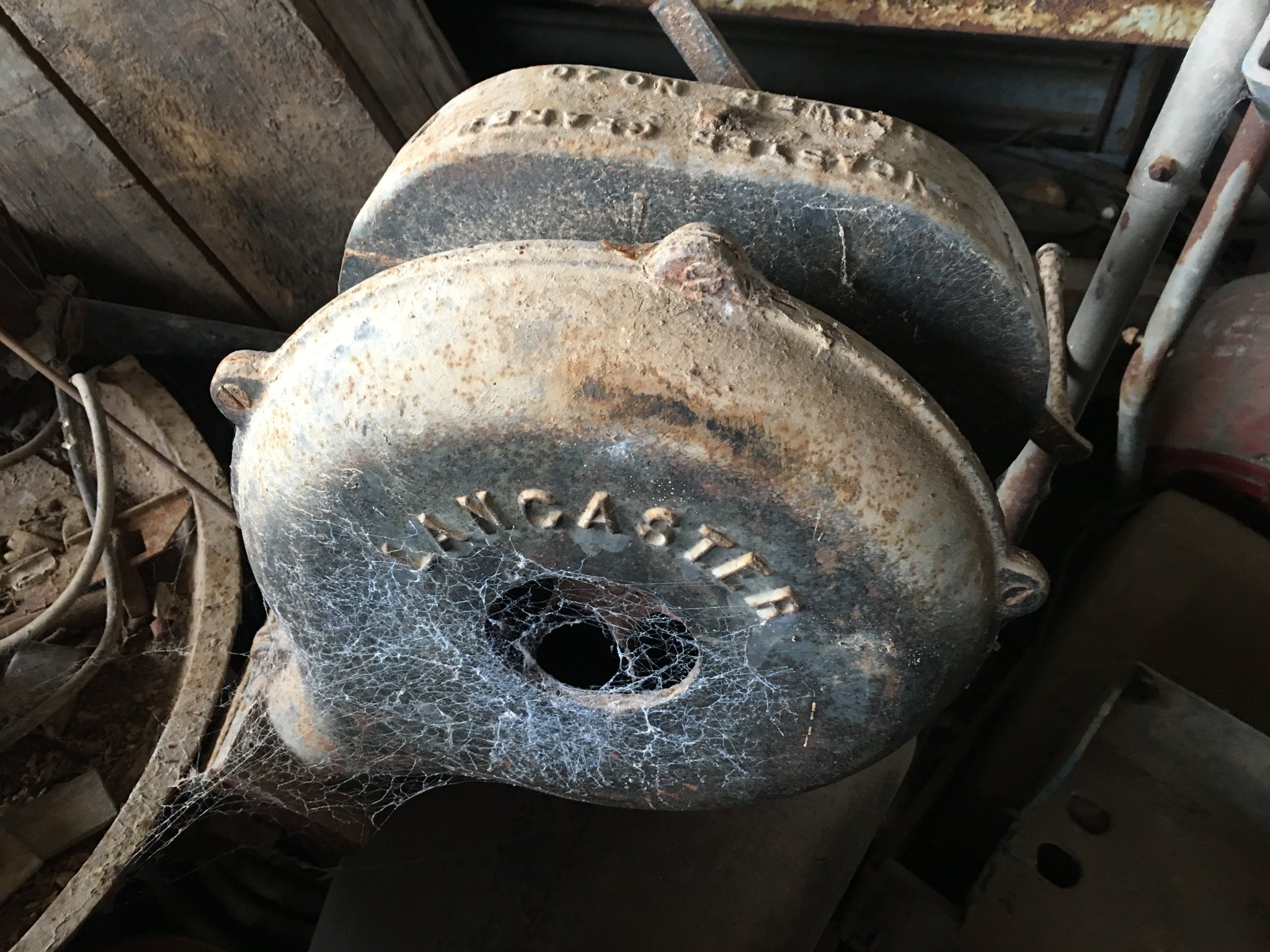

    The fire forge, maybe....depends on parts that are still there. Even if the blower can’t be rebuilt, the pan and chute could still be made to function. Coke fire and a small electric blower.

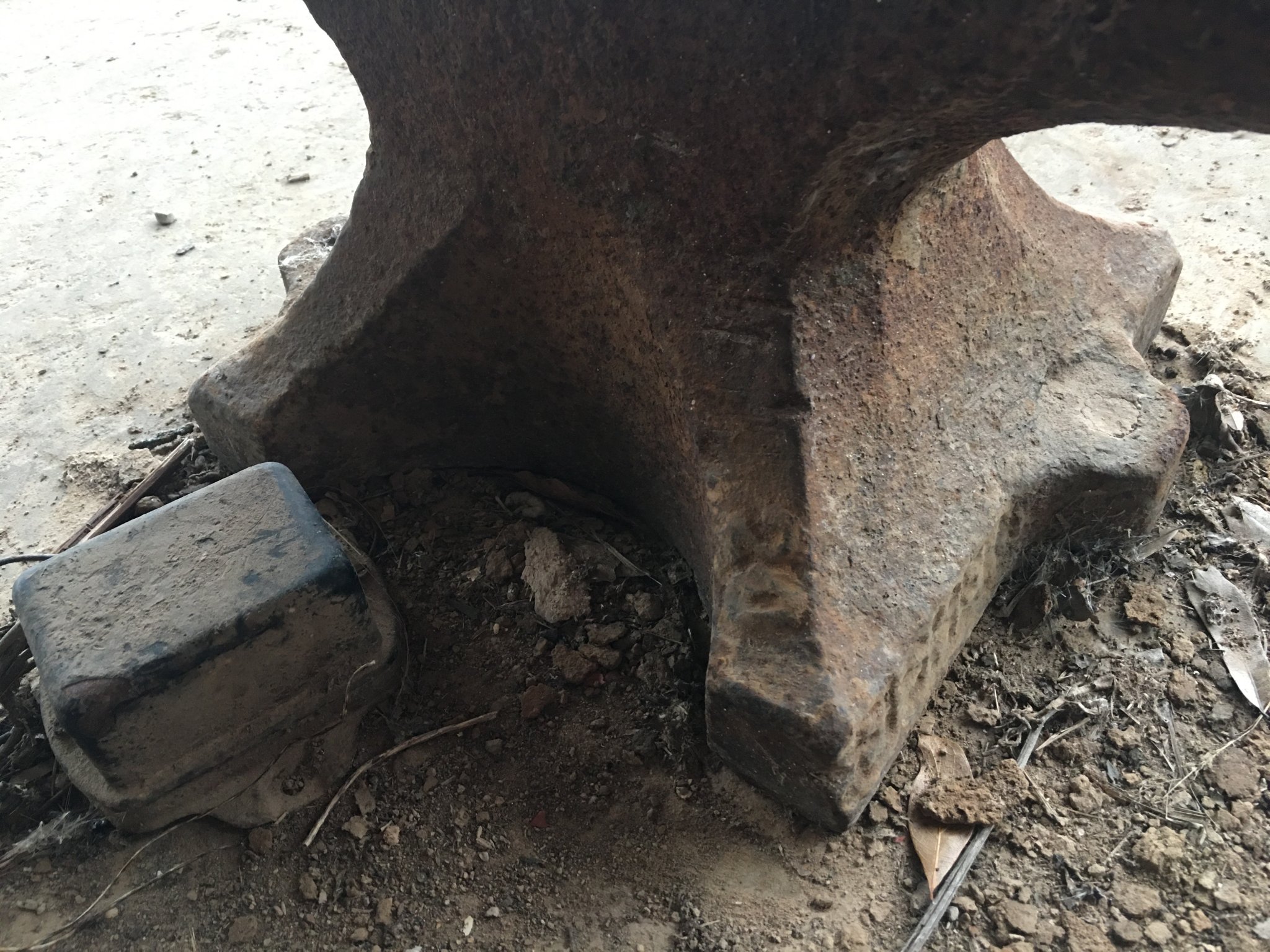

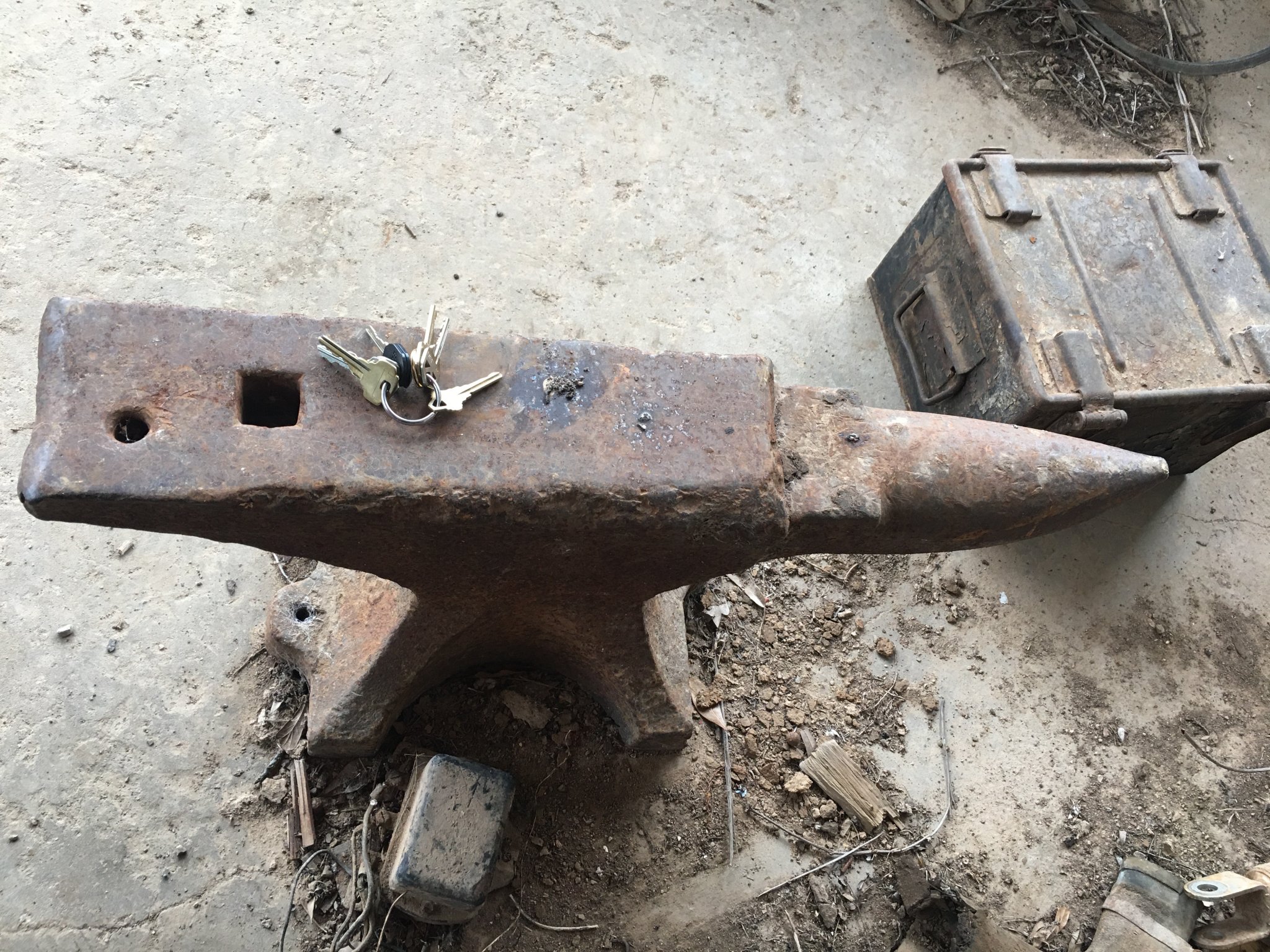

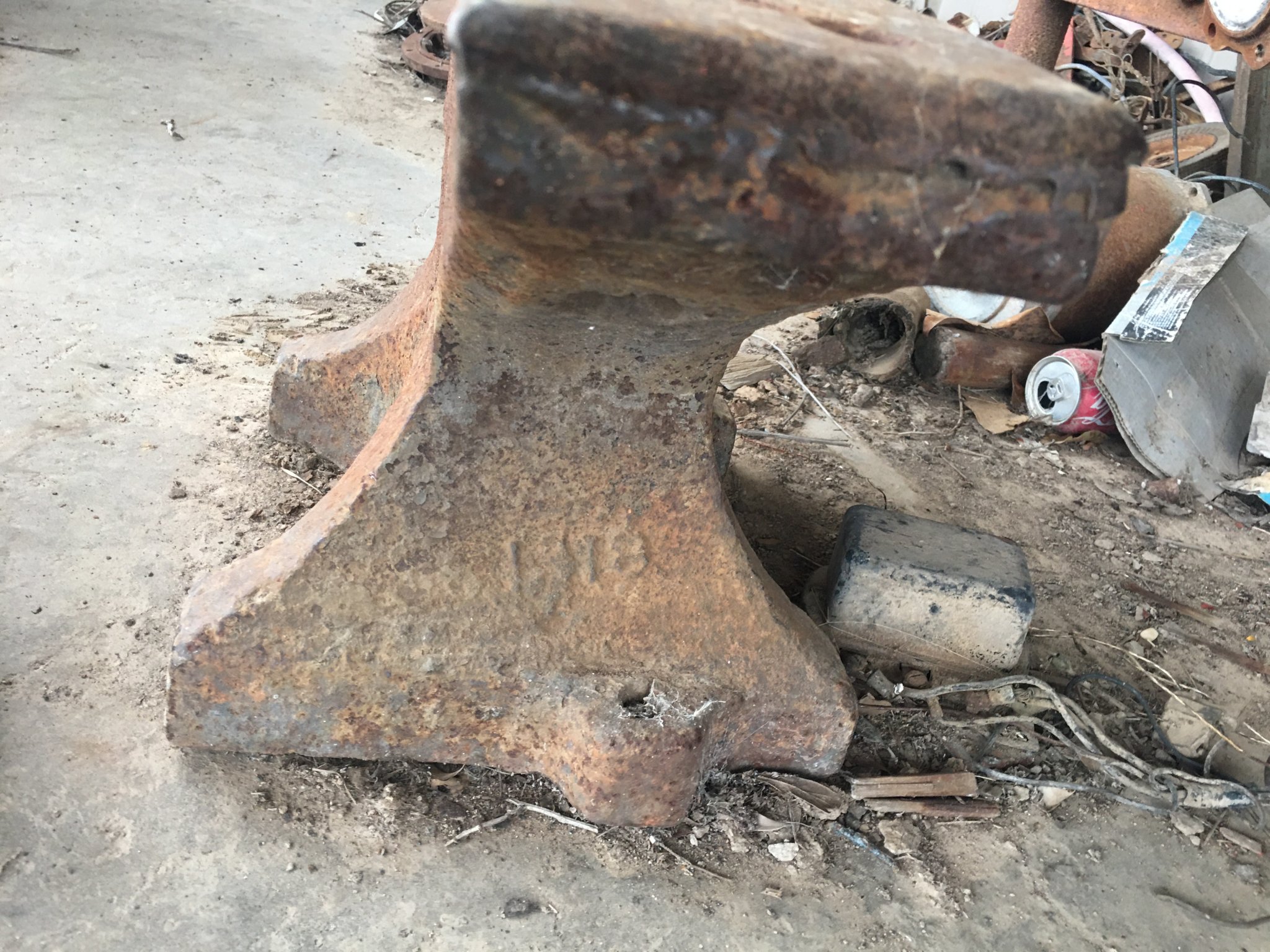

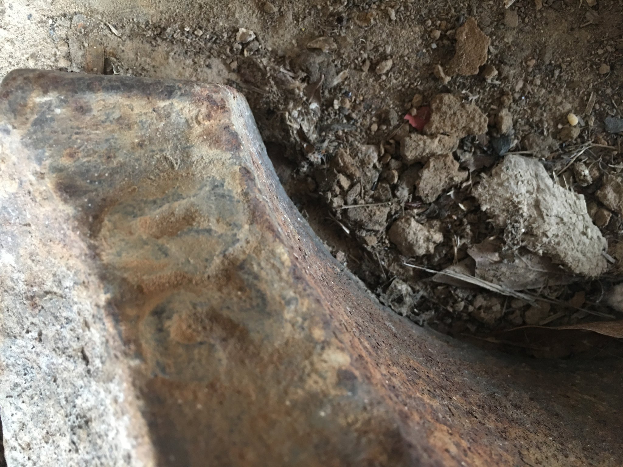

    If you're going to try to repair the anvil do a fair bit of reading on it first. You can do more damage than you're fixing by improperly welding the corners back up. It's also still got enough square edges to work with as is. You can grind a bit of a radius from the horn back to where it's still sharp at the heel where the keys are sitting in pic 3. That will both prevent the edge chipping further, and prevent "cold shuts" where metal folds over the steps left in the work by the sharp edges. The other side's pretty beat, but you could either smooth those chips out and use it as is for drawing metal out or build up and hard face if you want sharper corners all the way around. Personally I'd just smooth out it a little bit with an angle grinder and flap disks and use it like it is.

    Sell that anvil off and buy one if you want it. That thing is a pile. No cost effective amount of resurfaceing will fix that thing. I'd pour some coke into the forge to see if it's worth salvaging too before i made any decisions.

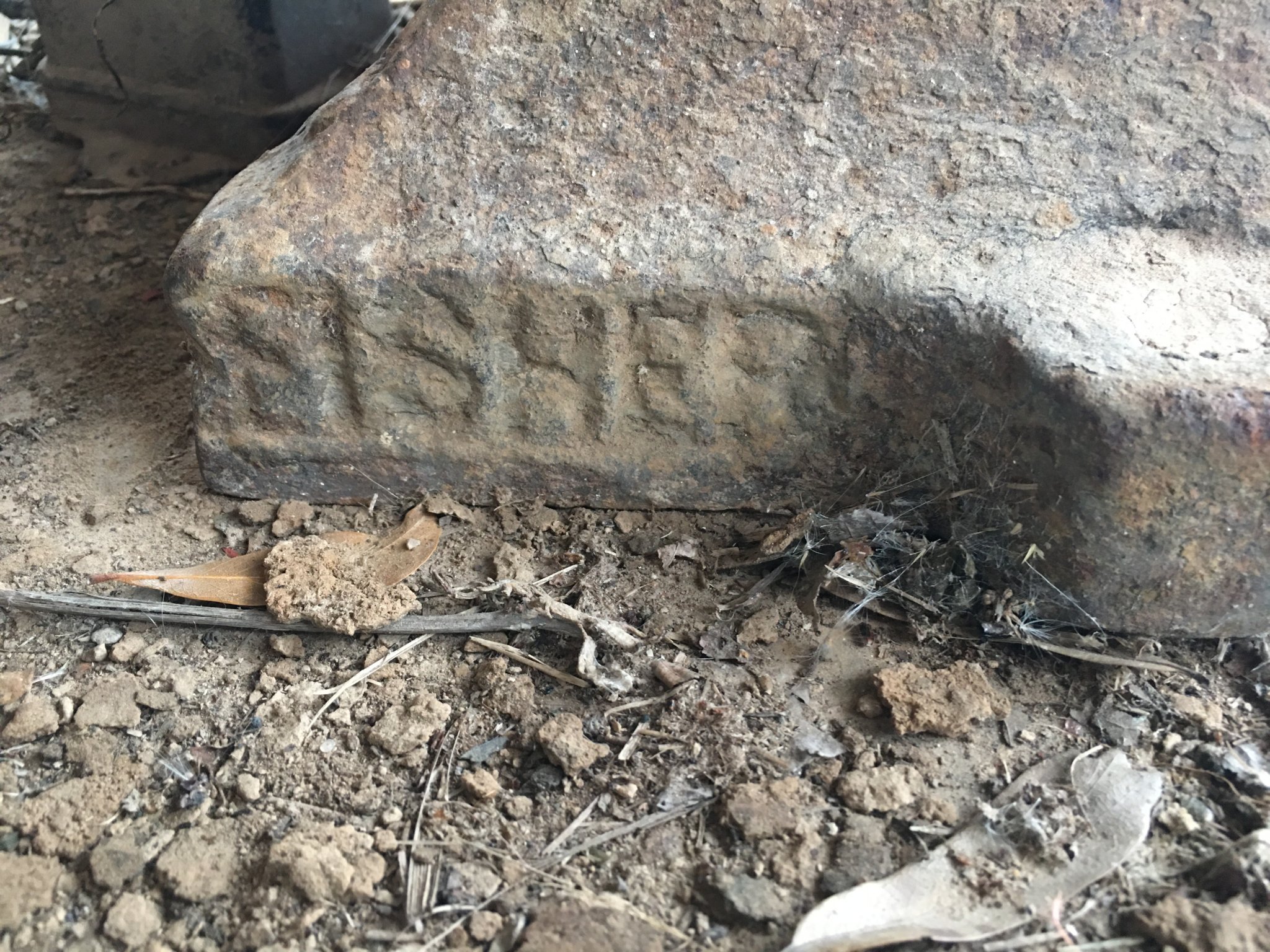

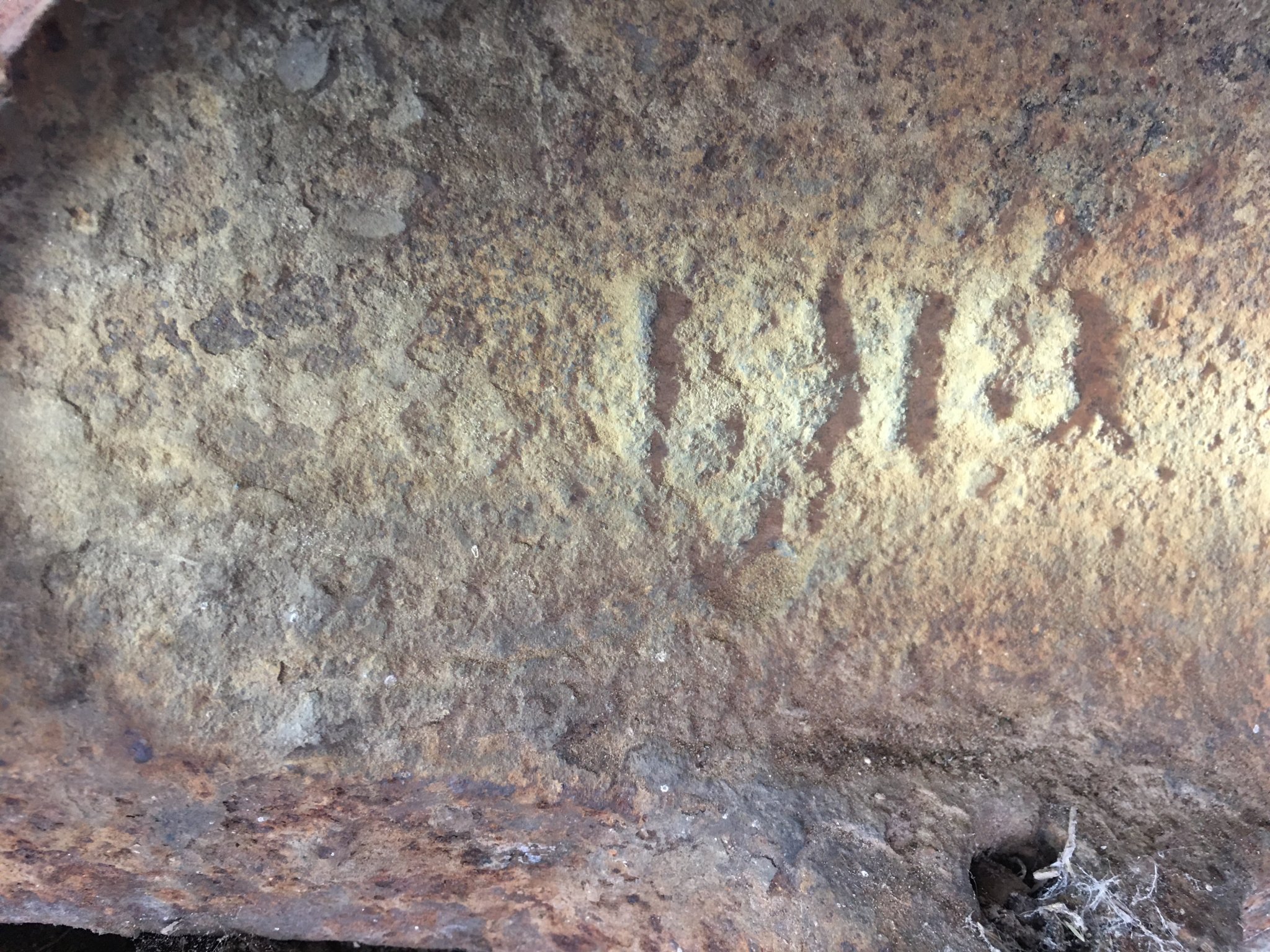

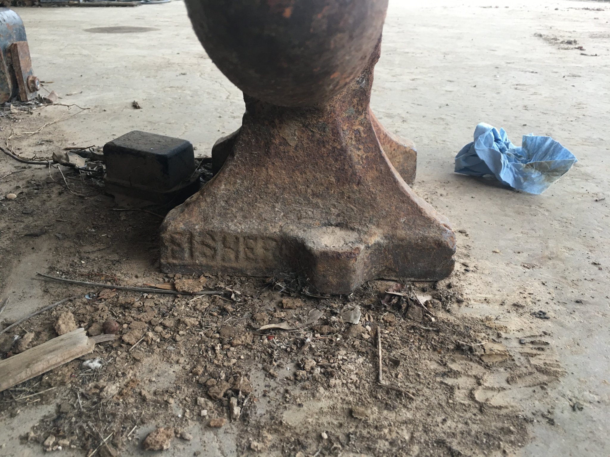

    Here are the marking I could find on the anvil. If there’s anything else, it’s covered with rust. Maybe a good wire brushing will reveal more.
    Reactions: Slash0311
    Fishers are cast body's with a tool steel face. You can see the seam pretty clearly in the picture of the heal. They're supposed to be very quiet compared to other anvils. Other than working around the chipping I think that thing will be very serviceable for hobby work.
    Reactions: Srgt. Hulka
    Fisher is a good anvil. Forged face cast body, just as others have mentioned. Clean it up and use it. You can still do a lot with that anvil. Horn looks good and the step is still in good shape so it should be suitable for any off sets and bending on small scale where you need a good sharp bend. I would use it and learn, then keep it as a spare and upgrade. Make sure the face welds is still good and make sure it has good rebound. Do you have any hammers?
    Sometimes it's not about whether or not the product is useful or can be rebuilt. The value is in the fact it's from a family member. Sometimes it's worth saving for that alone. Wouldn't it be nice to set up a replica of that man's shop? If you can't do that, just put it up so that maybe another generation may take on that task. I'd love to have something from my grandfather or even great grandfather.
    Thanks for all the replies and help guys. I’m going to wire brush I, clean it up and oil it, first and put it in the corner of the shop. Use it as needed. If the time comes it needs to be rebuilt, I’ll look into getting that done. It’s certainly nothing I could do without causing further damage to the anvil.
