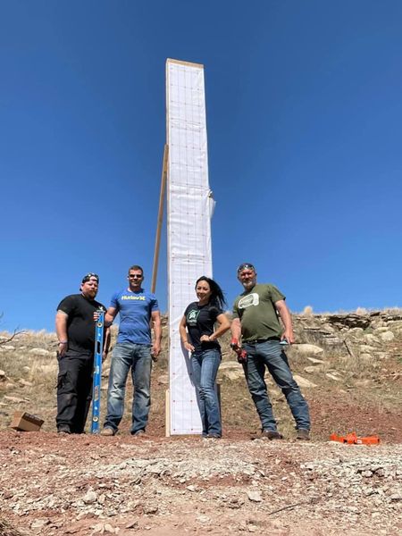

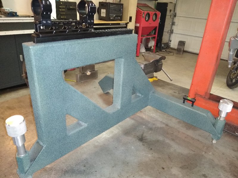

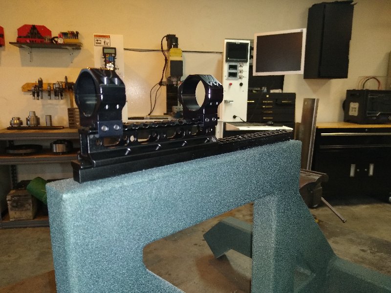

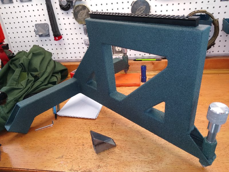

Most people don't have access to one of these fixtures that Frank is using. Really, every guy has to have something like this to shoot accurately! Sure you can mount your gun in a vise, and check it against the black sharpie line you drew on a 4'-5' piece of cardboard.
Most people can acquire a piece of cardboard to do this test. The plum line was made using a 4' level, of course it's plum to the Earth! You'll be aligning that plum line with your reticle so YES when you fire a round it's vertical! Dial another 5 mils and fire a round, dial 10 fire another round, go to 15 mils if you wish, go back down. They should have all gone vertical to the plum line. Now measure where your rounds landed, 18", 36", 54".
That's not hard to do, most people don't have access to a scope fixture unless they take Frank's classes. Frank is very good at what he does, in fact he's exceptional! I have a lot of respect for Frank, he's helped more people in this sport than anyone I know! I met him when I shot the 2014, and 2016 SHC. I only stopped shooting the SHC event because I had been shooting Carl Taylor's In-Motion Kettle Falls Steel Challenge since 2014 and didn't care to shoot another Team event in 2017.
I've shot more than a few PRS/NRL and CD events since I retired 7 years ago. I guess I just prefer to shoot more, and post less.... Which still means nothing, but that's Ok with me. I was attempting to show a way for the layperson to make sure their scope is tracking vertically while it's on their rifle!

Scrap piece of timber, couple of screws, old pic rail, sandbags. There's your tracking fixture.
Hang up a tape measure. There's your calibrated plumb line.

So shooting a tall target is a total waste you say!!! This was for testing before the Spearpoint ELR match that a friend of mine and her friends made for testing their rifles. You'll down play that too I'm sure..... "You Don't need to fire a round to test for your tracking to calculate where your bullets are going"....
I know more than a few people that compete on a National level that would look at me like I was trying to sell them something if I asked them if they use a scope tracking device vs shooting. But hey, I'll ask Jake Vibbert tomorrow when I see him. I'd bet he'd laugh, USO makes sure their shooting staff has something that works. How about George Gardner of GA Precision.... I'll text him and see what he does?
Backtracking, No, anybody can do that tall target test and see if they've mounted their scope level, and where their bullets are going. Concentrate... back to KISS.

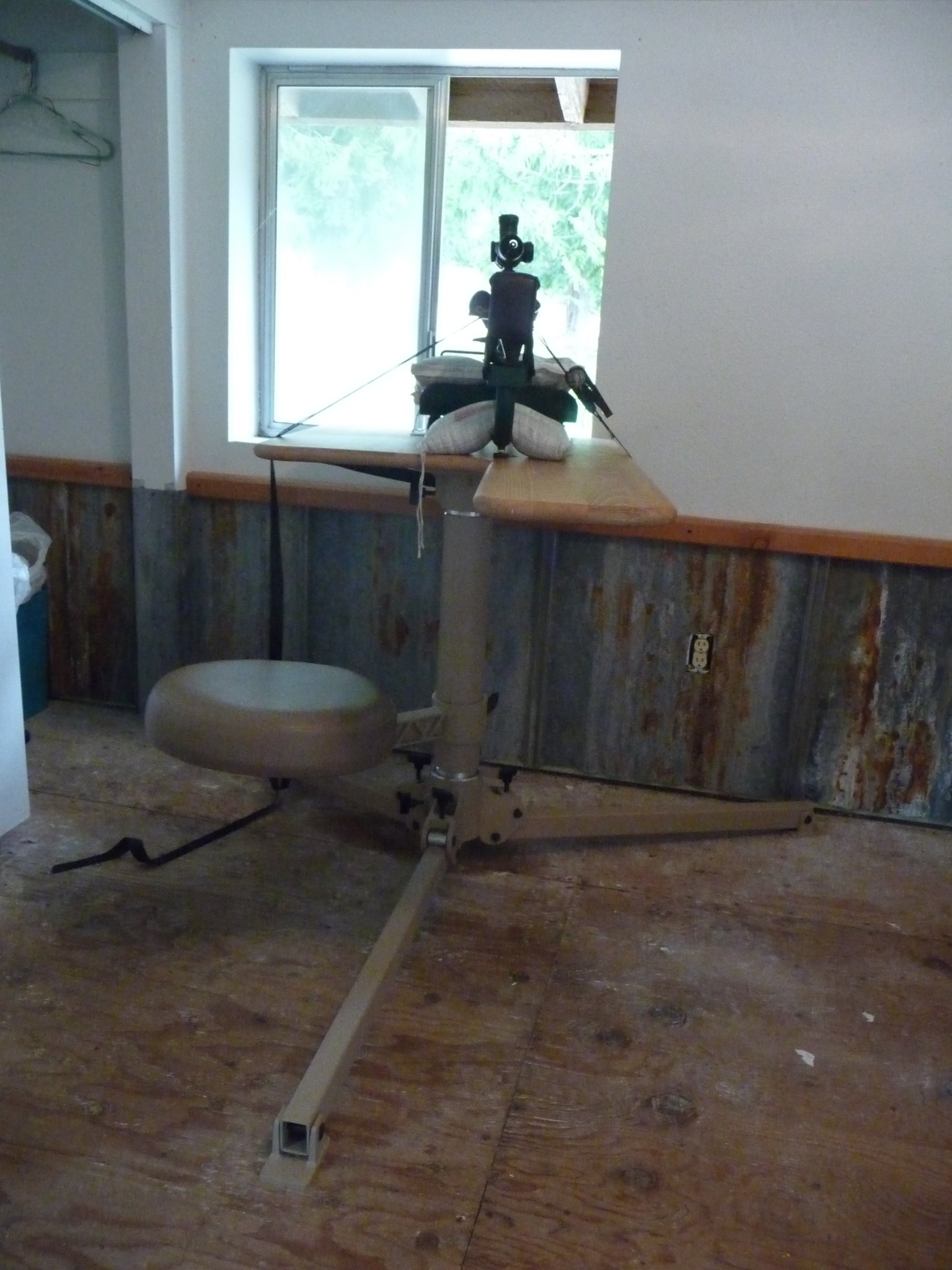

I made a scope fixture last year.
I built it from a few bucks worth of scrap steel, and a cheap ebay picatinny rail section attached with screws and rivnuts. About 50$ total and a couple hours of work. It makes checking reticle subtensions and tracking a snap.
Given the difference between which brands internet tards say don't track vs reality, I wanted to be able to accurately check things for myself. It's usually just Bear Pit dwellers hopping in with typically well thought out one-liners though.😁
