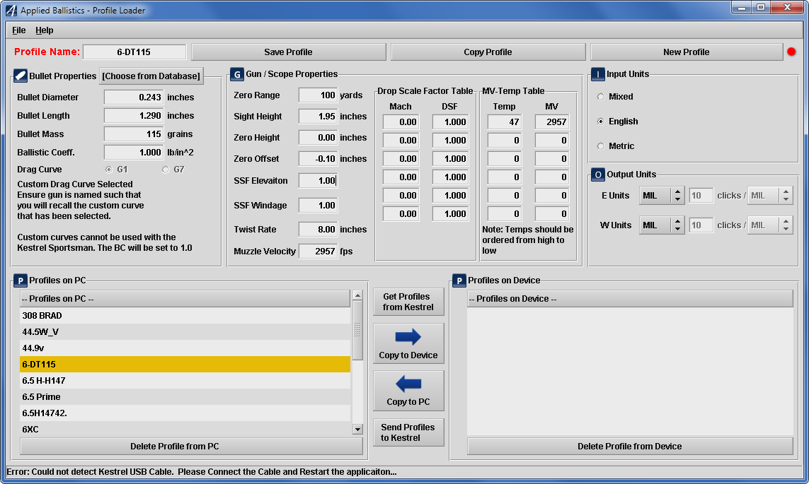

With profile loader you can add the factor. Save and transfer to your Kestrel. I never checked the results since my scope tracking is spot on.
'SSF' = Sight Scale Factor.
Thanks for the Infos. First of all, I think it was the same "Doc" who wrote me to use the ELD Match Data.... So my expectation is lowered, that there will be a happy end.

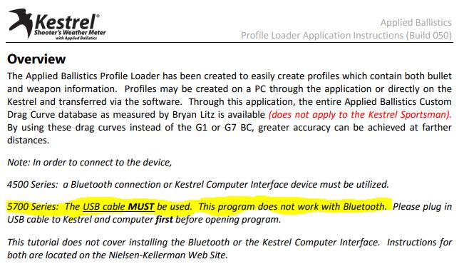

Regarding Profile Loader: Thanks for the Tip, but I do not have a cable. I have the Elite with Bluetooth and use it combined with Android Phone. I paid 100 Bucks extra for bluetooth, so I did not need to buy a cable. However the "Kestrel Link Ballistics" App does not have the SSF functionallity and AFAIK the AB Profile Loader needs cable and manual says it does not work withe the Elite over bluetooth. Only via Cable.... So I need to buy a cable for my bluetooh Kestrel ?
if i can upload my firmaware via BT i dont see why the BT dongle wouldnt work with the profile loader. we blame AB for much of this but fact is its often hardware limitations and that is NK not AB. i would try the dongle just to see.
Sorry, I do not have the Bluetooth Dongle. I have internal Bluetooth in my Laptop. I can see an connect my Kestrel, so no Hardware restrictions.
But the manual of AB Profile Loader clearly says: "This Program does not work with Bluetooth" for the 5700.

Cable arrived today, nothing has changed.
- ELD-X 178 not available in AB Profile Loader
- SSF has no effect !
After working around their bad programming habits (needed to set . instead of , as decimal indicator in the Windows Settings in Order to get the Tool to tranfer from Kestrel), I created 2 identical profiles. Only Difference is the Name and the Elevation SSF. Both created the same Firing Solution. So no effect.

The Kestrel does not have SSF. The AB Elite engine supports it, but that is not a feature in that product. If you would like to see it as a feature, then please let them know. We can only add in features that the parent company wishes to have in their products.
I just returned last night (very late) from Europe (IWA). In order to make sure that users information was not compromised I did everything only from secure network connections. While this limited my ability to respond to everyone all the time, it was the safest way to handle them. This did cause a delay sometimes. Not meant as an excuse, but meant as an answer to why responses have been delayed.
We are working hard to update the library, and we plan to have another drop of new bullets. We are also going to take a look at both the 178s to see just how close they are in performance. However the reason I suggested using it, and the reason you see it in the list is because of a incorrectly labeled file name. The bullet is the ELD-X and you should very soon see an update on your app. It was the correct bullet, which is why I went ahead and informed you to use it.
Reactions: MilDot1960

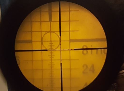

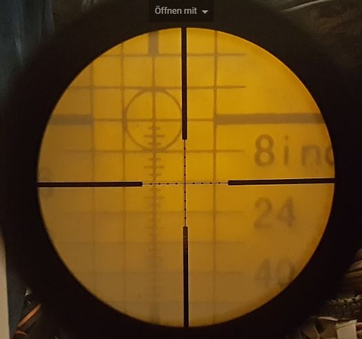

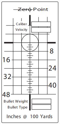

EDIT: Just checked the Scope, you were right: 0,25"@100yd per Click. So I did the math again, but the result is the same 0,268 MOA/Click or 0,28 SMOA/Klick, wich makes the Deviation from Nominal even worse.
EDIT2: Re-Checked it with Leupold Zero Point:
Zero Point´s Reticle is also in Inches / 100Yards (Pic1)
Photographed my Rifles Zero (Which happens to be a bit OVER the 8 Inch Line)
Dialed 8 Inches UP and took a Photo (a bit BELOW the 16 Inch Line)
If everything would be OK, 8 UP should be a bit OVER 16 Inch Line.
See for yourself.....

math has already been done and the SSF is ready to be applied.
It could be multiplied with the Kestrel Elite´s firing solution manually, but when I need an additional cell phone I might as well use a different ballistic calculator.

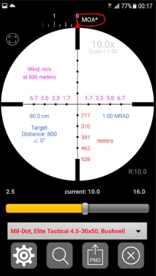

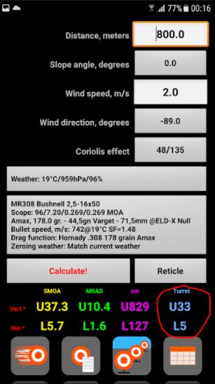

Strelok Pro had a simple custom Click Value from the beginning. You could simply define, that 1 Click is 0,124 MOA or Whatever.
It would show firing Solution in MIL (MRAD) MOA (or SMOA) and Clicks. Unfortunatelly Turret Labelling became useless this way, because you needed to count clicks. Becomes a PITA when needing to do several full rotations of the turret.....
So I asked Igor Borisov to use the Custom Clicks and label them with *, since those are not the real units anymore.
He did it 1 week after my request in the "Reticle View". That was a great help. Now, some months ago, he added a button, that says "Show clicks in 1 3/4 Layout", which now gives me the firing solution directly on the right page, still in MIL, MOA AND in my Custom Click Values (labelled Turret). Very Comfortable and all errors are beeing adressed. That´s the way to do it ;)
View attachment 6890101View attachment 6890102
In Strelok Pro you can choose MOA and MRAD, and SMOA per 100yds and CM's per 100 meters, but I am not sure about AB. ?
