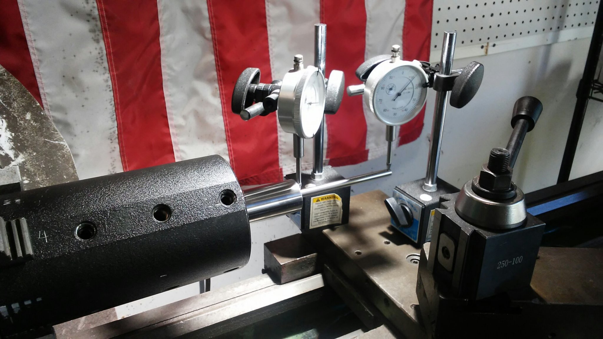

1 1/16x18 .980 to shoulder and 1.115" from shoulder to base of headspace gauge.
Just make sure when you thread, if your gunsmith uses wires like myself, the measurement is 1.0715", +0.000" or -.002" using .032" wires. THIS HAS TO BE WITHIN THOSE MEASUREMENTS.... Kelbly's machines their actions with extremely close tolerances so make sure your smith understands their hit or miss zones.
SERIOUSLY. Make sure they understand.
Best thing about Kelbly's Actions so far? The fact that I can cut a barrel and not need my action there... Saves me time and I can have 3 "rifles" ready in about 3 hours. In fact, I had 2 cut and threaded for the BugNut system before my action was even shipped. Stupid simple.

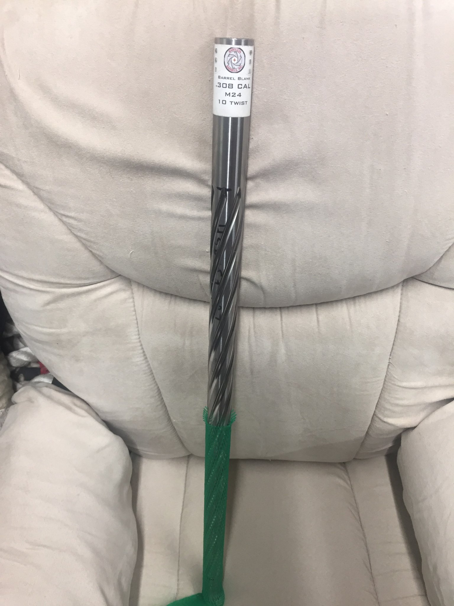

Thanks, I ordered it from Tom Manners. It is a awesome stock. I cut and chambered barrel and made my own pillars to bed on. That big flat bottom is like a dream to bed, absolutely 0 stress in bedding.

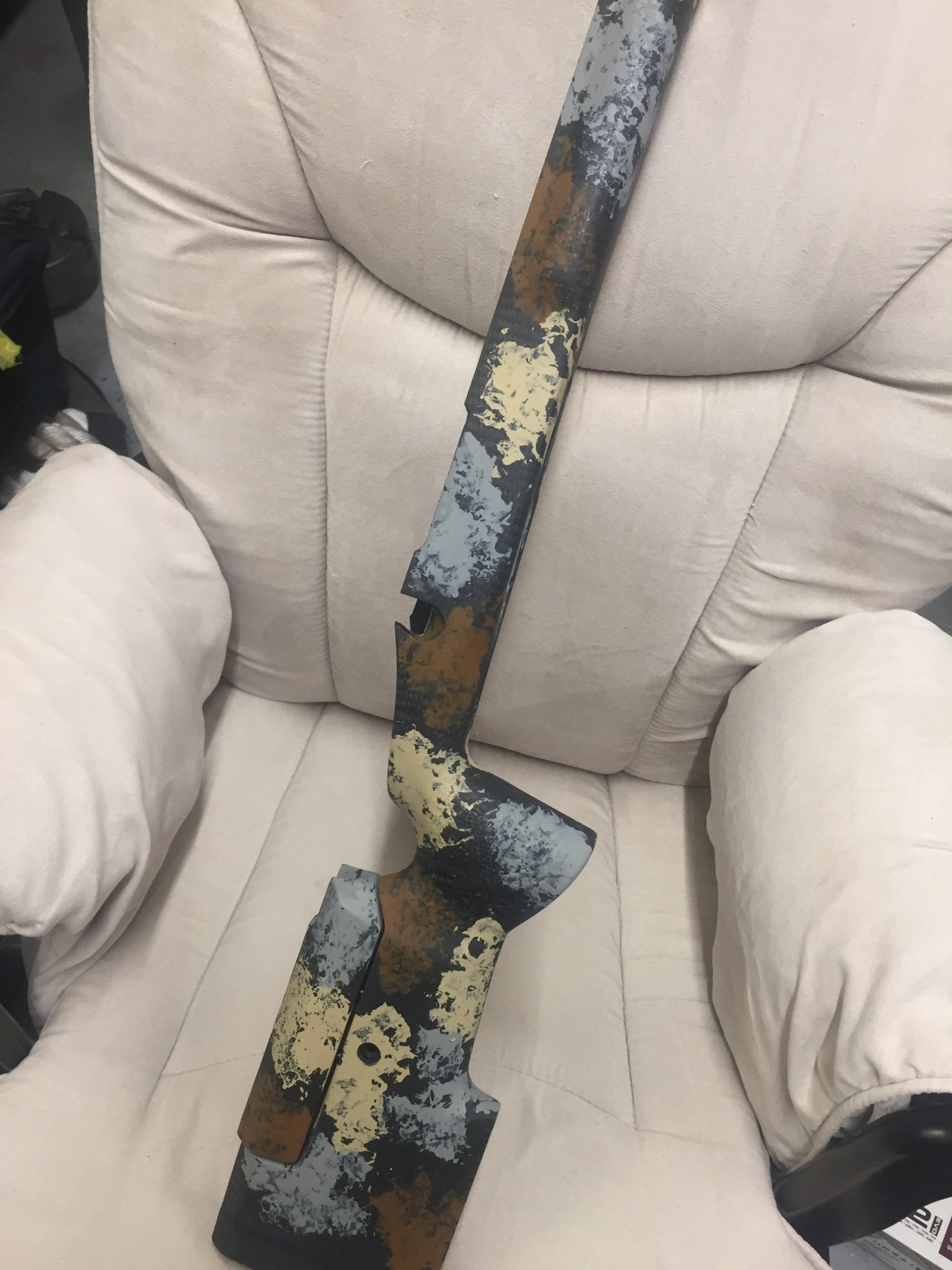

Inletting and bedding is complete on my Manners T4A, but before I could get all the pictures taken and put on here, I had to head out of town. I'll be back in the shop next weekend to finish chambering another barrel, cerakoting, and final fit and finish of the completed rifle. I plan to include pictures of the inlet (with dimensions) along with a step by step process for cutting and chambering barrels for Kelbly's actions (Including pics and dimensions).
I'll be at The Guardian Long Range Competition at Arena in Blakely, GA on the 13th and 14th of Oct shooting this build and really figuring out what the Black Bear's got. So if any of you guys are gonna be there and wanna get some hands on time, by all means, come talk with me.
Super excited to finally get some load data and downrange feedback. Probably gonna be shooting the 308 barrel.....well.....because the combination of the spiral fluting and overall look of the rifle is just beautiful and I enjoy the look of people's faces at matches when you tell em' you're shooting the three oh hate.
Overall, I'm extremely happy with this action, and that being such, have already started talking with Ian about doing a long action Black Bear or getting the Atlas Tactical SA to shoot in my AI AX chassis. It's had such an impact on the way I look at custom actions, that I'm selling my Ultimatum Deadline and quickly becoming a Kelbly's fan boy (And this is after handling Curtis's, Defiance's Tenacity, Big Horn's Origin, the Nucleus from ARC, and MANY others). It's just too simple and robust not to be a major winner.

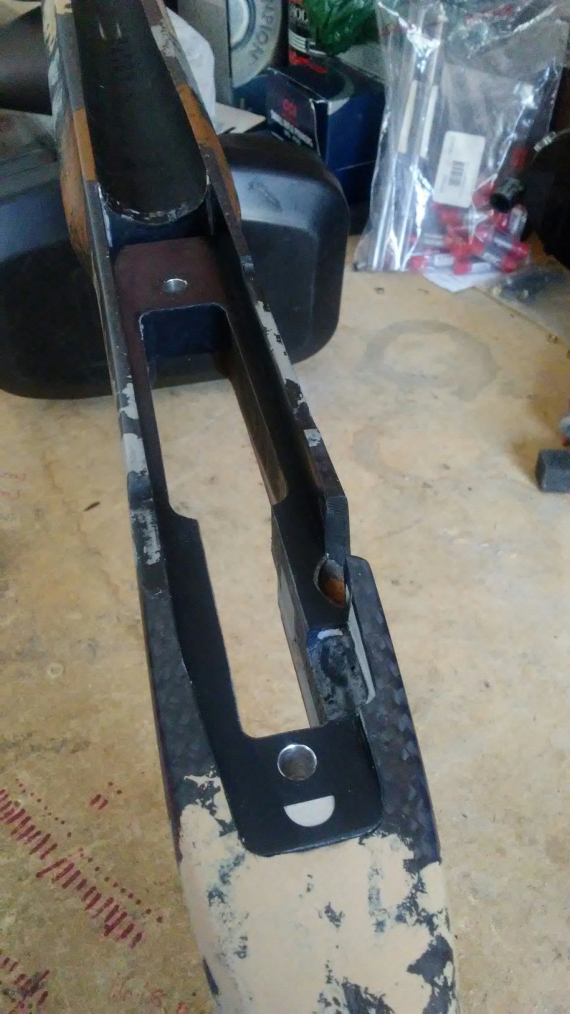

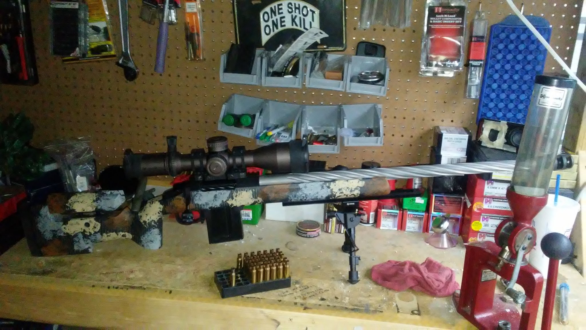

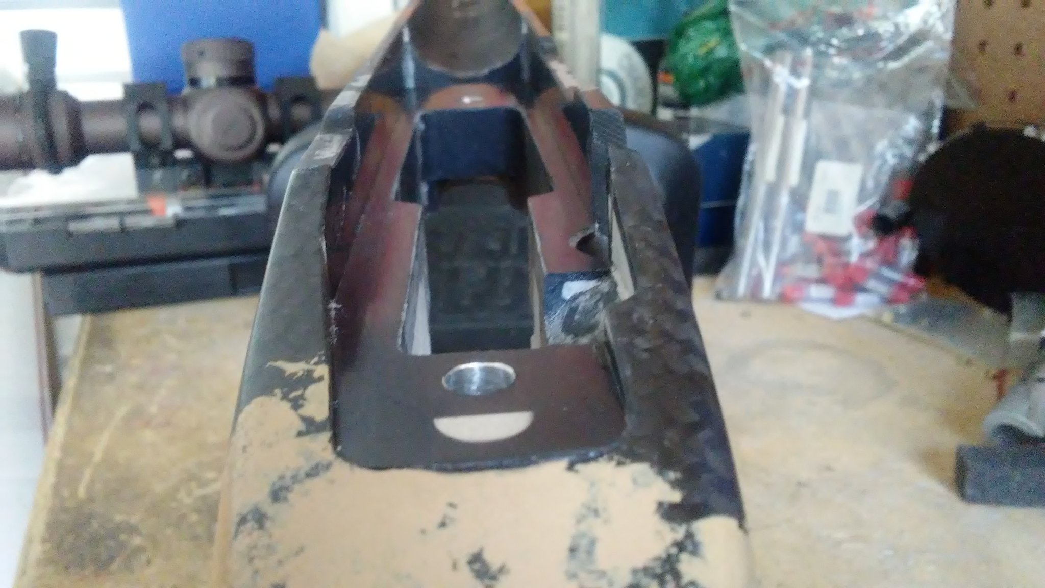

Alright gents,
Here we go. I've finished the rifle, well, 85% finished. I ran into some issues during the build this weekend and didn't get a chance to cerakote it like I wanted to. I love the way the rifle turned out, but I can honestly say I struggled completing it. Nothing to do with the action or parts I selected, everything is perfect, but I'll just say this.... Pay attention to you're machine and don't let anyone mess with it. I got a nasty surprise during chambering that could've been avoided.
Anyways, for the guys interested in the footprint. Here's your pics and measurments:
- OVERALL width of the footprint should be, roughly, 1.600" keeping in mind you need area for bedding. Mine is roughly 1.407" after the bedding was completed.
- Recoil lug width should be the exact same due to the action having a straight cut, integral lug. Depth to the bottom of the lug cut from the TOP RAILS (AKA top of the stock sides) is .970 AFTER BEDDING. Smartest idea is to cut the lug slightly deeper to get a good bed.
- Depth for the ENTIRE length of the action, from bottom to the top rails (FOR ME), was .770" after bedding. That's measured from the tops of the pillars to the top rails.
The tang is obviously drastically different and needs to be tapered from the 1.407" down to the surface of the original tang cut. Best thing I can tell you is to go slow, prefit measure, trim, then refit until its a tight fit. Don't be freaked out by how high the tang sits out, it's just part of the package. In my opinion it still looks great.
My pics don't due this inlet any justice... The barreled action is super tight. It LITERALLY clicks into place.

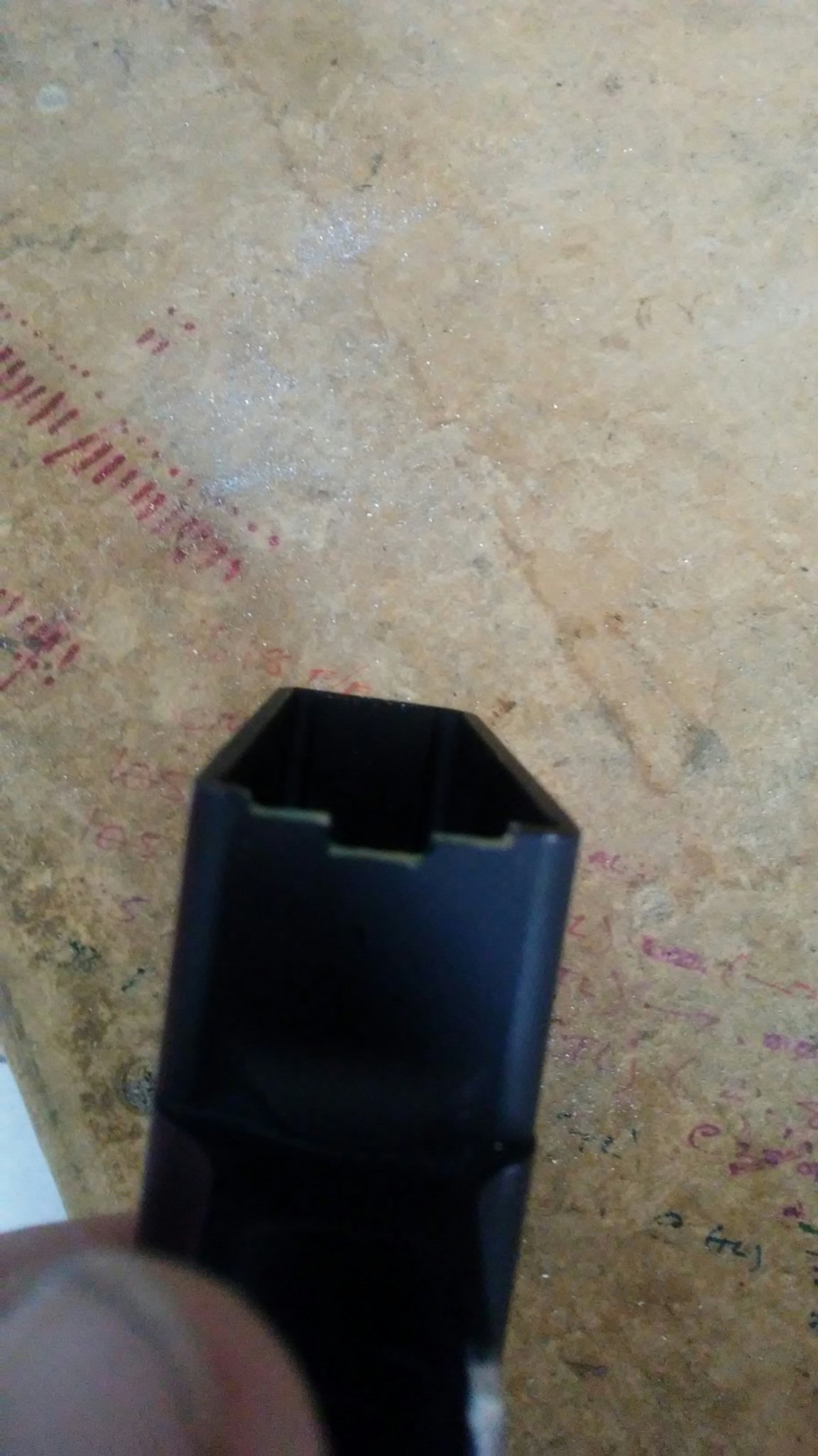

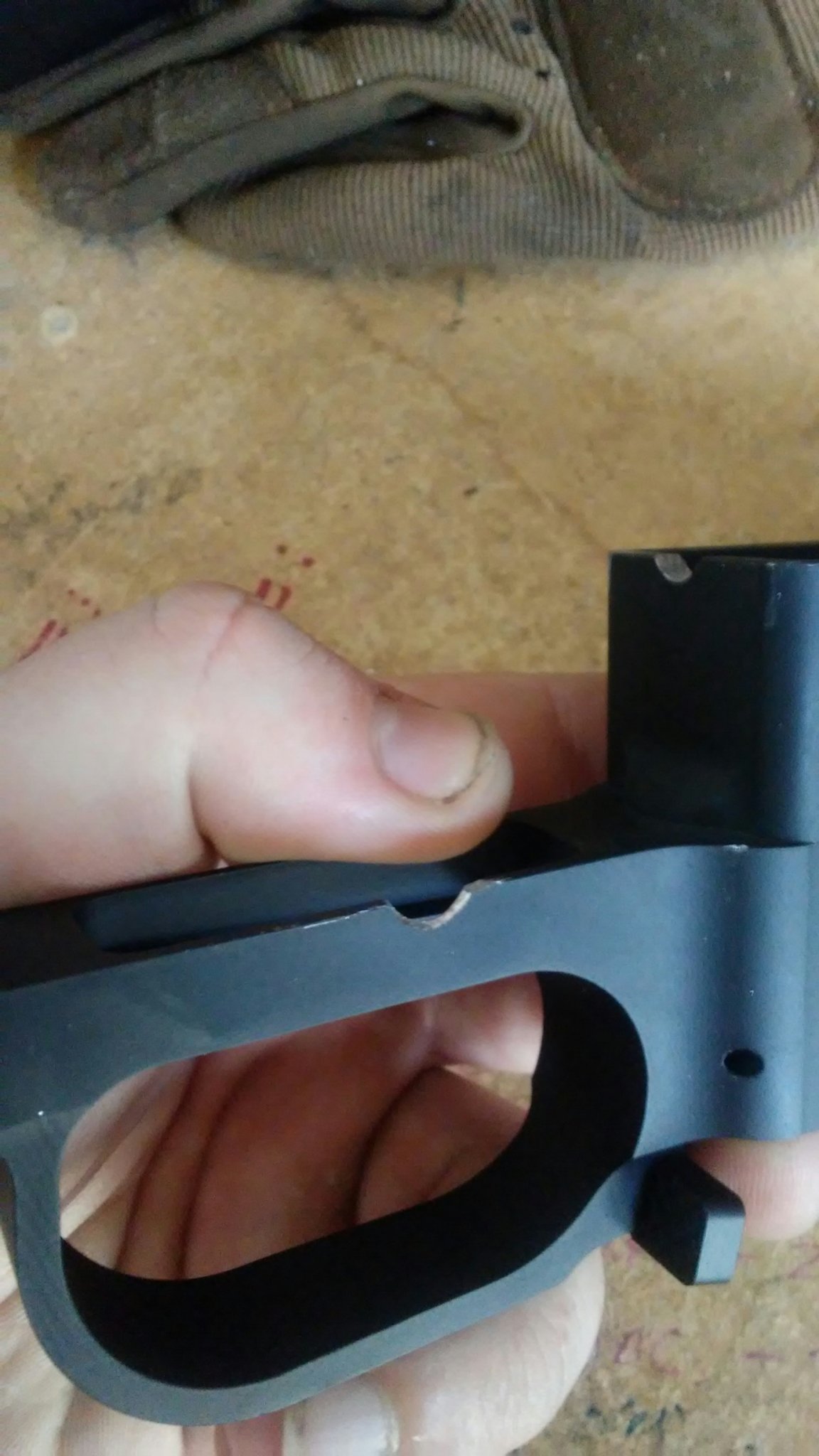

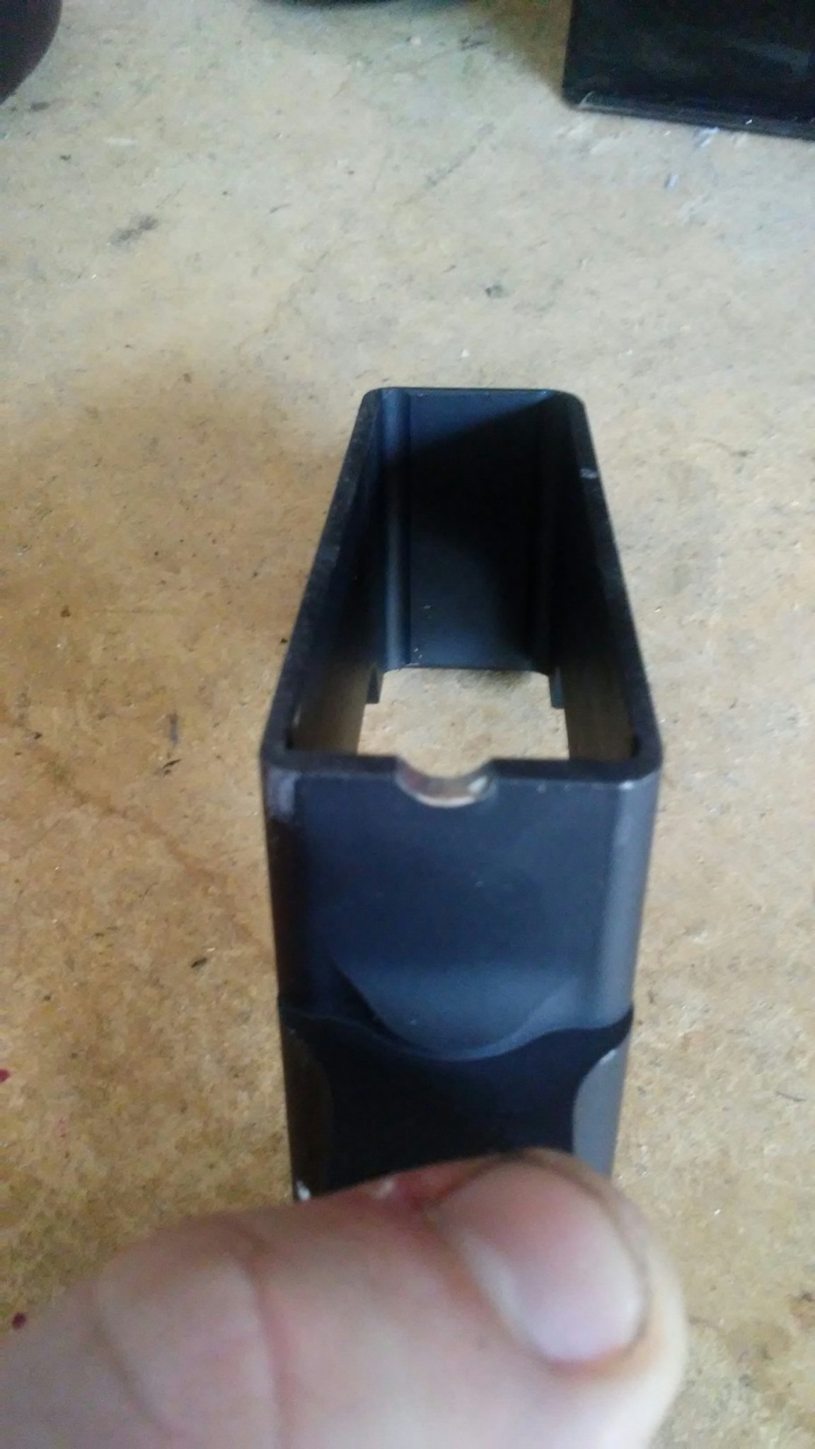

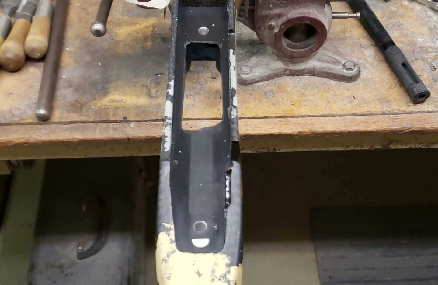

Next is the M5 bottom metal. I bought my stock as a REM 700 cut with a M5 inlet, so I didn't have to worry about inletting the DBM but I did have to fit the M5 to the action itself. Here's what I mean:

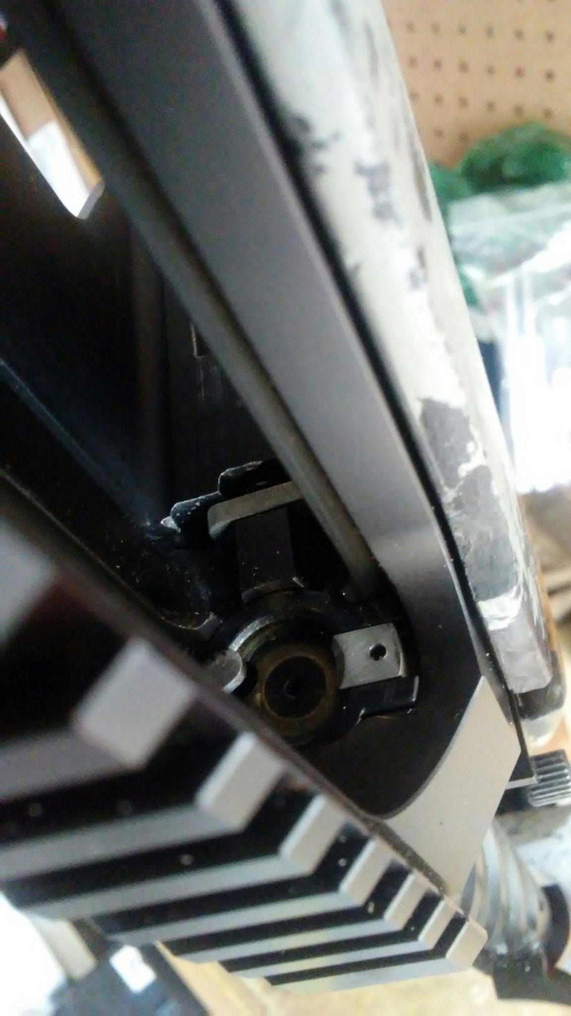

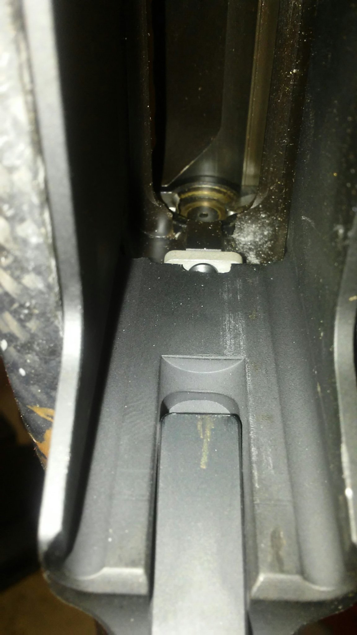

As you can see, the trigger hanger touches the DBM mag sleeve and created an issue with getting the action to settle completely. I filed a rough cut to see how much needed to come out for the hanger to clear. This was just a rough cut, yes I know its off center. Settle down.
After looking more closely, I realized the screw itself wasn't the only area that needed to be clearance for. I went ahead and sectioned the mag sleeve for the screw and the actual hanger itself.

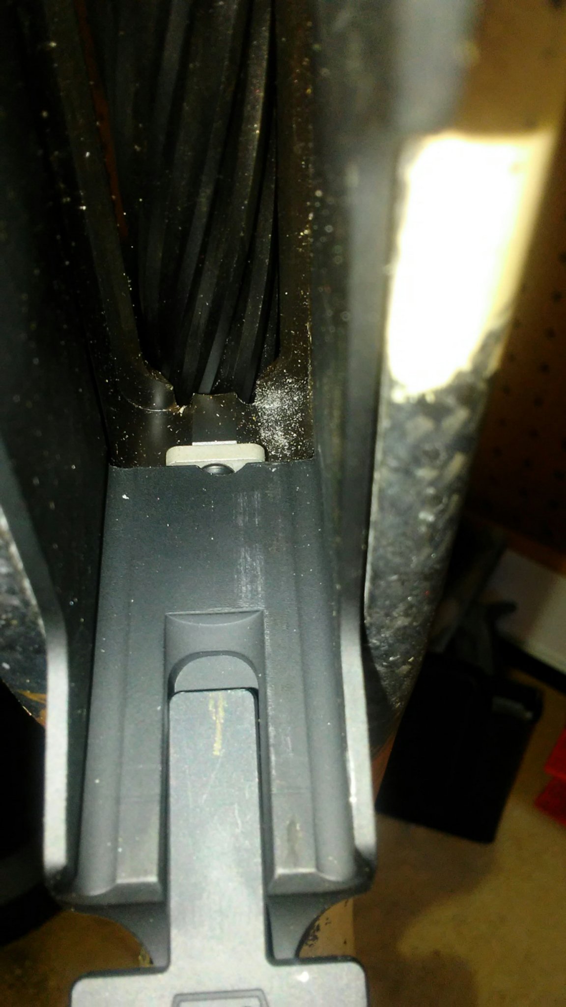

Continuing with the Mag sleeve, I fit, filed, and refit the M5 multiple times to make sure I was getting correct clearance. If you're doing this, GO SLOW, and make sure you only take off enough to make the room. You'll save a bunch of headaches.
Close view through the ejection port. Clearance made to allow the action to settle naturally in the bedding.

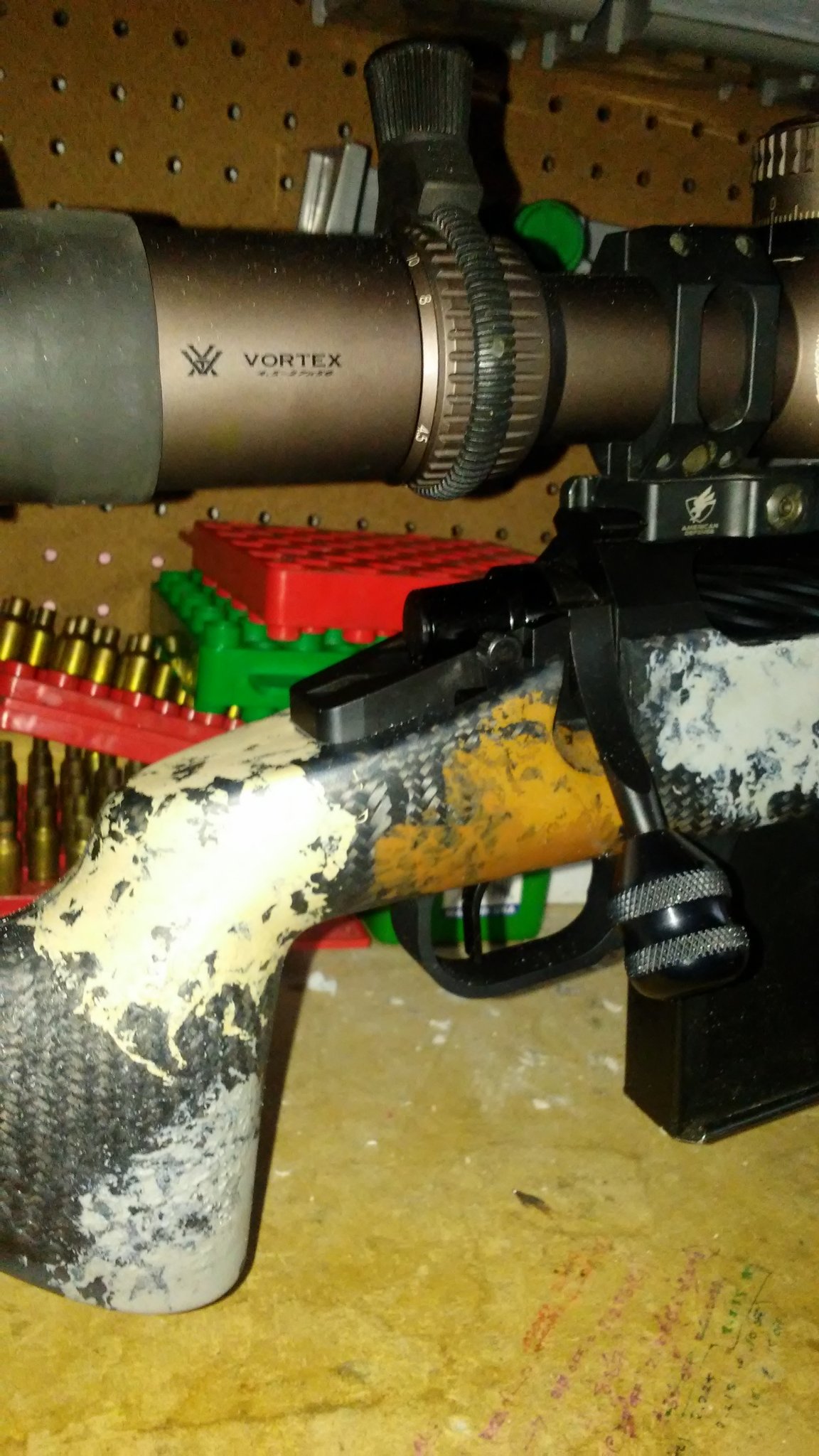

FOR ME, I had to also clearance the DBM for my trigger. I was having an issue with the side of my Calvin Elite touching the trigger guard so I filed a small section for the guard to clear.

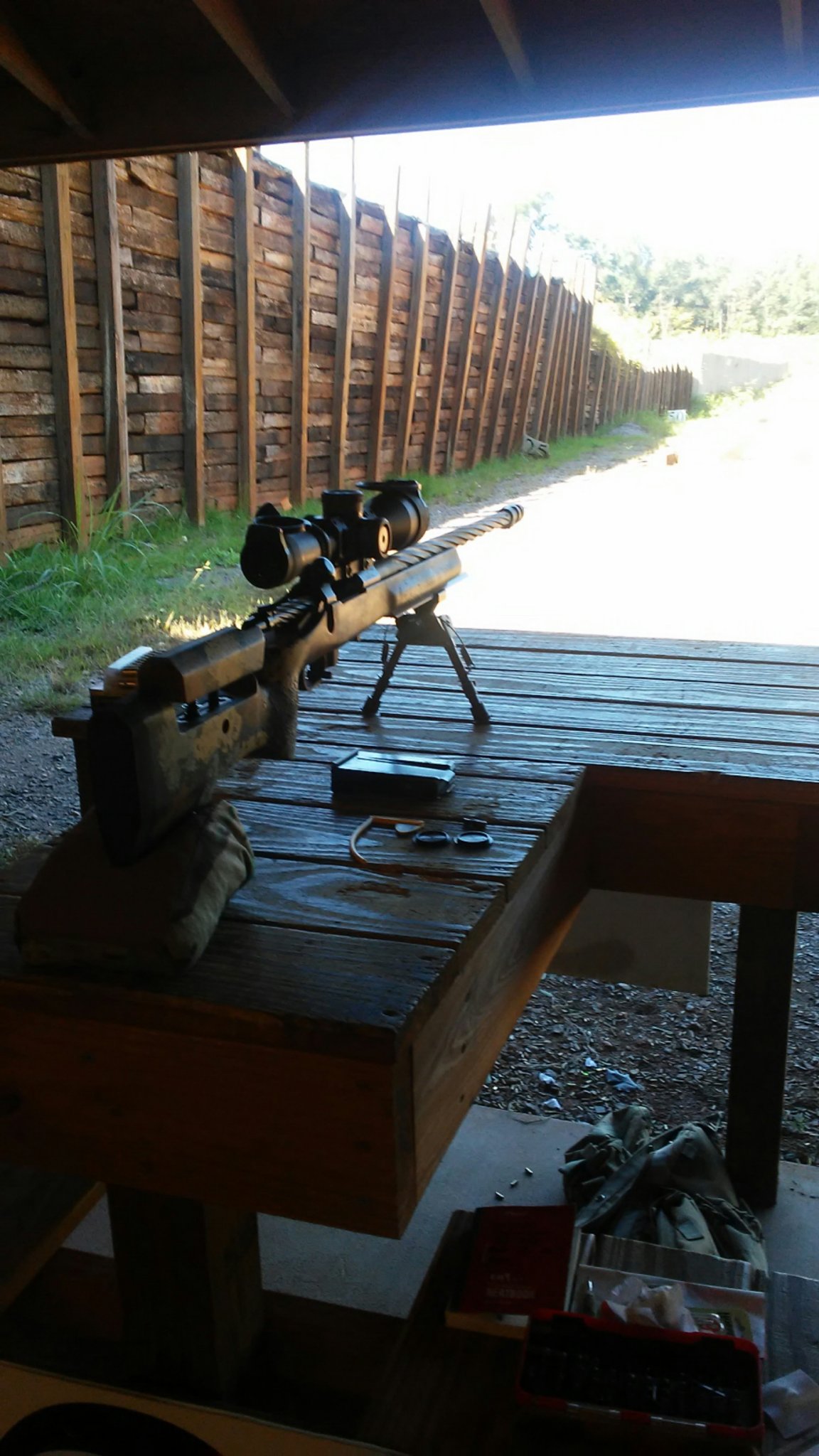

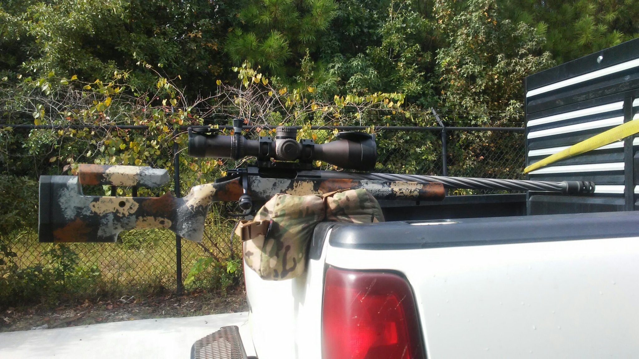

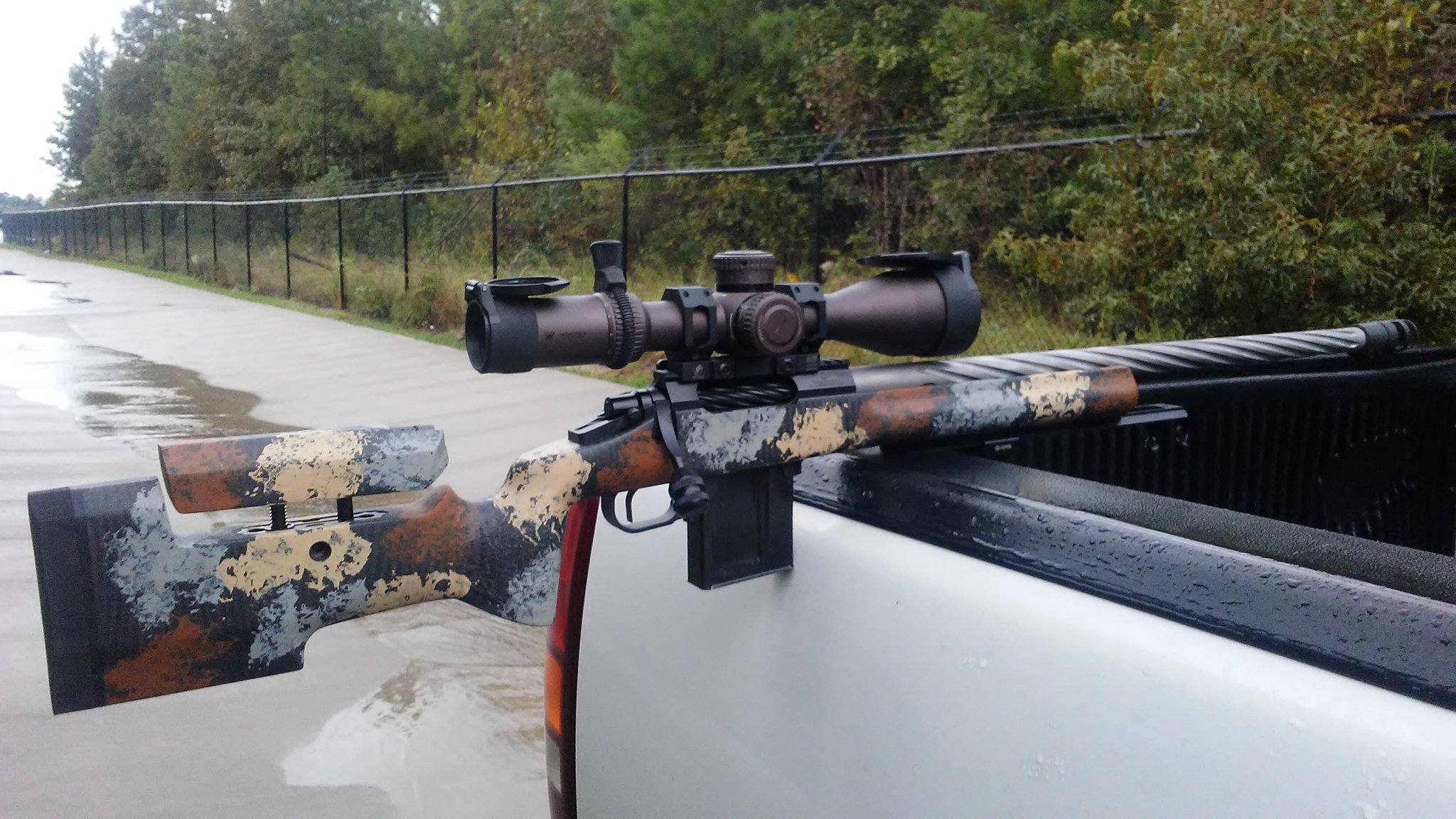

Range Report #1 (14 Oct 18)
FINALLY got to take this thing out and get some barrel break in/initial groupings with it. Main goal for the day was to smooth the throat out from chambering, so I didn't shoot a bunch of groups with it, BUT... if the first 20 rds out of it are any indication of how this rifles gonna shoot, this is gonna be a wicked stick. Perfect day for shooting, mid 70's, no wind, no idiots at the range, just the 100yd target and a new rig.
Here's my 2 cents with barrel break ins... In my eyes, the only reason to "break" a barrel in, is to smooth the throat area from chambering. There's a lot of guys that have a different mentality, and that's fine, I just don't necessarily agree with all the snake oil and charming some people think is involved. There's a reason you pay for a match barrel.... It's the guy that sits there for hours hand lapping the bore after cut rifling. I understand lapping doesn't necessarily get all of the imperfections out, and there's always gonna be micro grooves still along the actual rifling, but those get filled a hell of a lot faster than the average shooter thinks. Essentially 1-2 rounds down a bore will generally leave enough copper in those micro grooves to smooth those areas out. I've personally threaded and chambered a barrel, looked at the grooves with a bore scope, shot 1 round through it, removed the barrel after getting the powder residue out, and looked again with the bore scope..... Granted this is MY experience with a Hawk Hill barrel, but the rifling in that particular barrel was just as smooth as it could be after 1 round down it with the copper set in place. That's where I'm getting my opinion from, and why I hardly take any time breaking in a barrel.
For this rifle, here was my process:
- Do an initial clean with Hoppes #9 bore solvent just to make sure no debris from chambering was still left in it, along with using a chamber mop for the same reason.
- Shoot one round, remove bolt, install bore guide, and push one WET patch of Hoppes through the bore with a jag. After letting the Hoppes sit for roughly 5 min, I came in behind the wet patch with a 30 cal nylon bore brush. I run the brush through the bore roughly 3 times just to break up the powder residue, then I focus on the throat area with a few quick strokes.
- Follow the brush with 3 patches straight through the bore, then come behind it with 2 more clean patches focusing on the throat area.
- I clean my jag and rod off of solvents, then I soak a patch in Sweet 7.62 Bore Solvent.... ****(This is some NASTY stuff. BE VERY CAREFUL WITH IT. If not used properly you can damage the rifling and throat.)**** I push that wet patch through the bore and let it set for roughly 6-8 min. This allows the solvent to do it's thing and start break down the copper. I use the Hoppes for powder residue, and the Sweets for copper.
- After waiting, I will generally take my nylon brush and run a single pass through the entire bore and remove the brush before pulling it back through. I don't wanna get the solvent out just yet, just make sure its evenly throughout the barrel.
- Behind the brush, Ill reinstall the jag and stroke the bore roughly 12-15 times making sure I'm not coming out of the bore completely on either end. This ensures the copper is being scrubbed and not scrapped out of the bore yet.
- I follow up the Jag with the brush again, focusing on complete bore strokes at first, then the throat area by itself. I'll do this maybe 10 strokes, then short ones in the throat.
- After the brush, Ill push clean dry patches until no blue is found on them. The Sweets is good about telling you whether or not you've still got fouling in it. I use a brass Jag, so sometimes I get false readings on the patches, but after using it a couple times, you'll figure out it's from the jag itself and not the actual bore.
After that, I go back and shoot another single round followed by the same procedure. I'll do this for 3 single shots, cleaning in between each round, then follow up with a 3 round group, clean, then a 5 round group, clean, and then I'm off to the races and generally wont clean that barrel again for a long period of time. I'm not a benchrest guy... I don't need to clean between strings. Hell, I'm pretty sure I've got 2 rifles in the case that haven't seen a cleaning other than a quick pass of Hoppes, in over 1000 rds. Usually during a match season, I'll fully clean a rifle once (probably 3-4 matches in) and immediately follow it with a copper fouling trip to the range.

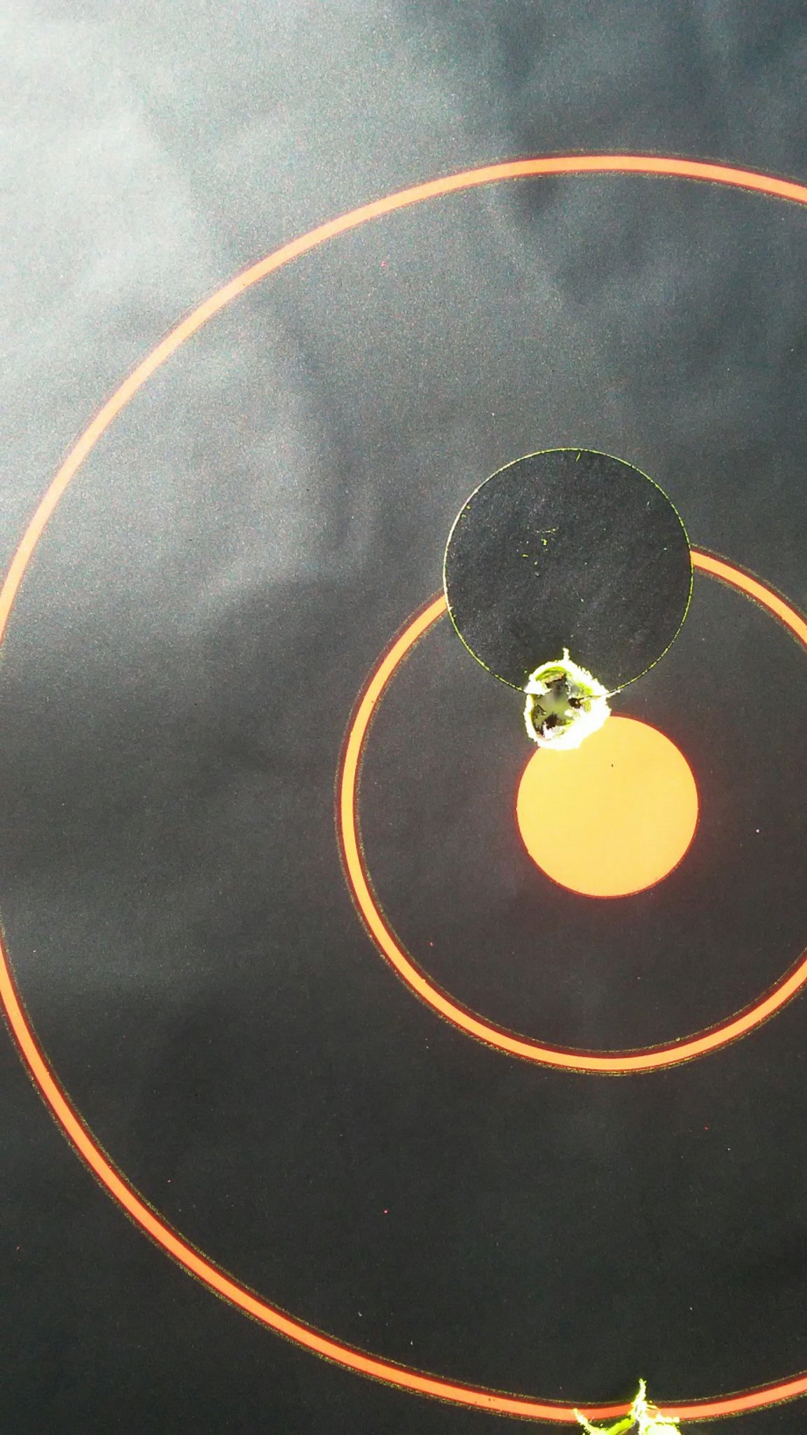

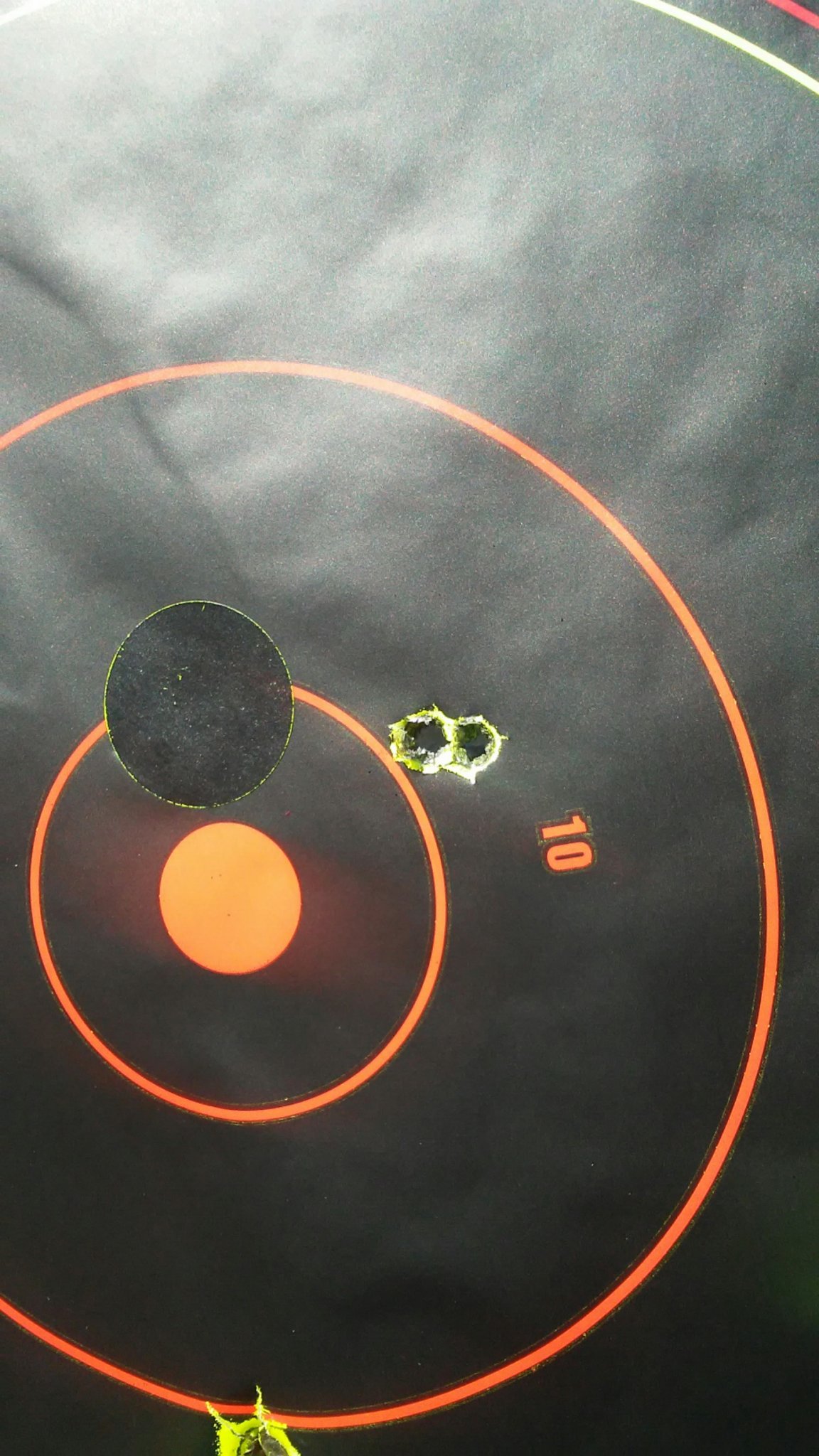

Here's how it shot with one group being the first 3 rounds out of the rifle (keep in mind this was during my "break in" process, so that's one shot, clean, one shot, clean, one shot, clean)… Pretty impressive if you asked me.
After adjusting the scope and shooting my initial 3 shots, here's what she did with her first 3 shot group.... YES MAAM. I'll take that all day long.
Oh... and did I meantion these groups were FACTORY 175gr FGMM... Yeah. So there's that too. Now if I'm in a bind, I can just go snag a bunch of it and shoot. That's nice to have in my back pocket.
Following 5 shot group was just as tight as the 3 shot, and when I got back to the shop and measured with a micrometer, it came out to a .215. The rest of the trip to the range was used to do velocity testing for a new bullet I'm trying this year but don't have enough data to start giving my opinion. What I will say though, is that for the advertised BC and velocities I was getting over my Magneto Speed..... This rifle is gonna piss A LOT of 6.5 guys off.
I'm heading back to the range today to test 2 more powders out over the chrono, then hopefully getting some time at the long range later this week to see if these bullets are the real deal.
As far as the completed rifle with the Kelbly's Black Bear Tactical action, its an absolute DREAM to shoot. It's just so damn smooth and rock solid, that I'm seriously considering selling my other rifles and having a stable of Black Bears in the safe. IT'S THAT GOOD. If you're on the fence about what custom action to buy, you can't go wrong with this one. Is it built like a tank? Yes. Is it slightly heavier than other clone Remingtons? Yes. Does it require a little fit an finish of a traditional stock? Yes... BUT when it comes to PRS/NRL matches, recoil is a serious thing. I'm not recoil sensitive, but I am when it comes to matches. I want my rifles to sit still and return to the target as fast as possible so I can either watch impacts, or rip out a follow up shot as quickly as I can. I want them to be super rigid so its consistent from shot to shot.
Ounces = Pounds and Pounds = Pain, yeah I get that... FOR A MOUNTAIN RIFLE, but that's not the name of the game with our competition guns. I'd still hump this rifle at Mammoth or other "sniper" matches like the Cup. I haven't weighed my complete rifle yet, but I would guesstimate it's in the 18-20lbs range. The Manners T4A helps a little, but when I stuffed an M24 in it, that kinda didn't matter anymore. But the accuracy doesn't lie... Rigidity = Consistency, and I'm a giant ballistics nerd when it comes to barrel harmonics.

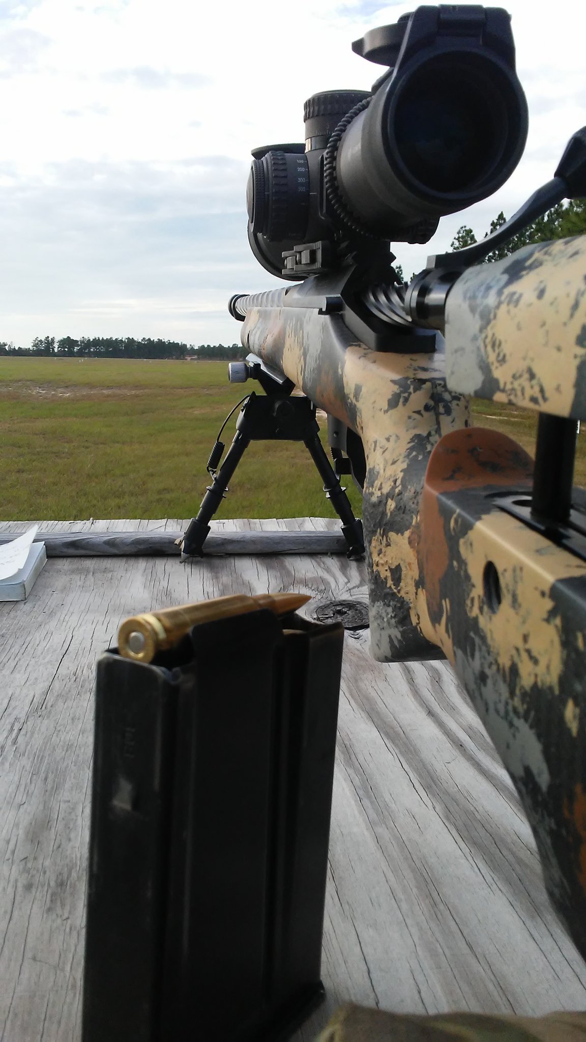

Range Report #2
Oct 18, 2018
Got out yesterday to really test the rifle at distance and be a little rough with it. I have the fortune of having a really nice range set up with steel all the way out to 970, barricades, benches, rocks, and tires etc. Testing the rifle on a traditional PRS stage, I really enjoy how it feels. Very well balanced, and recoil management is close to the characteristics of my 6.5x47.
The action is 10 times faster than any Rem Clone I've ever shot. Its smooth and only takes me flicking it to throw the bolt, and one finger to sling a piece of brass. I think Kelbly's has the right idea with their bolt knobs, because other than a giant AI round knob, this is my favorite. The mechanical ejector is super nice and I really noticed it during load development. I was able to run the bolt slow and the brass would fall into my hand, making it easy to check pressure signs. When I was running the bolt during a timed stage, I ran it super hard to make sure it and the bolt stop, were going to hold up to me being aggressive with it. Of course it did, and the ejector will seriously toss brass. Like ridiculously far. But that's the point, get it out of the way as fast as possible. Really really love the mechanical set up.
At distance, the rifle outperformed all my expectations and posted a 4.5/5in group @970 with a moderate 7-9mph crosswind. Thinking I must be seeing only a portion of the group through the spotting scope, I shot another group taking .1mil's out of the scope to move the impacts down and onto clean steel. Again, the rifle shot a 5in group on the plate. Just to make ABSOLUTE sure I was seeing what I thought I saw, I hopped in the cart and drove down to see it up close.... Sure enough. Two groups, no larger than 5in at 970. I'm floored by this rifle, especially after all the issues I had during chambering. It shoots as good, if not better than my 6SLR, and on par with my 6.5x47L.
I'll be running the crap out of it again tomorrow, trying to find something that doesn't mesh well with me....But so far, that hasn't happened and I have a high suspicion that it probably won't unless I force it to.
