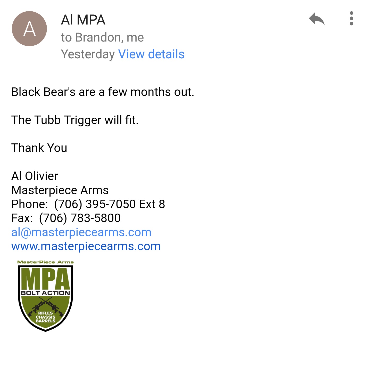

I emailed Al at MPA yesterday and he said they were "working on the Black Bears now but did not have a release date yet". I ordered mine in June under the impression it would be a few months max.

When I initially ordered the Black Bear in March of 2018, I immediately contacted MPA to check if there would be an inlet. The response at that time was 6-10 weeks. After 10 weeks I called back and the new response was there wasn't really a projected date as to when there would be an inlet. Glad I ordered my Mcmillan or else it looks like i'd still be waiting.

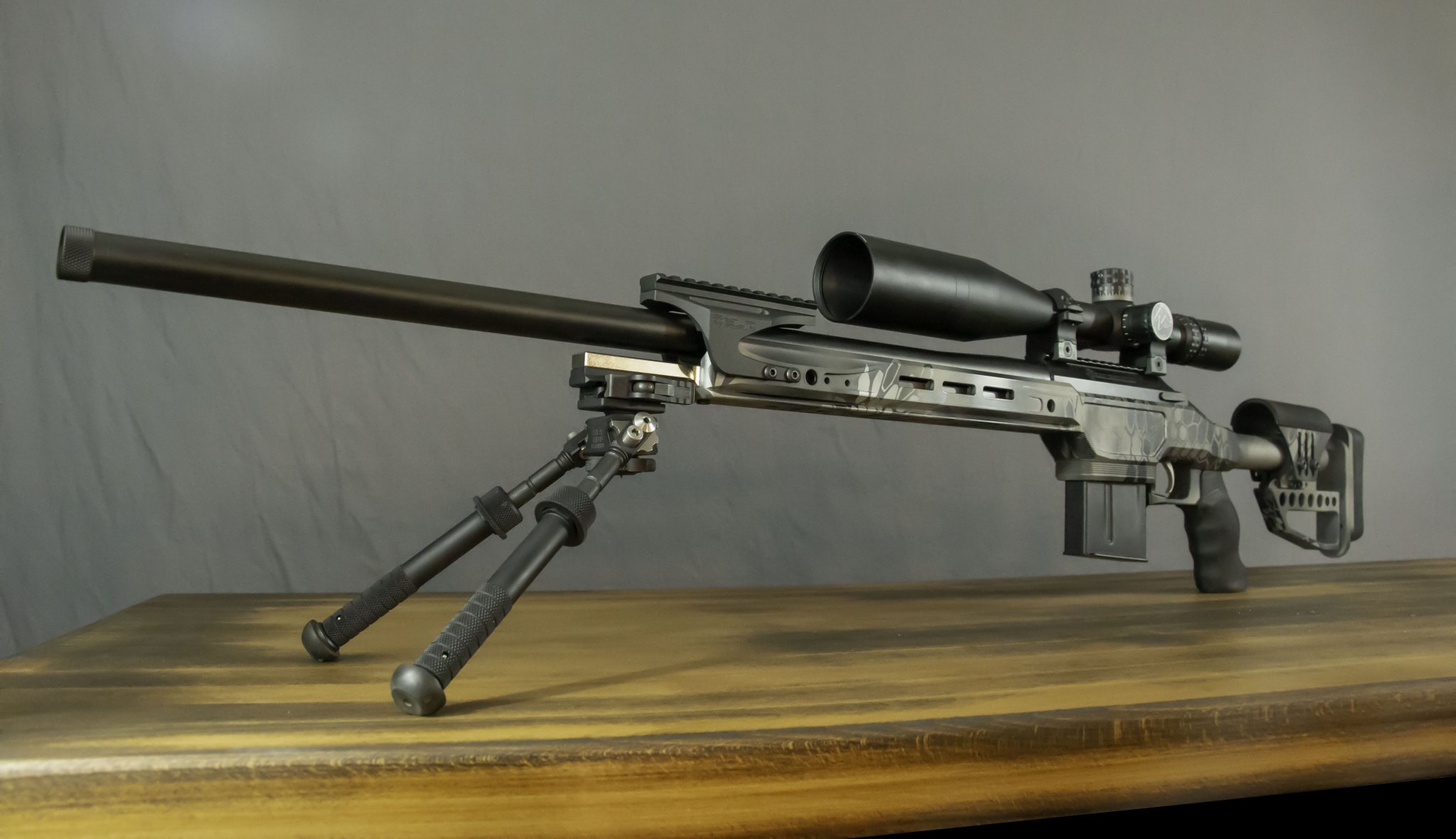

We offer the Black Bear with a Sako Extractor and Remignton Ejector that will work great for the Dasher and BR Variants. The mechanical ejector will work if run quickly, but the primal rights insert can cause some issues as the case in the magazine can push the round from the boltface. So the best setup for Dasher and BR is the Sako extractor and Remington Ejector.
The Atlas works so well with the Dasher and Primal Rights follower, because of our short throw Dasher Bolt stop.
@XLR Industries that looks incredible... do you have any more pictures of that build, specifically showing how the action looks nestled into the chassis? Also, is the standard Envy package available with the Black Bear inlet?

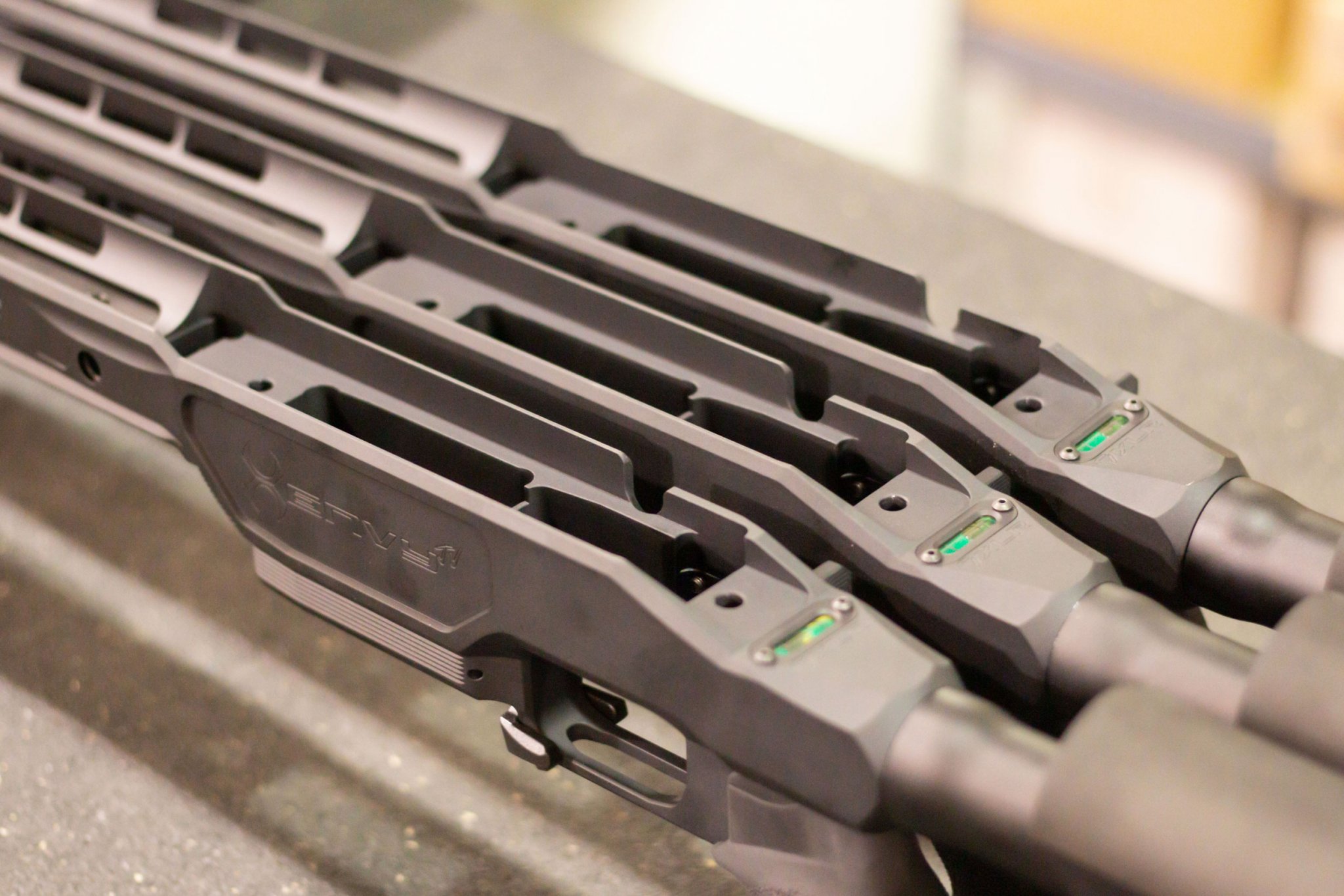

We are currently only offering the Carbon chassis, Evolution, and the JV Heavy fill Envy chassis. The standard full length might eventually be offered. Send us a email and we can get you some more pictures. [email protected]
The fit of the inlet is flawless! They are tight and make great contact.

For those of you looking for visual representation on how tight the fitment for the Black Bear action is in our chassis system, check out this little video we put together. If you'd like more images of the Black Bear action in the ENVY chassis, send us an email and we would be more than happy to send over some close-up images!

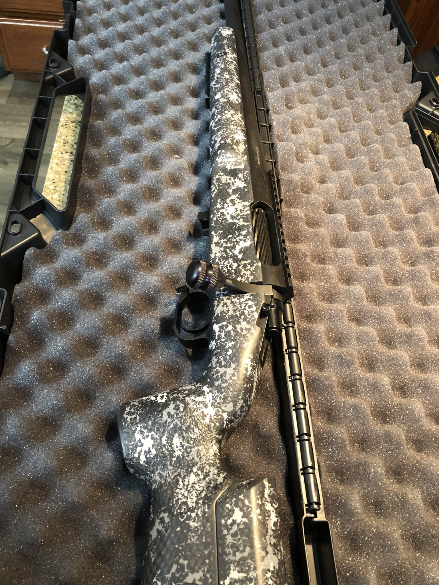

Picked up my Envy this morning and went straight to the range to install the Black Bear. What a spectacular fit, I’m pretty impressed with the quality of this chassis.
I have a match tomorrow so I really wasn’t planning on running it since I’m not familiar with it at all, but man it feels so good. I’m really considering it
Talk about your first world problems, which one of these awesome rifles do I run tomorrow.

Run the ENVY! Just SEND IT!

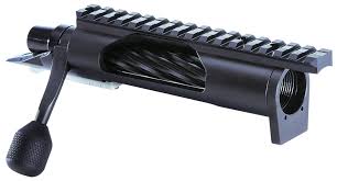

Do blackbears take a prefit barrel of any type?
And is the difference between them and the atlas just the bottom profile?
Any competent gunsmith can build a pre fit barrel for any action, but if you're asking if there is any companies doing prefits for the Black Bear, not that I know of. The thread pitch is different than a Remington or Savage (which most prefits are threaded for).
There is quite a lot different between the Black Bear and Atlas. Yes the flat bottom is one, the Black Bear also has an integrated recoil lug, and integrated 20moa scope base, whereas the Atlas Tactical has a Remington footprint, pinned scope base, and pinned recoil lug.
The tenon is different between both actions as well. The thread pitch is the same 18TPI, but the shank on barrels will be different (longer vs shorter).
Also, the sheer size of the Black Bear is much much different than the Atlas Tactical.
Only thing I know is the same between the two, is the bolt, and the TG extractor/ejector set up.
