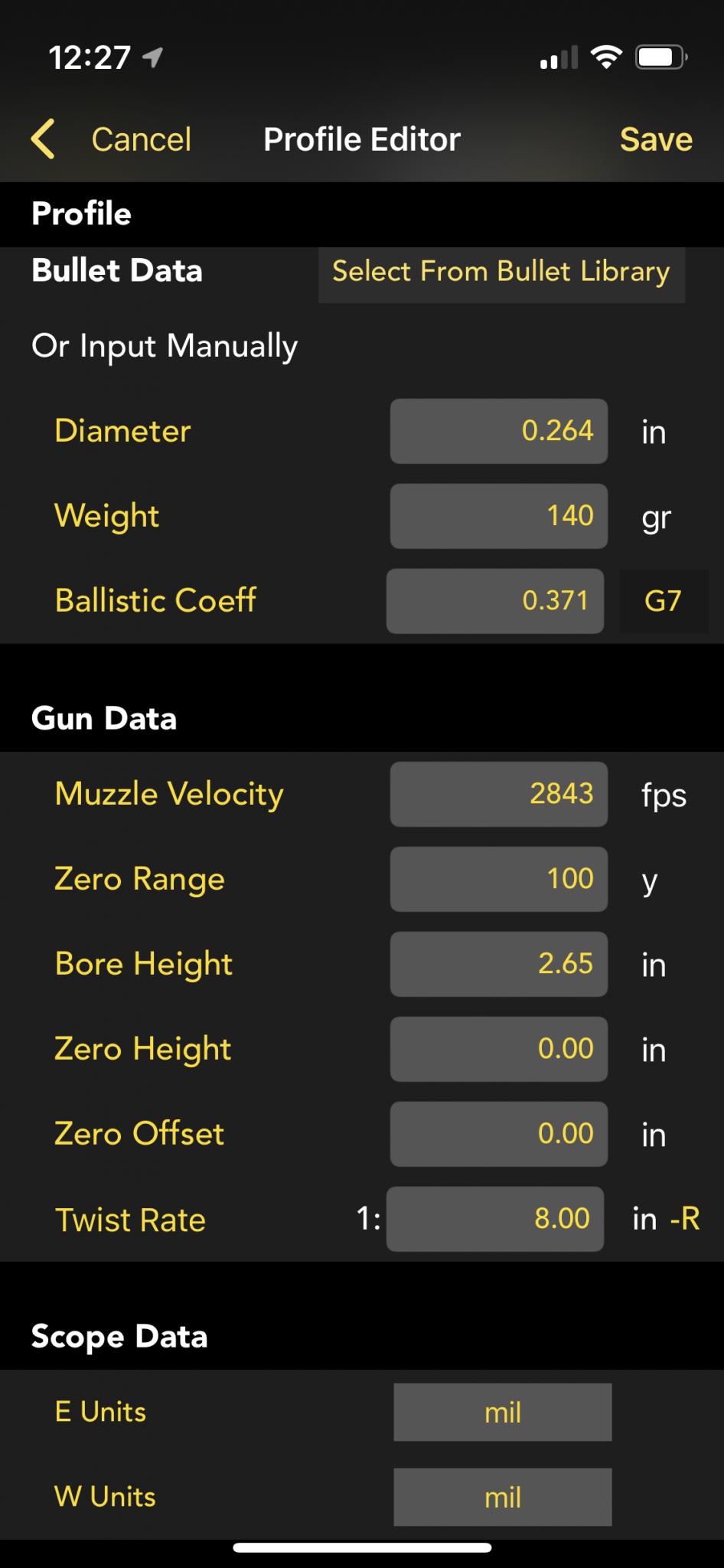

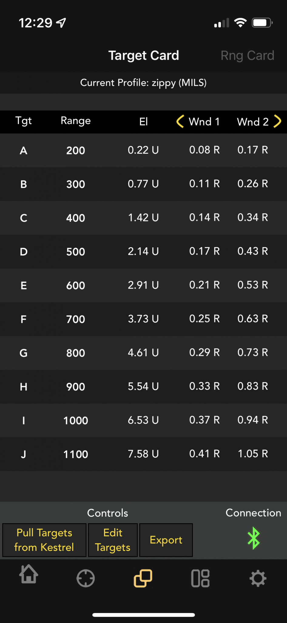

Ok, I'm trying to figure out what I'm doing wrong. I'm using a Kestrel Elite Ballistics and was using the custom curves.
I'm using Hornady 140 BTHP Match bullets, 6.5 Creedmoor at 2843 FPS. I know they are a bit fast, but no signs of over pressure on the brass or primers. I tested this with both my Magneto speed and my Lab Radar to verify velocities.
With the custom curve for the bullet, my dope was fine for targets 500y and under, but past that I was hitting significantly high. So I switched to manual BC and adjusted it to match were I was hatting at 1000y. This brought up my G7 BC from 0.285 to 0.371 which is insane for any kind of 6.5 creedmoor bullet. Even a 153 grain A-tip is only 0.355. The weird thing is it worked, well for elevation at least. I tried from 400-1000y and all the elevation calculations were on point. Windage was way off however as the bullet isn't actually that aerodynamic.
Any Idea what I'm doing wrong?
Would need to see all the rest of your inputs to even hazard a guess. FWIW BC is tied to velocity so yours would be higher than normal but not like that.
To give further comparisons looking at the various PDM's for this bullet G7's of .252 to .296 are listed in AB mobile.
Zero off. Zero distance wrong. Zero elevation offset set to something instead of zero
Reactions: DeathBeforeDismount

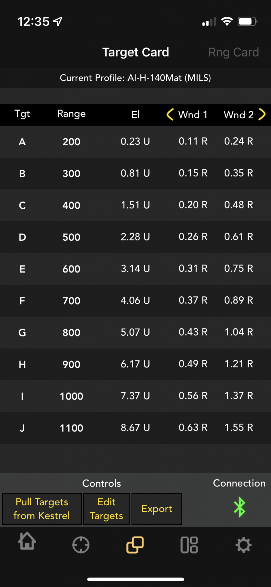

Zeroed it a week ago, and was still having the issues then. Heres the data that worked. Also I wanted to add in, that this is an issue Ive only seen with this projectile in particular.
Edit: Added a third photo for the dope with everything the same but with the Kestrel's Custom curve BC.

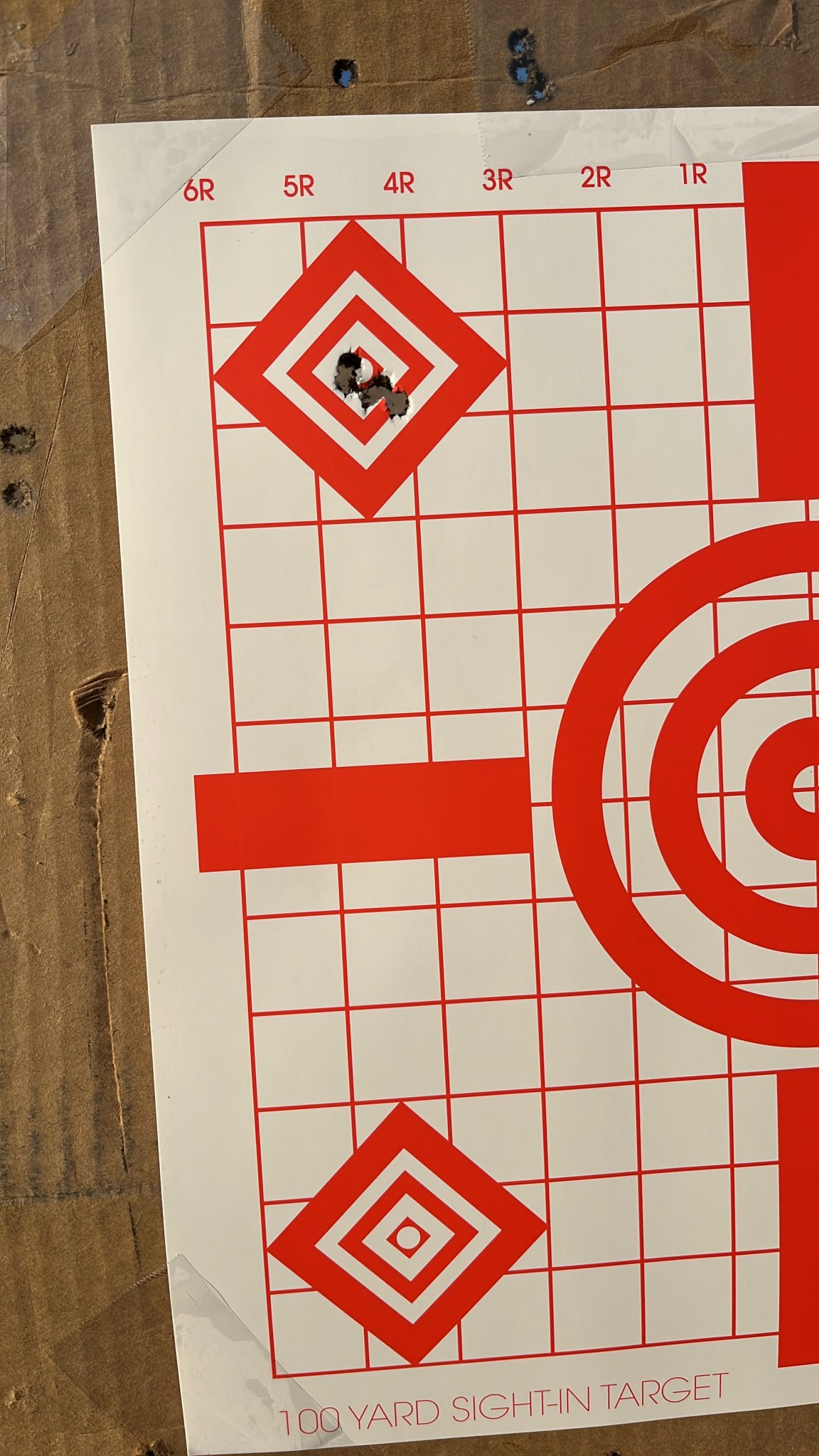

Have a picture of the zero group and how did you measure that distance to target?
At a public range, targets are supposed to be at 100y. This was from last week, but I verified today and it was grouping pretty similar so I didn't adjust anything.
Is a 1/2 click low, not enough for the differences you are showing but does bring up the other half. "Supposed to be 100y", is it really 90 or 120? Unless you measure it are just adding another piece of incorrect info to the calculations, it all makes things worse the further out you go.

Is also the BC at 100 yards or whatever it tracked to, so it will still be high for an average BC number, but still a true number to adjust from.
Using the typical "adjust the middle number a digit or two" puts you near the higher PDM G7 value I listed above.
I'd measure the actual range you zeroed at, then step by step review all the settings on the kestrel. I have seen it mix imperial and metric after an update requiring using the global unit setting to correct it.
Reviewing this article can give you an idea of what all can cause things to give poor results:
Next time I'm at the range ill bring my rangefinder. Would you trust the data from a laser rangefinder over the posted distances at a range? I have a Sig Kilo BDX 3000. I was hopign it was something simple like I had a setting wrong on the kestrel, or missed calibrating something, but I'll go through that list. Thanks for your help!
Your laser will likely be closer to the truth. One of the largest public ranges in the country only has two spots with accurate 100 yard measurements, their benchrest range and a PD range. The main range there has some as close as 92 yards. This scenario is more common than you'd think.
If you were going to do turret click value truing I'd not trust the laser and use a 300 foot tape measure.
ETA:
Just noticed your odd wind holds in your screenshots. You likely have the incorrect latitude set and spin drift and Aero jump all enabled. Firmware update will change all of those.

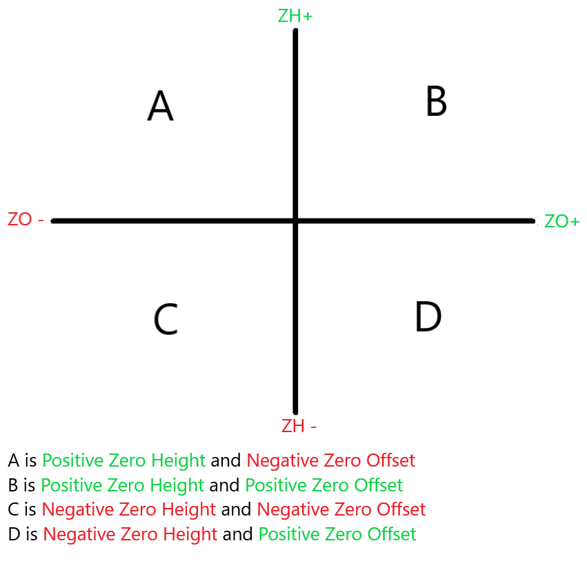

So I want to make sure my understanding of entering Zero Height and Zero offset are correct since the web page explaining them isn't very clear to me and cuts off mid sentence.
"ZH/ZO – Zero Height (elevation) and Zero Offset (windage) are used when the addition of a suppressor, a change in ammunition, or the addition of night vision optics changes the point of impact of your zero. For example, if adding a suppressor shifts the point of impact of your zero up one inch and to the left half an inch, input 1 for ZH and -0.5 for"
I made a diagram of my understanding. Assume A, B, C and D are groups you are zeroing off of. Please let me know if this is correct.
