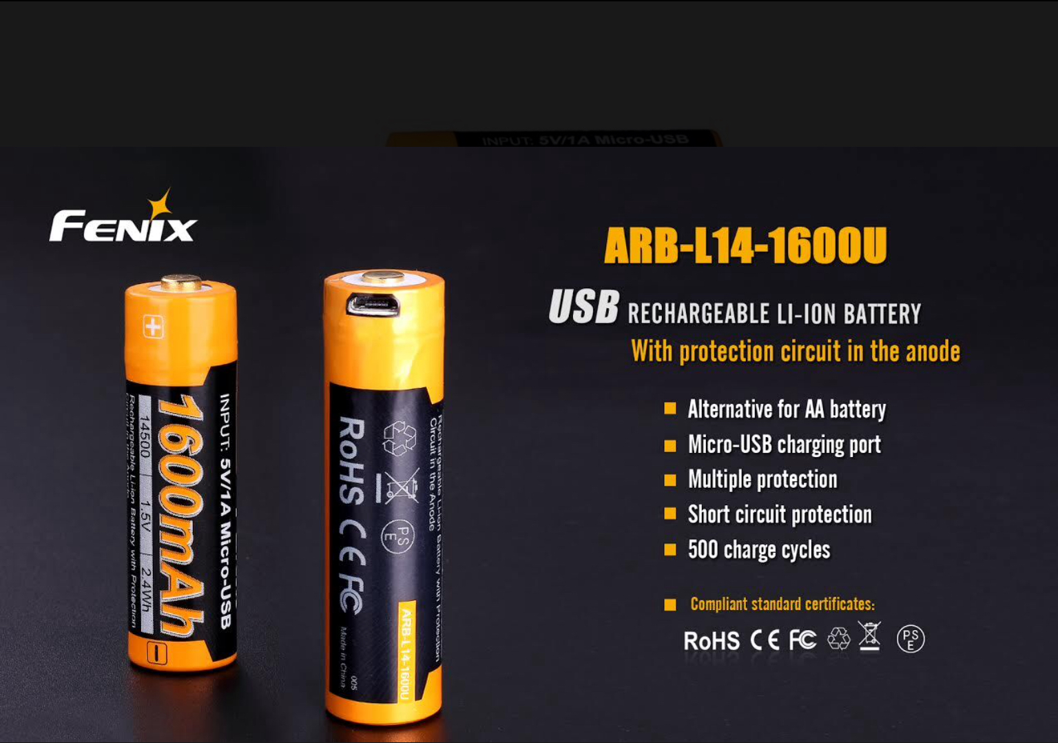

    I have been running these for a couple years now in my 5700 Elite and love them. No problem with the compass. They charge with USB cord. https://www.fenix-store.com/fenix-arb-l14-1600u-usb-rechargeable-li-ion-14500-battery/
    The only drawback is that there is not a comparable battery scale setting for the battery level indicator. I have two and just swap them when I think its getting low. I leave it set on “alkaline”.

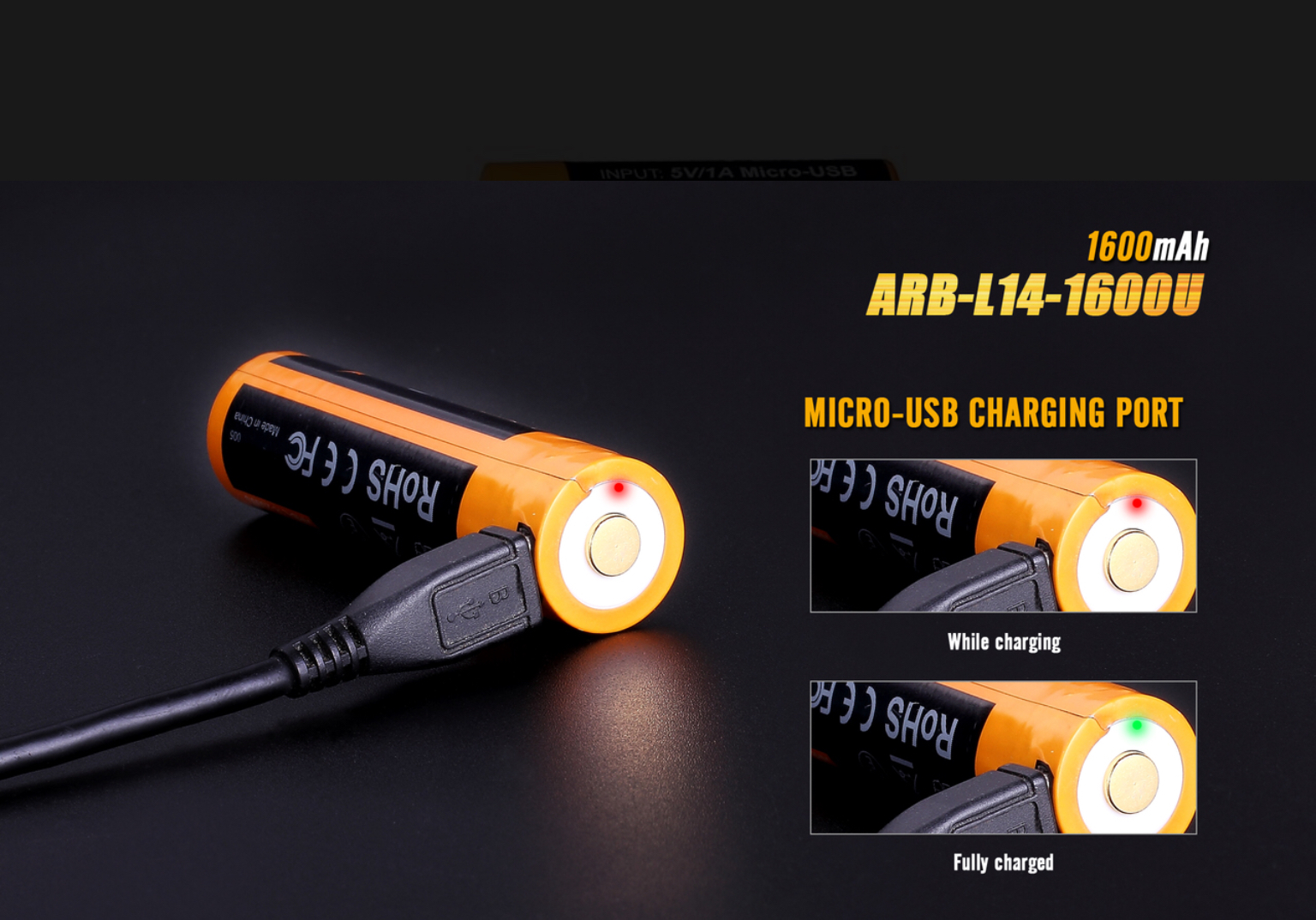

    Reactions: TheMammoth

    Huh. Now that is clever as shit; I may have to order some of those. I like the micro USB charging, because I can leave a set in the truck and charge them on the way out to the range...
    Yeah, I'm going to have to give these a try. Thanks for posting this!

  • Huh. Now that is clever as shit; I may have to order some of those. I like the micro USB charging, because I can leave a set in the truck and charge them on the way out to the range...
    Yea they are nice. They are Lithium batteries......I believe they still offer free shipping too.I did get one bad battery out of four (two separate orders) and they sent a new one right out. They have more powerful ones(mAh) but I have not tested those. One of those might line up with one of the battery scales better. I a was told the BT cuts out to conserve battery when the scale reads low so I run the scale that reads the highest, which if memory serves is the alkaline setting.

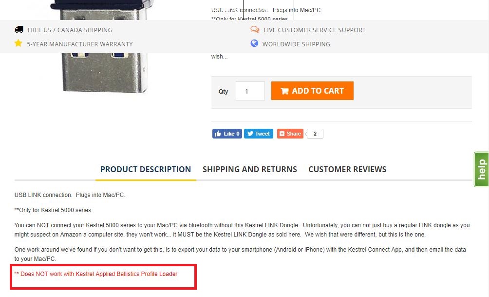

    Okay, so I have a 5700 now, and just received the Link dongle. Installed the driver or Win 10 did), and launched Link after turning on the 5700 and ensuring BT is ON and Conct is set to PC. Link scans, and finds the 5700. I downloaded the latest profile loader (68) and launch that, then select 5700 for device. The PL say it does not see the 5700 (something about USB cable not seen). Scratching my head here...any suggestions as to WTF is going on?
    How does the profile loader aware of the Link status? Doe sit need to be installed in a certain directory, or is searching for the device (dongle)?
    Win 10 Laptop, Latest Link download, 5700 with FW v1.23

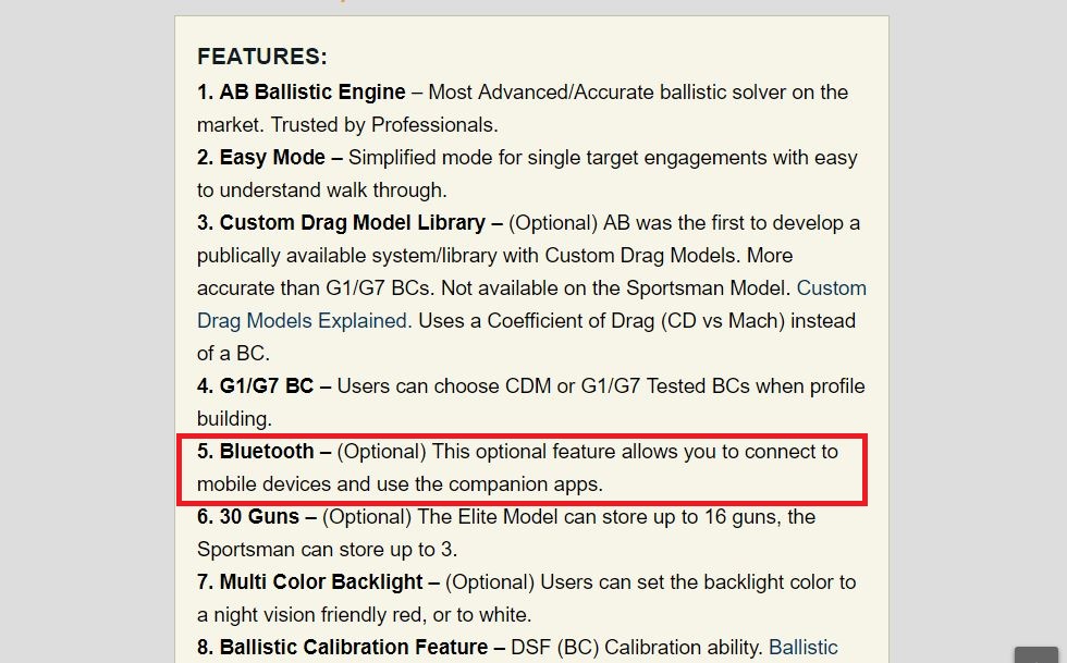

    I think I figured it out. The dongle doesn't support the Profile Loader.
    What. the. Hell.
    Trying to figure out how one page can say "allows you to connect to mobile devices AND use companion apps (like the Profile Loader), and the other page says the one thing that uses BT for a PC doesn't support a companion app like the Profile Loader. WTH?
    What. the. Hell.
    That’s just retarded. Shouldn’t even be an option then. I like AB, but they got to move into the modern era. Everything feels so clunky right now. Too many integrations that are like 75% good to go but nothing is 100% and for the money that’s kind of a shame.

    Yeah, I'm just sitting here shaking my head. The Garmin is an easy peasy loading process. For some reason the Kestrel AB solution has always seemed clunky and half assed. I'd hoped that at least the Link mobile app would allow side loading of .pro files, but they didn't include that option either. I'm just finding it hard to understand why the profile loader can't sync up with the Link PC app. I mean, it's freaking code, not hardware.
    Now I see a new firmware update is available, and the hotlink URL in the PC Link app for downloading the latest FW, launches the online pdf instructions, which say to click that link to perform a download of the latest FW. ??? Does anyone test this stuff? Smdh...not trying to bust AB's balls here; just wanting the stuff to work as advertised.
