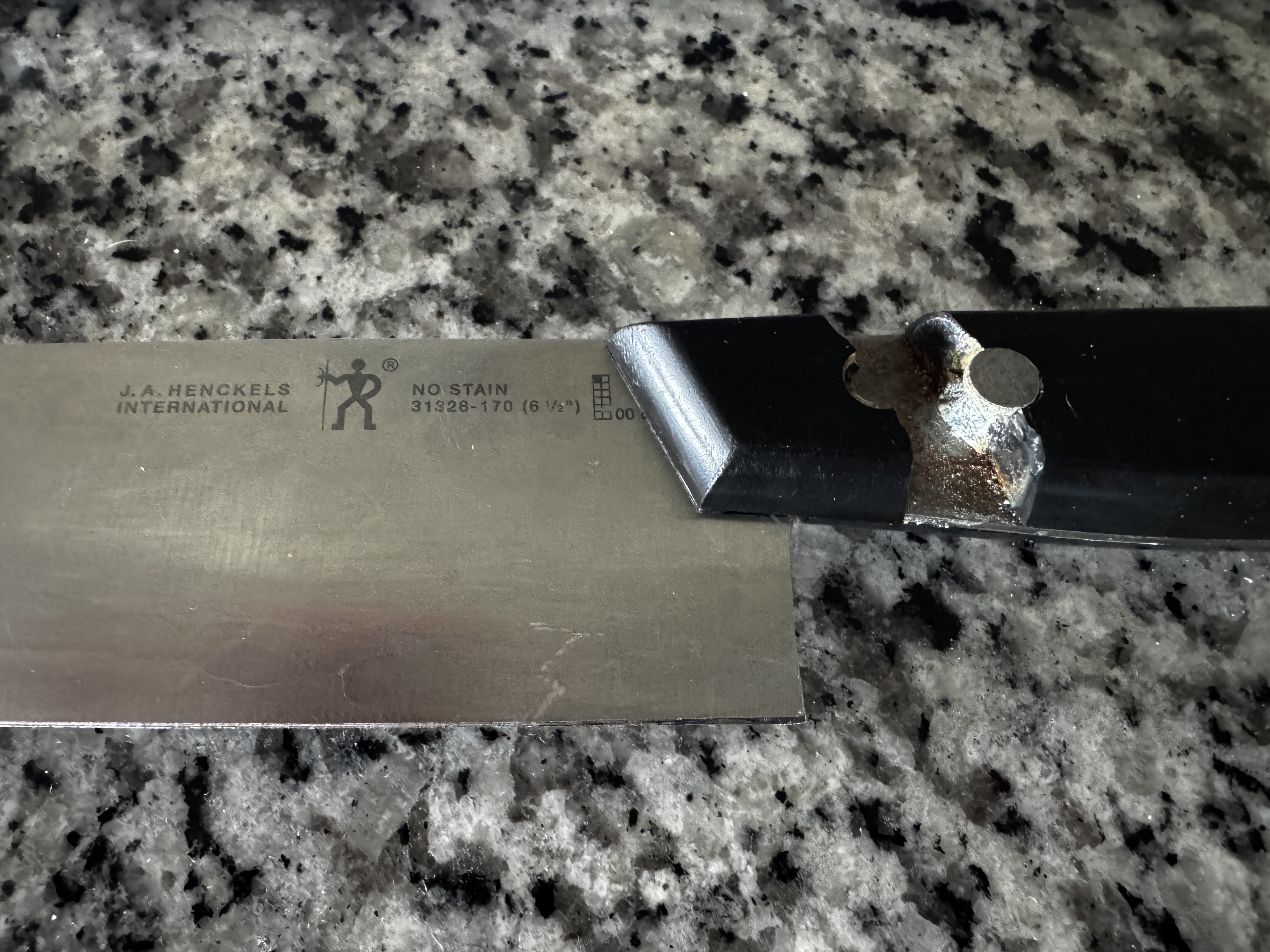

    Got a 20+ year old JA Henkels santuko knife that the handle has finally cracked and broken off. They wont/cant repair. Still waiting to hear about a replacement knife under warranty. If they wont warranty it it wont hurt my feelings as 20+ years, the knife owe's me nothing.
    Anybody on here that builds knives think they could make me something to replace this? Would need to drill rivets out, make new handle, and some way to attach it...maybe a machine screw and recessed nut type setup. I dont know how their original rivets are done. Maybe a material like G10 for the handle.
    I did some google searching with no real source of somebody who readily does this, even though it seems to be a "common" problem with knives like this(not just Henkels knives).

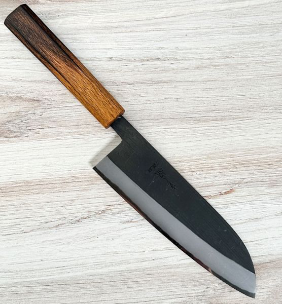

    These guys have cool stuff if you decide to buy something new. They also put custom handles on their knives upon request, so they may be willing to rehande yours...who knows? Honestly though, you'd probably be better off just buying something else. Once you use a good carbon steel, it is hard to go back to the soft stainless steel of Wusthof/Henkels. Something like this one for $150 in Blue #2 steel would be pretty nice.

    That is a great DIY project. Buy some G10 scales from TexasKnifeMakers or KnifeKits. Good epoxy found locally. Get to work shaping the scales as you like them. It really isn’t difficult work with common hand tools: jewelers saw, file, couple of clamps. Faster with a bench mounted belt sander, but that isn’t required.
    Reactions: lash
    Smash the rest off. Zip the rivets off with a grinder and punch them out.
    Shape some G10, hammer some rivets back in, finish shape.
    Rivets are just a straight piece of soft material that you smash the ends to flare out.
    Getting the proper rivets is probably more challenging than anything.

    Instead of "rivets", use the closest size copper or aluminum tubing.
    Countersink the holes in the replacement handles(g10 or paper micarta) and peen the tube ends to match the countersink in the handles with a flaring tool.
    Clean and easy to replace in the future.
    All you need is a coping saw, files, and sandpaper....unless you have a bandsaw and belt grinder.
    The paper micarta will polish very nicely after sanding to 1500gr or so.
