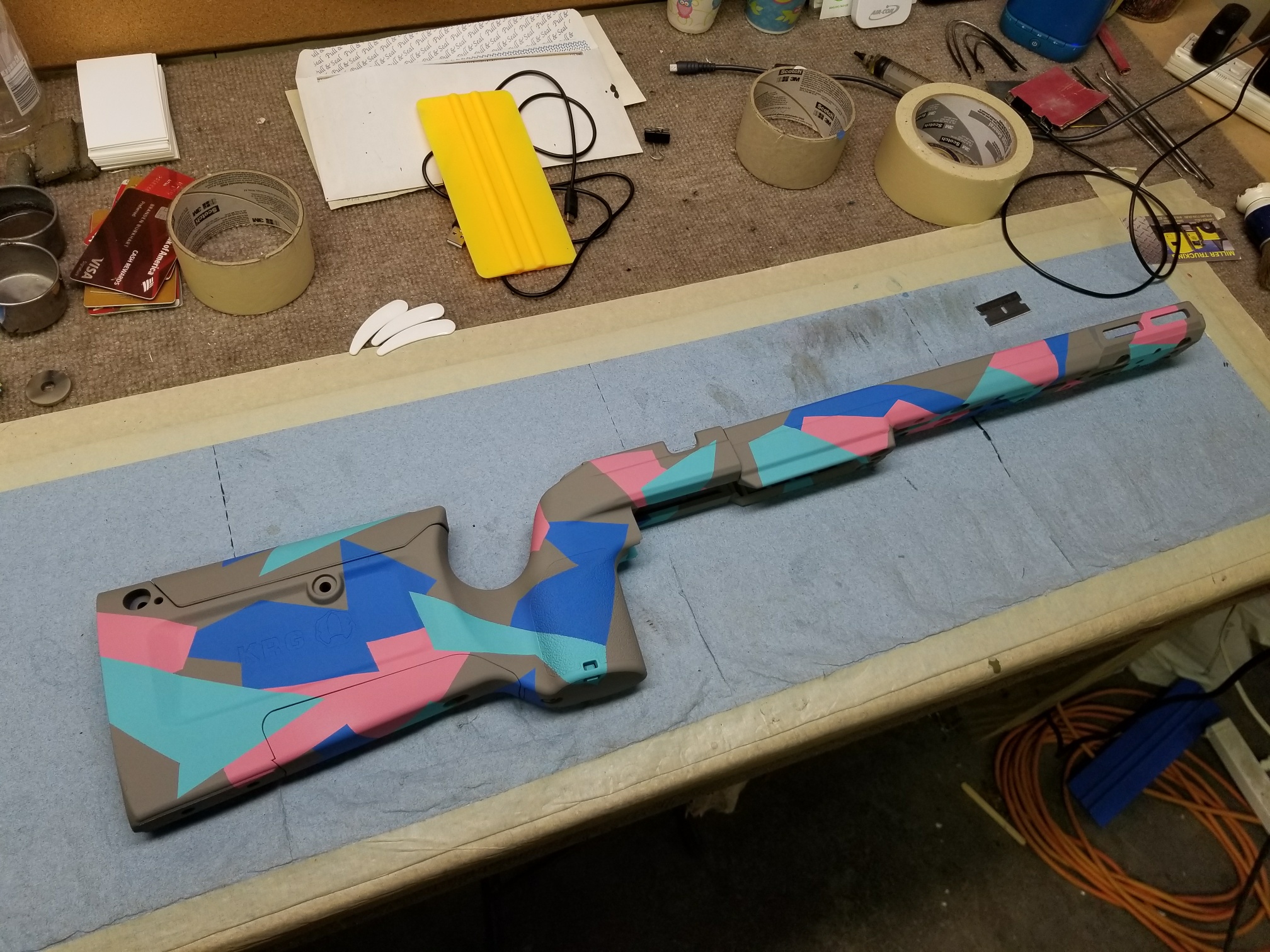

Got a KRG Bravo for the wife's custom build. I was really impressed with the chassis when I first received it - it's a very well done chassis at a great price.
It's on its way back from Branden at Custom Gun Coatings, I had him do a pretty unique paint job for the wife!

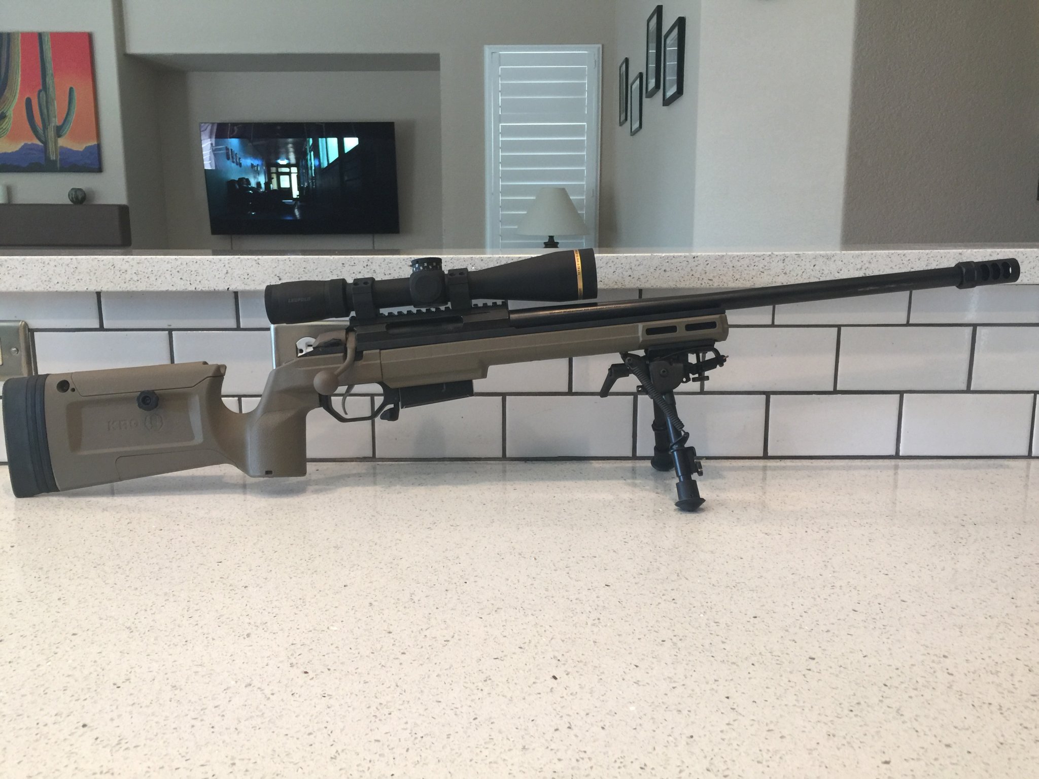

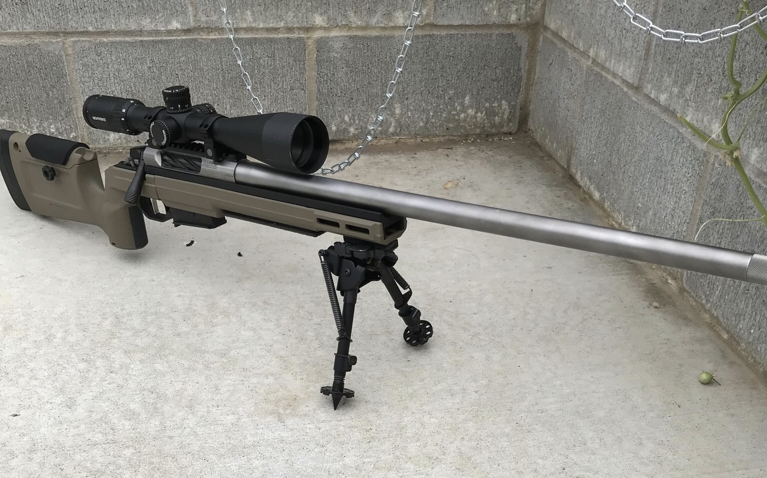

*****NOT MY RIFLE. SOMEONES POSTED IN SEEKINS HAVAK PAGE****
I think it looks great and pretty much what I’m shooting for. I think black action would look even better.

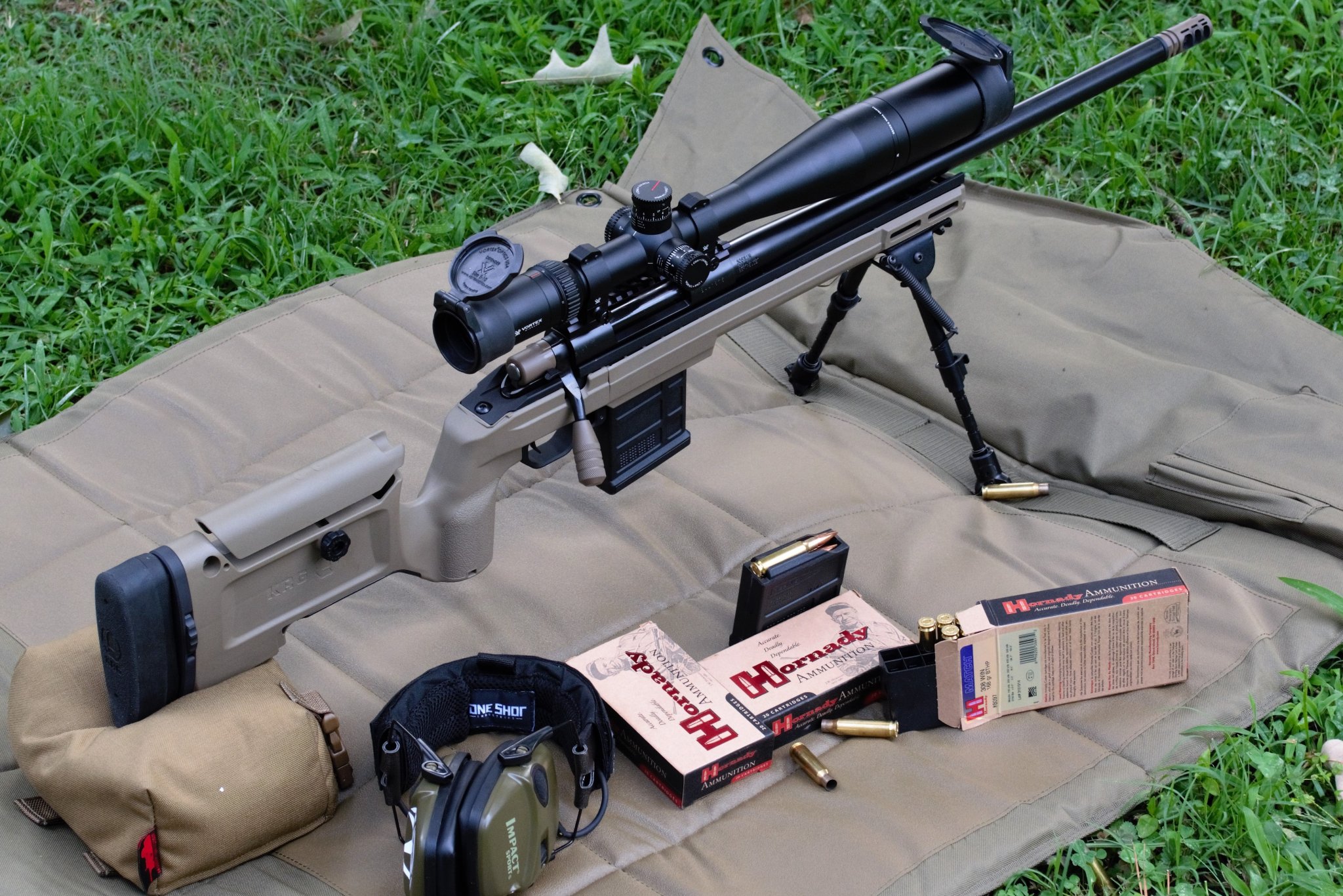

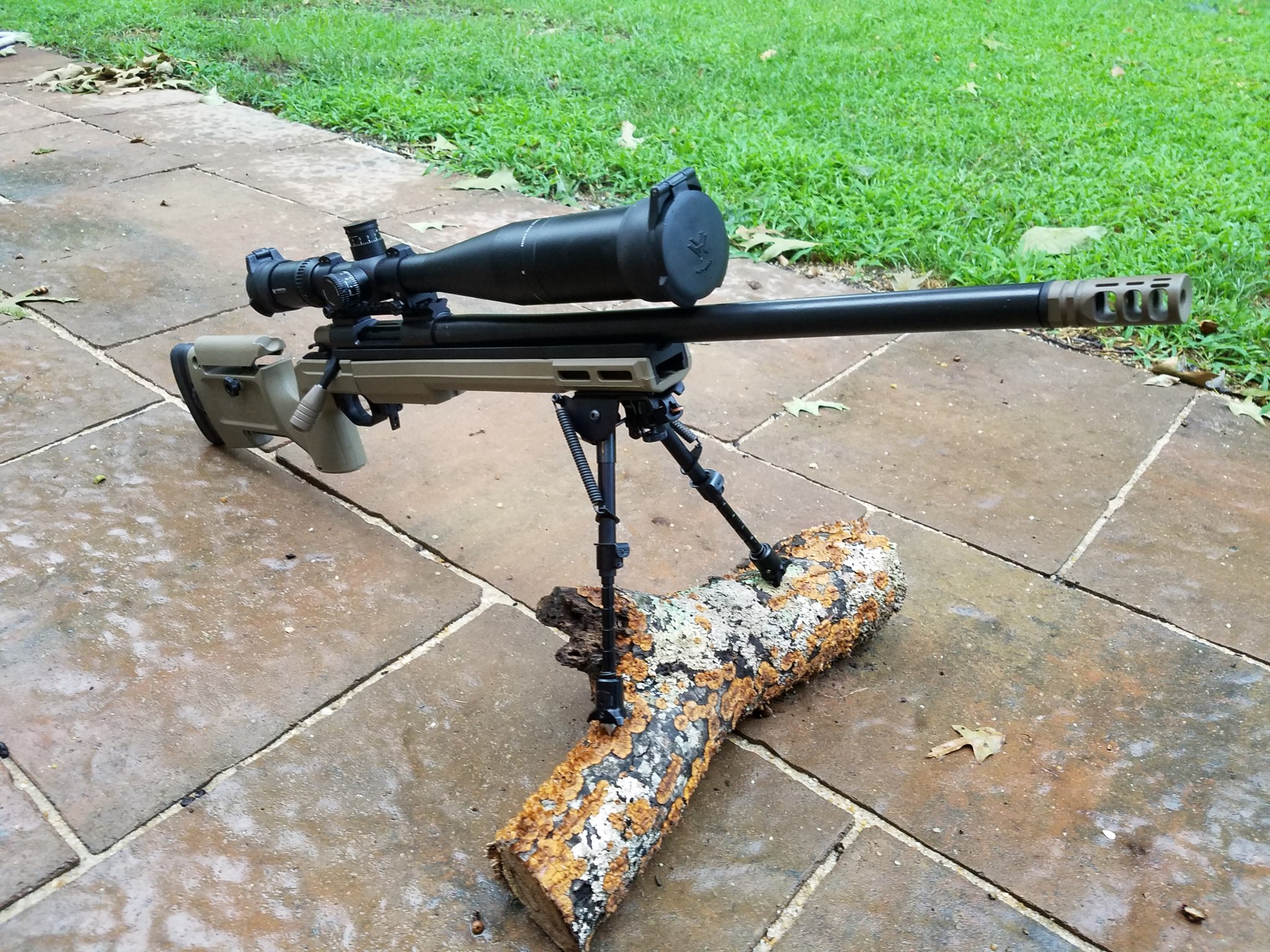

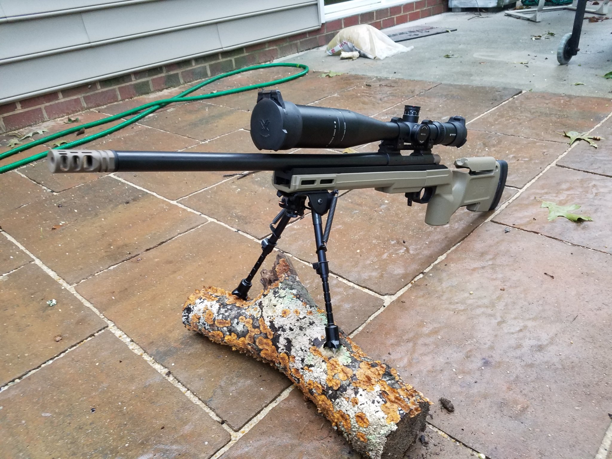

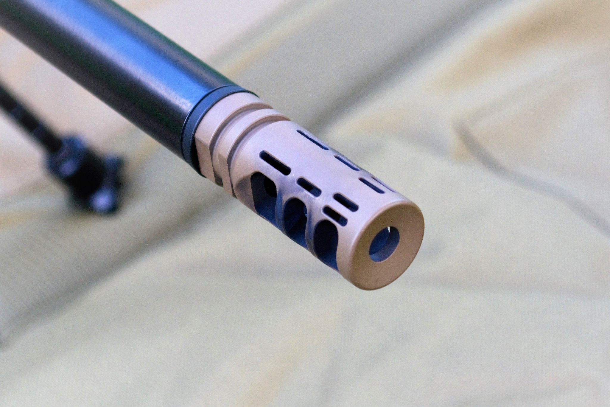

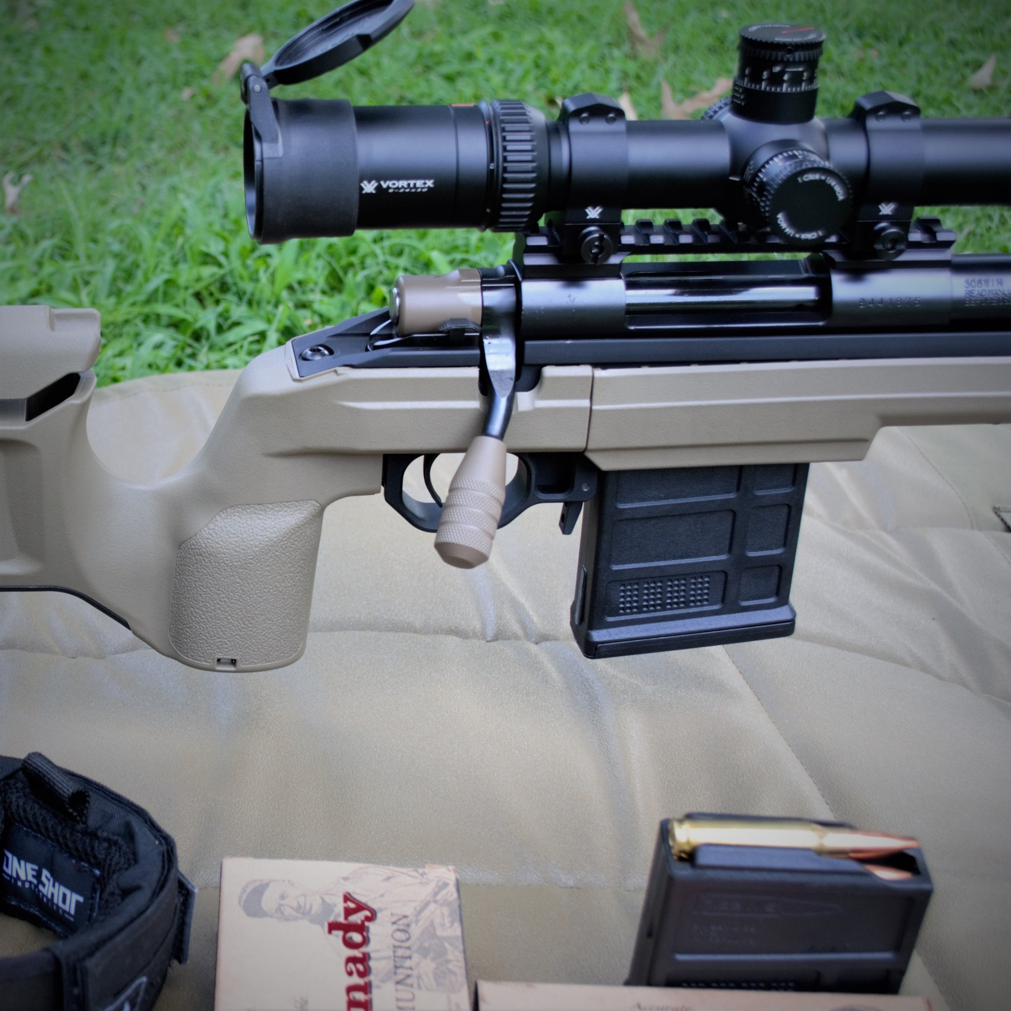

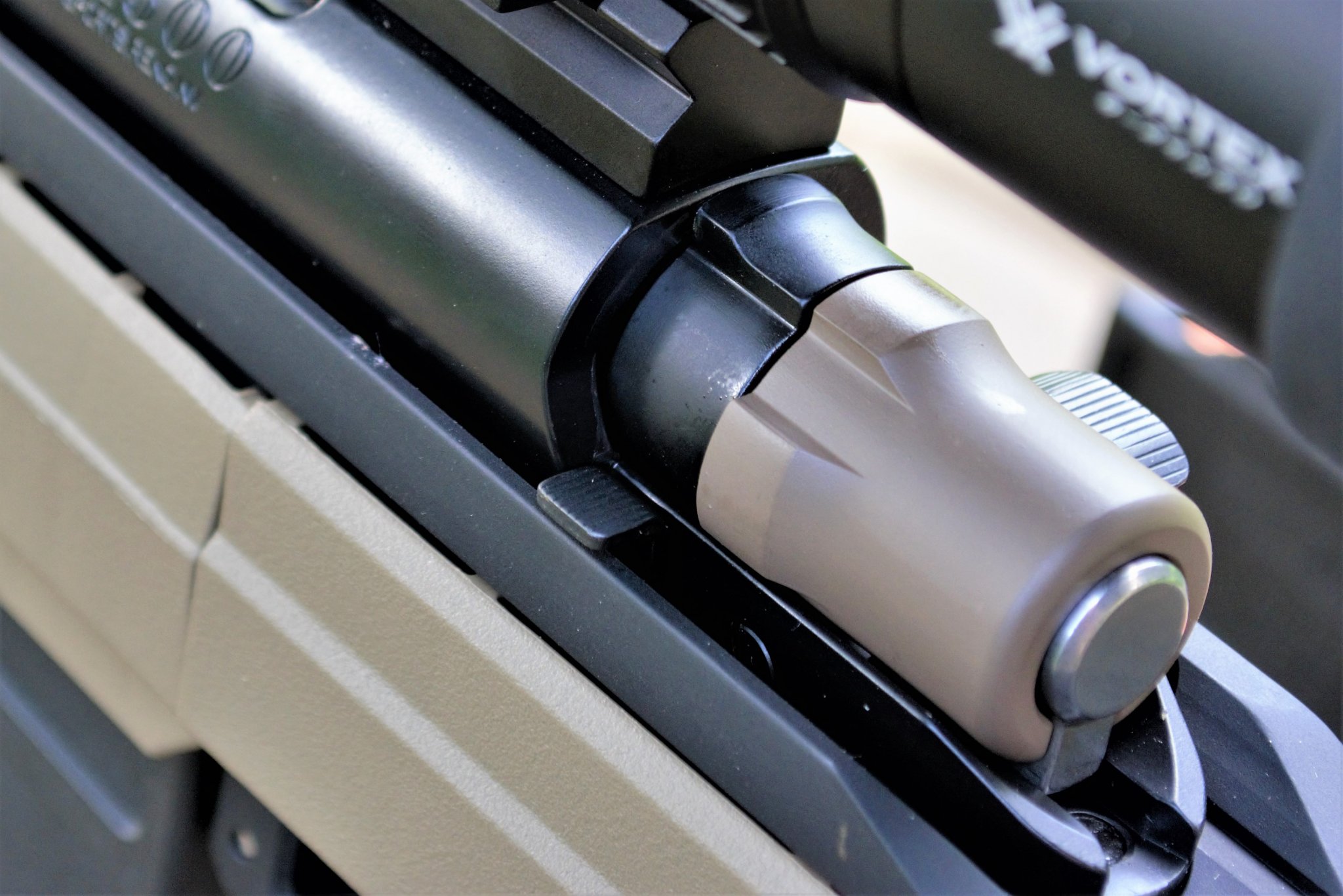

I think mine looks pretty fantastic. Barrel and action are Cerakoted Black Graphite (H-146Q), and the bolt knob, hood, and muzzle brake are Cerakote FDE (C-246Q).

Am I the only one that saw this paint job and thought of this...

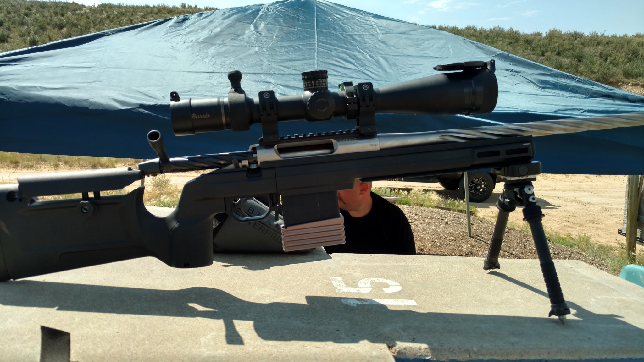

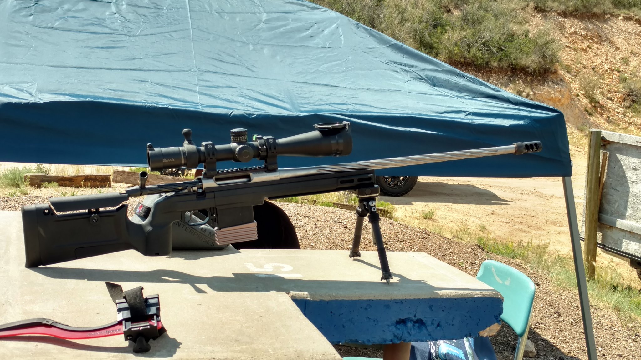

I will try to get some closer up pictures but here you can see the setup I ran. I wasn't planning on using that scope but my other one went down the day before a match. Here the bolt is in the rearward most position. I put the cheek rest just to where it would clear the bolt and the cheek weld was fine for me. That is a 34mm tube in the ARC X-high rings.

I will try to get some closer up pictures but here you can see the setup I ran. I wasn't planning on using that scope but my other one went down the day before a match. Here the bolt is in the rearward most position. I put the cheek rest just to where it would clear the bolt and the cheek weld was fine for me. That is a 34mm tube in the ARC X-high rings.View attachment 6934197View attachment 6934198
Greatly appreciated! From what I’ve played with the havak I do like it but I do not get making a “700 footprint” action but having the subtle differences/pains lol. My HP1 showed up at shop last week I’m just waiting for stock and parts to show up so I can make one trip.
I only chamfered the back edge of the recoil lug slot slightly. The timney that came with the HAVAK rubbed the right hand side of the trigger cutout. The safety was rough to operate but still functioned. I did not sand this down in my Bravo, rather I swapped to a Huber. What other differences/pains are there?
The length of the bolt/shroud. I have the bravo on a Christensen Arms action and had it on a R700 actions for a minute and I can run the cheek peice anywhere and not have it hit. Also the extra length on the end of the other side of the action in front of the recoil lug. There isn’t a issue with that with the bravo because the “chassis” is level end to end. Standard 700 inlets on stocks don’t work with Seekins due to the action material in front of the recoil lug. That being said if it has room for a prefit barrel nut the Seekins has a better chance of dropping right in. It’s very close in a lot of ways but I don’t think it’s a straight up works with any standard 700 inlet stock/chassis.
How does you barrel do on matches? I went with an HP1 I stead of the ph1 thinking the lighter barrel may heat up too much and start walking but now I think I am regretting my decision lol.
the barrel gets pretty hot in 8-10 rounds. I don't notice it walking, but have not had time to specifically check. In the sun that day I was not able to pick up the gun by the barrel it was so hot. For a 6.5 PRC at elr matches i would much prefer a heavy barrel both for heat and recoil. Even in the Bravo this is a pretty lightweight setup.

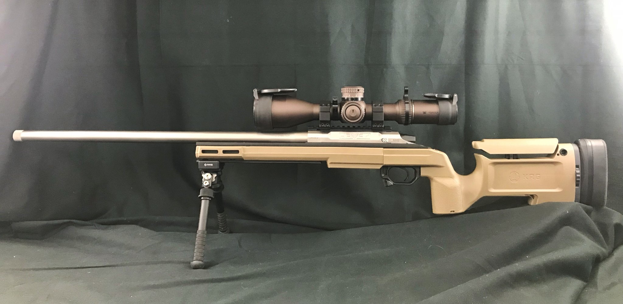

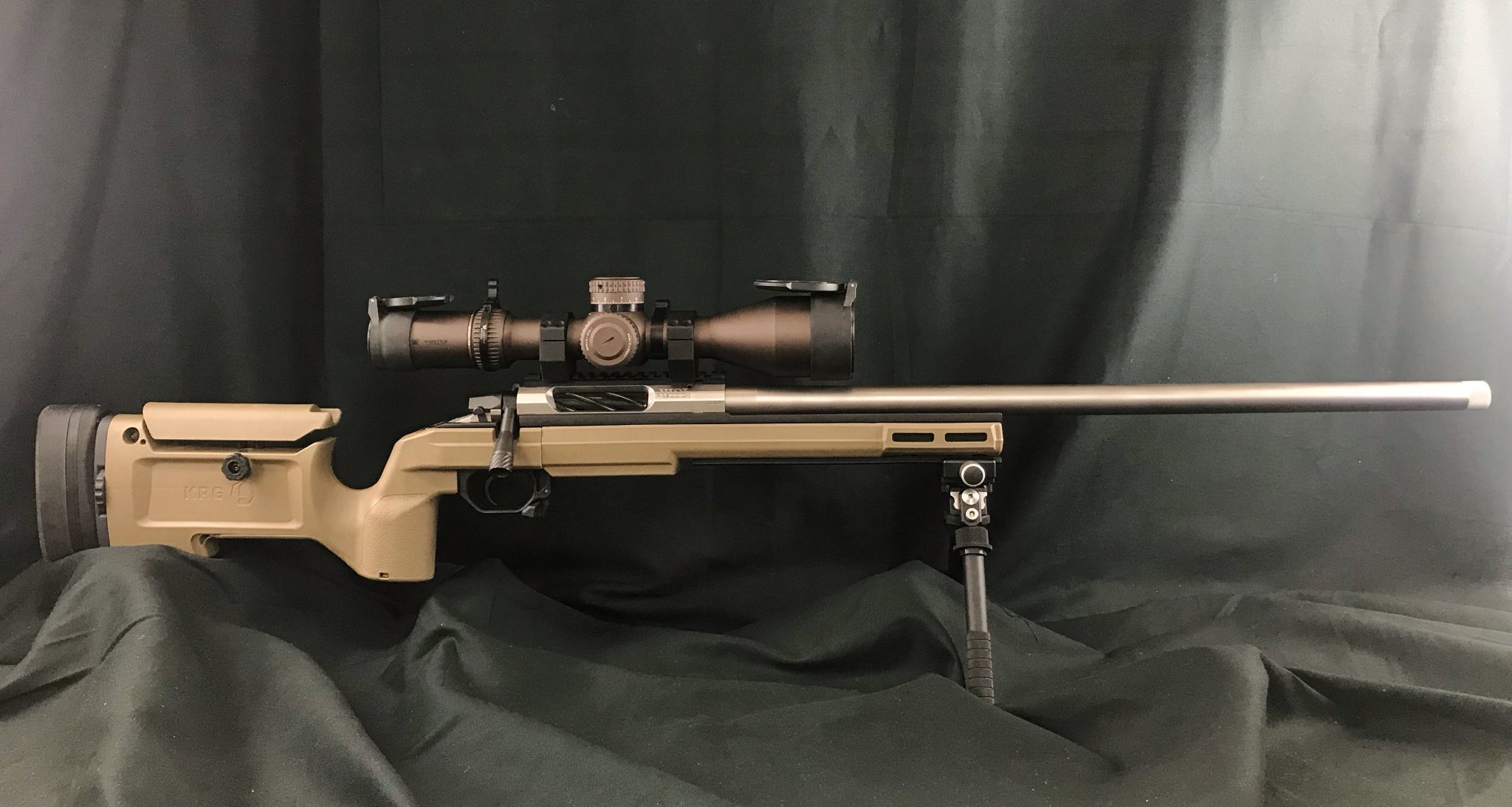

Second Bravo Chassis- this time for the Seekins Havak. Had to mod bolt catch to allow the bolt to be ran with mags, and the bolt does hit the cheek piece when it’s up high enough. Other than that it drops in and is a great option for the Havak! On this one I added the Arca Swiss Rail, butt hook cover, and adjustable tooless butt plate. I will also add a stick on cheek pad to avoid having to make a permanent mod to the cheek piece to allow for bolt clearance.
This a “newer” Bravo. The recoil lug area was already relieved, mags drop free, and the extended mag release came on it. The Bravo I purchased a couple months ago didn’t have any of that. Great new touches to an already awesome product!
