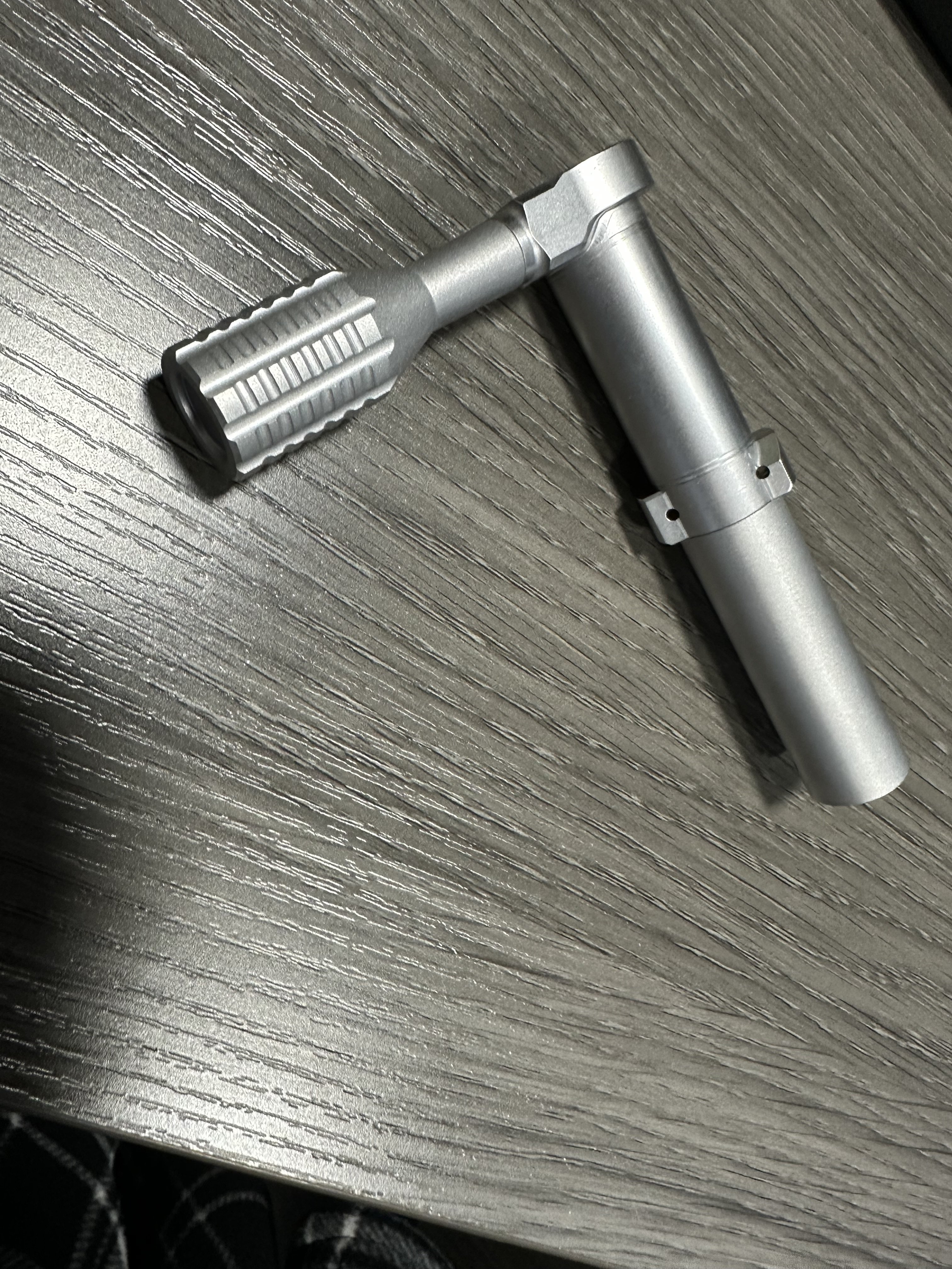

Most owners experienced with 700 pattern custom 22LRs have had to become low key rifle “tuners” to get them running smoothly with even 1 type of mag, let alone several brands. I know from experience. For prospective owners, a barreled action with mag, already tuned to the specific chassis would go a long way. Otherwise manufacturers open themselves up to a lot of online criticisms when $2500+ “builds” run like shit because the new owner is not an amateur gunsmith. I think that’s why CZ builds and Bergaras are still so prevalent. My Duece is accurate, and becoming smoother as I get more experienced with tuning, initial ownership experience has not alway been joyful, considering the cost.

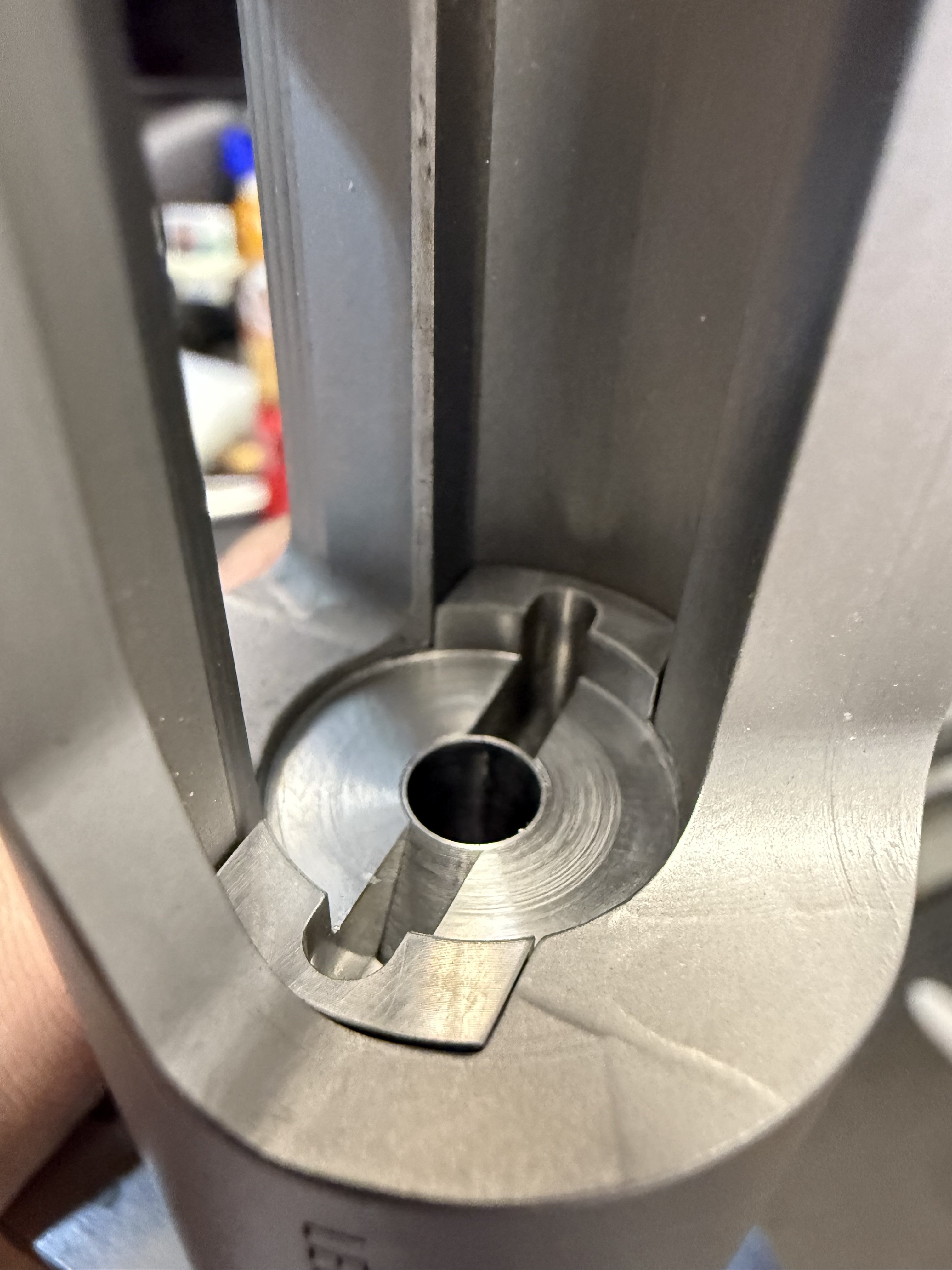

The widened extractor cuts seem like a no-brainer to me, these cuts are always the reason people say a Vudoo can't take prefits. I always thought they could just be cut wider, or eliminated entirely with a coned breech a la RimX, with no compromise in function, but I also don't make actions or cut barrels.
Either way, glad to see the innovation! Would be interested in the barrel torque specs and a review of bolt stripping/cleaning/adjustment when the design locks in.

I made many pre-fits for the Vudoo, not a hard thing to do and without timing threads. About half of my Vudoo's were barreled without the host action in hand.

Who made you a prefit without the Vudoo in hand? Was is from a smith who had your action in hand before and had the measurements on file?

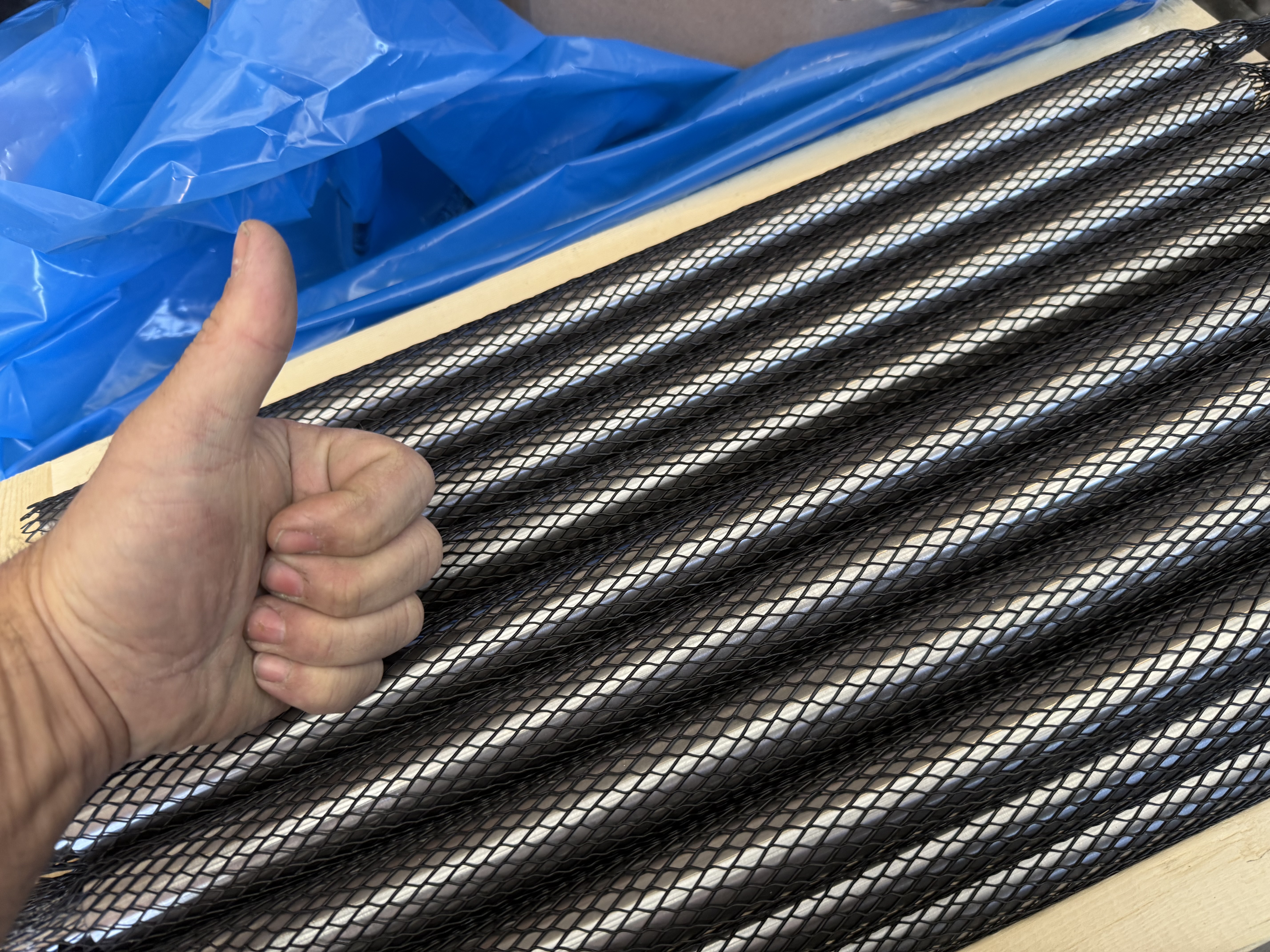

I probably missed it somewhere in this thread, but are the blanks made in house? If not who’s are they? Button or cut? Rifling style? Straight bore diameter or choked / tapered & if they are choked are they crowned at the choke? Will you be offering different barrel contours and lengths?
They are not made in house, we closely partner with a barrel manufacturer to produce them to our specifications. They are a button cut 6R rifling profile made from 416 Stainless. They are vacuum stress relieved and lead lapped. They are a straight bore with a 11 degree crown. They are manufactured on modern CNC machines to exacting tolerances and air gaged to ensure conformance. We are offering one contour and one length at this time. Our barrels are proven performers!
