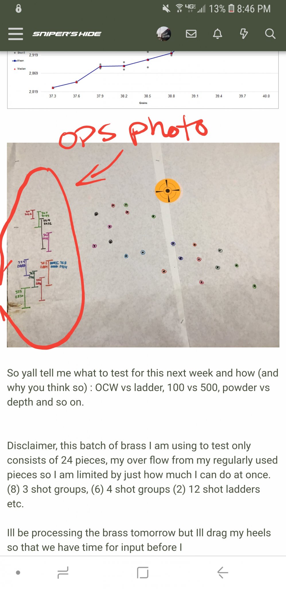

The pictures from the original poster are too cluttered for me to see what he is getting.
He needs to take out a measuring tape and list the difference between each shot in only the vertical direction.
That means he can have two shots 4 inches apart horizontally but only 3/8 vertically.
We are only interested in the vertical.

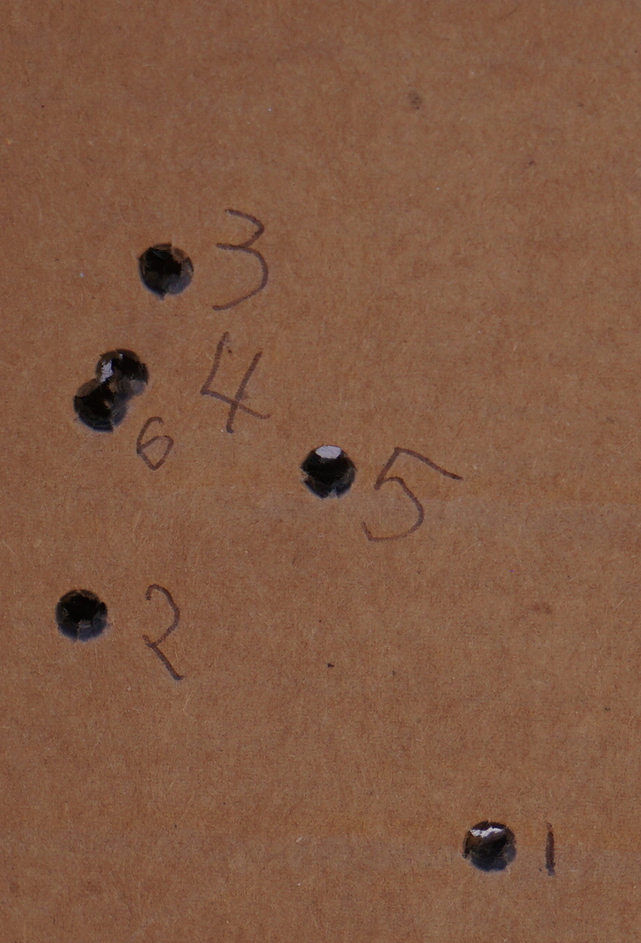

He did exactly this on the left side of the group photo....
7042471
On that target I should have put the comparison lines in order of lowest charge to highest left to right. I had that thought after the third one... which was already out of order lol.

Looking at the left side of the photo doesn't tell me what I am after.

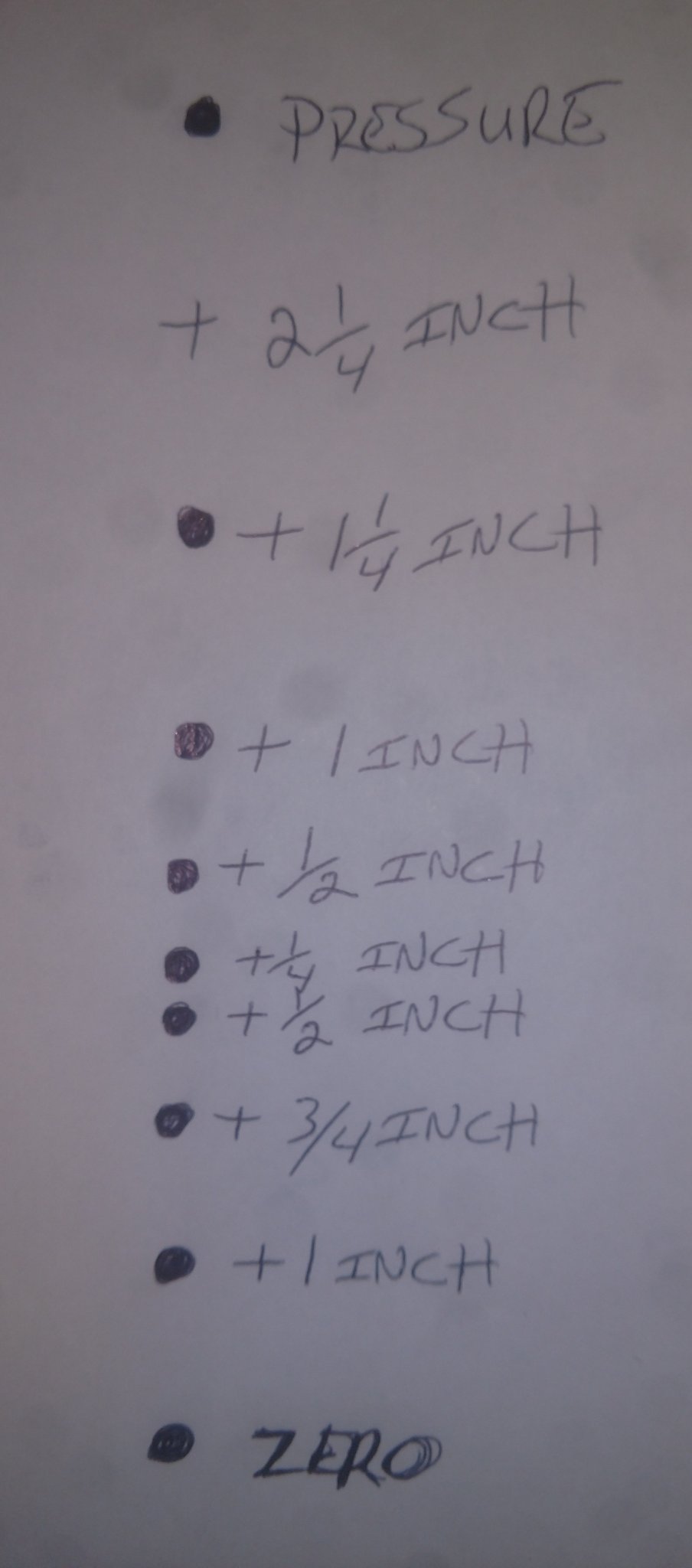

I will draw it up on paper and take a picture so you can better see what the goal is.

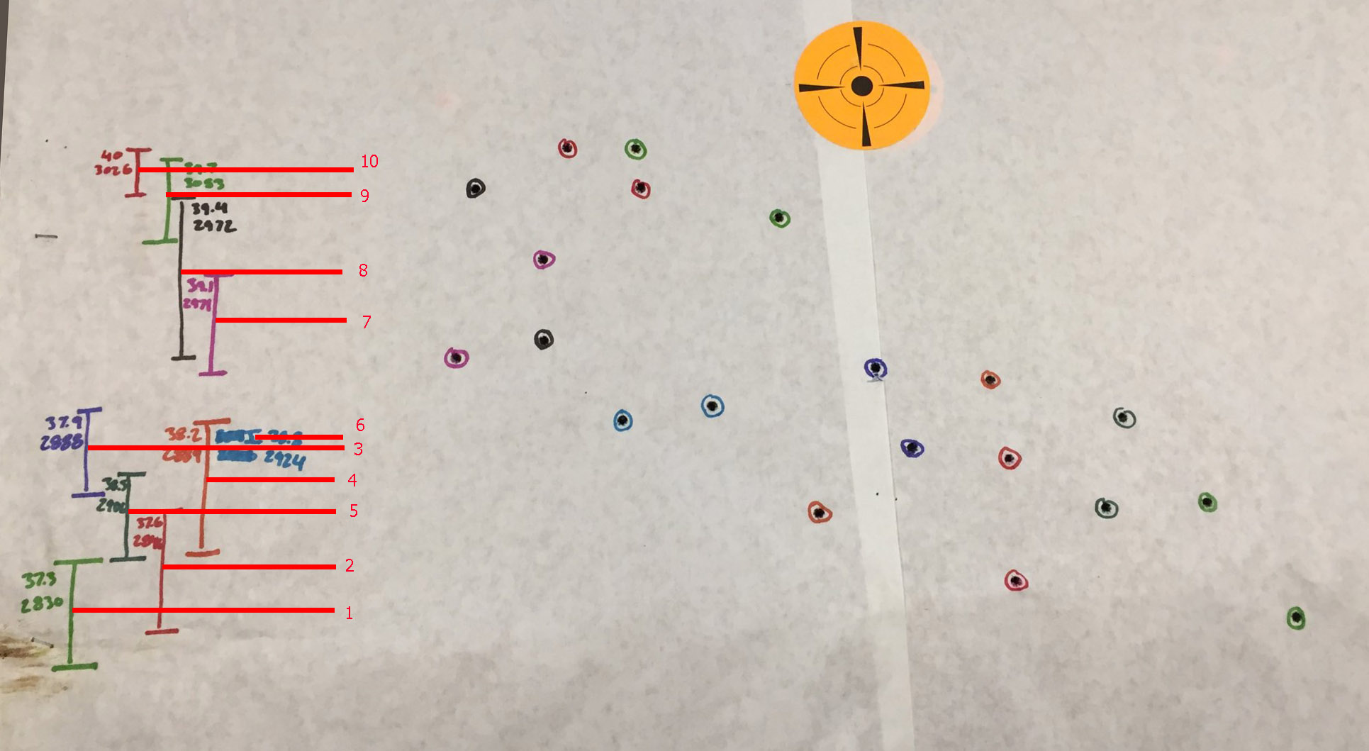

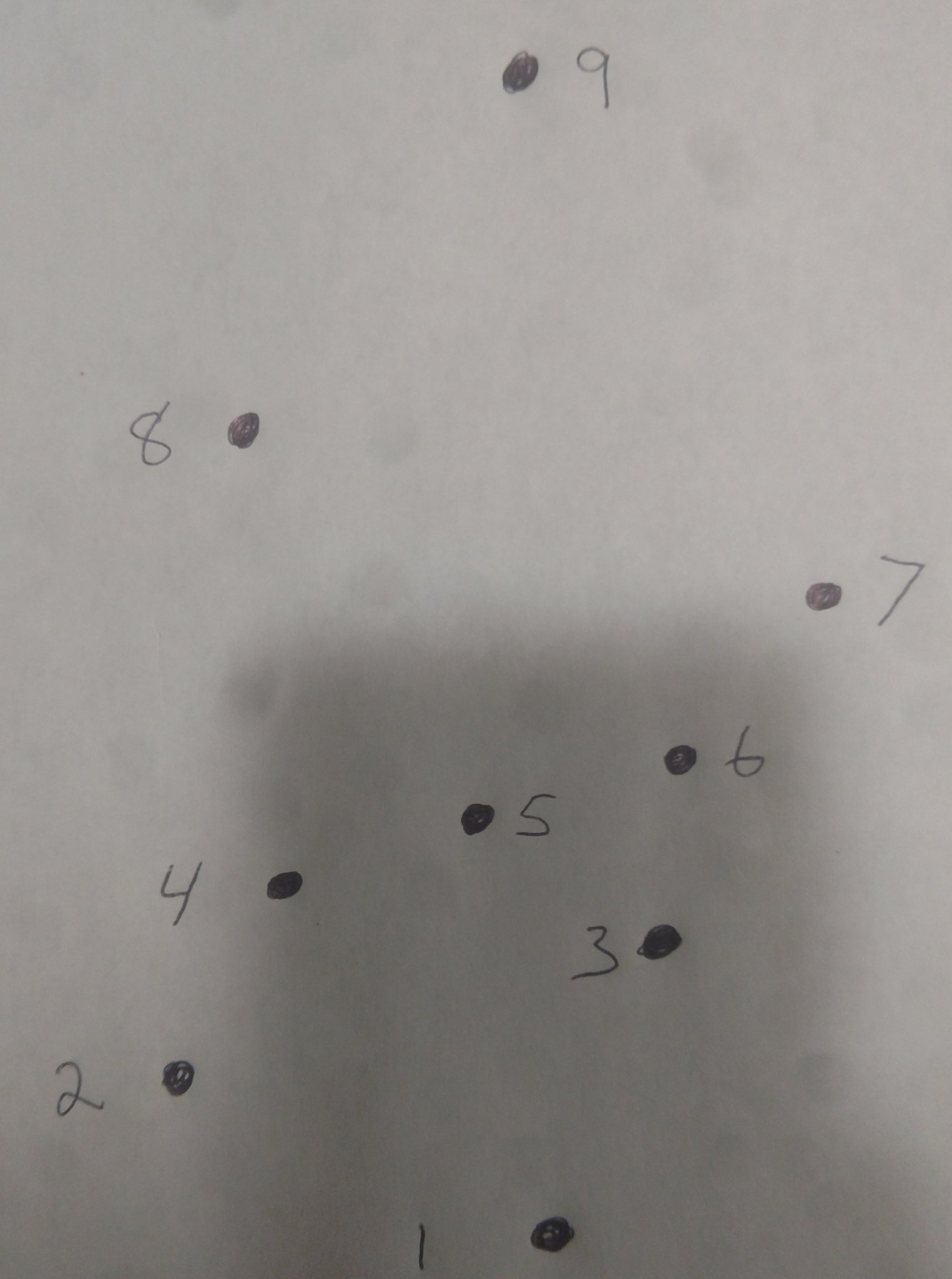

Alright if you look at this picture it shows a 9 shot ladder test with each hit numbered.
Now shot number 5 showed where the barrel is approaching the top of its arc.
Once you have that you move the bullet in only one direction because you started at the maximum length you will ever use.
You will never have any pressure issue doing it this way.
Now you play with the seating depth in 0.005 increments shooting 3 shot groups until you are 0.030 off of the lands.
If your using VLD bullets you would then go in 0.040 increments until you found a second spot were accuracy was good up to 0.200 off the lands.
If your shooting lathe turned solids you would start at touching the lands and move shorter in 0.020 increments until best accuracy is found which is generally right at the lands and 0.060 off.
You need to use a comparator to set your seating depth and only shoot rounds that are within 0.001 of each other.
With mass produced bullets you can get wild extremes in one box.
Once you have your optimized seating depth you go back to your powder charge and look on both sides of it because nodes have width.
If your using multiple different powders the nodes width will change.
Faster powders will have a narrower node than slower powders.
Best accuracy is always at the halfway point or higher on the node. If our node runs from 64-66 grains of powder best accuracy will be between 65 and 66 grains.

@Lynn Jr
He did the same thing in his powder ladder. Just 2 shots per charge instead of 1. And he didn't label the target the same way, but if you look at the charge weights it's the same thing. Just read his handwriting. Nodes are at 37.9-38.5 and 39.7-40.0 (and likely just above 40.0).
You get the added bonus of looking at 2 shots per charge weight, so you can see how well each pair of charge weights held vertical when compared against the other equal charge, and you can base your evaluation on an "average" vertical POI. Gives more validity to the ladder.
Here it is, converted to a 1 through 10 scale for each charge weight in ascending order, from the midpoint of the shot pairs. You can see that weights 3,4,5,6 actually invert a bit with higher charge weights hitting lower on target. However, each pair doesn't have great vertical and more importantly they are around 2900fps which is just silly slow for a 6XC with a 105.
Things start getting promising again around 9,10 etc which is approaching the 3050fps node.
7042603
What I am seeing is the shots going backwards at 4,5 and he never reached pressure.
When you get above the high node the vertical change per grain of powder will drastically change.

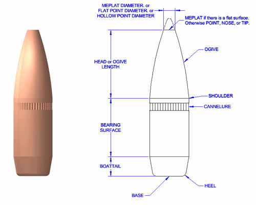

The boat tails are better than the VLD's in 6 creed?
Are the VLD bullets not a boat tail design? (they are. just pulling your leg)
7042898
I can guess what you mean though since berger calls one product line the boat tail though.

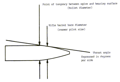

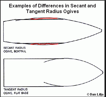

The BT has a tangent ogive design, the transition from the curvier ogive of the bullet to the bearing surface is smooth and even allowing it to slide into the lands painlessly.
The VLD has a secant ogive design, it has a longer flatter nose for better aerodynamics but then where it hits the bearing surface it has a more defined transition. This makes it more seating depth sensitive as you need typically need to time it a bit more carefully.
In this image they continued the lines of the bullet ogive, as you can see the lower one is tangential and it flows in smoothly. The higher one is secant and if you were to continue the curve from the ogive on around it would be wider. The bearing surface cuts it off making an abrupt transition. The area shaded in red is where that curve is cut out and removed from the secant bullet.
Tangental only has the curve encounter the bearing surface at one point (tangent) where as the secant has a curve that would geometrically encounter the bearing surface in two points (secant).

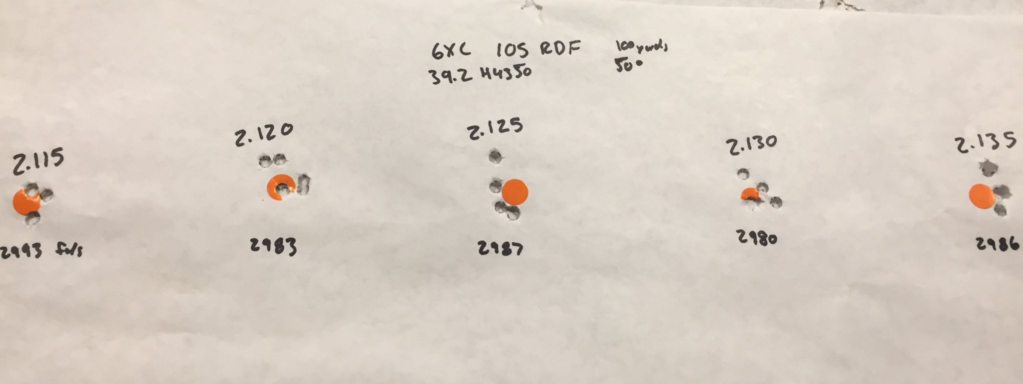

Well I did a seating depth test at 100 yards, 2.115, 2.120, 2.125, 2.130, 2.135. Results arent spectacular but its what the doctor ordered.
Because I only have 24 to test the 5th shot is absent from 2.115 and I forgot to turn it on at the start. So Im missing two velocities for that test and I guess I got too far over to the side on the missing 2.130.
7044001
7044003
(1/2" orange dots)
What next, an OCW at 100? From 39-40 in .2 increments and 4 shot groups? 39.5-40.5 test for sheldon?
(1/2" orange dots)
(1/2" orange dots)
Look at how the groups basically start out round on the left and string out vertically as you go from 2.115 to 2.135. This is exactly what I was talking about above. If I was doing this, I would now go with 2.115 and tweak a couple of tenths fore and aft in the powder charge to make sure I'm in the middle of this node.
I would consider the winner to be the best load within the small velocity window I was looking for. If it didn't perform to expectations, I wouldn't keep dicking with it. I would go with another combo. That way I don't end up burning barrels and chasing fairies.
Finally figured out how to post pics - again - I used to use photo hosting sites which quit working for some reason.
Spife, I'm being a bit presumptuous but I would like to show you and others my last ladder test with my 6mmBR at 400Y that I did a few months ago.
This is in """.1 grain increments""" it's the high node with Varget and the 105 hybrids. Starting at 30 grains, I chose #5/30.4gr, although it's 1" right, because it splits the difference - all .2" of 4, 5 and 6.
A few of the 100Y group pics were shot this morning and some the past weeks, not the greatest but not bad either. Off bipod and rear bag and I used 20x. Hey man, give me a 50x scope, a proper benchrest, edgewood rear heavy BR bag, and I think I could show improvement!
I thought I'd be smart and aim a bullet widths left into the 2-3 mph gust this morning which cost me in the largest orange sticker, darn.
I didn't use a chrono during the ladder test but did the next couple times out, going from 2895 to 2915 fps - a little difference in speed because of temp changes. SD on the first outing was 3 for 5 shots IIRC.
