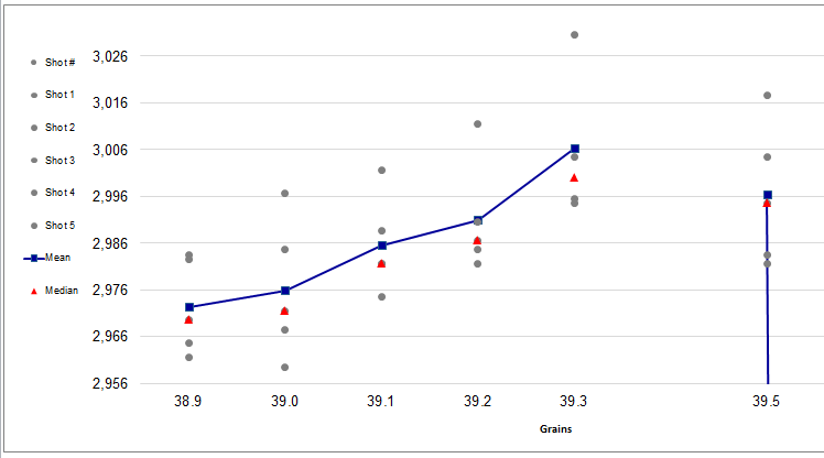

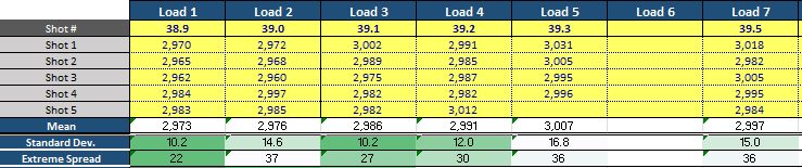

Ladder Test- Hide Input wanted on the next step
That 39.4 looks like a winner. 39.2 was my original prediction.
Side note: I have been scouring the interwebs on any forum I can find for OCW's and ladder tests. I have found several dozen, going all the way back to 2005 I think was the oldest one I found.
From those I've found where a definite winner emerged, I would say that out of every 10 of them, 9 ended up being at 2% off of max or 2% + 0.2 grains from max. This includes all calibers from 338 wildcats to 223 Rem.
I am not willing to say it is definitive, but I can say that it pops up so often that it shouldn't be ignored. Just a trend I've noticed. Do with it what you will.
Is this trend you observed at 2% from the listed max, or 2% from the max load determined from that particular gun and that set of components? Very interesting trend that would make for a good target zone to expect good accuracy when doing either method. Thanks for sharing.
It was from that particular gun and set of components where they started seeing pressure signs.
You can test it for yourself pretty easily. Just take note of where you saw pressure, and multiply that number by 0.98. You can see just how close you are to the load you actually picked. It is very often spot on, or within 0.2 grains.

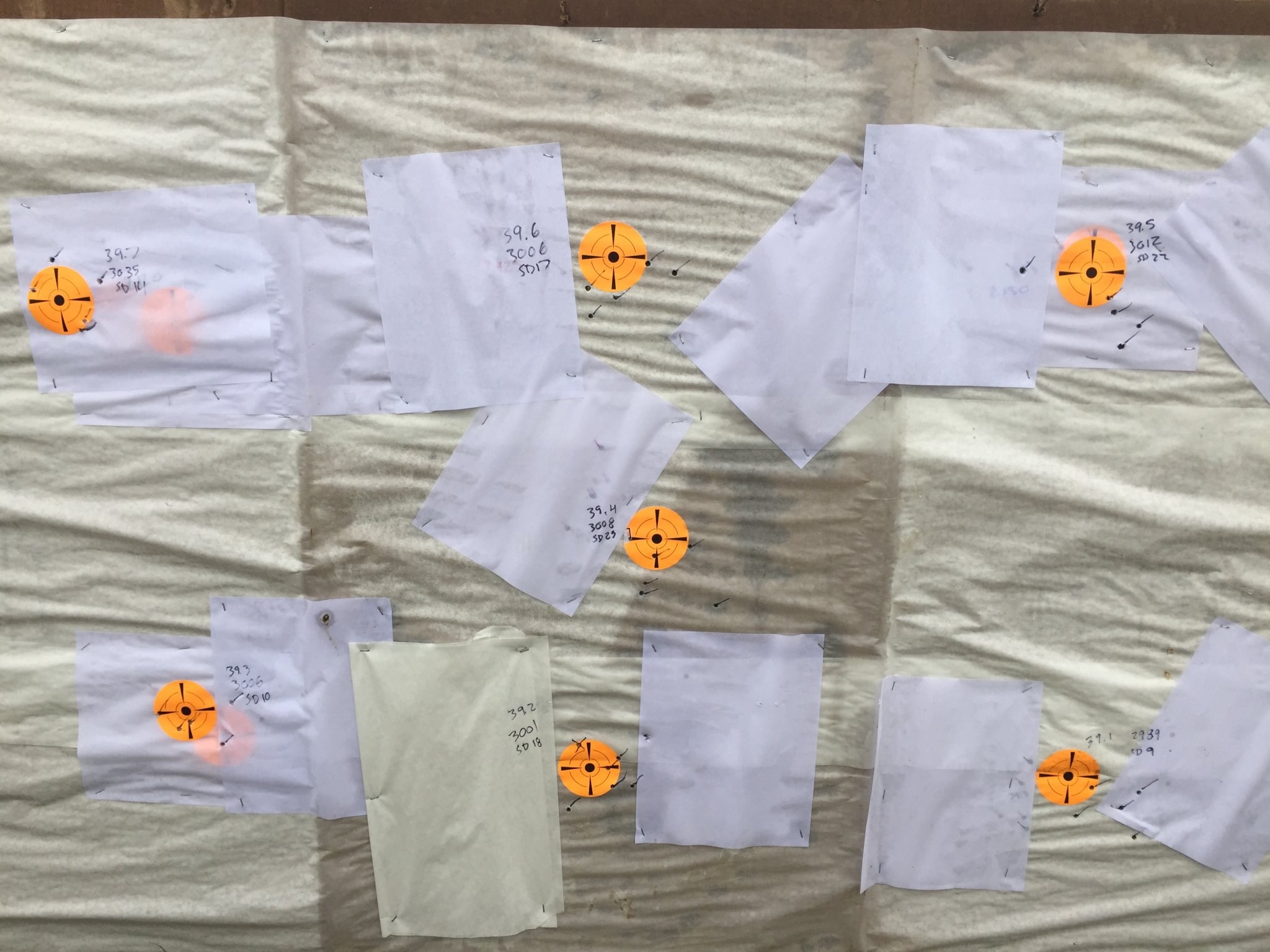

As you can see it was a bit wet today... tough to get the marker to show up well.
7056252

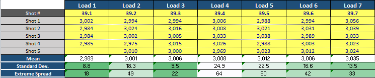

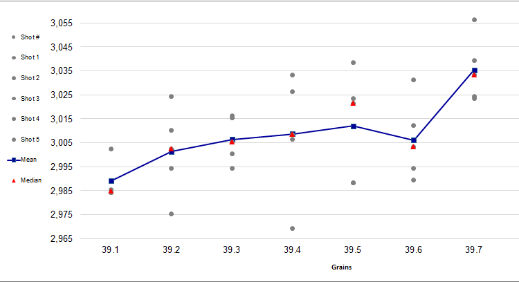

You rolling with 39.1 then?
I guess so. It matches the velocity of my prior chosen load.
Also, 39.7 was getting hot. All rounds over 3030 fps had heavy bolt lift and that 3050 one had smear around the primer and a good amount of force/clicker to open the bolt. There may be accuracy for Sheldons hypothesis but I’m not going to play there.
39.3 has the best vertical, 39.1 is fairly round and not too bad vertically, 39.2 has 4 shots in about an inch with just that one landing out. I don't think you would do bad with any of them.
This another nugget for my 2% hypothesis. You saw pressure at 39.7 on this particular day, 2% backed off from there is 38.9 grains. You chose 39.1 grains.
The trend I have been noticing is that either 2% or 2% + 0.2 grains off of the place where you find pressure is a sweet spot in a very wide spectrum of calibers and loads.
Just an interesting side note. Thanks. (y)
