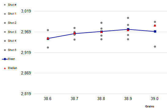

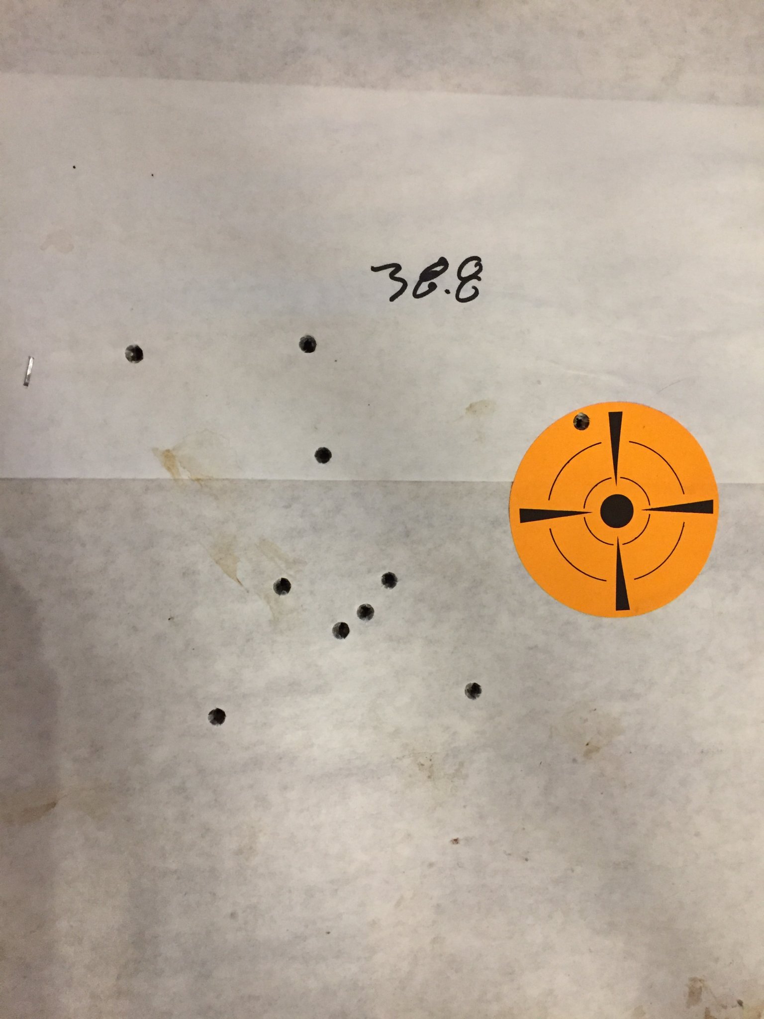

Please humour me and do a test with 38.8
Youre going to enjoy seeing this target...
7047983
7047984

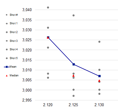

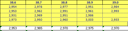

That is a retarded, ridiculously tiny group! Too bad the SDs didn't follow it! 15 isn't terrible but would have been awesome to see it around 10 or less. Good shooting @spife7980 !
There is a good argument to try that seating depth at 39.1 +-.1gr to see if SDs follow and have same precision.
It had good vertical at distance and it is accurate at 100 yards so It begs the question, is SD as important as we all think it is. I would like to see if that group can be replicated with the same seating depth and charge.

Valid question. I don't worry too much about SD inside 800... Beyond that it shows up pretty fast. Especially with lighter bullets.
At 700, 6.5cm will be .7MOA different with a 25fps spread. At 1000, its over 1.3moa and continues to grow. That's well over enough to miss at PRS size targets even with perfect hold.

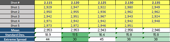

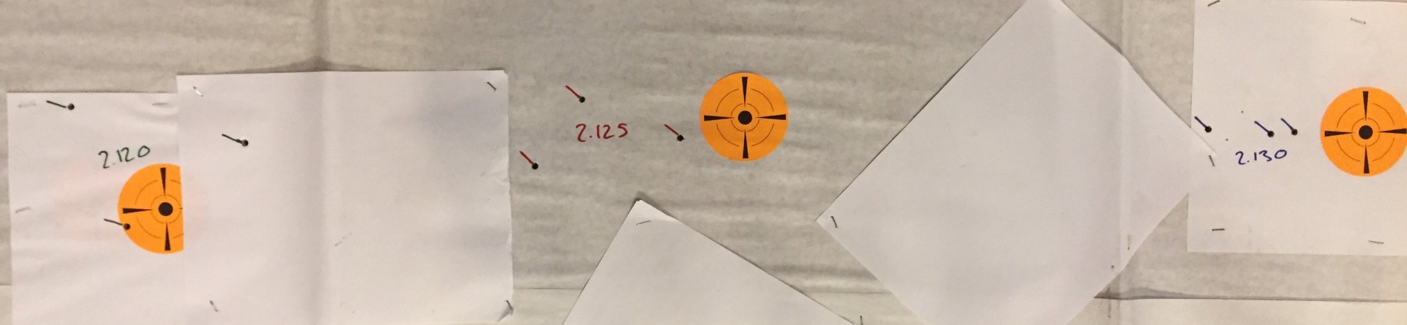

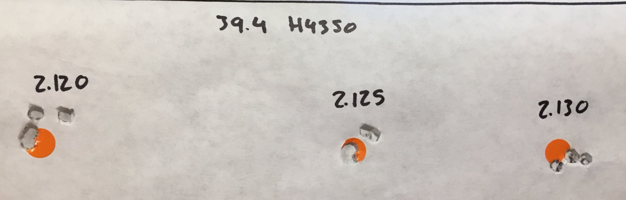

is 2.125 5 shots in one hole?
Pretty much, a bit wollered out but yeah.
The 2.125 would be .015 off touch the last I measured.
I was planning on doing a .2 ocw next but I guess I’ll just load up these to see if they repeat and how they do at distance

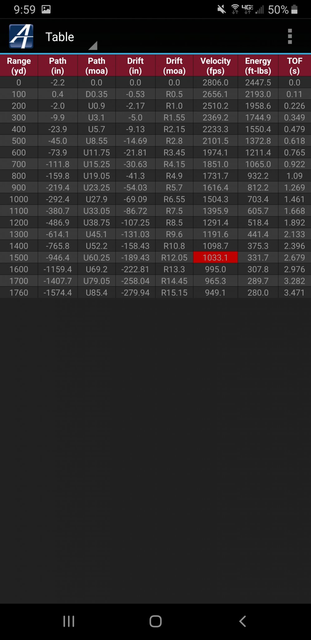

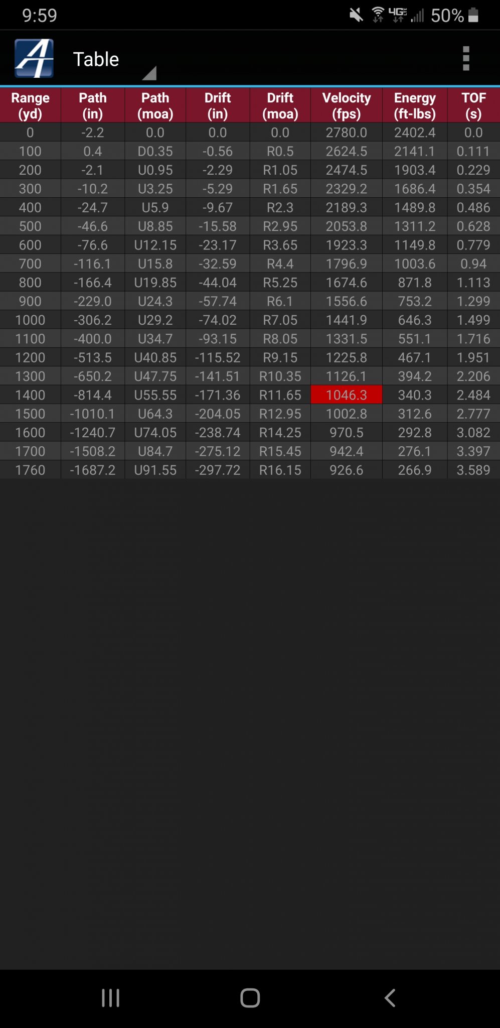

Are you sure a 25fps spread would be 13” at 1000yds?
Same bullet and atmospherics/environment. 26fps difference: 2806fps has 292.4" drop and 2780fpa has 306.2" drop. 13.8" difference to according to AB Mobile.
If you believe calculators are correct, then yes I'm pretty sure. And it falls inline with my experience at 1k+.

Tested 38.8 in .1 increments up to .2 above and below.
7052318
7052320
7052336
And then I tested 38.8 at 2.125 at 500 for a 10 shot group. Averaged 2969 with SD of 16
7052343
What I find interesting is that these velocities of 2970 (+/-20 fps) that Im seeing are equivalent to what I was seeing last summer when I initially developed my load of 39.4 gr... half a grain less powder and the same velocities. I did a seating depth test on 39.4 right after and its quite a bit hotter than it used to be.
I did a group of 4 at 100 daisy chain style and then a group of 3 at 500. I forgot to to activate the labradar for the first series at 100. And then the wind was picking up as the cold front blew in so I shot each group quickly together to try and match conditions within th group but I forgot to repoint the labradar to my 500 yard tartget and I think that may be why the last 3 for the 2.120 load are 30 fps faster.
7052325
7052326
The 4 at 100
7052337
And the 3 at 500
7052344
@spife7980 have you checked your accuracy load to see if its still shooting?
im not a smart man but so far none of this testing is looking good.
I know that’s a dream water line but he shot the same load at 100yds what am i missing? Serious question.
He has 3 shots in one hole with a couple of outliers. I don't ever under estimate human error and it was only one group. With a waterline like that I would roll with it as long as it wasn't producing pressure or close to it. But that is me.
Gotcha.
My problem with that is there is nothing on either side of it to lead me to believe there is anything worth chasing.
39.4 @ 2.120” was my load. But that used to be going the same speed as the 38.7-38.9 is now.
But the 39.4 still shoots well, I guess my lands may have eroded .010 further than last time I checked. I’ll have to check them again just to make sure.
Reactions: 47guy
how many rounds do you have through that barrel?
I’ll have to check when I get home but I think I’m around 1500? It’s no longer young in the tooth but I’m hoping I can get another 500 out of it. As soon as my dasher is barrel is ready this 6xc is getting moved to a loaner hunting rifle.
Id expect to be loosing speed though if it were shot out, not gaining speed.
Edit: yeah, 1500 on the barrel
Pss: Just checked, the lands are right where I thought they were at 2.150 for resistance-free bolt fall via the wheeler method. So they didn’t suddenly shit the bed. I’m curious why they are all going so much faster
That 39.4 looks like a winner. 39.2 was my original prediction.
