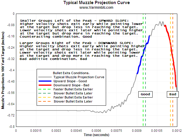

Just so some of the other newer readers that may not be as well versed have some basis for the discussion going on in regards to this thread:

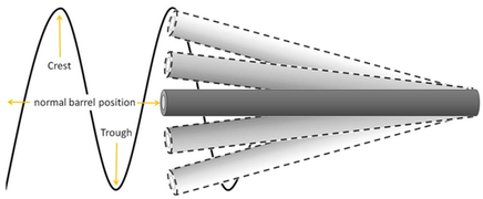

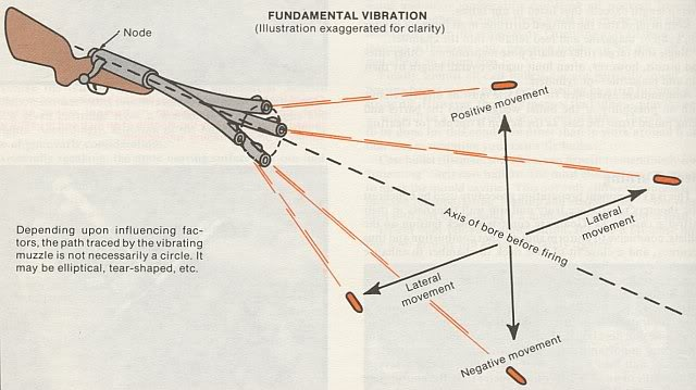

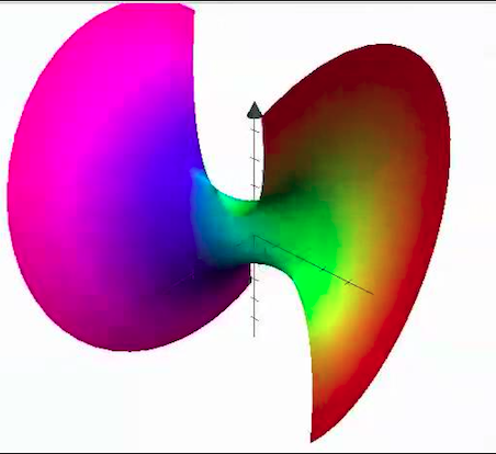

The barrel vibrates when fired. Mapped on one of its axis it looks like this. This is typically what we are going to envision with a ladder test. A simple sine wave. This is what the ladder test is really trying to display.
That said a barrel vibrates in many ways. Each with their own sine wave pattern, so suffice it to say that and modeling we are trying to accomplish through these tests is really just a best guess.
I cant get the gifs to embed here but this link visualizes all the different ways the barrel can vibrate, worth a click to see the animations https://www.varmintal.com/amode.htm
As you can tell from those animations trying to model this would be extremely intricate (a pain in the ass) but is what Optimal Barrel Time is basically trying to accomplish http://www.the-long-family.com/OBT_paper.htm
This is probably more indicative of what the vibration sine waves would look like when all graphed together lol

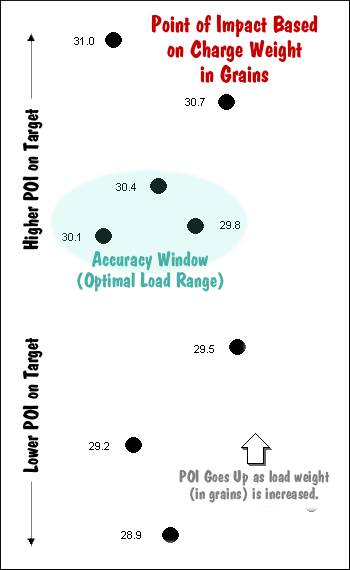

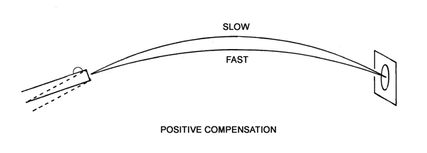

So that brings us to the Ladders fundamental principle: Positive Compensation- basically we are looking at the initial single axis sine wave graphic I posted first and ignoring the others for general discussion. The fast bullets are coming out early in the cycle so they exit the barrel at a lower point of its vibration and the slower bullets take longer so they are in the barrel long enough to catch the highest point of the vibration.
So with a ladder test we are only really concerned about the vertical displacement at distance, in this example the 29.8 is slower and is released at a higher spot in the barrels vibration, the 30.4 is fast and is released at a lower spot in its vibration.
Ladders ignore left-right windage and rely on distance to minimize the shooters error and for velocity to be the main driver at comparing how the bullets shoot.

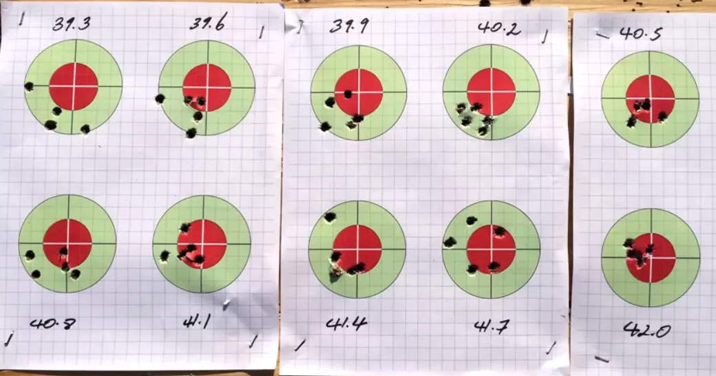

What about the other axis of vibration though? Thats where an OCW test comes in. It looks at not only vertical but also horizontal, and since we are focusing on the actual complete impacts 100 yards is the standard distance as its not really far enough for environmentals to play a big part yet still far enough to judge the rifles accuracy, everything will look good at 50 yards. It looks at not only vertical but horizontal as well. You look for where the groups impact compared to one another and try to find a stable spot where neighboring charge weights have similar points of impact.
If we were to take each of those individual targets, lay them over top of one another, and compare we would want to find a series of targets that have their impact centers close to their neighboring group so that it would look something like this hopefully.

Having tried a few different load development methods with the same rifle/bullet/powder combinations, I noticed a reoccurring theme/pattern. My OCW/OBT nodes NEVER matched up with my ladder test nodes. They were predictably a bit “out-of-phase” from each other.
This didn’t make sense until I started reading about ‘positive conpensation’ and the lights really came on after having a conversation with Alex Wheeler. I definitely think that positive compensation is applicable to precision rifle shooting. Yeah, F-Class & 600/1000 yard benchrest shooters can more finely tune their positive compensation for a specific distance, but you can still have positive conpensation working to your benefit across a range of distances, albeit optimized at a particular yardage (I like 500 - 600 yards for the matches I attend)... As opposed to finding/using a ‘node’ with negative compensation tendencies, which could easily happen with the OCW/OBT method.
So as I see it, ladder tests identify positive compensation and OCW identifies areas in the barrel timing where the effects of the oscillation/harmonics are minimal. Two different things.
Maybe oversimplified, but just observing the vertical component of an OCW test usually results in a sine-wave pattern that moves up-and-down relative to the aim-point with the ‘nodes’ usually ending up near the upper and lower extremes (the ‘flat-ish’ spots where the sine-wave direction changes). The ladder nodes nearly always end up at a powder charge where the POI is moving up relative to the POA. Sometimes near a ‘scatter node’ per the OCW method, more often closer to the ‘upper-inflection-point’ of the sine-curve, near-to, but off (behind/below in charge weight) of the corresponding OCW node.
Anyway, that’s just my observation and understanding after putting a lot of time and effort into finding what works for me. Probably should have just listened to Alex Wheeler when he told me it would be best to keep this (positive compensation ideas) to myself with regards to the PRS crowd and I’d have a little ‘leg-up’ verses the masses chasing their tails working up loads based on chronograph results ??? <— Paraphrasing BTW ?
