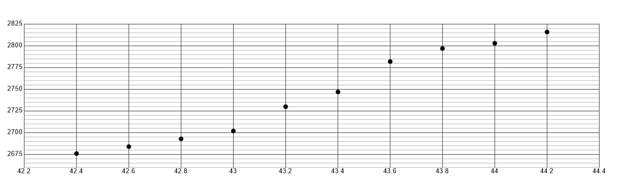

Shoot this today.
Seems to be a nice flat spot at 2800ish which is a speed I like for the 147's.
I'll explore that area closer and se if I get a decent SD and accuracy.
I'm interested in if this method works for me.

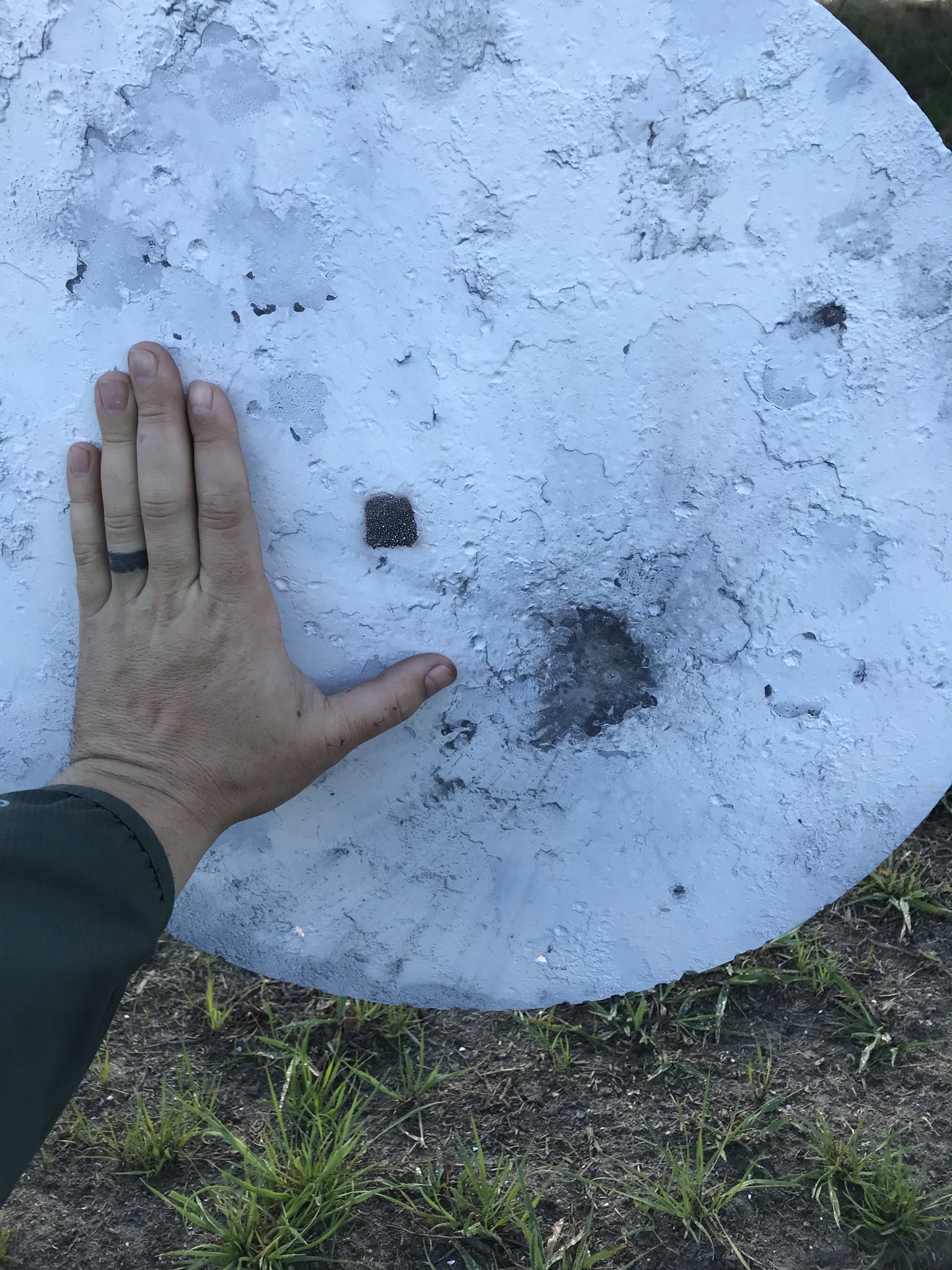

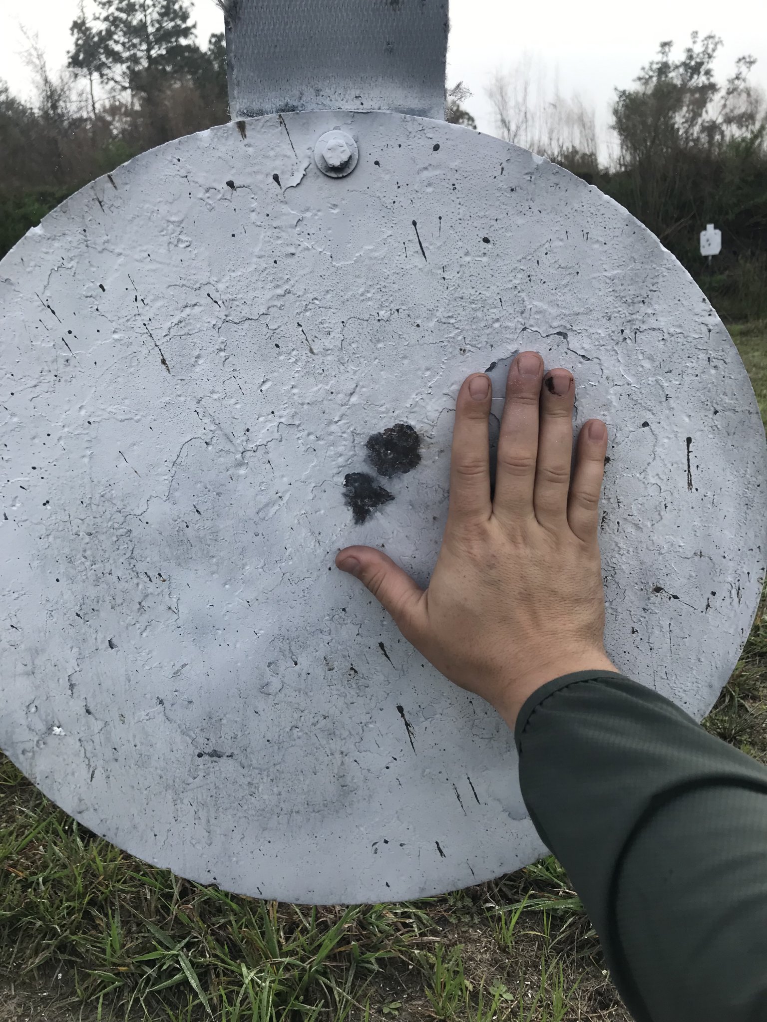

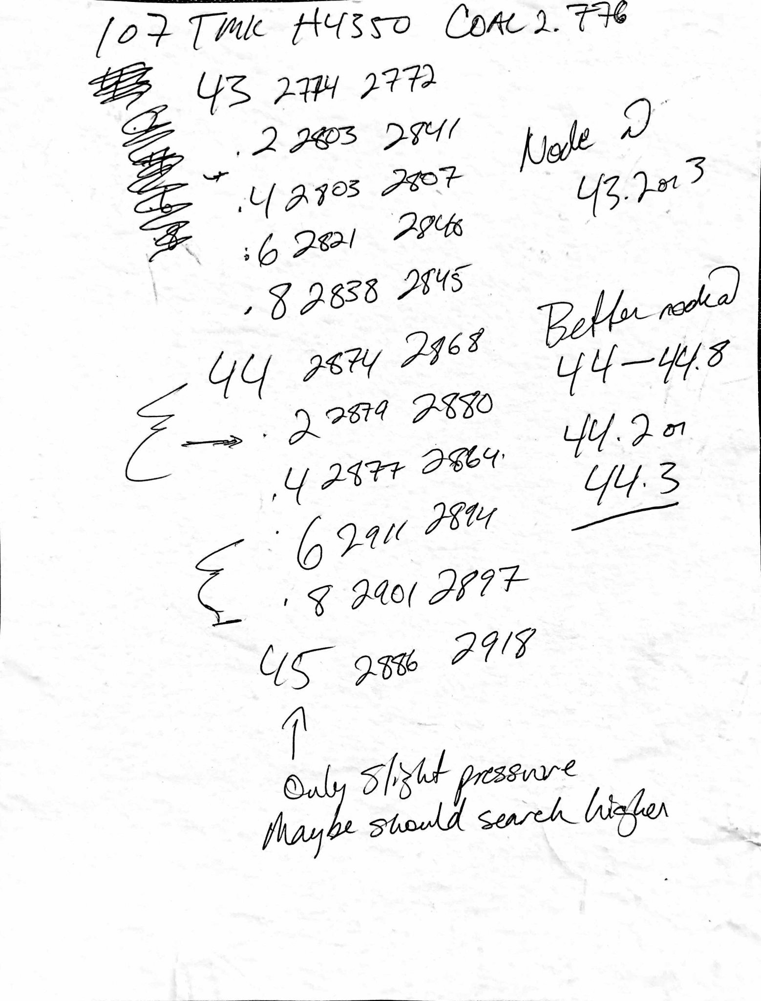

Ok, so since this thread is derailed as fuck I’ll try and make an effort to steer it in the right direction...which is probably futile at this point. Anyhow, before I start, you’re not going to get any qualification pics from me because I don’t have any. All I have are the results of doing a couple ladder tests for a 7mm Rem Mag using 168gr VLDs and Retumbo and 6.5 Creed using 107gr TMKs and H4350 this week, the results of which are sufficient for what I need. In the past I discovered that I couldn’t get a reliable load right off the bat with a 1 round per charge weight ladder, so now I load 2 and shoot it over the Magnetospeed. I literally didn’t even shoot at a target. Just into a berm. I look for velocity nodes (for new guys reading this for legit info, it’s where the muzzle velocity doesn’t change much but the charge weight does). I then pick the load in the middle of the node with the lowest extreme spread for the node and the lowest velocity difference (technically also an extreme spread...but since there’s only 2 shots it seems silly to call it that) between the 2 shots of the same load. For my 7mm it happened to be 69gr Retumbo. For the 6.5 Creed it happened to be 44.2gr H4350. I put that MV into my ballistic software and then load up 10-20 of whatever that load is to test and have some fun. I sight in at 100 (since my POI with the Magnetospeed is usually different than without it) and then dial for 300. I shoot off a bipod and rear bag. If the wind is bad I’ll shoot a 3 shot group here. If not, I’ll shoot 1 shot to make sure my windage setting is correct. If not, I adjust it so I’m center punching it. Then dial for 500 and shoot a 3 round group. I then true my muzzle velocity based on that data. Maybe I’ve just gotten lucky but it’s definitely worked for me. The pics below are of the ladder data for the 6.5 (didn’t take a pic of the 7RM data for some reason) and the first 3 shot groups I shot with each rifle at 500. Doing it this way has been way more efficient for me personally and I’ve been very pleased with the results. My hand is only in there for size reference later.
If your load looks good at 500 it looks very good at 100.
Your not doing a ladder test if it involves velocity but when incrementally increasing powder it will look something like this
Shot 1 3000 FPS baseline
Shot 2 3025 FPS +25
Shot 3 3050 FPS +25
Shot 4 3070 FPS +20
Shot 5 3085 FPS +15 node
Shot 6 3115 FPS + 30
Shot 7 3180 FPS +65 non linear
Shot 8 3325 FPS +145 pressure
Don't worry about derailing this thread the OP is on the right track now and a 300 yard ladder test is in the works using one of my rifles and a lady shooter who has never fired a shot before.
