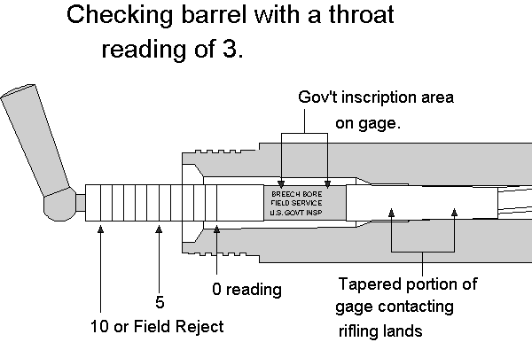

There are air gauges that will work. Just not the ones linked.
The limitation with air gages in rifle bores had to do with custom shape tools needed to be made to account for the rifling, then, the air gage would show a change in airflow indicating a larger or smaller condition but not providing more information as to where or what was causing it. In the end, it couldn't provide meaningful data. If the thought was to measure wear in the throat area, as it appears Justin is pointing to visually, I just don't see air working.
I have decided against air guaging.

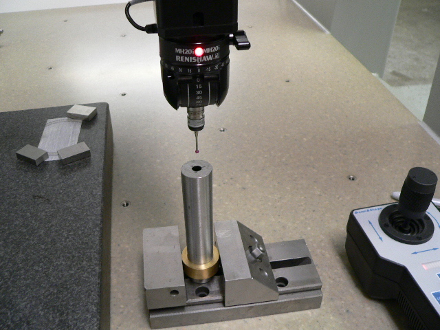

Thanks for the link. That is some interesting equipment! I own an optical CNC coordinate measuring machine that uses very similar technology. Just not on internal features. It measures depths using the focus of the camera system. It works well but the accuracy of measurements has its limitations. I looked for accuracy specs on the Novacam machine. As with mine, they state "repeatability" accuracy in the millionths of an inch but do not state a true accuracy. I'm sure that is because it's a variable and very complicated. I'm sure a super useful tool nonetheless.
There are numerous other systems that accomplish this as well. However not the particulate, flaws or finish evaluation. Those evaluations may be accomplished with different tests. Yes they are pricey. People just have to open their eyes and minds. They just do not wish to spend the time and effort it takes to learn.
Do these numerous other systems have a name? Got a link? What are these different tests? What is considered pricey? You speak in absolutes but with absolutely no detail. To me, that makes you sound like a bag of wind rather than someone with actual knowledge on the subject.

These are just a few things that should help the individuals that still do not understand. If the point is not made at this time then you must look somewhere else. There are more variable pieces of equipment that serve the same purpose from a very large group of manufacturers. Those you will have to find for yourself. That is what computers are for present day. Help yourself.
https://willrich.com/product/gun-barrel-diameter-gages/
https://willrich.com/product/dyer-gun-barrel-gage/
https://www.nides.cz/en/agi/ Not for .22lr however the same principle
https://mcgowenbarrel.com/bore-groove/ This may be of interest to some. Subtract the bore diameter from the groove diameter and then divide that in half. You will then have your rifling depth for one side. IE. 17 caliber barrel, Groove .172, minus Bore .168, equals .004 divided in half because there are 2 sides to this dimension of .004 and we have a rifling depth on one side of .002. About 1/3 the thickness of a sheet of paper.
https://www.productionmachining.com/articles/honing-system-eliminates-a-gun-barrel-lapping-operation Honing and measuring the barrel profiles are included in one operation here.
https://www.productionmachining.com/zones/measurement These are measuring devices that are able to go to a depth in a cylinder or “Barrel if you will” and measure the interior diameter with a probe. This type of tooling has been available for over 50 years.

This is a picture I found of a barrel section I was probing in 2004 with a Hexagon Metrology CNC CMM touch probe like the one shown in the link. Sure, you can do some measuring with that. After you cut your barrel into pieces so you can reach into it. LOLOLOL!!!

Looks like the US Gov has an easier method than pins. Same idea though. Someone better tell them they aren't checking cylindricity.
