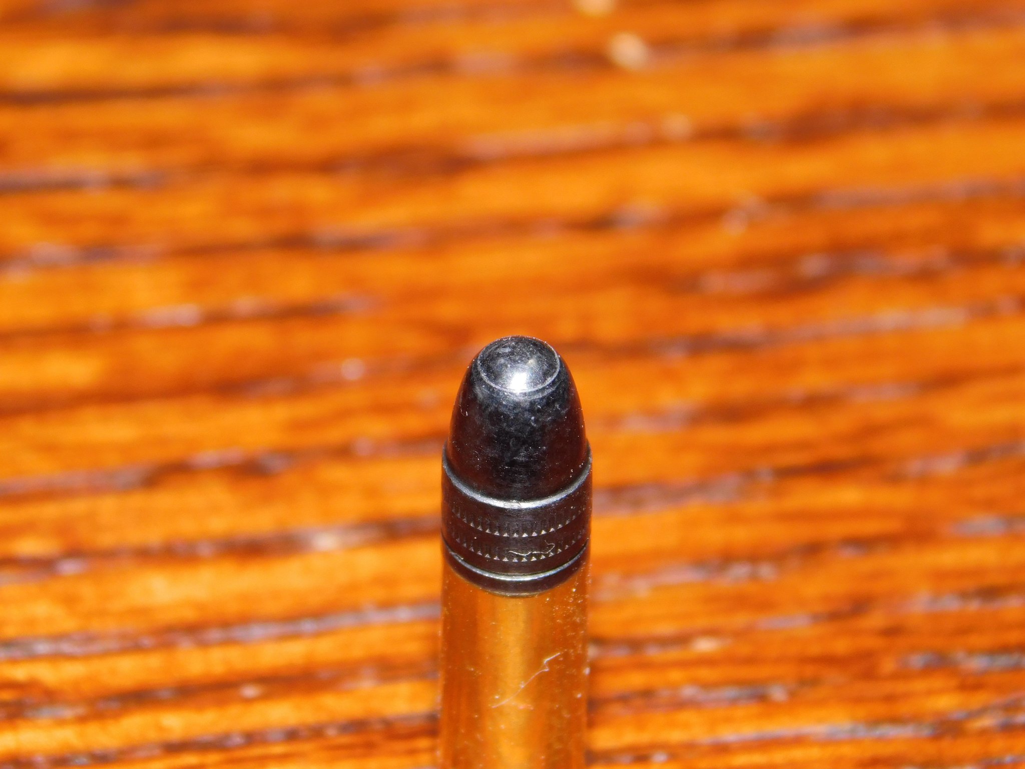

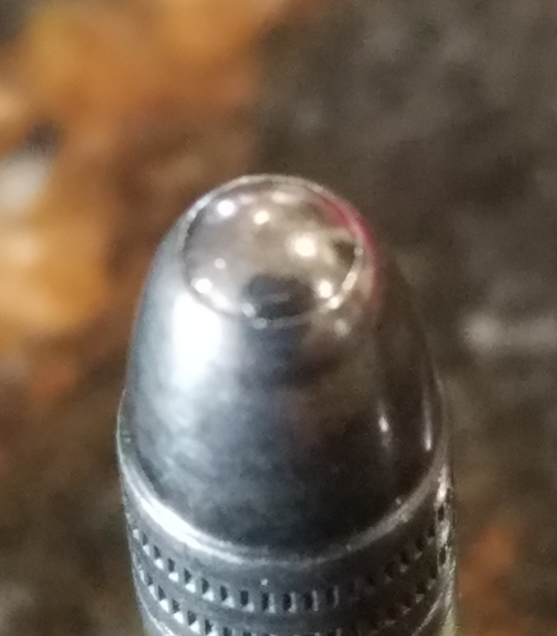

Since yall are talking about Lapua lot testing tell me what is the .0025 ring around the end of this center x cartridge? Reason ? Maybe purpose ?
Thanks

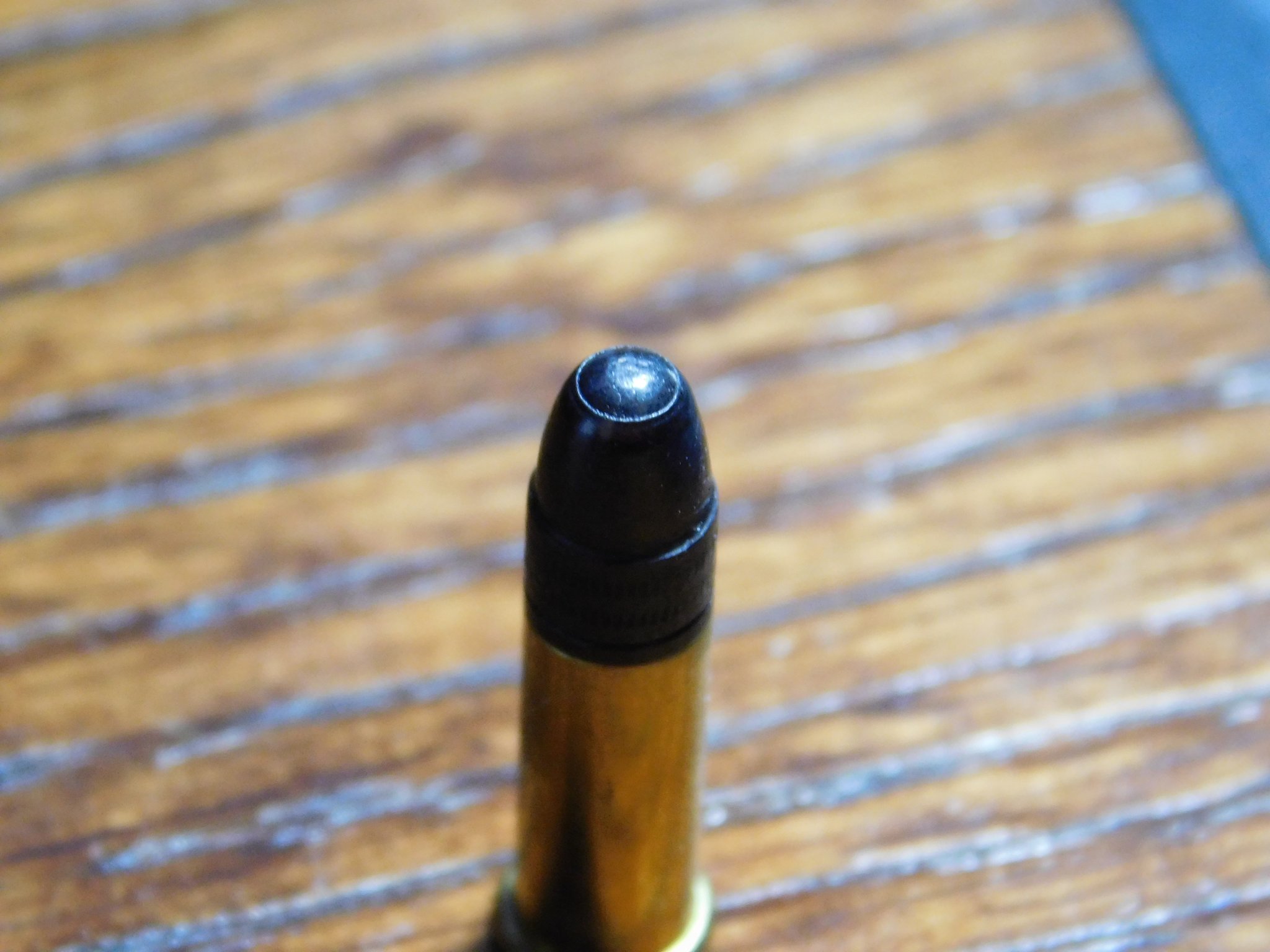

Thanks

In any event, here's some pictures of Lapua X-Act and Midas +. I also had some SK Rifle Match on hand and it looks remarkably similar, perhaps similar enough to be the same bullet as with the Lapua. Shown below in order of X-Act on left, Midas + in middle, and SK RM on right.

Clean the lube off real good and take another pic I'll tell yall what I believe it is.
Thanks
I initially thought you were pointing out a defect. Now that it looks intentional, I'd venture the guess it has a positive effect on the drag properties of the bullet. Though, I suspect, at shorter ranges. I dug out some old books and found an illustration from McCoy showing the transition from laminar flow to turbulent flow. That ring, and also the flat point on Eley, likely starts the flow to turbulent. Though I don't understand the ballistic value. This is the stuff that keeps me up at night.
As I don't find it on any of my CenterX, I'm gonna offer a much more simplistic answer.
It's a dent left by the automated seating tool caused by it exceeding set tolerances.
It's a cartridge assembly defect. Maybe, I think.

I have to ask -- naked eye or magnified?
I can't see it without a loupe or looking at photos with a magnified macro lens.
If it's a defect as you suggest, it's a most curious one. I checked four random lots of CX that I have conveniently available and it's on each random round I looked at. It's also found on each of the random bullets I checked from three different lots of M+. It's also on the one lot of SK Standard Plus I found.
I believe its intentional listen to my theroy. I have spoke to No one about this till now and have reviewed alot of information. Including direct work with engineers from Textron Marine and the Navy during the Mid 90's. One day 20 large aluminum appearing foragings showed up at our facility. 8 days later the Rear Admarial and 3 under brass with 4 Textron engineers showed up.
We had only been allow to do a roughing quote on the job, with final machining pending. Material was described as a 7075 t651 aluminum substrate. I was like a Wolf I saw the Company making a killing off this I was in management. We had 5axis pallet changes with 30k spindles that feed rates, were 900 to 1100 ipm and rapid at 2100 ipm. Then we set down with the group that showed up and things went south they discussed the recommended machineing practices the 7075 foraging substrate was atomized tungsten. We were able to machine it with cbn tooling and was awarded the final machining. This part finished close to 4 feet in diameter the technology in it was crazy it looked similar to the bullet but not quite. The part was a nose cone for a torpedo designed with stealth technology. I asked the engineer about that similar ring he said it was, I quote to create dissimilar force to stablelize the torpedo during underwater current shift or veloicty change. I looked at alot of old German military artillery shells that had this as well we use it today in our advanced weapons like the photo you posted here his acronym for it was FAT forward advanced technology. I have searched for this and never found nothing. The idea of opposing forces is keeping the nose centered during disruptions. Now heres the kicker the Cartriadge Is called Center X on the very center of the nose is a precise ring centered on the precise center on the rim is a x which creates one of the flatest rims or perpendicular I've seen hence Center X.
I could be wrong, but there's something to it.

I just sent Lapua an email with photo's asking them if those marks were from the manufacturing process or were
I have a lots of Center X from 19 and 20 and both have the ring. I'm betting there is a reason Lapua put it there.

It directs and contains the nose to CENTER

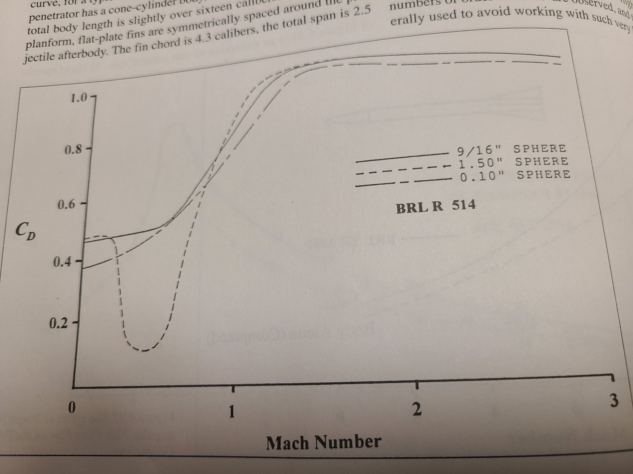

If my memory serves me, subsonic bullets are affected by forces acting on the bullet surface in the laminar flow area. Which also happens to projectiles under water. This made me think of an article I read on bullets designed for underwater so I did a quick search and here it is:
"Supercavitation effect can be produced, rather counter-intuitively perhaps, by giving the projectile a flat, disc-shaped nose with a sharp edge lip."
Maybe a more important clip from the article:
"Supercavitating bullet designs, which appear to use rounded tips that lead back to flat, sharp ridge discs at the point, as well as other ridges positioned further back on the bullet body."
Sure sounds like the wording is describing a Center X to me.
Sure sounds like they are describing a Center X to me.

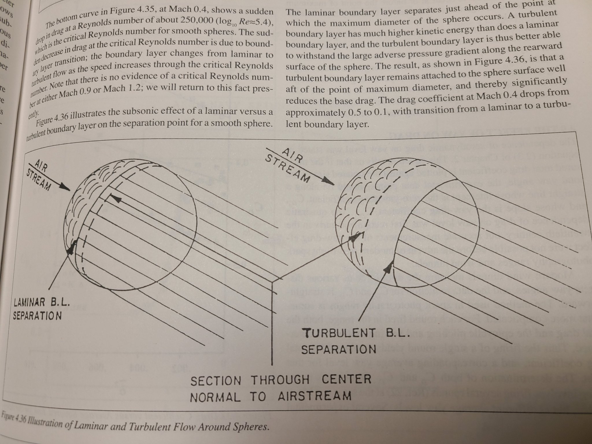

I've been doing some reading on this. This is really interesting! When a projectiles leading surfaces break from laminar flow to turbulent flow, it goes through a dramatic decrease in drag that McCoy describes as "anomalous". This does not happen with conventional bullet profiles but it does with certain size spheres at certain speeds. Here is another illustration showing the drag anomaly as it occurs on a 1.5" sphere at around mach .5 :
If this same effect is induced by the ring, it would mean less velocity loss and less wind drift than predicted. The problem I see with long range 22 is using a drag model like G1 wouldn't be accurate.
