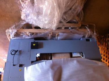

I recently took delivery of a brand new lathe and when it arrived at my home here is the damage that was done. My mind tells me that what I can see is cosmetic but what I cannot see bothers me a whole damn lot. Company I got it from says "cosmetic, no way you can damage what you can't see, its all adjustable, yada yada yada."
Company wants to "fix the broken buttons and such" I personally want a brand new damn machine. Am I out of line here holding them to the fire to make this right?

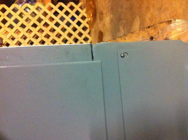

image (6).jpg Gear cover door is bent downward pretty good and one of the welds holding the hinge on is straight cracked

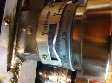

image (3).jpg Compound dial cover is bent pretty good

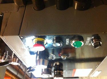

image (10).jpg Faceplate cover looks as if it was hit by an object and has a noticeable dent inwards
image (13).jpg Company says it was shipped in a 4' wide x length of the lathe crate with sides and a top....it arrived to me just how you see it, shrink wrapped.
The best part is the delivery driver said it fell off the pallet and he had to go back to the warehouse and put it back on the pallet. It is noted on the bill of lading so the freight company is aware of the damage.

Damage to the compound dial could also easily have damaged the threaded lead screw inside the compound feed. Ditto for your cross slide/carriage.
