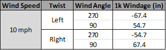

    You're right, I couldn't find the target azimuth entry on JBM either, looks like that solver doesn't include Coriolis. However, using JBM and your data (although I went with the manufacturer's BC for the 112gr Matchburner of 0.624 G1), here's what I got:
    So you're only closer to the target if the wind is in the favorable direction. Try switching the wind direction in your original test to 180 degrees opposite and see if the left twist gets you closer to the target then; I expect it'll be farther away, by the same difference you saw the first time.
    Ahhh I get it now! Thanks for walking me through this.
