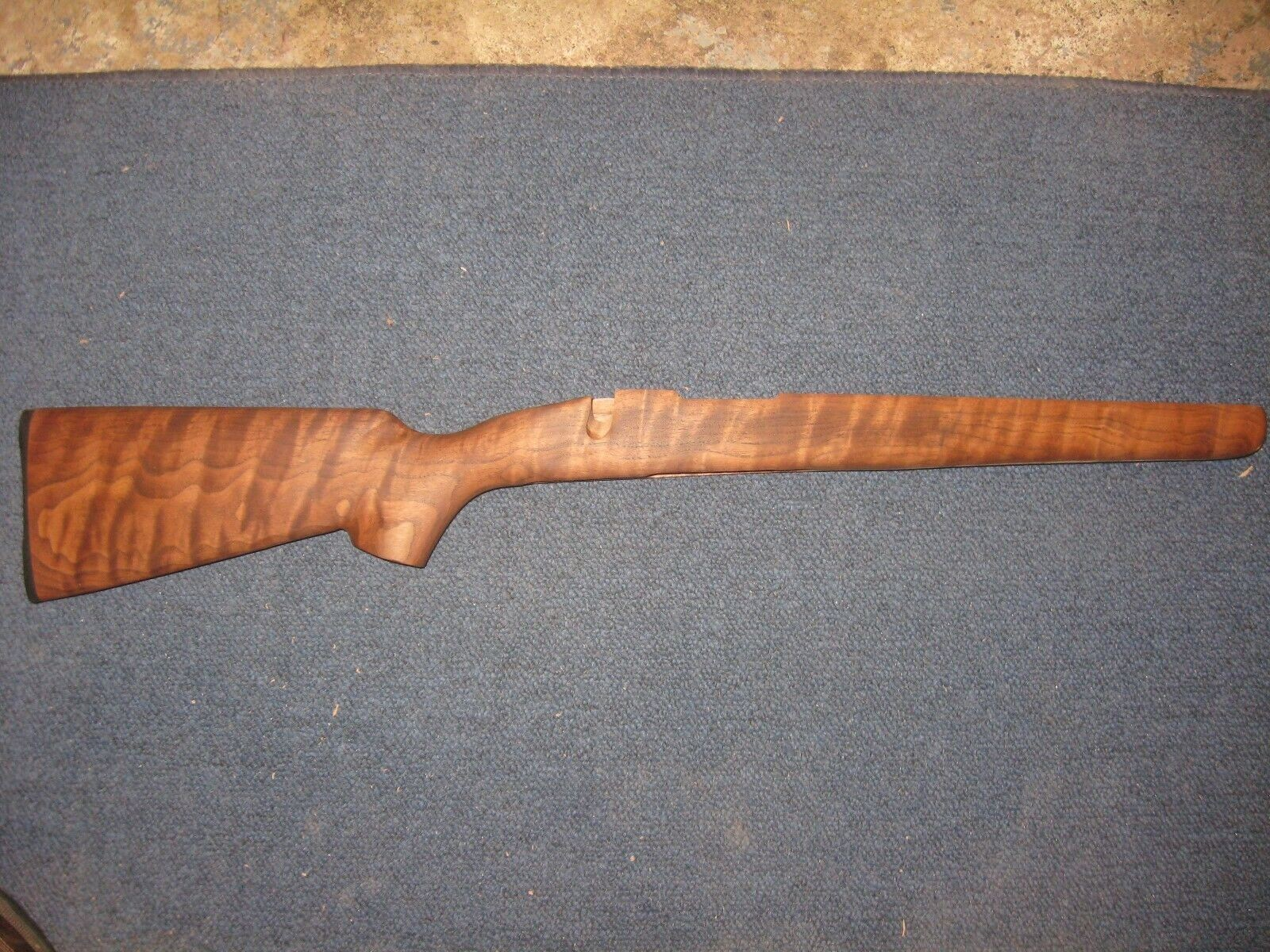

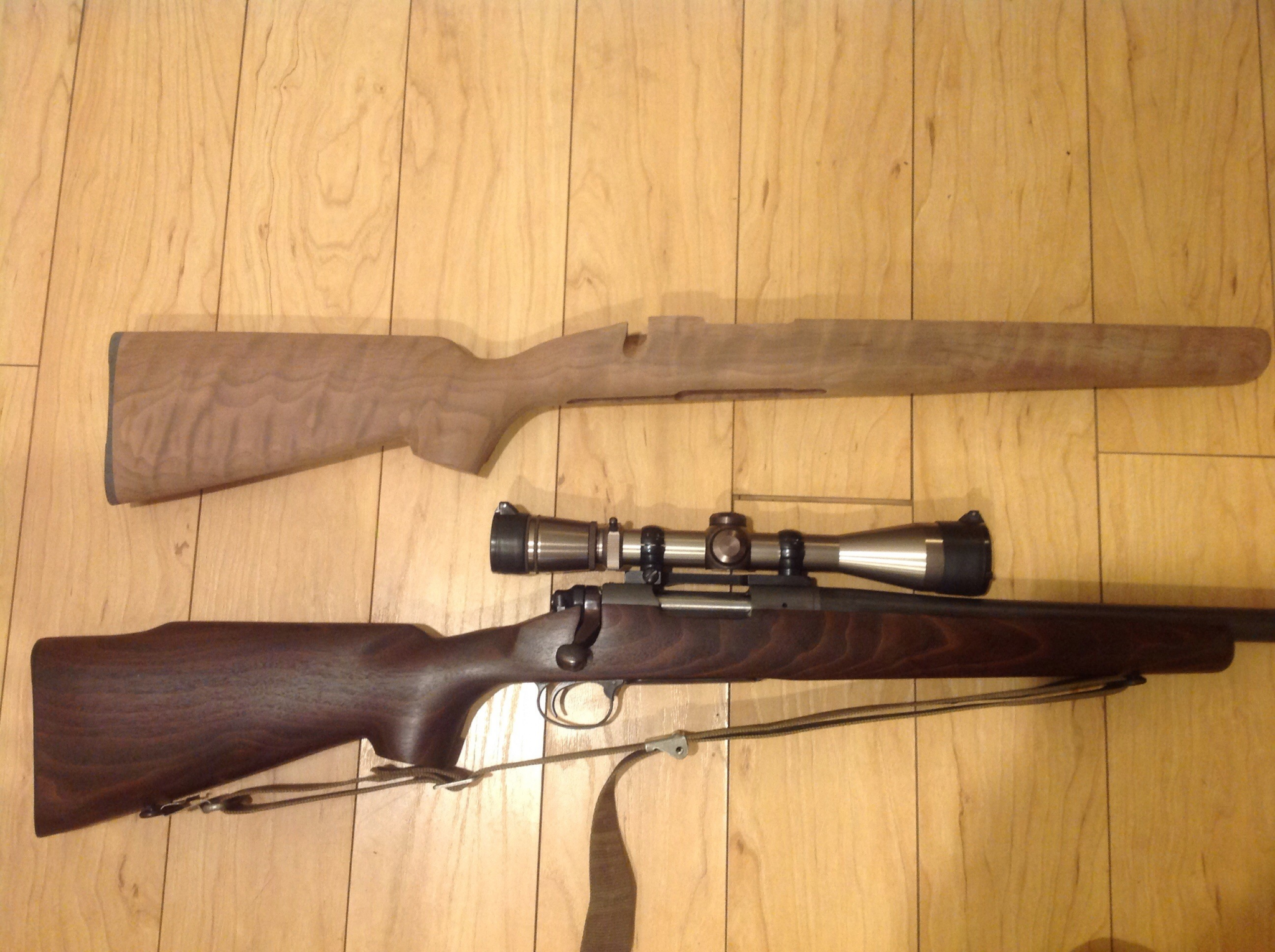

    My build is going to be a wood stocked R700 in .308.
    Kind of an M40esque heavy barrel with a detachable box and tiger striped walnut.
    Screwing up and impulse buying wood is leading me into an expensive project.
    I dont have a lot of room like a McMillan stocked rifle might offer so Im thinking an option using the standard R700 BDL inlet may be the way to go.

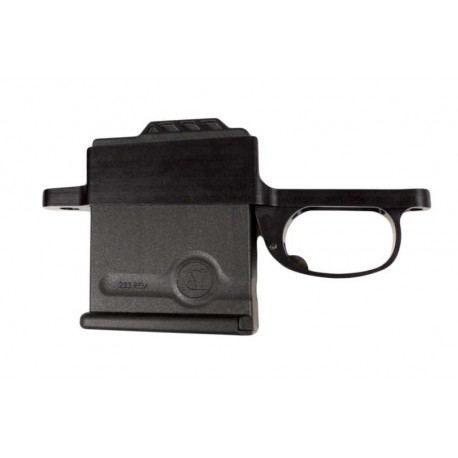

    Ive come to the opinion this PTG product might be my way to go.....
    Im assuming this uses single column magazines.
    I like the idea of staggered but that probably goes against my desire to remain inside the existing BDL inlet.

    That particular one you linked won't fit into the factory BDL inlet. Most bottom metals that say M5 will use the Badger M5 inlet which is larger than the factory BDL inlet.
    Maybe something like the Wyatt's bottom metal if you want to retain the factory BDL inlet. I've never seen or used one, so I can't recommend it one way or the other.
    I see Wyatts has an inside the guard release and looks good. Kind of has a DD Ross look to the trigger guard.
    There is room to widen the inlet so "drop in" is not critical. Quality install because of using a part with good QC and good function once built matter most.

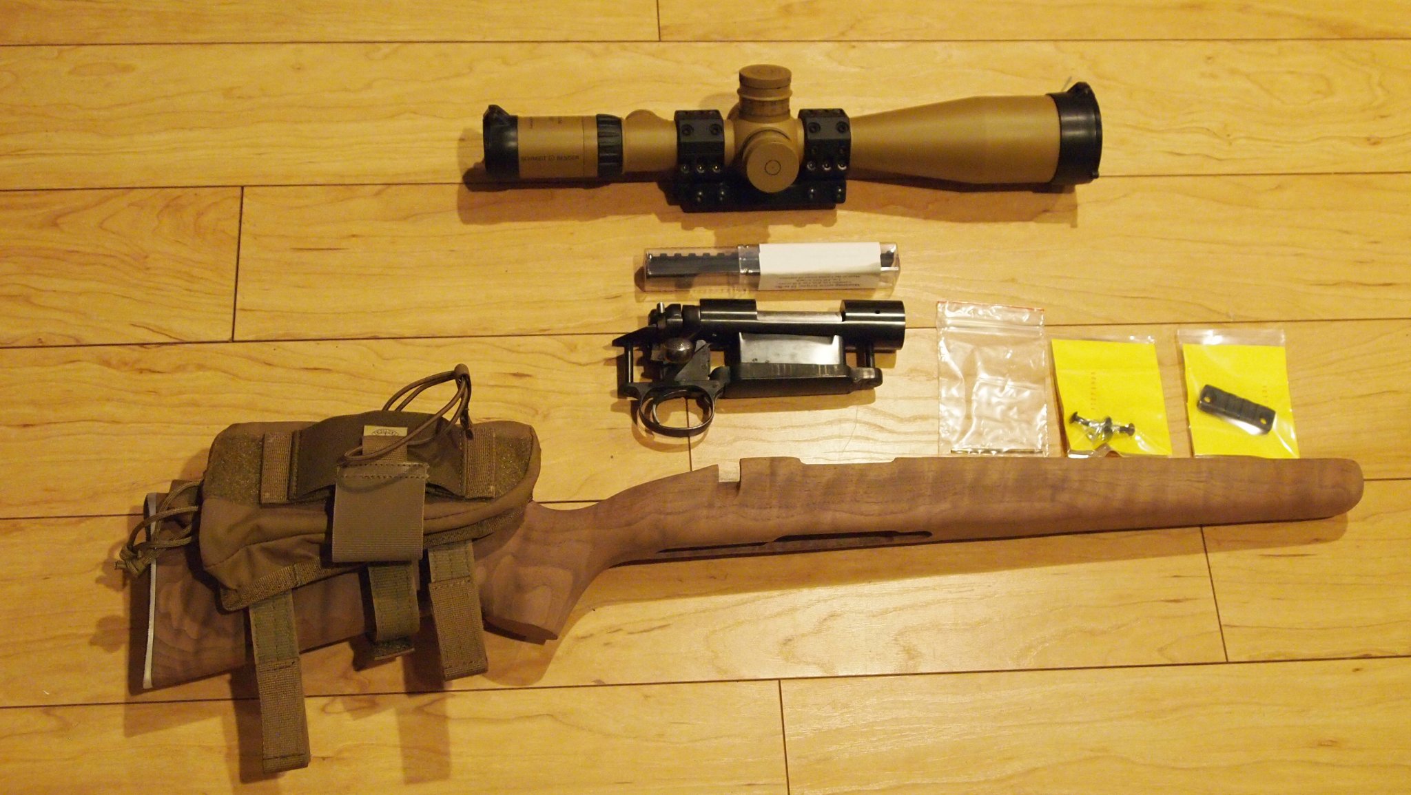

    Wichita swivels Accu Shot 2 inch bipod rail
    5 digit R700 cut for DD Ross lugged scope rail
    DD Ross heavy M40A3 700 lug
    Kreiger 5R, cro/moly, 1/8 finished at 18 inches, likely to have an MTU (perhaps lighter, maybe heavier) once I figure how much wood I need to leave in the forearm.
    Park the B/R, Hot blue the bolt
    Glass will be an S&B 5-25/Spuhr because it is sitting unused in my safe.
    and it will need a high rise Triad Stock pack which will cover most of that beautiful linseed oiled tiger walnut.

    I don't believe PTG includes the pillars with their BMs, or even provide the pillar dimensions their product's designed to work with. You might have to either make some yourself or figure out if they're offered elsewhere. Without proper pillar heights you're asking for feeding issues. I've made my own and function tested everything before epoxying everything into the stock.
    Also, my experience with the PTG BMs the anodize is "Type II" not "type III" that's thicker. Type III is less likely to dye the vibrant colors you typically see aluminum take. So while it's coated, it's just 6061 aluminum (relatively soft alloy compared to others in common use e.g. 7075) the coating's pretty thin and won't withstand a lot of abuse.
    Not ripping on PTG just laying out my experience. They work, you just have to put in a little more effort for the discounted price.

    Whichever one you choose, the M5 inlet is VERY minimally larger than the standard BDL. M5 is the default standard pattern. You can also be reasonably sure that any standard AICS pattern mags will work with it.

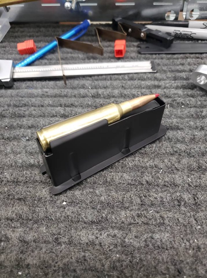

    Im feeling AI pattern mags are where I want to go.
    Anyone know of a flush M5 inlet, perhaps made of steel.
    Both Badger Ordnance and Pacific Tool & Gauge make flush fit. I am unaware of any steel version.

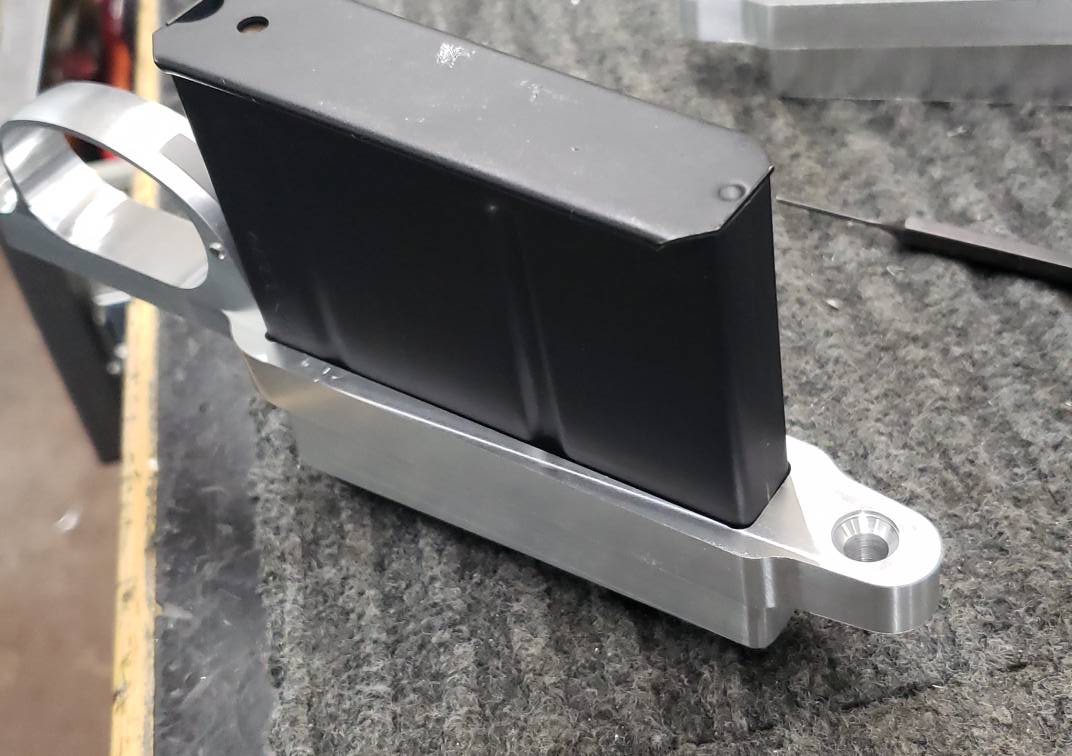

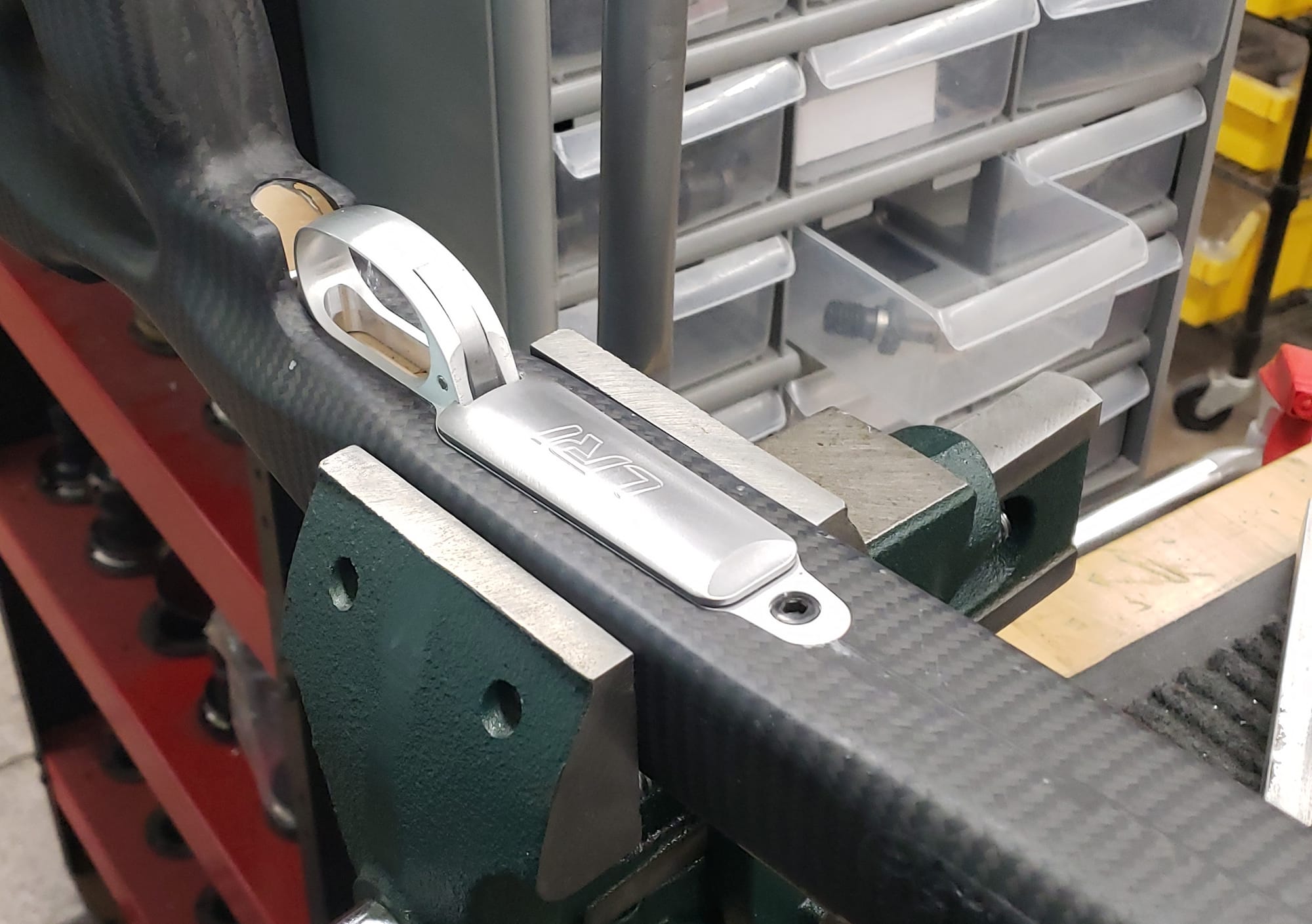

    call @LongRifles Inc.
    they can run you through them.

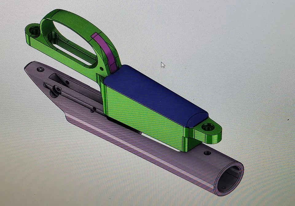

    they make one now IIRC that looks like a BDL and have a mag to make it flush if you want too.
    In case you missed it, they do some wild-ass guessing, second rate inletting of stocks for actions and /or DBM......
    they can even make a wood stock (see old SHC rifle with a T4 style stock out of walnut like yours).
    Having an idea of your preferences (I see the quality and classic stuff you like) I think their new DBM could be it for you.
    Plus they have great CS and comms, fast turn around, and affordable prices.

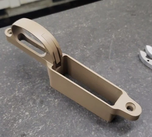

    Didn't realize Chad was making DBM but as noted above I'd like to see about having them do the build.
    The stock that caused this frenzy is really nothing special.
    Someone asked about where to get an M40 stock and I said check EBay.
    Well I checked Ebay and ended up buying that stock for $140.
    $140 will end up being the cheapest part of this whole mess.

    Yep the LRI DBM looks great. Inside the guard mag release and guy that builds the metal should be able to do the inlet in the wood......That would be a no brainer choice if they will do the entire build.

    just looked at their site. Could do the 1:1 CNC inlet without the bedding to save a little $. A little few hundred $..... Of course its an LRI build, so their bedding kinda needs to be part of it.

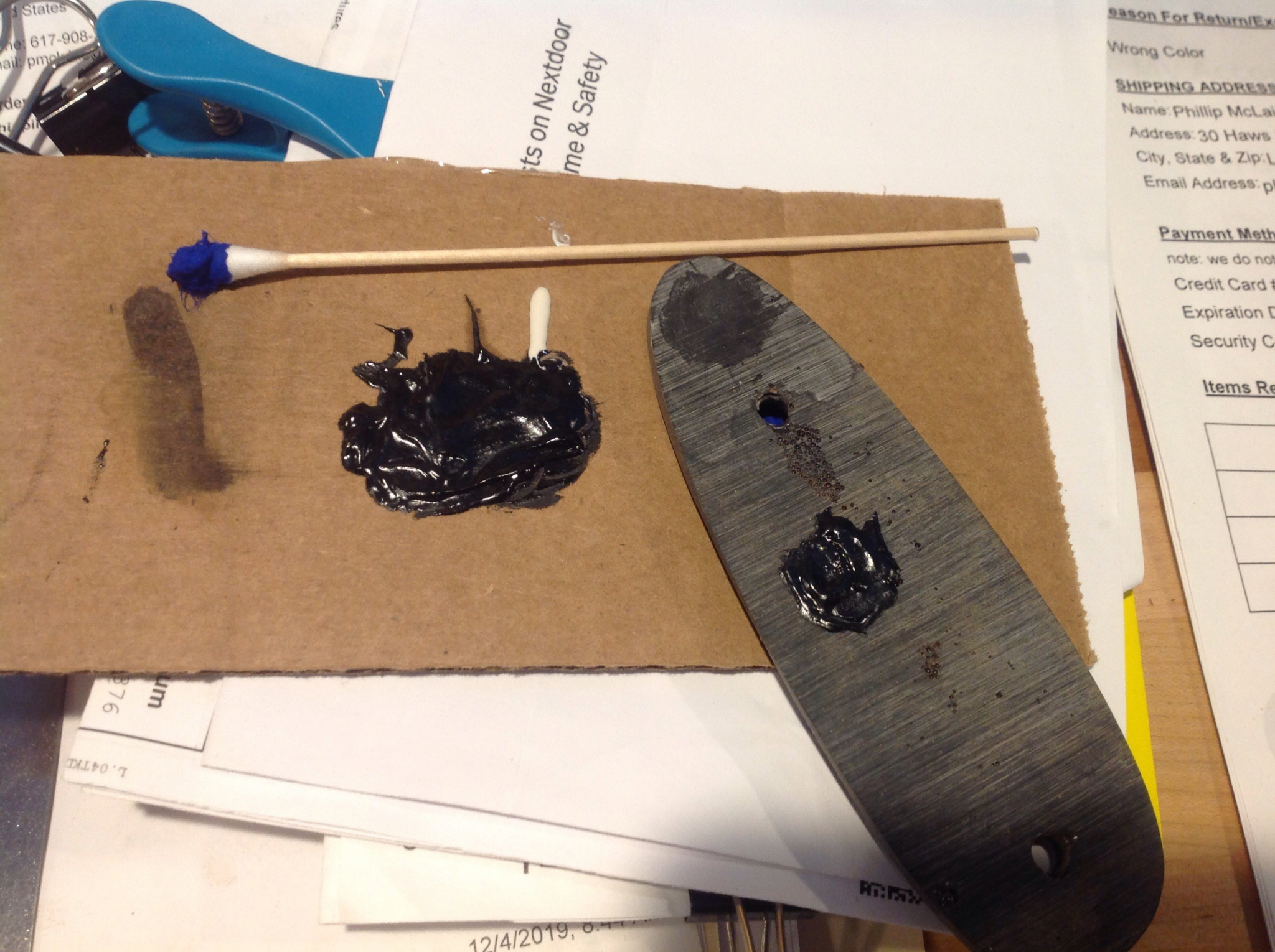

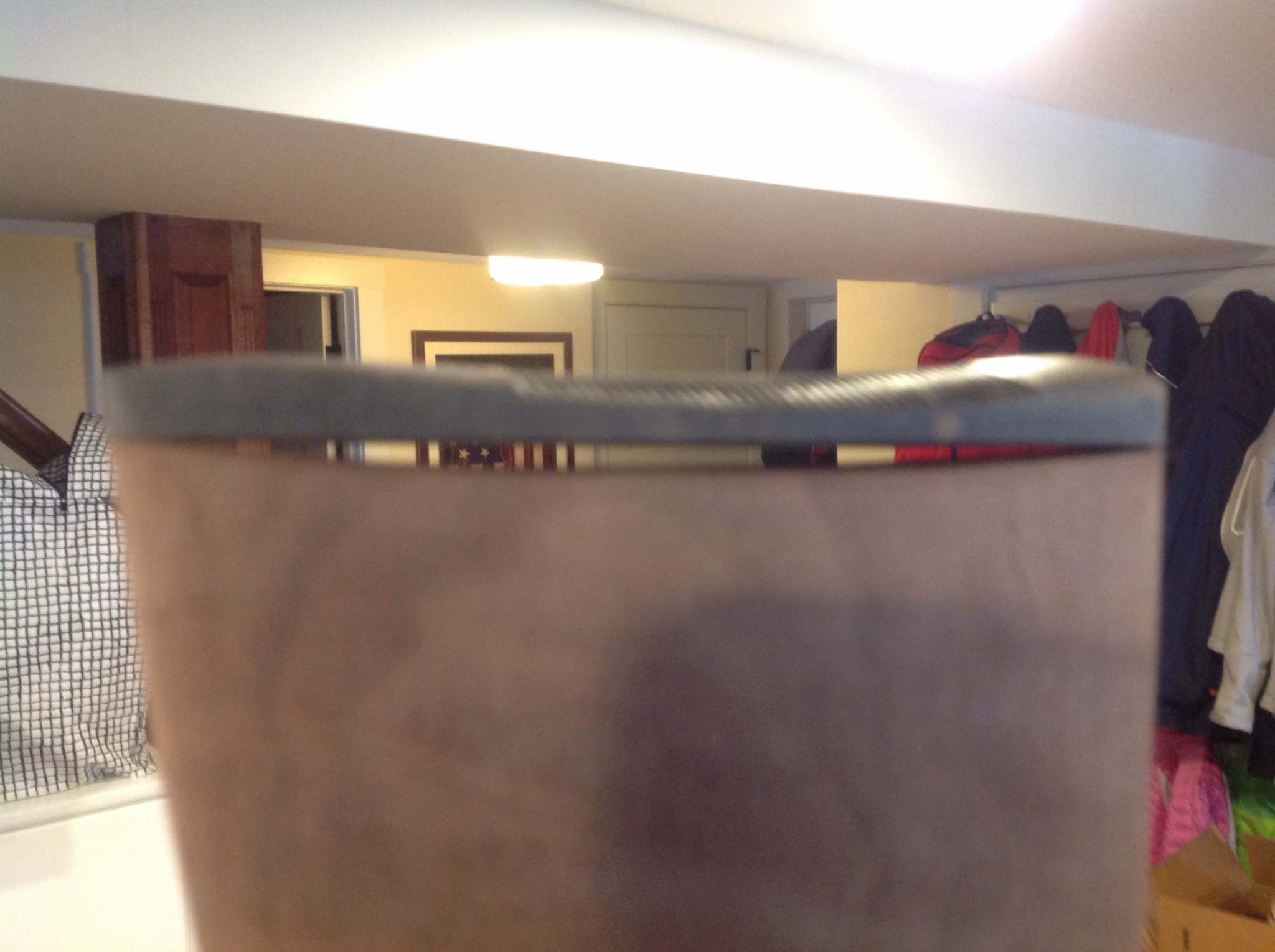

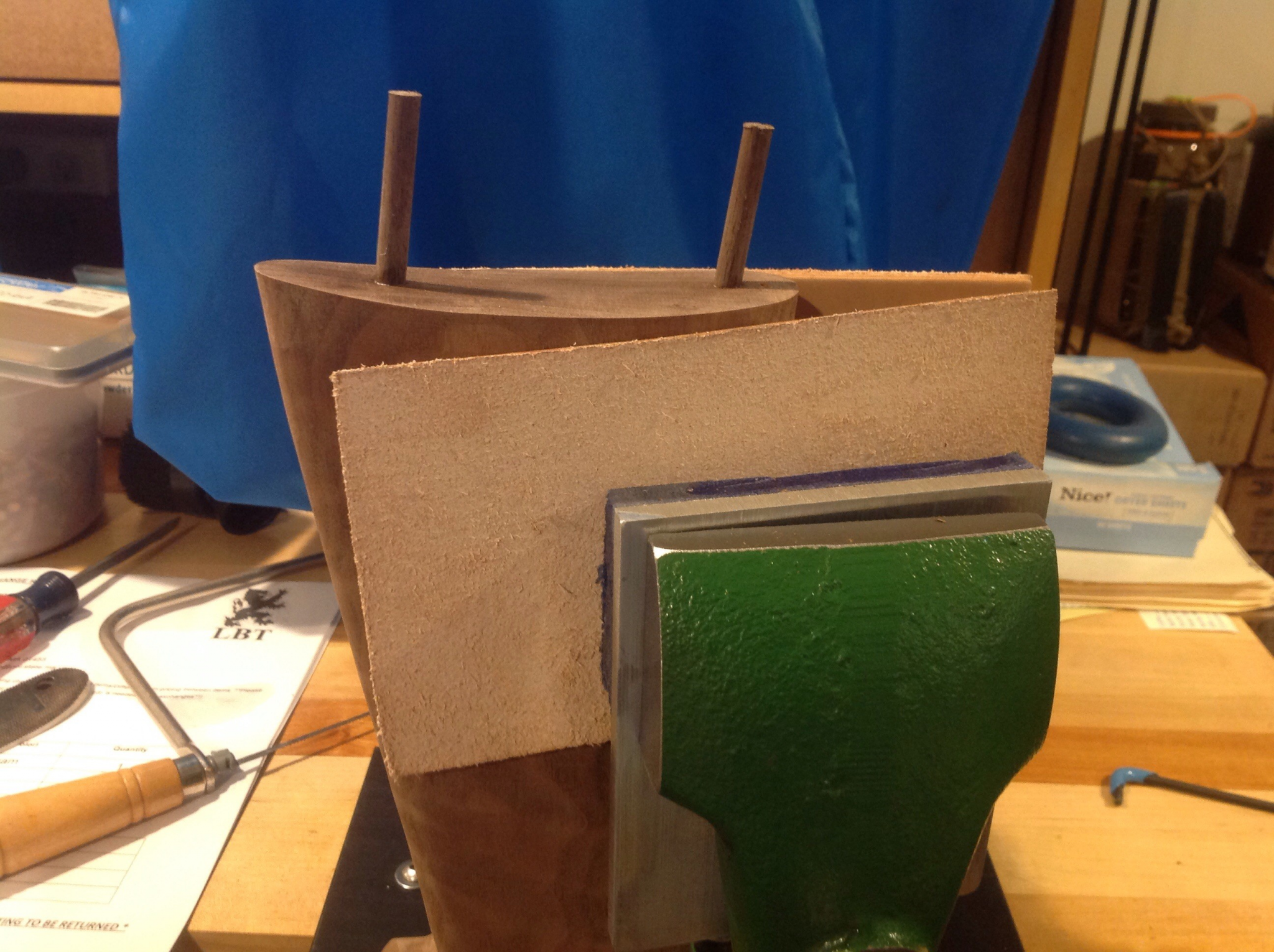

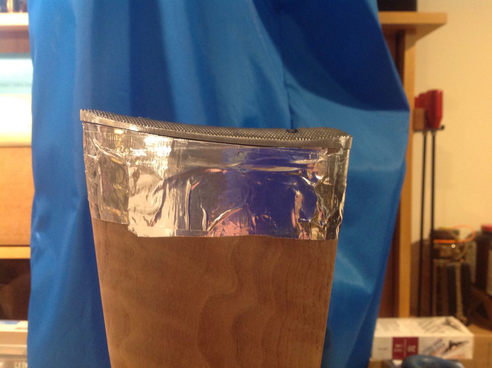

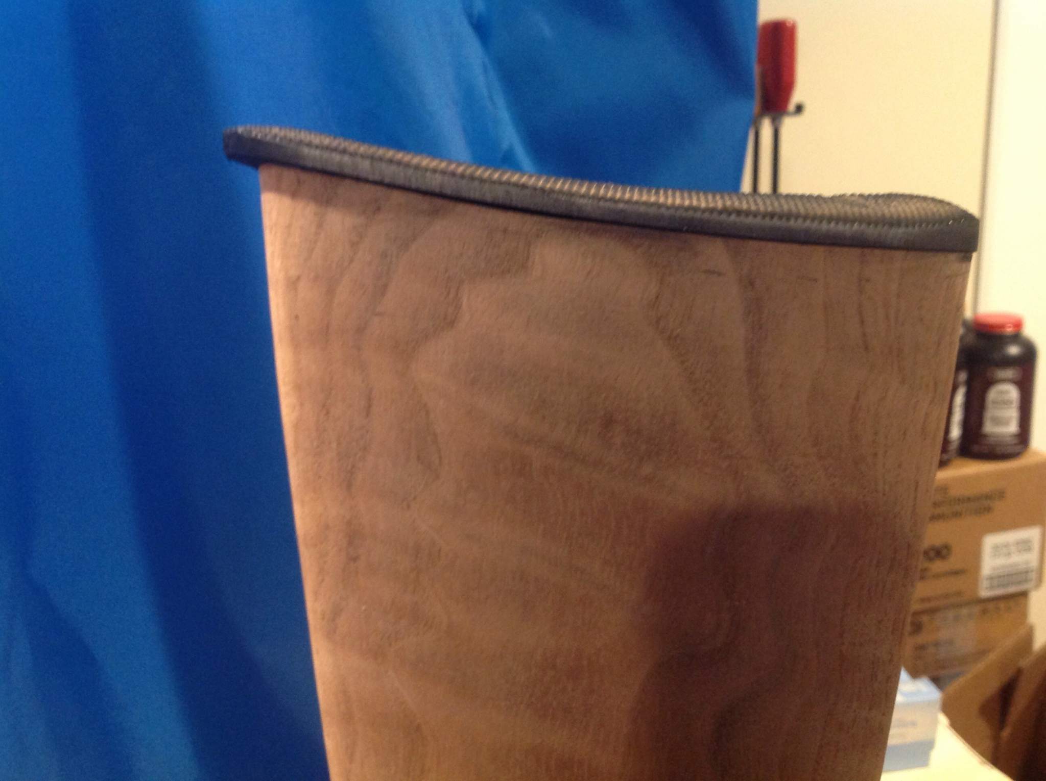

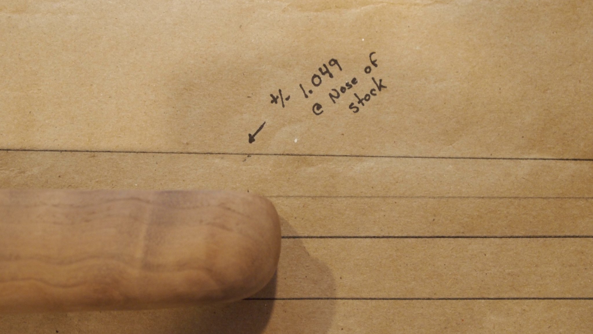

    Been working on my stock for a week or so now. It came with a generic flat plastic Butt Plate. I want a Remington 16601 that was on the M40 series of rifles.....
    So it started like this...
    I bought a 16601 and by gluing sandpaper to the back of it and short stroking back and forth I built a curve into the stock. Note to self: next time use a coping saw and make a gross rough cut.....I really spent a lot of time stroking it.
    Had to fill in the old screw bores with some walnut....
    Bought some scrapers and using candle black Im removing material one atom at a time to get the plate to fit. Its getting close. Nice thing is Ill have a lot of aluminum to remove so the end result should be pretty smooth....

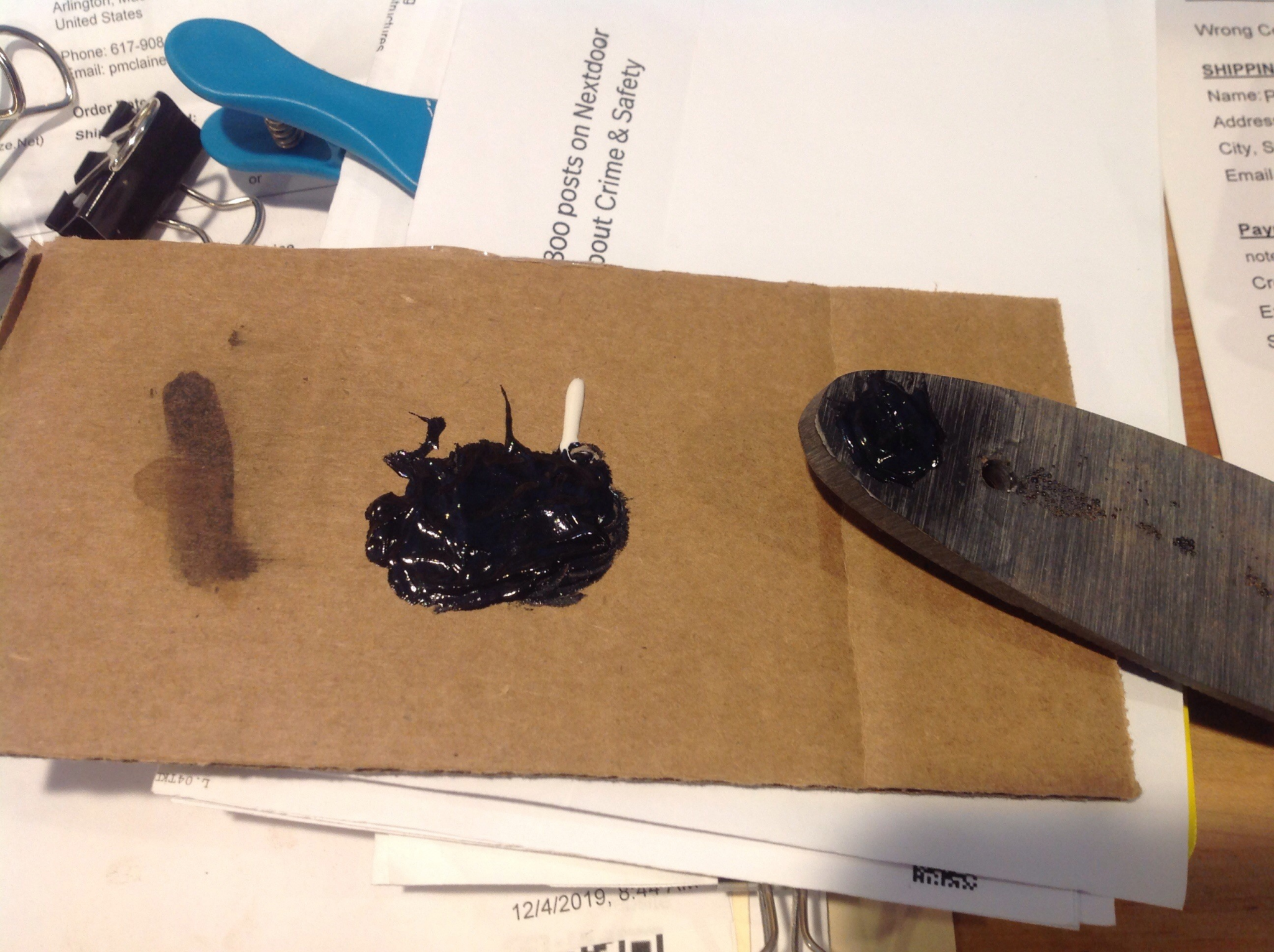

    I plan on bedding with JB Weld to hide any of my errors. Did a test batch yesterday.........
    The "product" still feels kind of rubbery today. Maybe the black dye is affecting cure. Perhaps those of you familiar with JB Weld have suggestions such as use slightly more than half on the hardener. I used the toe of the old butt plate to test if neutral kiwi shoe wax would be a good release agent and it looks like it will be.......
    The semi gloss JB will be a good color match to the BP. I plan on spray painting it and the screws Rustoleum semi gloss black. I did similar to my .308 M40 and it has held up surprisingly well for 3-4 years now. A little wear on the high points but pretty well intact. Paint is what the Marines did in VN when the received their raw aluminum edged butt plate guns back in the 60s.
    Got a BT/Accu Shot 2 inch bipod rail coming this week. Ill install the rail and Wichita swivels. Went with a seperate Wichita up front rather than a rail with QD because it drives me nits that most QD swivels marked as 1.25 are really more like 1.2 and it messes with real 1.25 slings on pass through.
    I really want to start linseed oiling this. Unsure if that will be a problem to the builder. Understand that during build something may get scratched or bruised but thats the beauty of linseed oil.....wipe more on and it goes away. I figure if I start oiling it now this thing could have 4-5 months of daily love before it even goes to the builder.
    Reactions: AMGtuned
    Your butt is looking good pmclaine! Can't wait to see that wood with a few coats of oil on it!!
    Great project by the way... your probably going to "make" me spend a bunch of money again : /

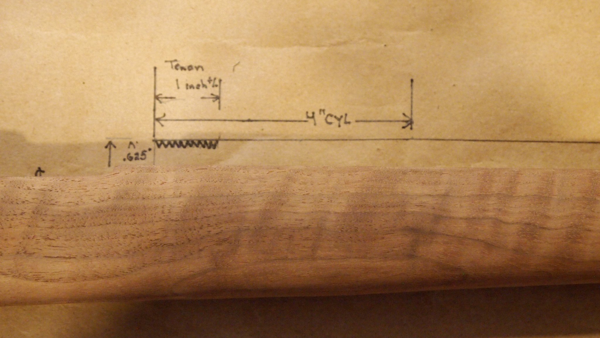

    Going to mock up a barrel profile on butcher paper to get an idea of how big a barrel I can install without taking away too much wood. The wood is actually pretty stout. Its trim in the wrist where I want it so but pretty beefy through the belly and fore end.

    8. I fit Remington 16601 butt plate to about 95%. I don’t have the correct tools to get the slightly proud edge of the aluminum to match the wood without risking banging up the stock. Please check fit of butt plate and if you see room to improve…..do it.

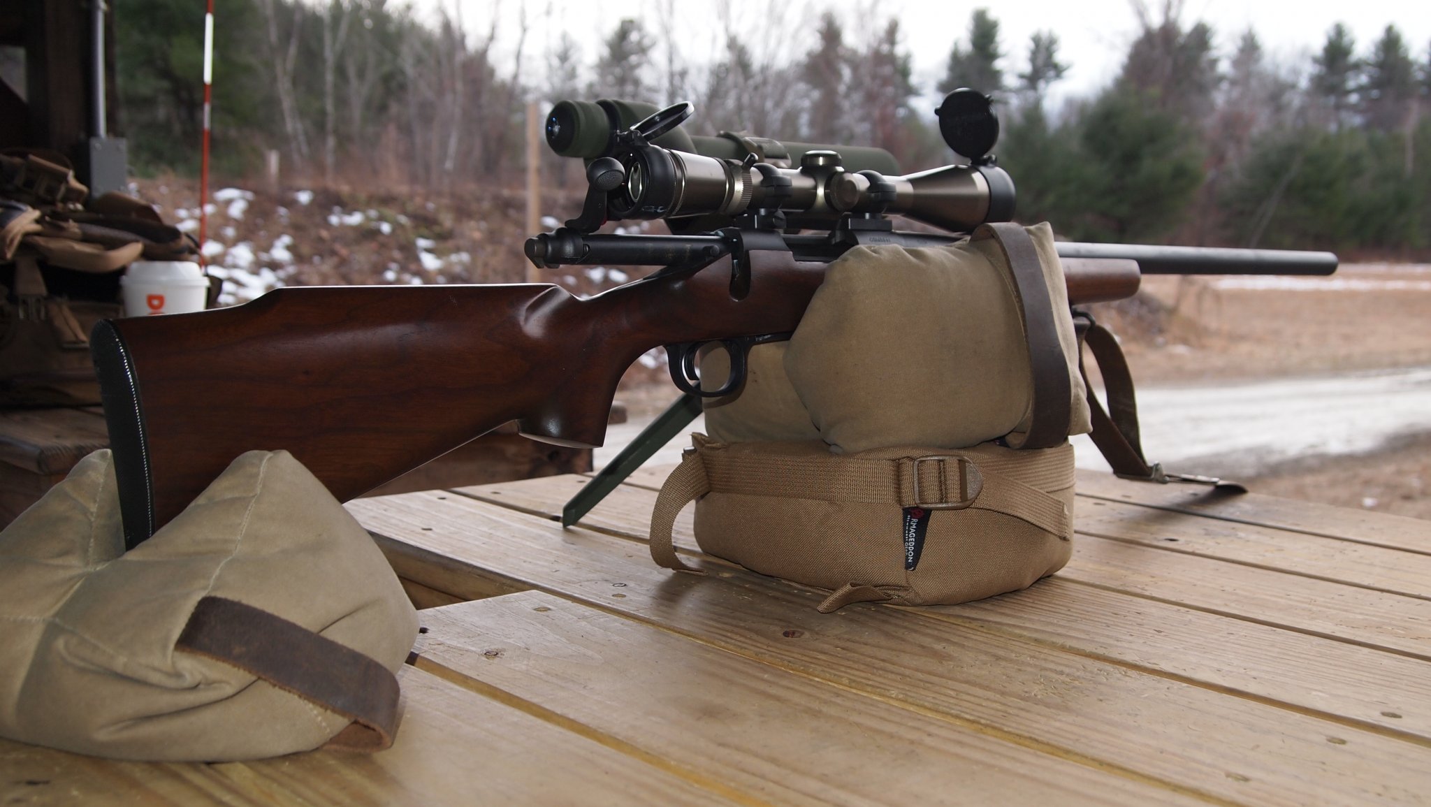

    The new rifle will be an updated version of what is now my favorite rifles to shoot....
    Remington M40.....
    Except with the capped Leupold I have to hold mil dots for range. It works great on bigger targets like steel.
    For trying to make groups on paper though I sometimes cheat and draw an aiming point. In this case a 1.4 mil holdover red circle for shooting at 300 yards...

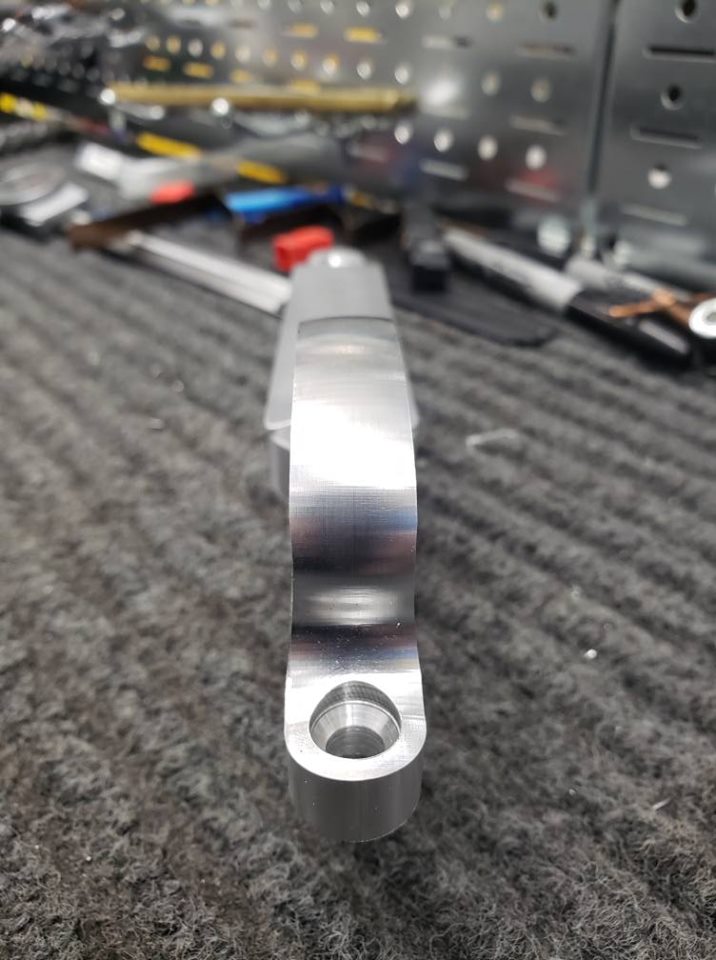

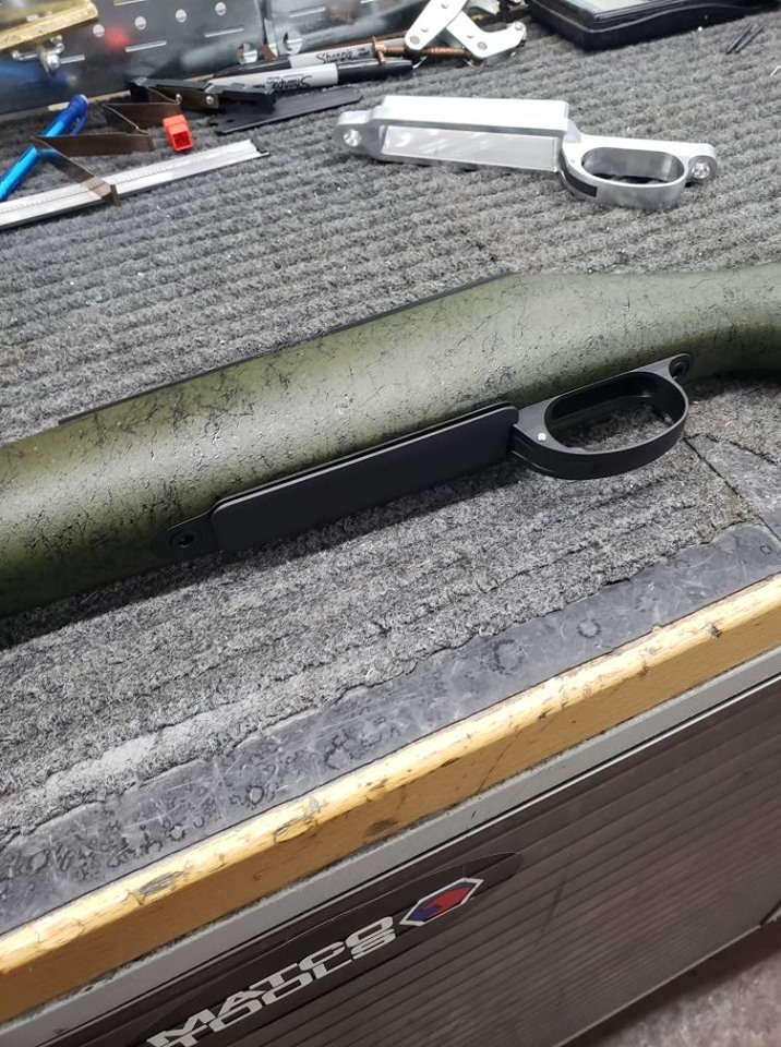

    The DBM setup LRI is making was born out of necessity. There are issues I've encountered for a number of years that annoyed the hell out of me.
    1. A DBM with a bit of elegance to hopefully appeal to the sporting community.
    2. AI magazine compliance* (rant to follow) :)
    3. Obendorf style latch for hunting applications (goes in/out of a scabbard, vehicle, case easily)
    4. Lightweight
    5. Crowned trigger guard with hips. -an attempt at a respectful nod to how guns used to be made.
    6. Full support to gunsmiths and end-users. (more on that in a minute)
    *AI set a standard with magazines that began almost two decades ago. When you look at any attempt at a "sporter" DBM what do you find? You find a corner that you become boxed into the moment you get your wallet out. Now, you are locked into the magazine configuration they offer. The stuff you've already spent thousands of dollars on has no use. It's a big reset button and you have to start all over again. Then add insult to injury when you later learn that the magazines are almost always poorly made. Rubber O rings and other things to bandaid problems that shouldn't exist to begin with.
    I am of the opinion that this approach is both dumb and stupid from a manufacturer's standpoint.
    It doesn't take a 30 round magazine to go shoot a deer or an elk. -Least it shouldn't. Hunting guns demand some compromise to suit the task as a whole. ( A light gun that's easy to shoot and built to deliver good accuracy from a cold bore shot.) That's really all it has to do. Now, that said, it is nice to not have to destroy your thumbs loading (3 round) magazines at the range when you just want to go shooting or while working up a load. That is where this trinket I'm making starts to get a little traction. Grab some (AI, ARC, Alpha, Accurate) 10 rounders and go to the range.
    Our floor metal works with all of them.
    So, OP, at this point it might be a good time to review your setup and make sure I'm the right guy for your project and your application.
    The next facet of this project that I wanted to work on was the "after purchase" side of things. A big company has been the dominant force in this particular product for a long, long time. YET, the best you get from them when it comes to fitting the thing is either a photocopy void of any meaningful dimensions or a telephone call where the person on the phone says, "send it to us and we'll do it for "x" amount of dollars.
    LRI supports the product for both gunsmiths and end-users. Anyone can go to the product listing and download prints, setup sheets, tool packages, AND the ACTUAL CODE that we use to fit the parts to the stock. You may have to change a bit of the syntax to suit your machine, but the meat and potatoes of the process are lined out in detail.
    I've been on a crusade for the last 15+ years to change this side of the industry. When I can go to McMaster Carr's website and download a Solid Works Part file of a bolt, screw, pump, assembly, whatever, then we should be able to do it here as well.
    the days of being treated as though I'm asking for access to National Security matters needs to die a quick and painful death. It is just a floormetal. . .
    Im sold before you even posted.
    Been wanting to have you build me something for awhile.
    Your DBM is exactly what I was looking for - Oberndorf without the QC problems associated with PTG.
    My usage will be PSR classes and me plinking at paper targets. Id probably be better off with a M5 type paddle mag release but thats not what I want.

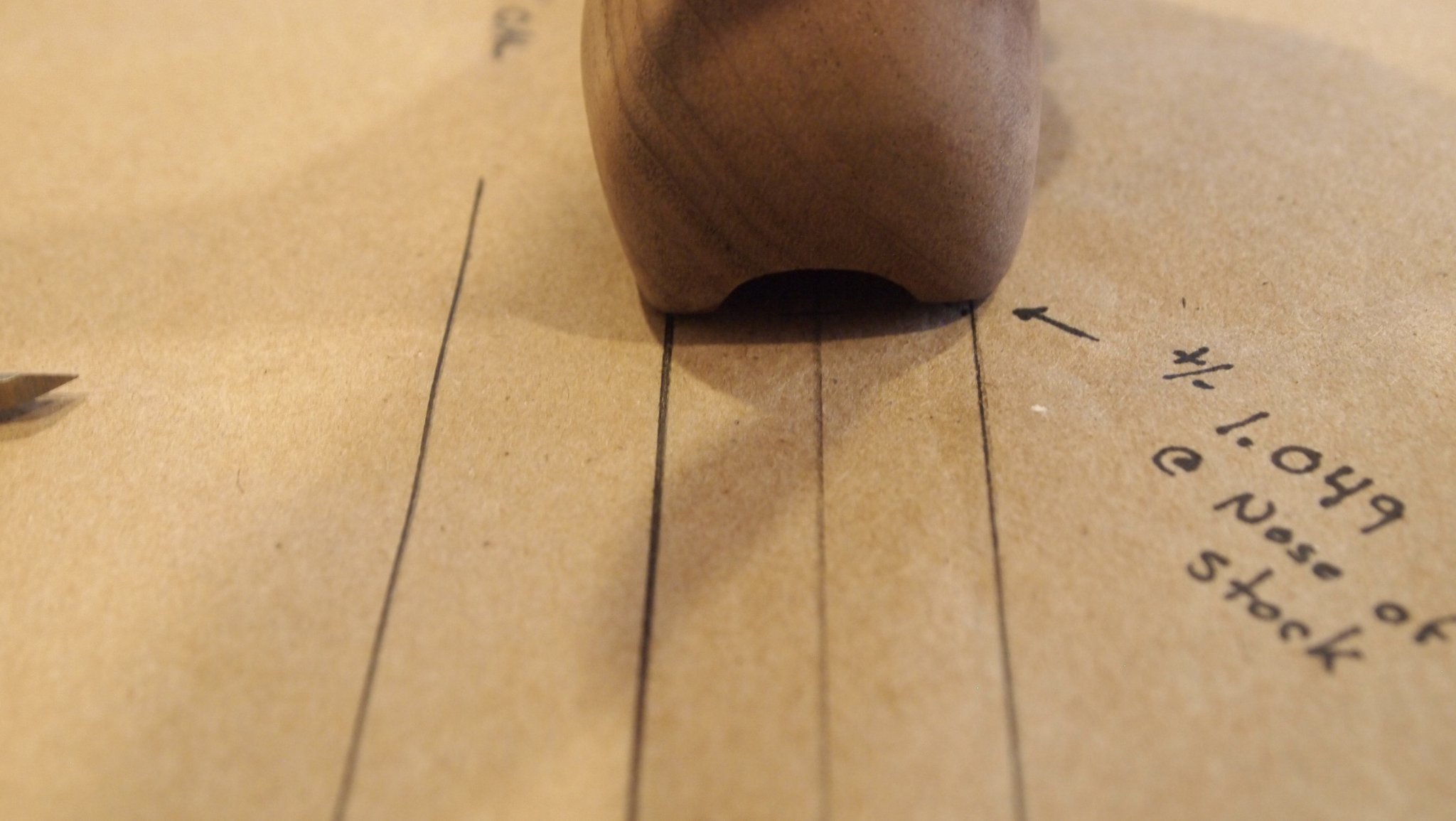

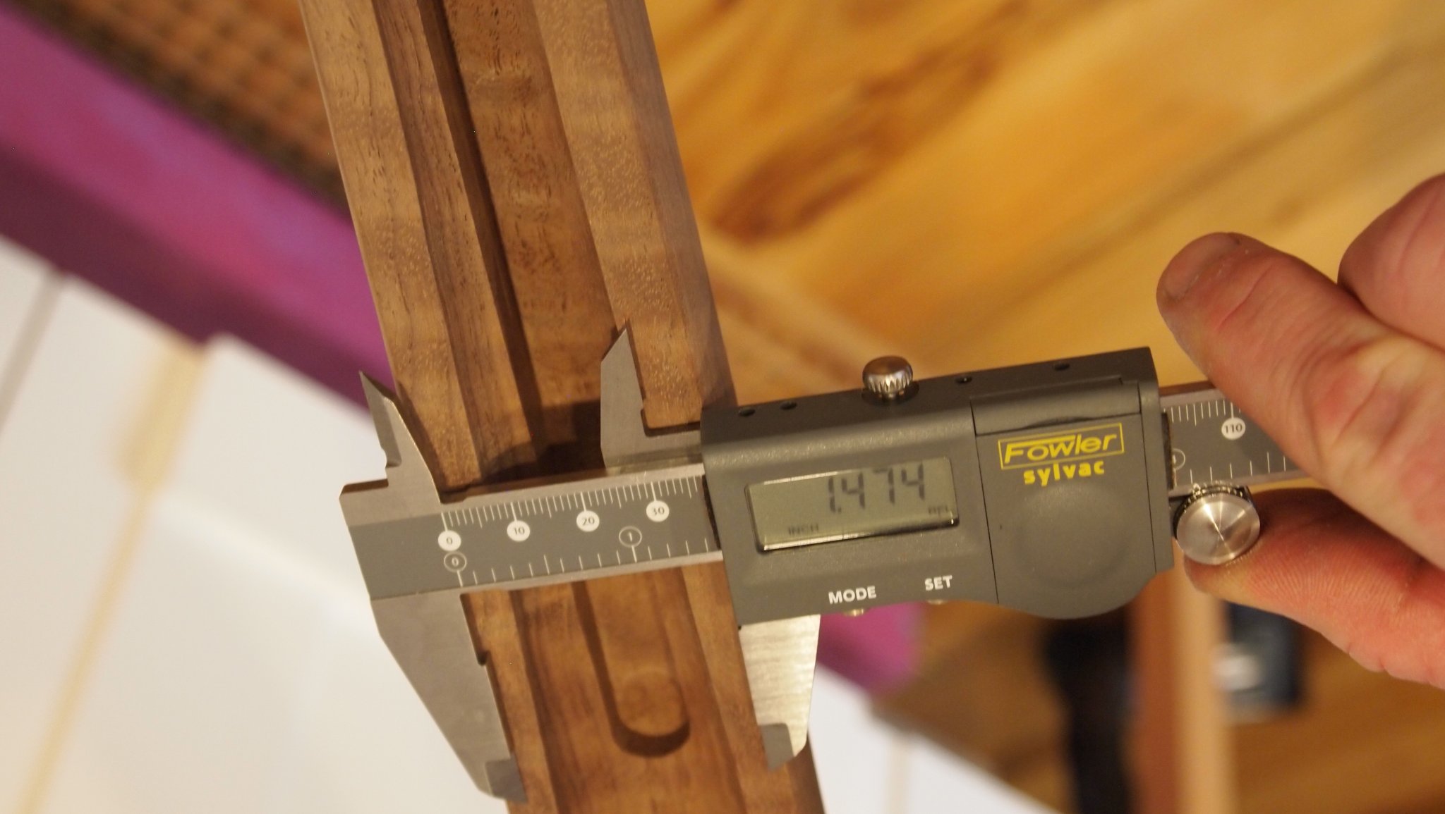

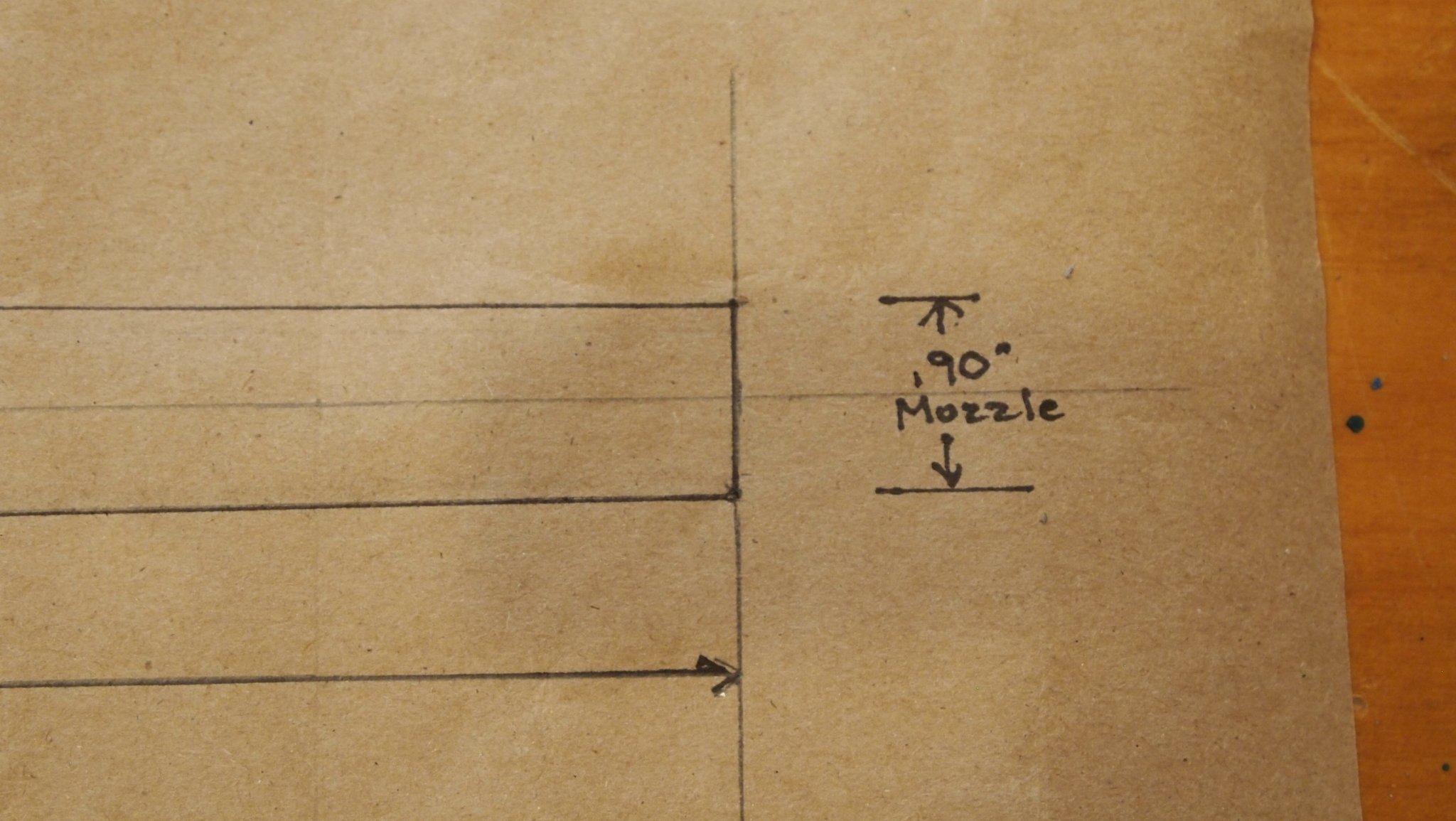

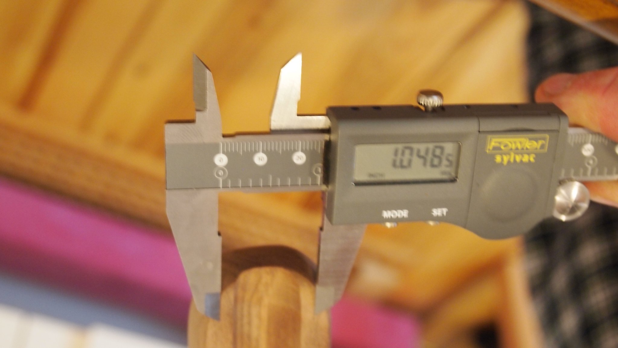

    Did a mock up of my barrel profile....My daughter took the pictures with the calipers. She didnt really capture that I was trying to show that there is about 1/8th inch or more of wood beyond the edge of the barrel profile. The stock is fatter than my Remington M40 stocks so it should accept a heavy profile. The added structure of epoxy bedding should only help...
    Guess I cut it off in the picture but the overall length of finished barrel will be 21 inches.
    The diameter at the cylinder is 1.25 inches.
    This will make up for my personal inadequacies.
    Shooting yesterday with my M40 I noted that after 2 or 3 rapid shots so much heat was coming off the barrel that the Leupold greenie was a pain to see through the mirage. More than a few shots were taken with a "wavery" aim point.
    The bigger barrel better scope may negate that negative aspect.

    Picked up my receiver today. Parts are coming together.......
    Wichita swivels are off getting an offending design feature turned down so that the swivel lug will fit flush to the wood.
    The little plastic bag is a brass reinforcing stock pin. The USMC ran one of these pins in from left to right on the thin section of wood between the trigger and magazine. The head of it was only visible on the left side. I want one on my rifle but Ill leave it up to the builder to see if that works not knowing how the LRI DBM will fit.
    Only things not on hand are the Barrel - in production, the LRI DBM and the LRI heavy lug.
