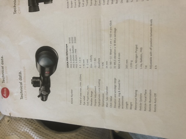

Do the turrets lock? What kind of rev indicator do they have?
I reached out to the folks at Leica and they said:
"It is not a locking turret yet a zero stop. With our zero stop it will also allow the user to set below zero for a “hold under” option. There is also a pop up column in the center of the elevation turret that will indicate with lines and nomenclature as to what revolution you are on (1-3).
The rev indicator is a visible and tactile post that pops up one level from the center of the elevation turret each time the shooter completes a turn of the turret. "
They also sent me this link which is a great read.
