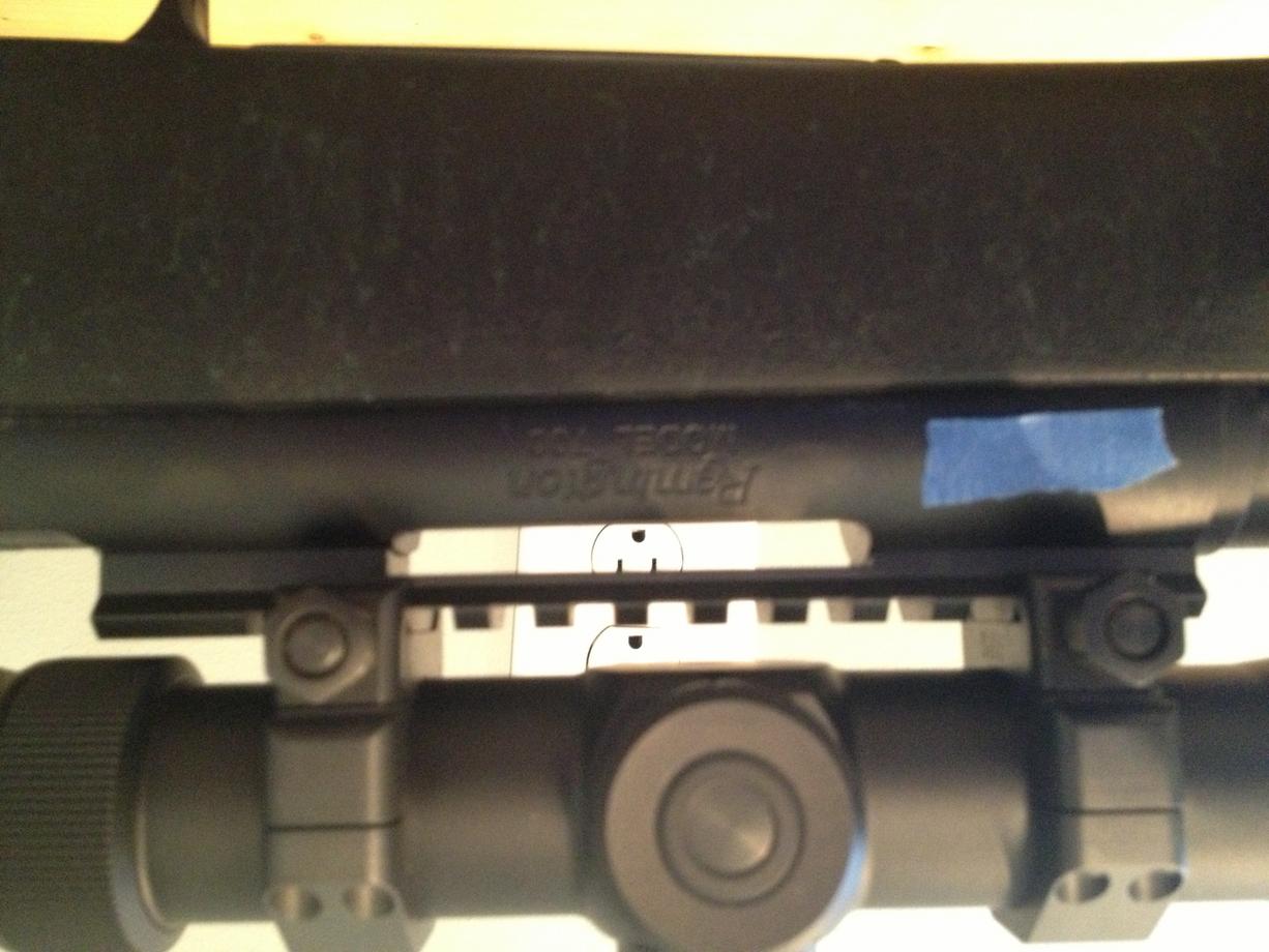

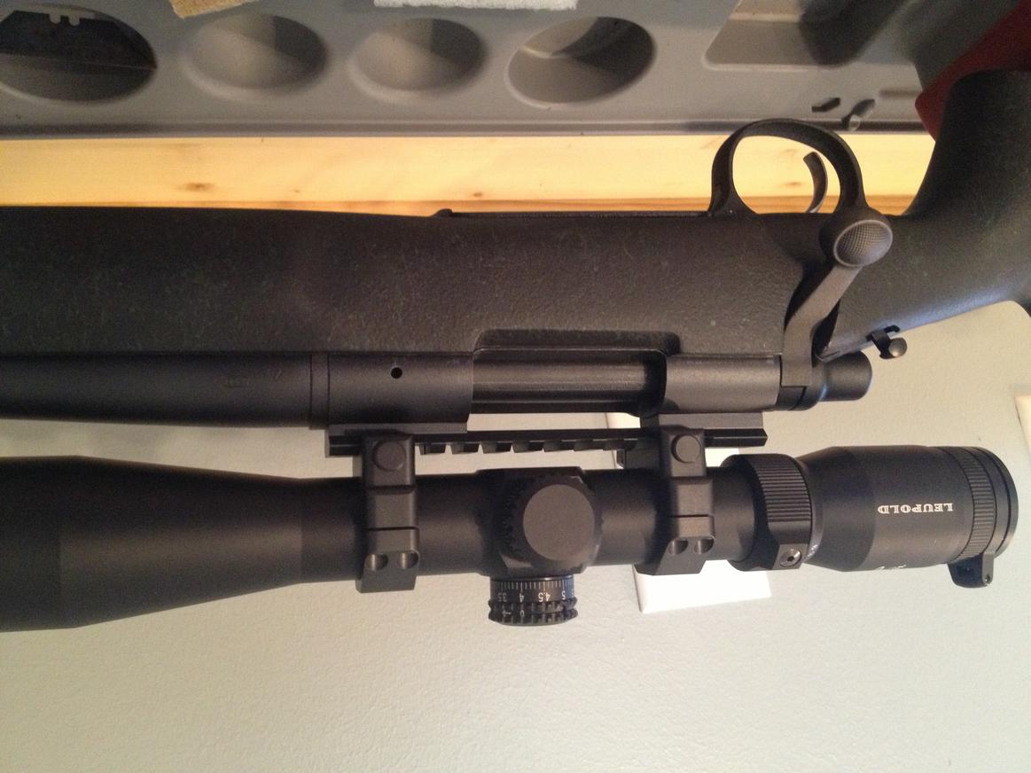

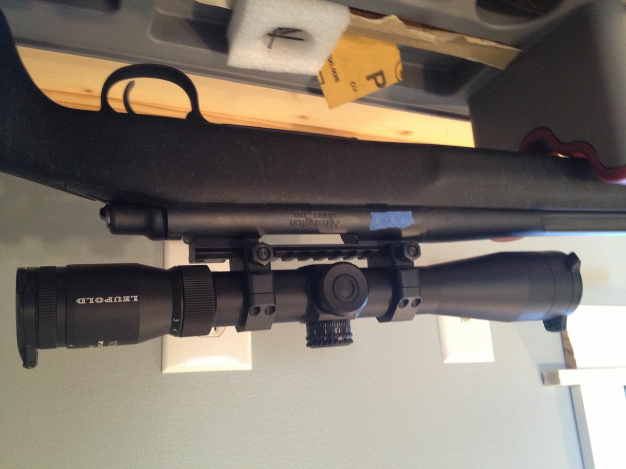

2. I will try to get a pic up later, but I confidently certain the 20 moa base is correct. (Small/thin end mount toward the muzzle - scope angled in "downward" angle as compared to the muzzle).
3. I have to side with Doug S...how does the starting position of a scope erector have anything to do the final position at zero or any other dope for that matter. (The relative position of the scope to the barrel/action will set the initial zero per say; hence 20, 30, 40 etc. bases).
4. The ring are 0.82 TPS TSR Super-Low steel. No cant.
I will get a few pics later today. I appreciate all the responses. I will check the tracking as suggested.
Here a few pics...
Everything is kosher to me. I'm leaning toward a internal optic issue. I just checked the travel and everything seems to track well and good. Only issue is I only have 3.7 mils up (reticle moving down) and I have 14 down (reticle moving up).

An out of spec receiver, low in the back, can really eat up your elevation. Did you bed the base? Tighten the front screw only, and look for daylight under the back?
I do have an update. Occam's razor strikes again. I went through everything over and over follow advice from some responses. The optic was ruled out as it tracks perfectly well. I decided the issue must lie in the barreled action in some way. The quickest fix for me was to bed my scope rail and bed it at the cant I needed to atleast center the optic mechanically to a rough 100 yard zero. This turned out to be very close to an additional 20 moa every way I calculated it. After bedding the base with a conservative 22 thousandths incline, I bore sighted to find about 18.9 moa achieved (I could lose or gain some tomorrow after an actual zero.).
Being pretty anal about everything, I started thinking why would I need an additional 20 moa. 20 from base and 20 from bedding for 40 moa total just to near mechanical zero. I went back and checked the part number of my base a I was very suspicious it may be out of spec. Low and behold it is a 0 moa base. My order states 20 moa, but the part number is for a 0 moa base.
So know I have a 0 moa base bedded (front and rear) for 20 moa (roughly).
Saved $100 bucks and prevent mass confusion if I would have bought a 40 moa base and not been able to zero at 100 yards. I doubt this post/thread will help anyone and like make many think the OP is a dumbass.....it's what I feel like.
I just couldn't let it go; I knew something was a miss....
The range will tell tomorrow if I'm good to go or if I need 30 moa. Guess we'll see tomorrow.....
