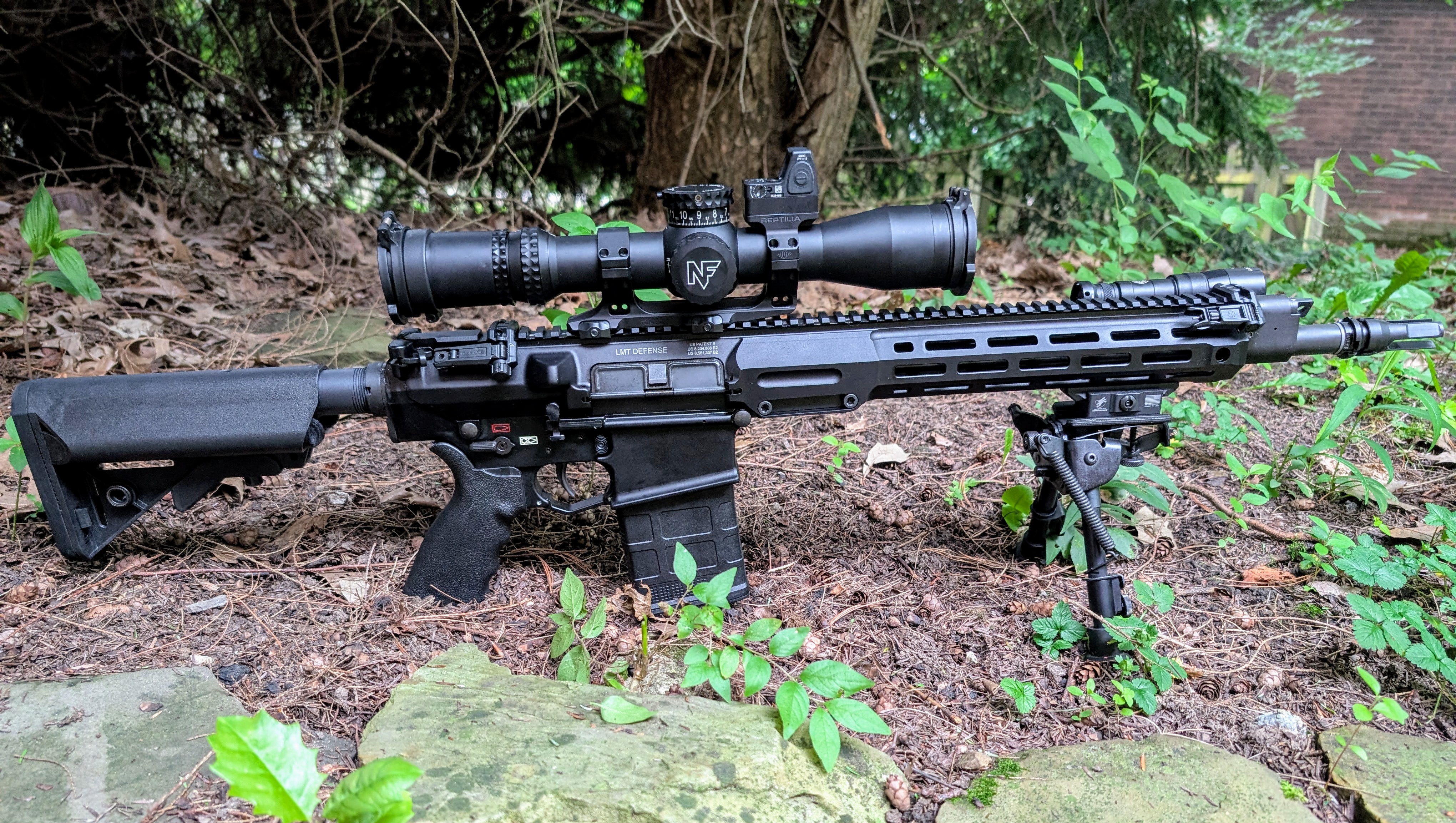

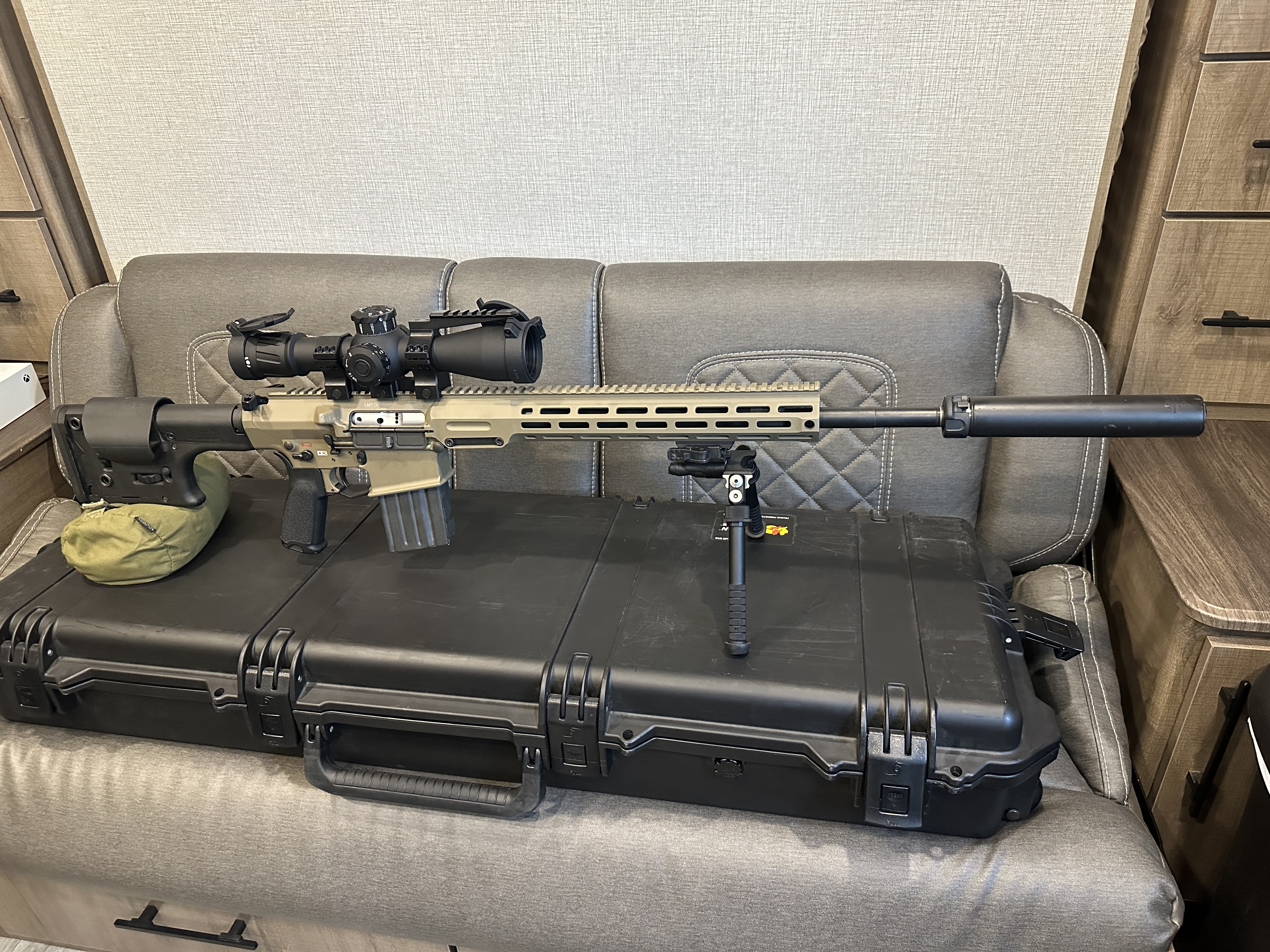

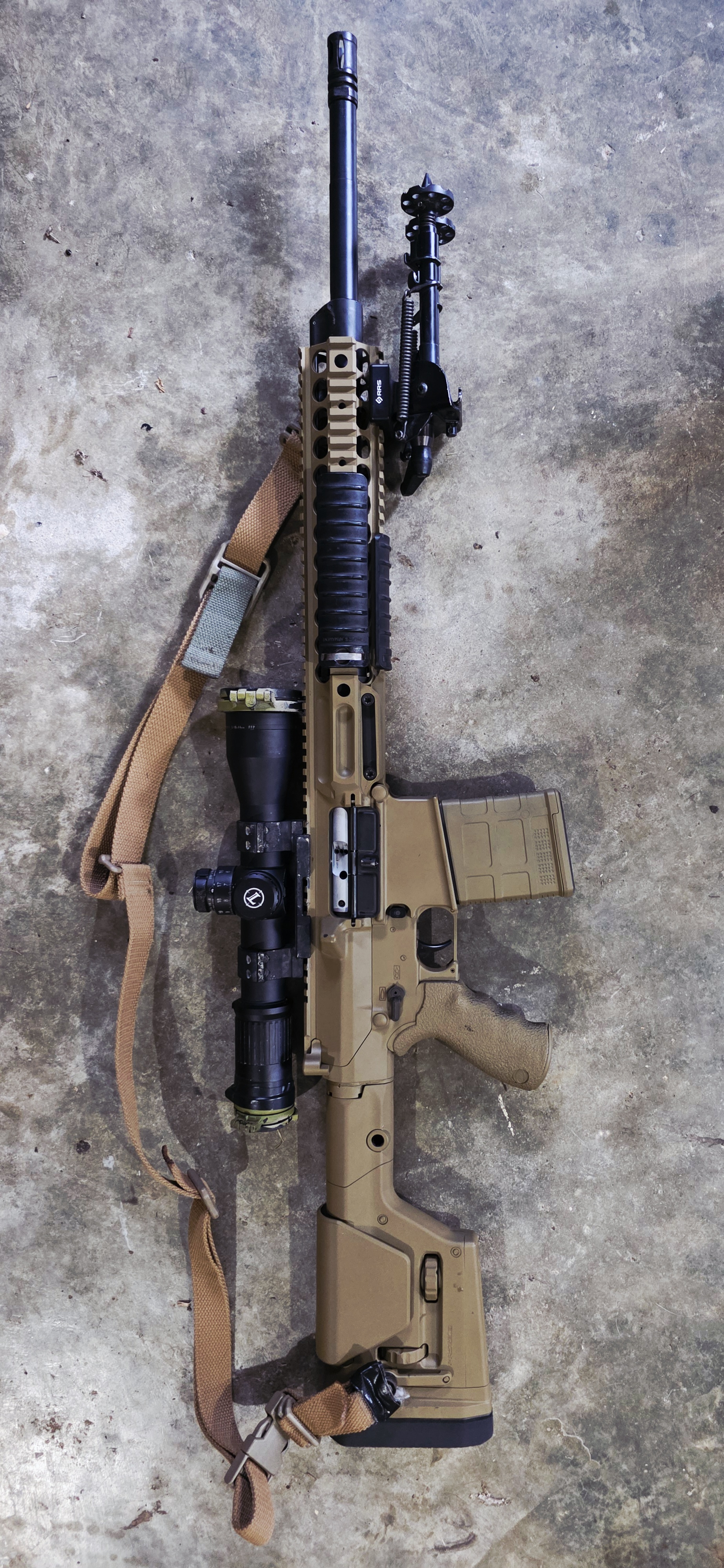

Starting to get my MWS upgraded to get it out shooting again. Have a 15.5" MLOK upper and am getting it outfit with some Dwilson Arca rails. What do you guys recommend for Atlas compatible bipod adapters?

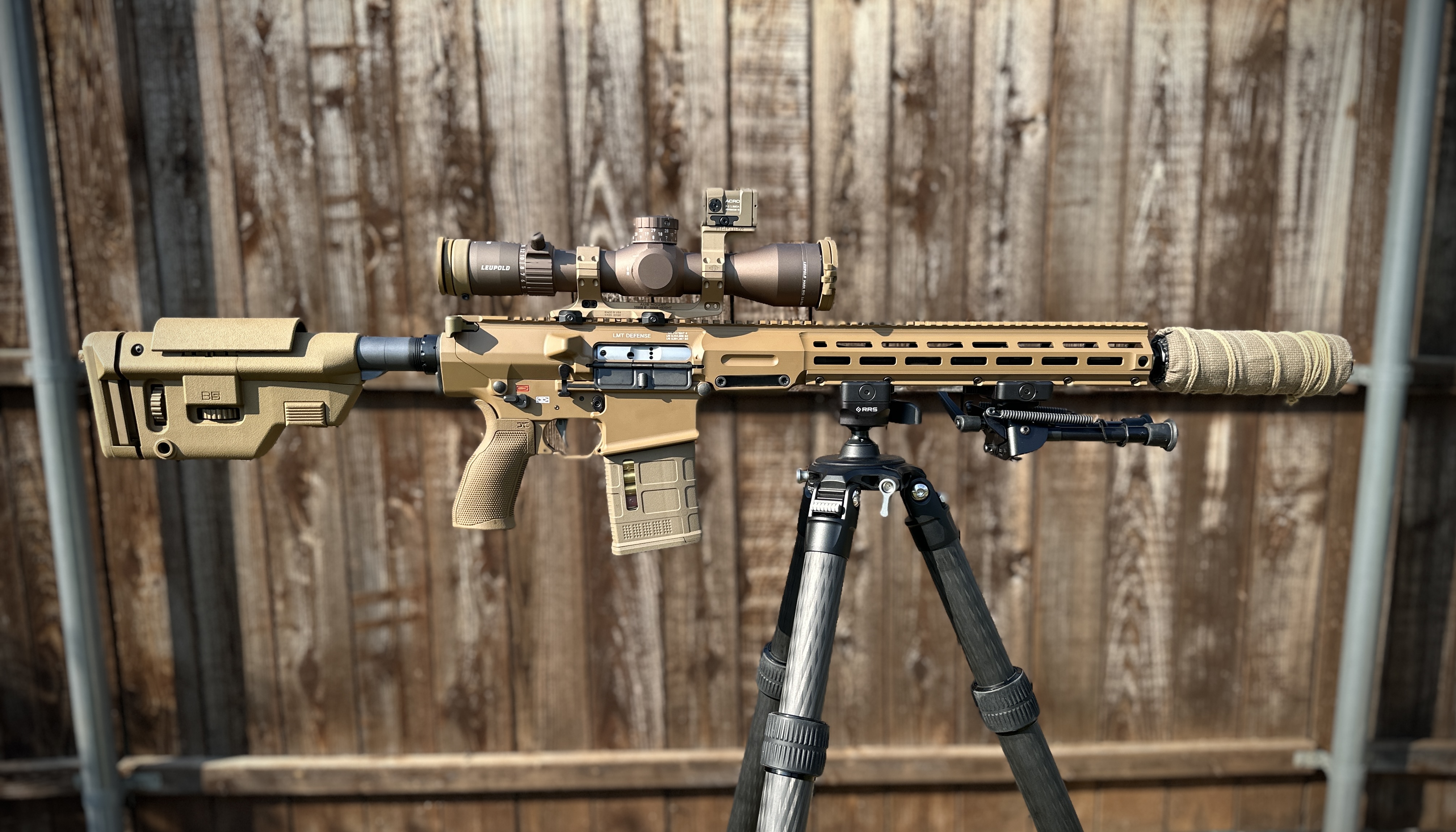

I’ve gone back and forth on selling this rifle. Since getting into precision bolt guns the “cool factor” of a semi-auto precision rifle has dwindled for me.
When the ZC420 arrived I had a hard time wanting to let go of that optic, since I originally purchased it for this rifle.
I didn’t realize just how much the resale value of LMT’s have dipped since I put this thing together, so deciding to just keep it.
Shoutout to Tony @ MKMaching for giving me a great deal on the optic

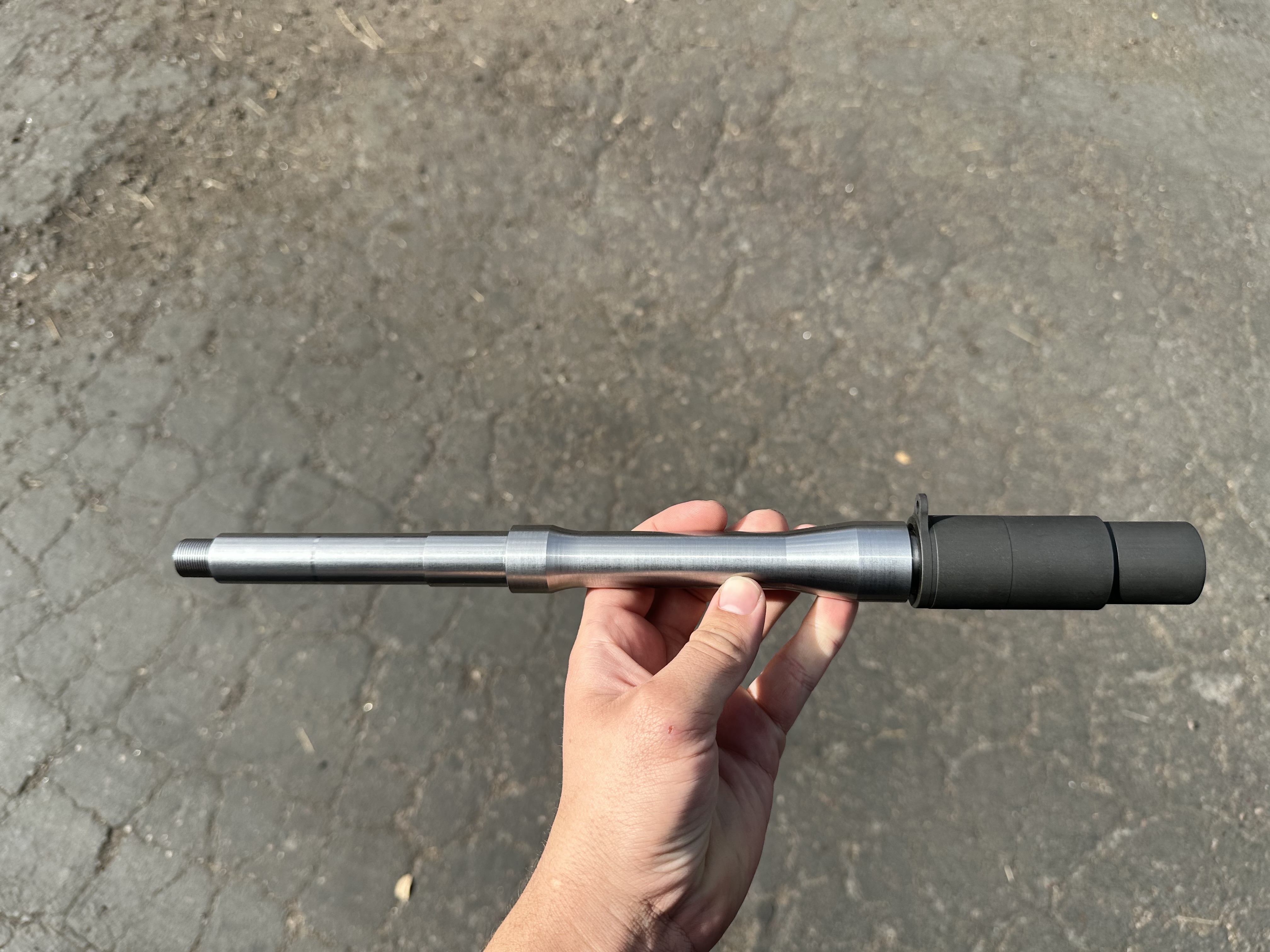

That's what I figured. It's almost worth just having a premium cut rifled blank made with an intermediate length, interference fit gas block and getting it converted with an LMT extension.
14.5” Intermediate and 16” rifle gas barrels seem to run fine. One of my buddies shoots a 14.5 and I have several 16” rifle gas set ups. I get the “extreme reliability” claim but damn. It’s like Colt still using carbine gas on their 6920’s.
Mid-length gas tubes must be cheaper. Lol
Reactions: Bakwa and JR1200W3

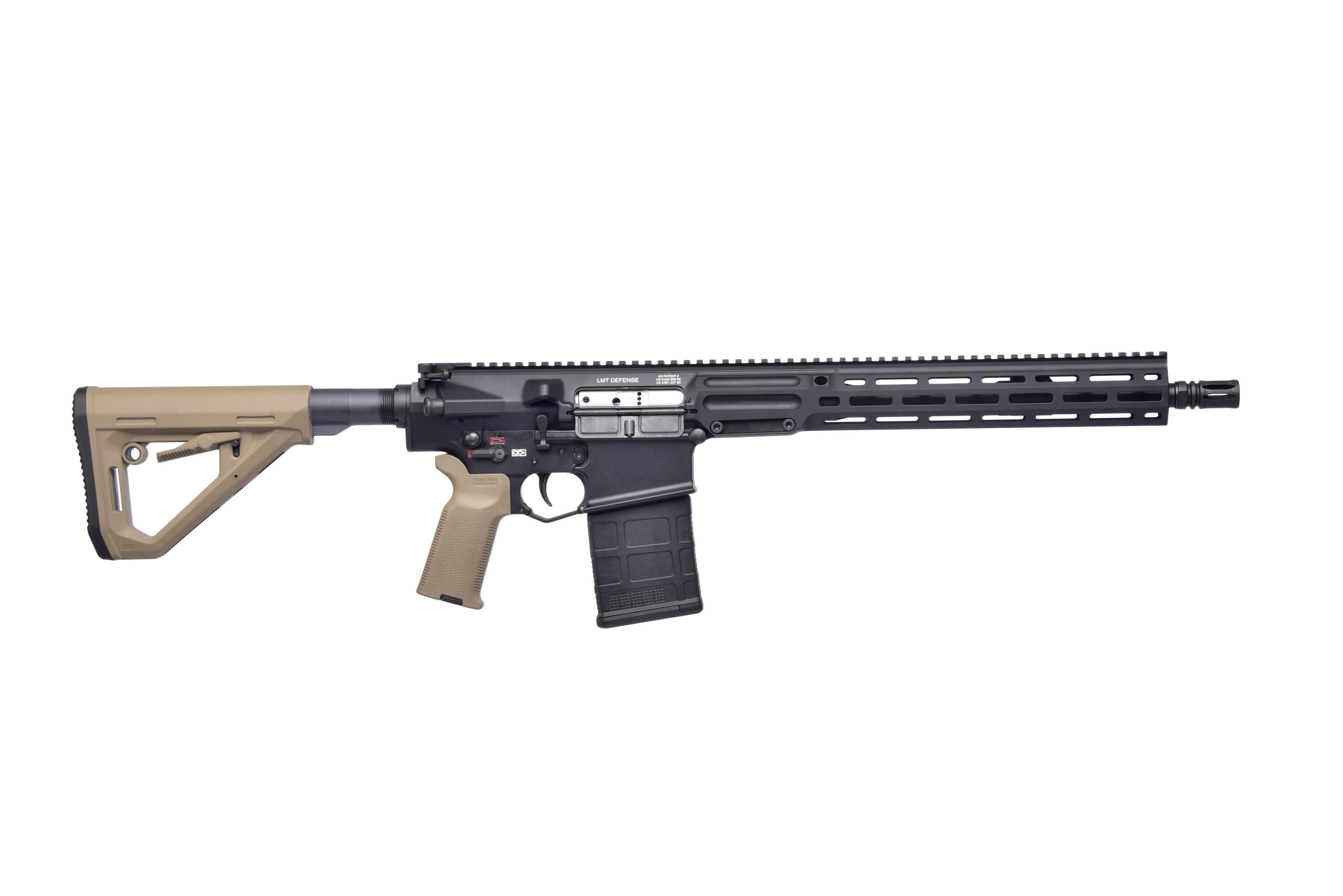

Any difference than the LMT barrels that were already available on your site?
I’m still going back and forth on buying a factory barrel or having you do a conversion for my MWS.

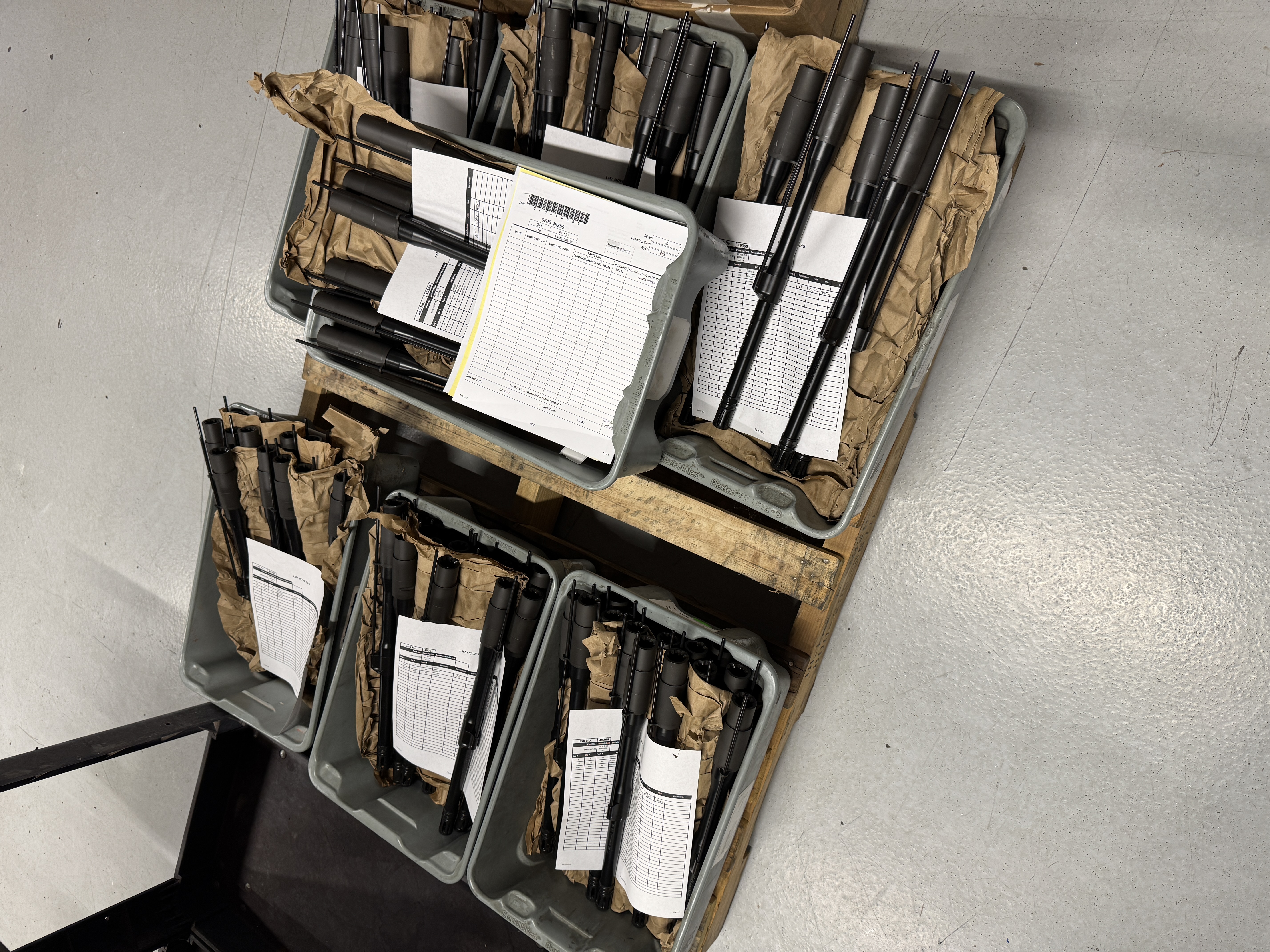

These are the barrels listed on our site. We made a trip out to LMT the other week to see them getting finished up in production and test fired prior to shipping to us.
Reactions: Hardgainer14
I guess I’m living under a rock. I bought my 7.62 CL 16 inch MWS around 2011. I thought they were all old school gas operated. Super happy with it. Put a heavier buffer in it and it shoots great with or without a can. Kills the shit out of pigs and deer.
When did they bring out a piston version?
Reactions: Bakwa

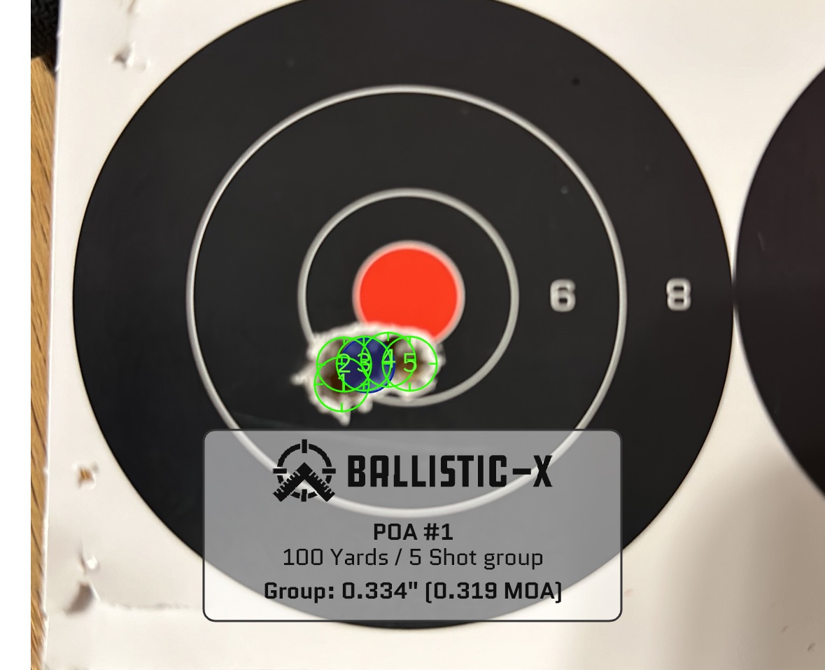

Varget and 175s consistently shot 1 MOA or less. Hates FGMM... ~2 MOA or higher for both 168s/175s

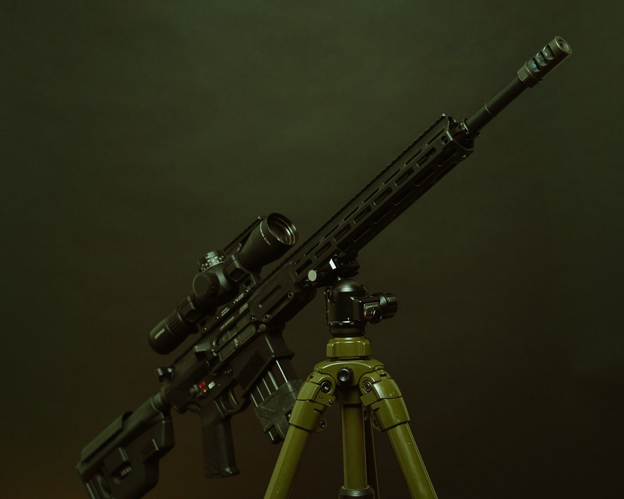

Craft drill off a tripod with mine today. First time I've ever attempted this. I was doing all the good until the last round that went high. 168gmm isnt this rifles favorite ammo either. It prefers the 175 over the 168, and it really likes the hornady black 168 Amax. No 175's on hand, and running low on the hornady stuff so it got the 168gmm today.

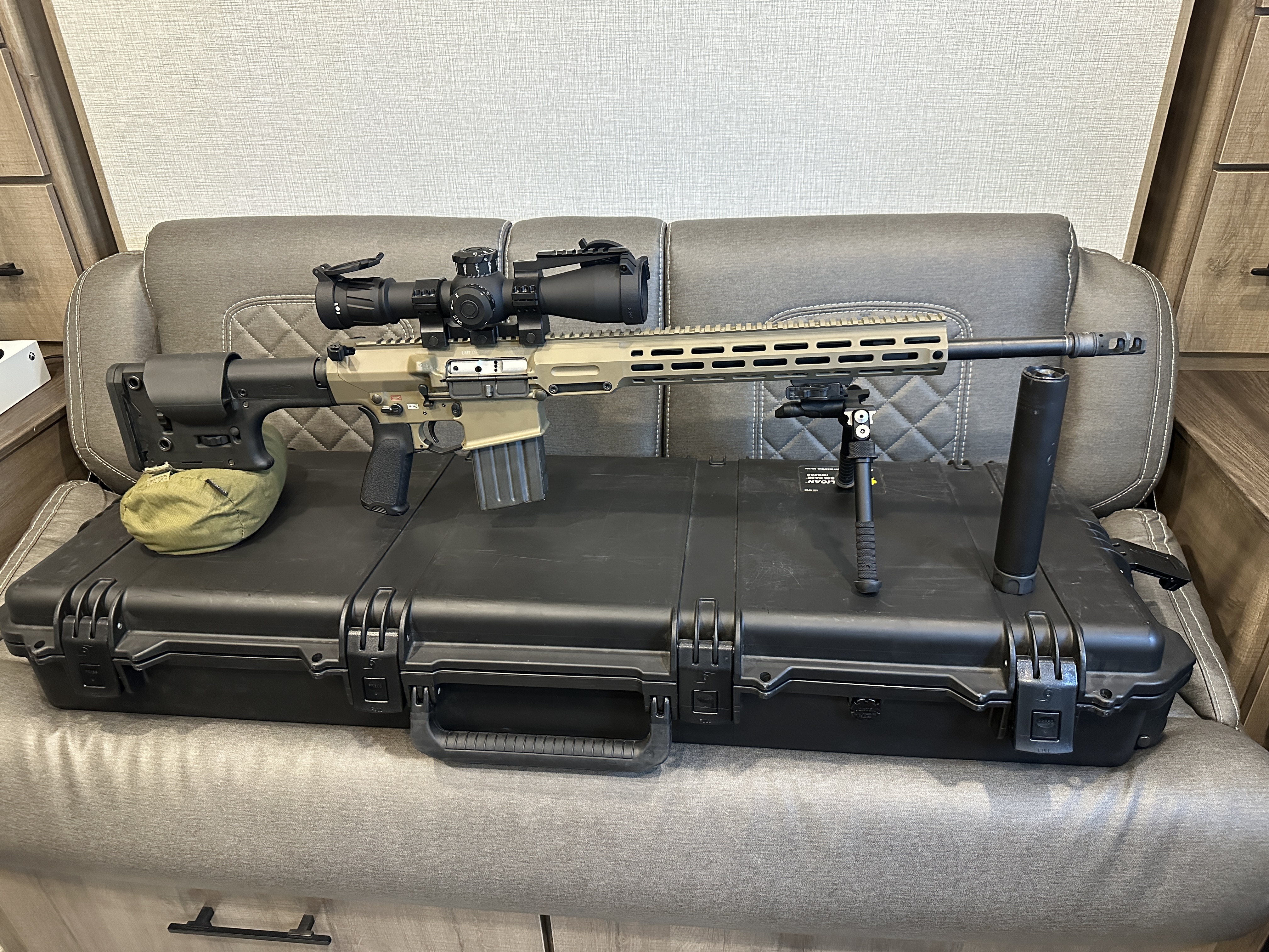

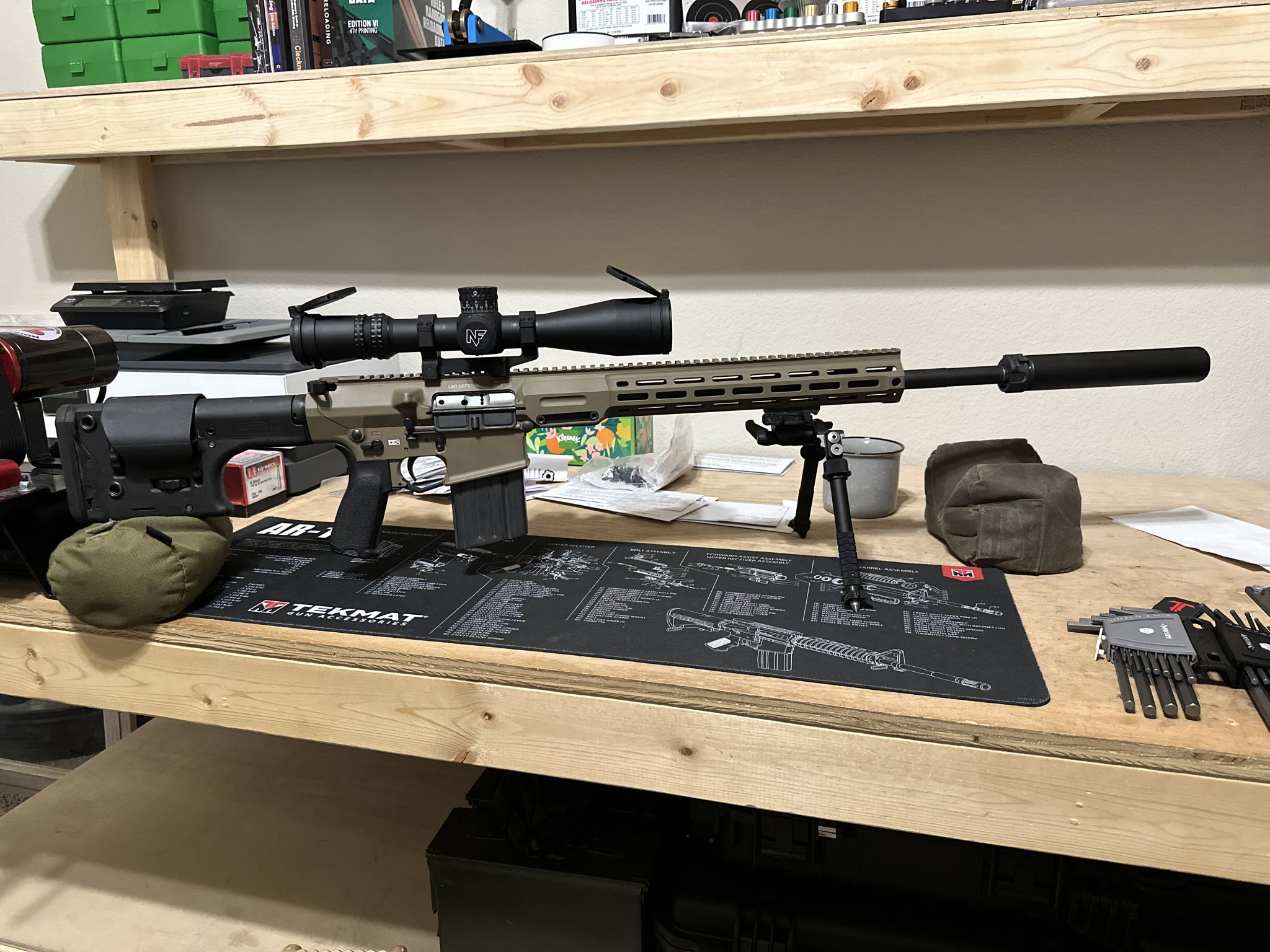

picked up this one on gb, ordered two 20" 6.5 barrels on sale from lmt (no tax or shipping charges). waiting for arrival at FFL, will try out next week. sharpshooter reference kit
Have any interest in selling the case?
