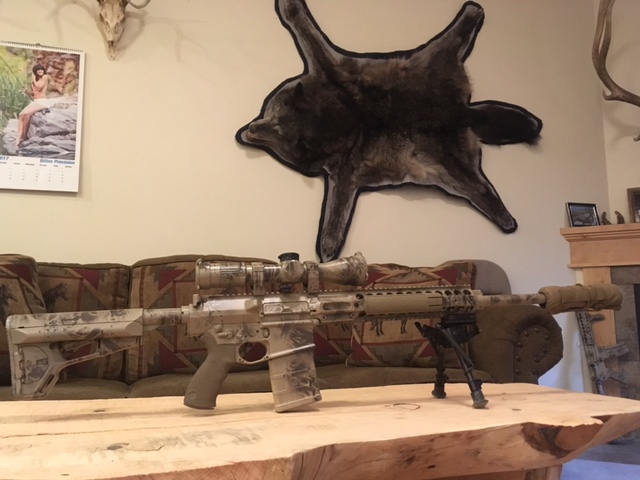

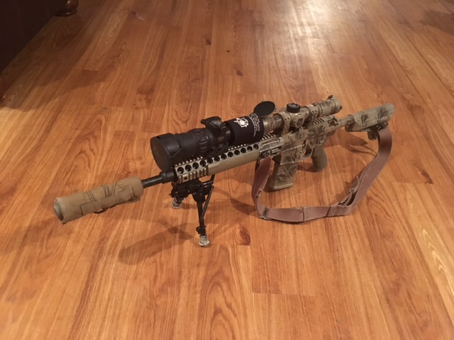

Not sure if I posted a pic of the rifle or not. It’s not as cumbersome as it looks, but it is definitely heavy. I’ll try and get it on a scale if your interested in weight. I know I’m not going to be kicking doors and clearing houses with it though! Yes, I know the door needs repainted. My wife reminds me all the time of the projects “WE” need to do around the house.

Looks like we may end up with the same color. I have an SB ultra short on order in RAL-8000 and am trying to see if Federal Field Drab 30118 (also known as Marine Coyote Brown, LMT/B5 FDE according to a post on AR 15) will work.

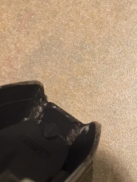

I had the issue before and I think I posted about it but it happened to me again.
The bolt catch peened the aluminum around the plunger hole resulting in the bolt catch not having any spring tension keeping it down. I haven't had any failures but noticed it was loose today. I had to work the plunger in and out for a few minutes to get it out then I took a Dremel with a very small ball cutter and removed the lip again. I do have a few chips on the rear edge of the bolt catch from the bolt or carrier grazing it.
I may email LMT and see if I can get a new catch at least. Just something to pay attention to. I doubt I'm the only one this could affect.

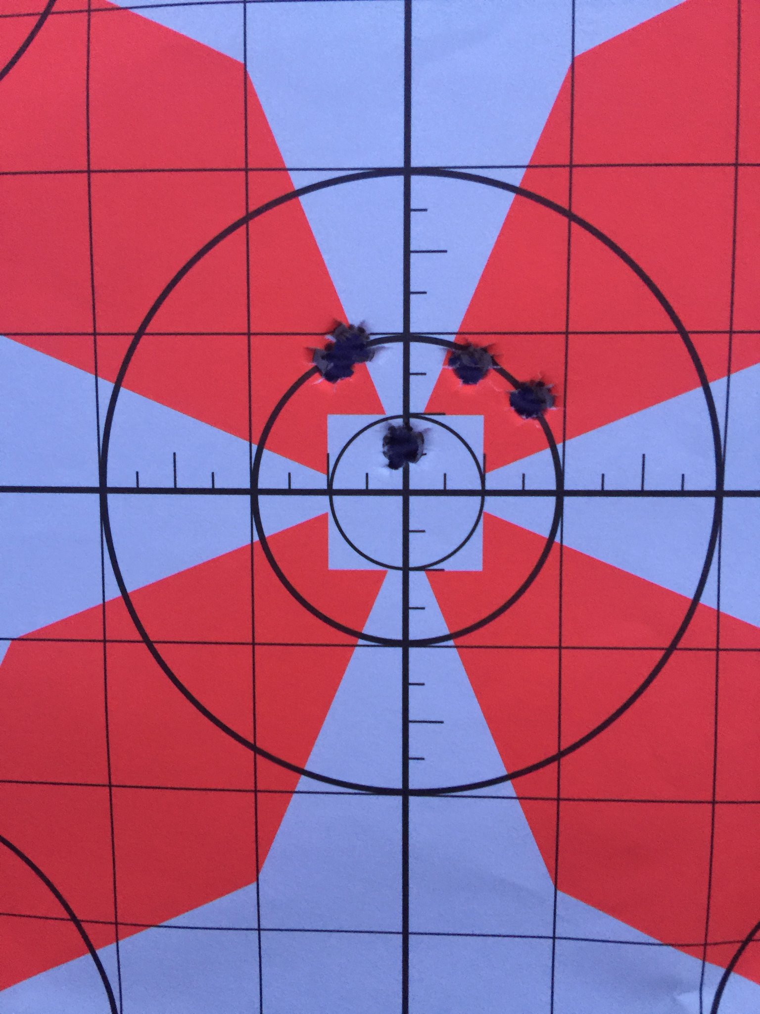

Took the 24” 6.5 Creedmoor out tonight. Between darkness coming, mosquitoes and rain I only had the chance to shoot 15 rounds. The first 5 rounds left me really disappointed. Had to get my head right and try again. The one low in the bulls eye was a called flyer. Then I tried again. All in all I’m damn happy with the results.
These were shot at 100 yards prone off a Bi-pod with no rear bag

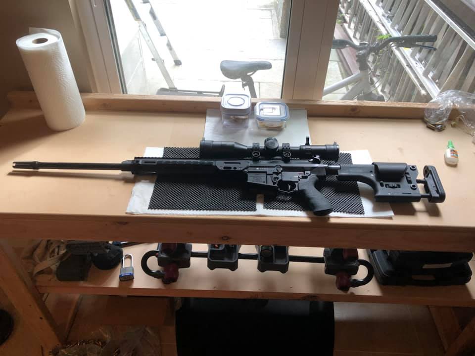

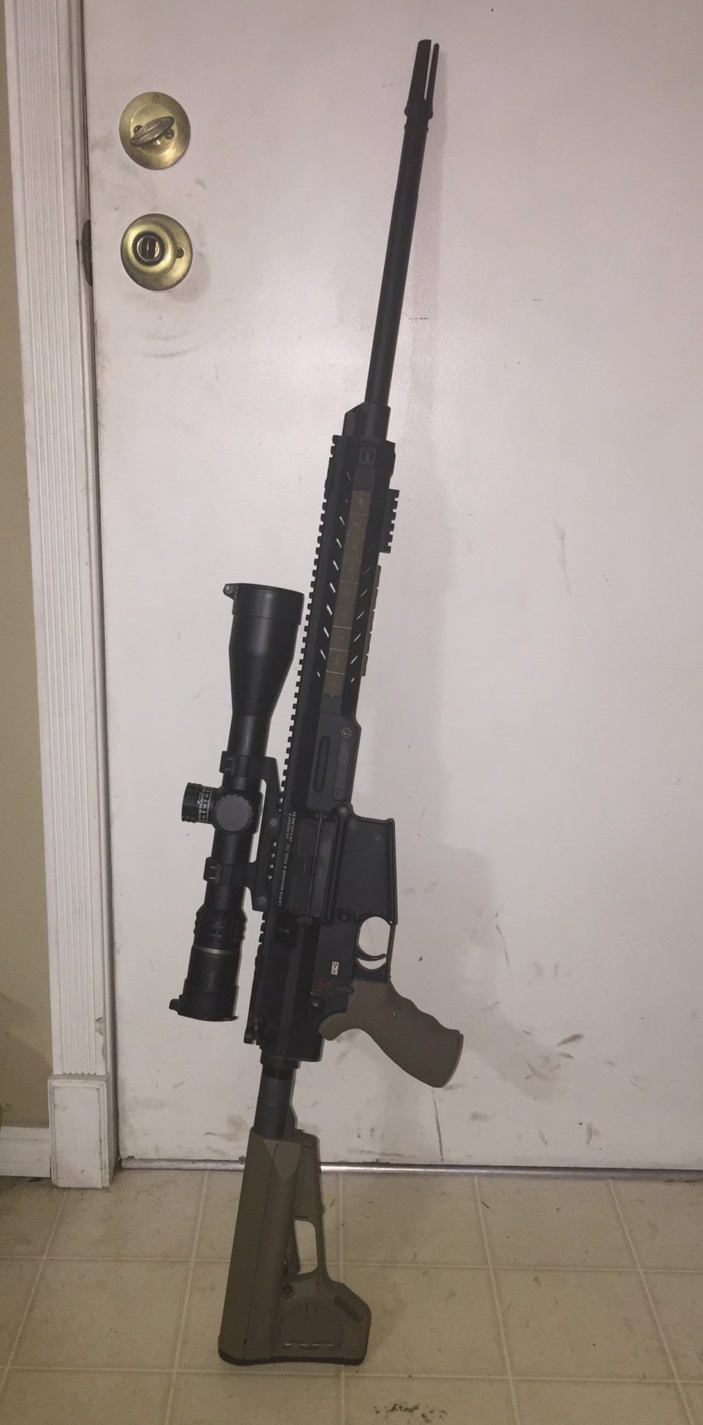

Breakdown of the rifle.
LMT MWS 24” 6.5 Creedmoor
Burris XTR II 4-20 H-591 Reticle.
Geissele High-speed NM trigger(NM spring set)
KAC bipod
Horandy 140gr American Gunner ammo.

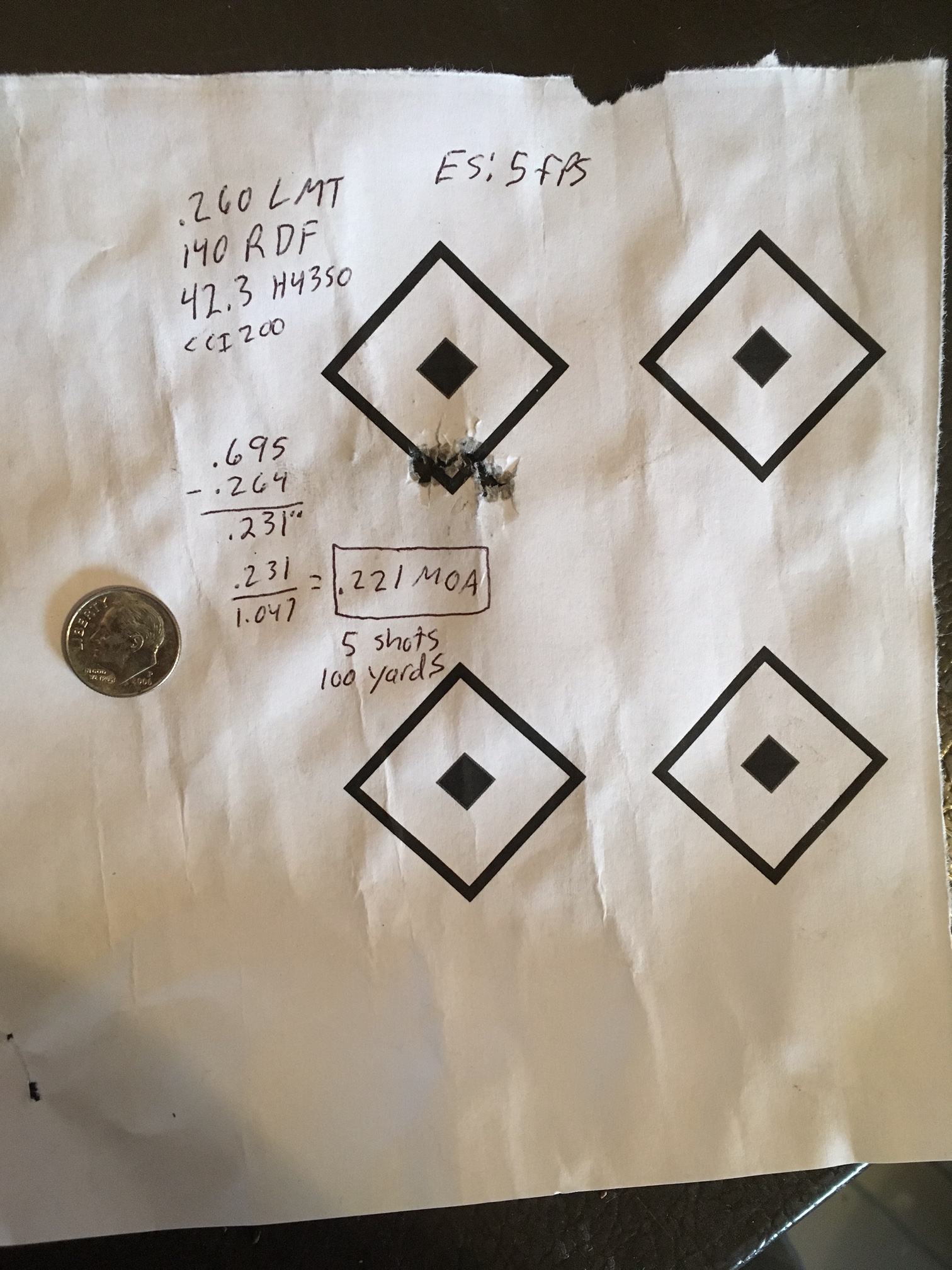

I had a 18" ss LMT barrel cut down to 16". I also had the original gas block removed. I'm guessing they knocked the pin out and used a hydraulic press to push the old one off. From there it was a perfect .875" under the old and I put an slr sentry 8 adjustable gas block on it. I never did get that barrel or LMT's replacement "SS Match" barrel to shoot very well. I gave up on the factory barrels and now use Jeff Hayes from river's bend gun company to spin up bartleins on the LMT barrel extensions. I have a .260 from him and my .308 barrel should be here soon. His .260 barrel shoots like no other gas gun I have ever seen.

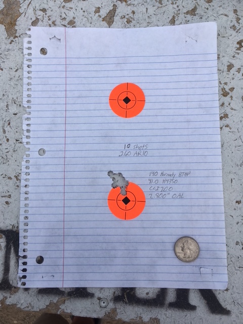

This is a 10 shot group with some random generic load I just through together to see how it would do. This is not the load I normally shoot.

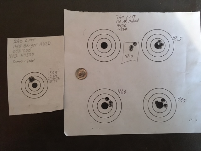

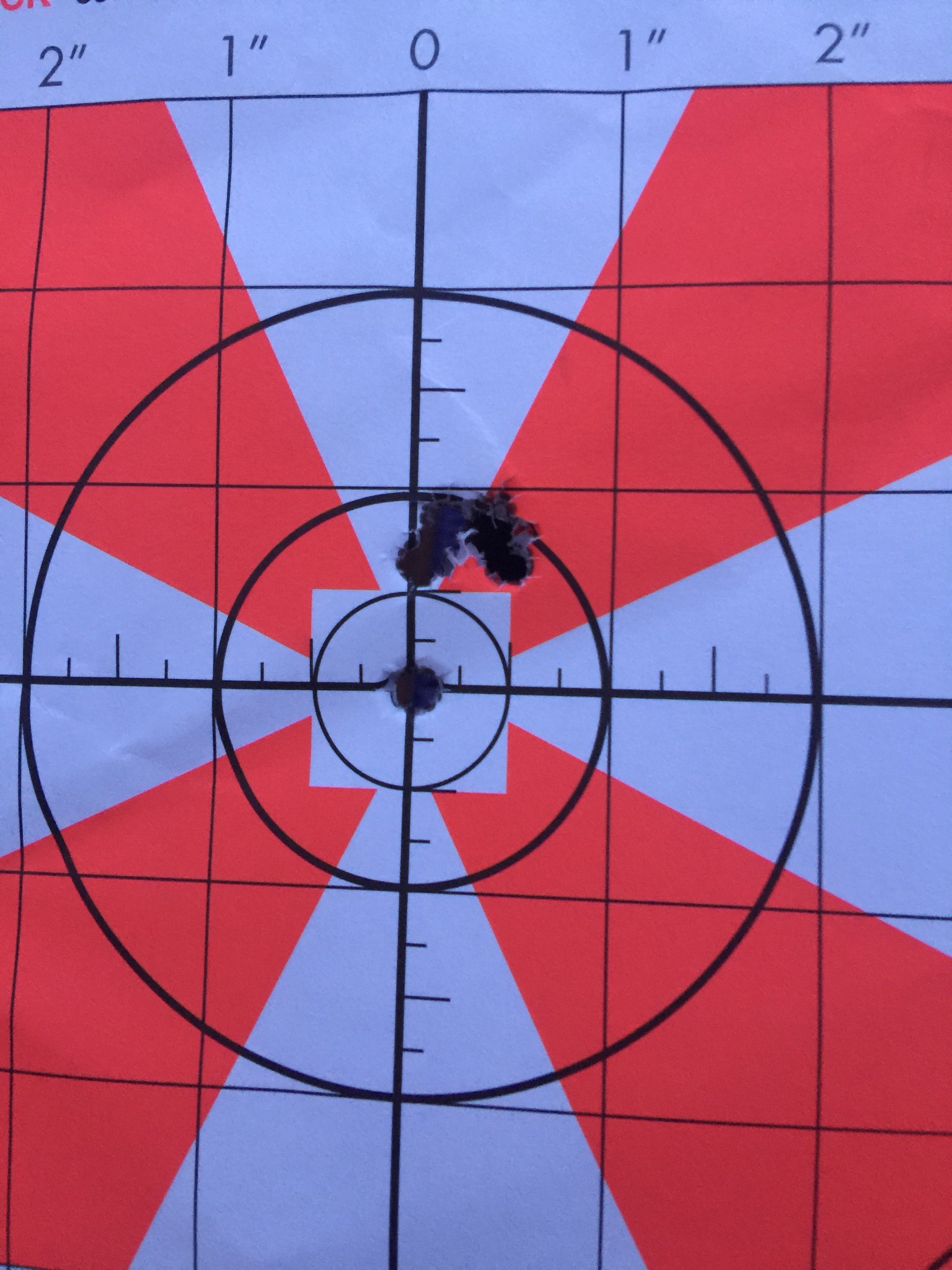

Here are some other targets I kept during load development with the .260 bartlein barrel.
And here is an example of the type of stuff I was getting with a factory "SS Match" barrel.
I am very happy with my LMT, except I just never could get any accuracy out of a factory barrel. This includes (2) 16" chrome lined, (2) 16" SS "match", and an 18" SS "match". The money is already spent on the rifle and an extra barrel. Once they get sent off to get a bartlein on, everything is great. It would be nice if the $600 factory barrels would shoot, but in my experience they just don't.
