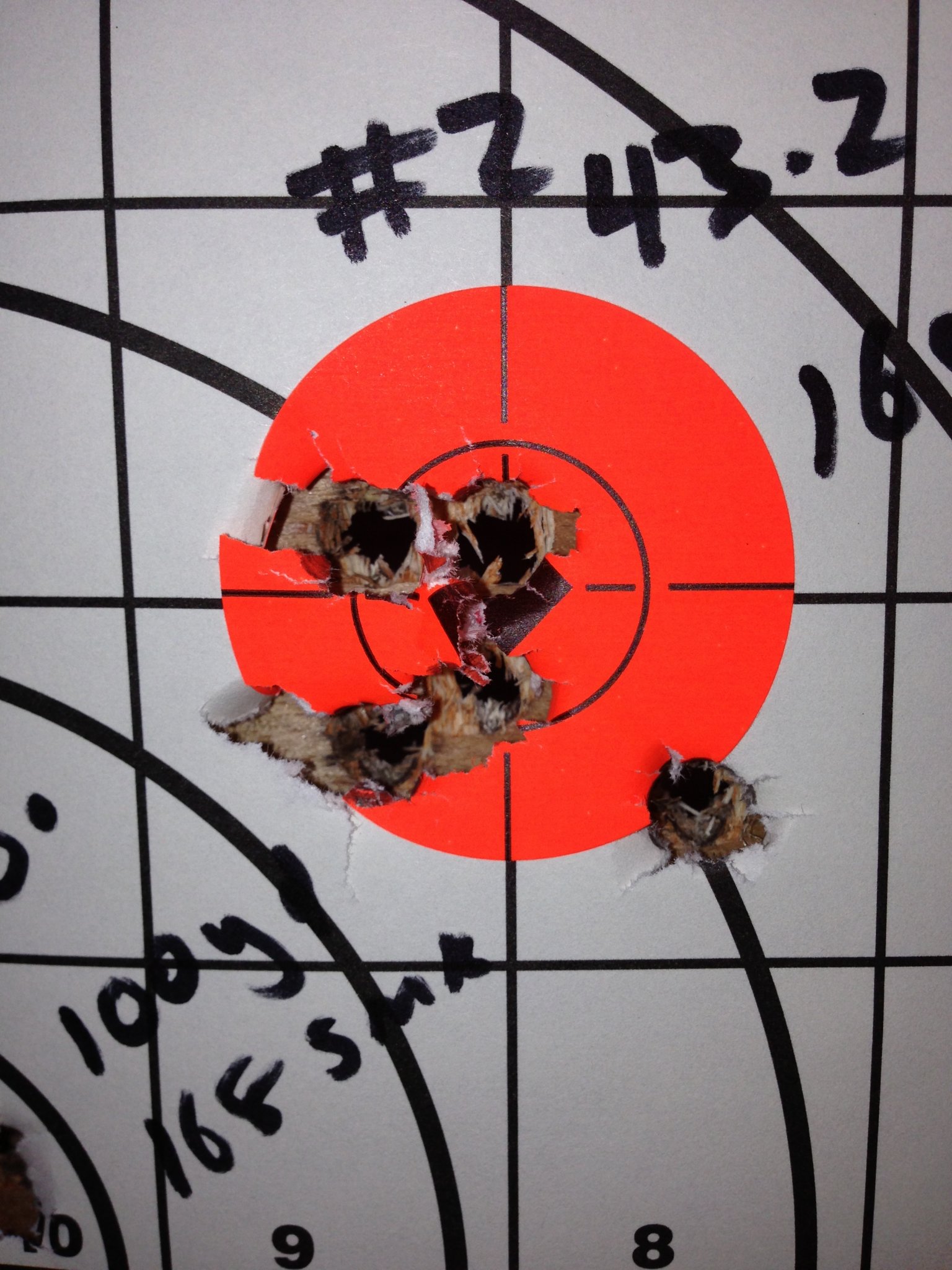

Checking in after a few years, rifle still works
(That’s 5 @100)
155 Barnes match burners over 43g varget
Hasn’t been stock since day 1 but settled on this setup for a while now. Springco orange spring and standard weight rifle buffer cut out unnecessary recoil of the extra heavy stainless buffer I thought I “needed”.

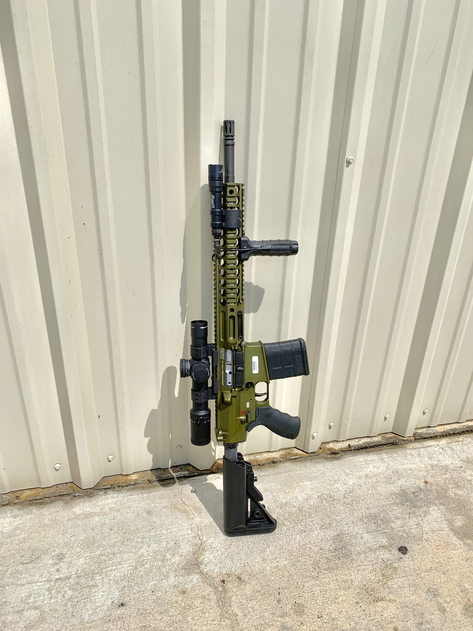

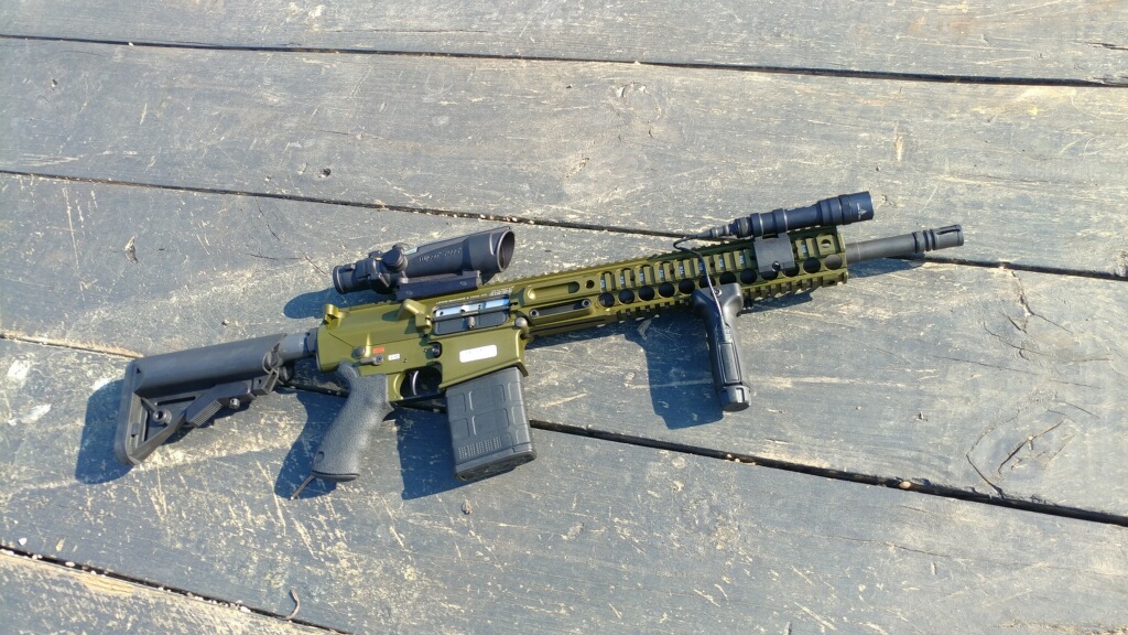

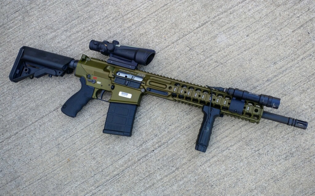

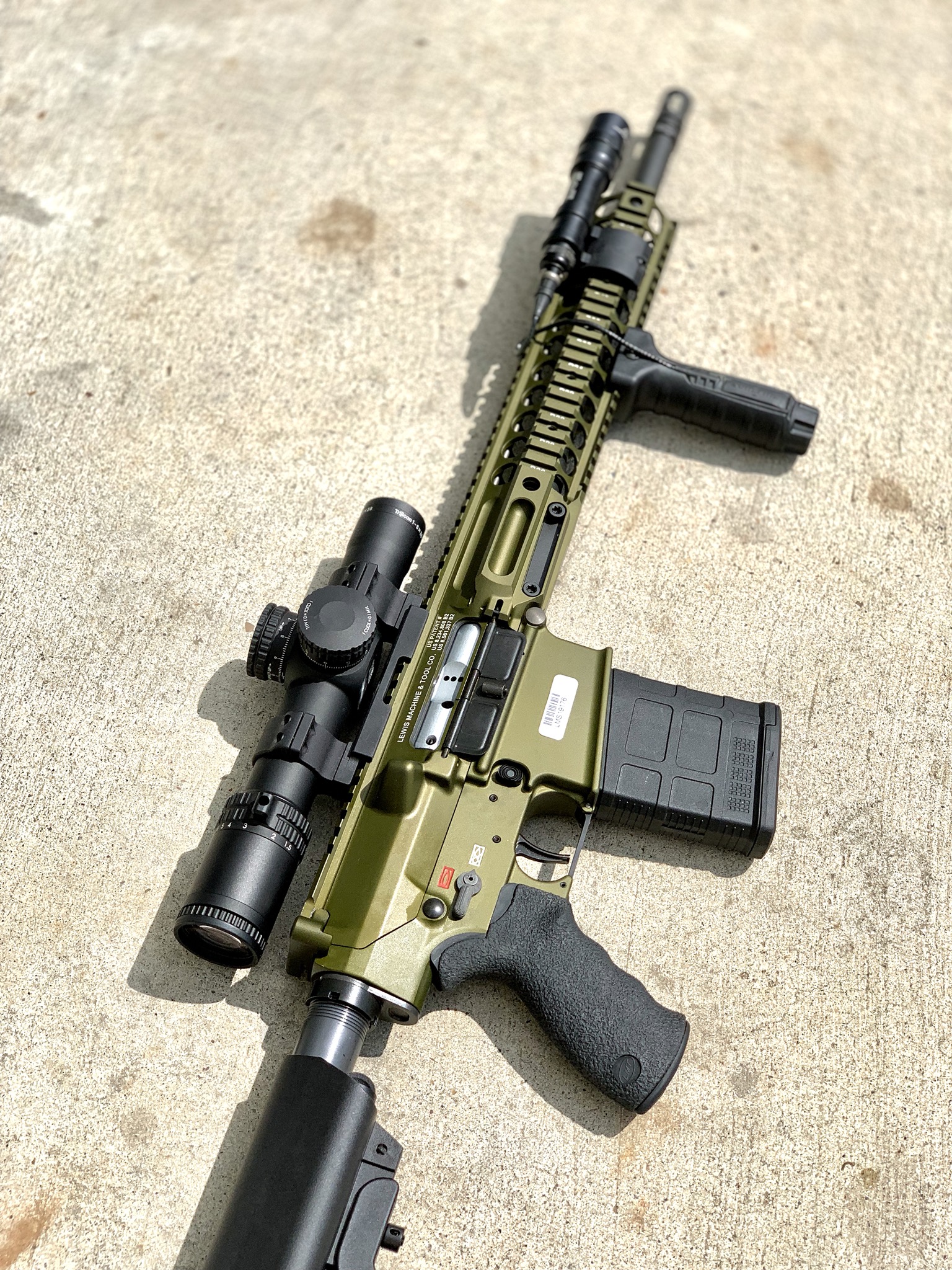

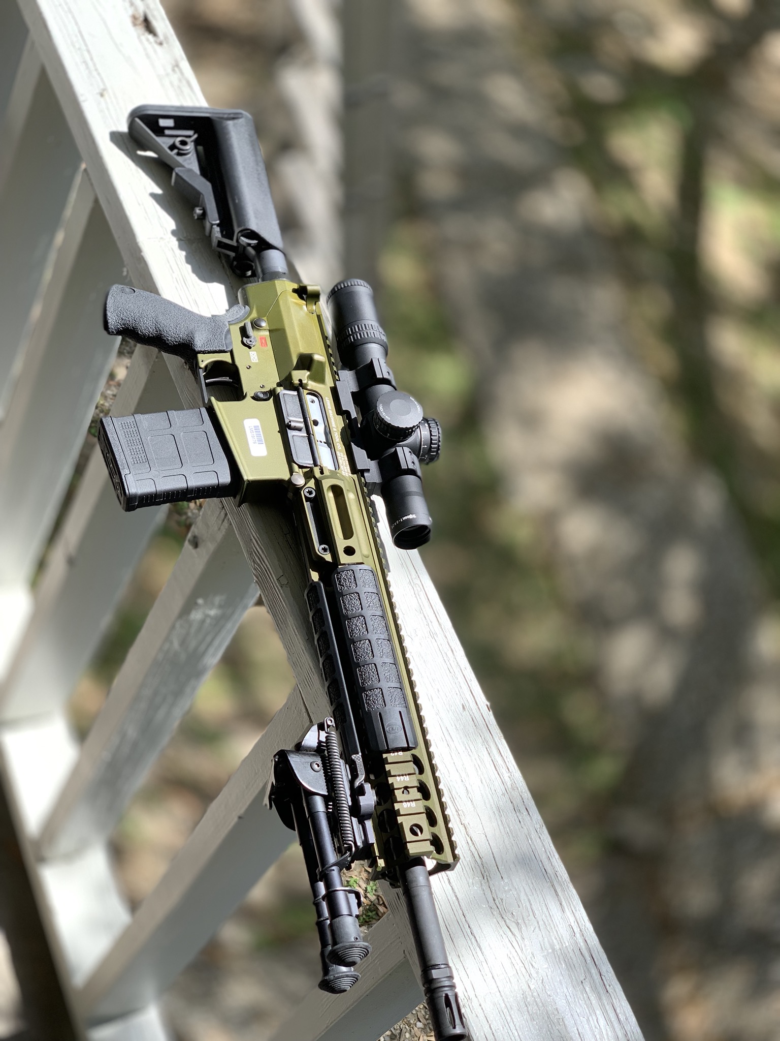

Those canteen rifles are sweet! I really like the color and wish I had found out about them before they sold out. Kudos to you guys who picked them up.
In the pictures the upper and lower look a shade off in color from one another. Is it just the lighting on the angles or are they a little different?
I guess I missed the news. Where did you get these apple green beauties??

Been tinkering with my loads but it shoots pretty good for a gas gun. Using 43.2 grains of varget with fgmm primers and 168 smk. The 16 CL barrel definitely likes 168 over 175.
