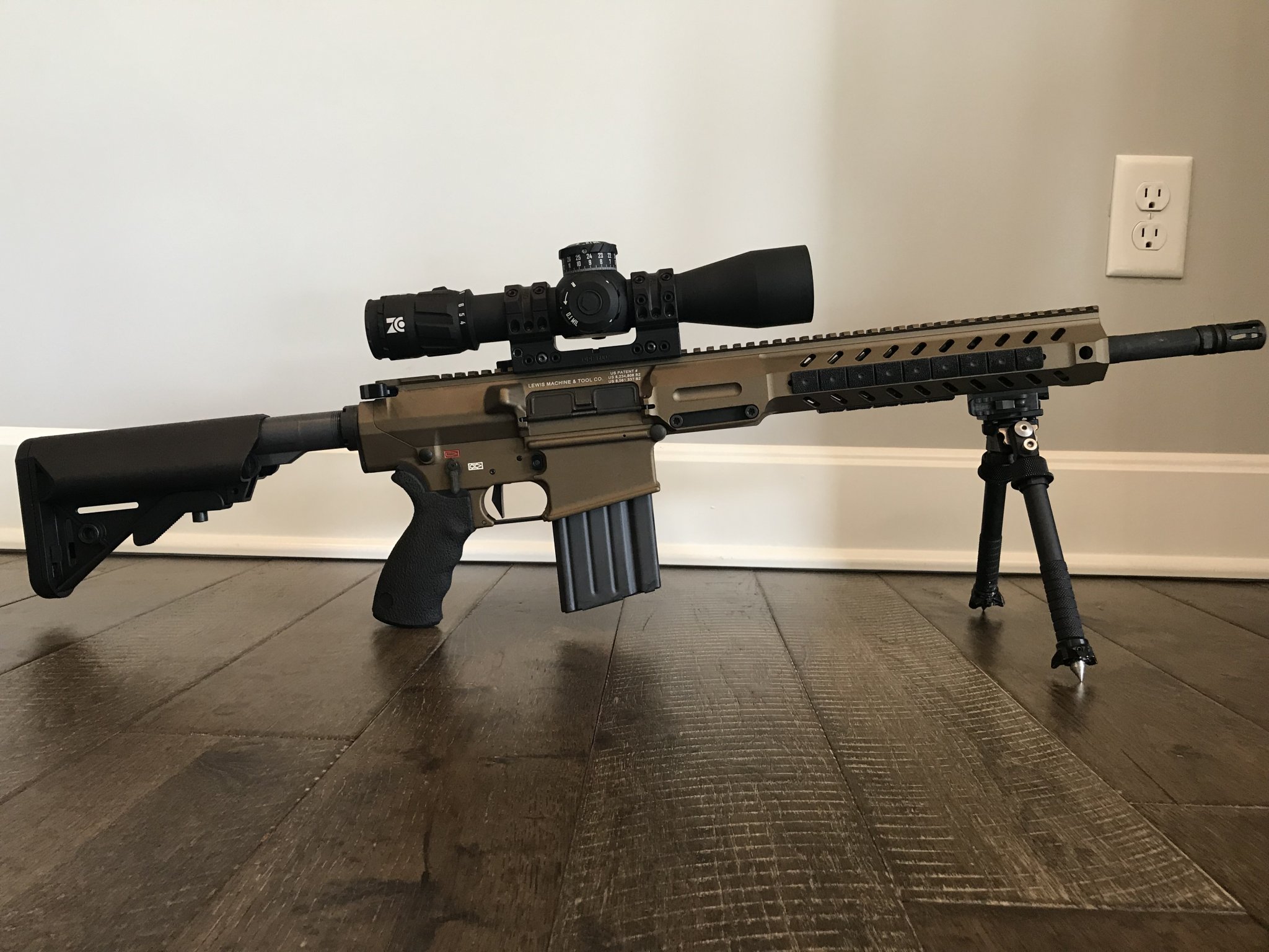

I just picked up a burnt bronze MWS in 308 and mounted a ZCO 4-20 on it. Looks great. I think this optic is a really good fit for this platform. I have a DMR stock and a 20" 6.5 creed barrel on the way. Hopefully I can make it to the range this weekend. Will post a range report.
Reactions: TACC
Looking forward to hearing how she does with that 20" 6.5 Creedmoor barrel! Please post up pics of your best groups. I put a Geissele trigger group, SSA-E, in mine.

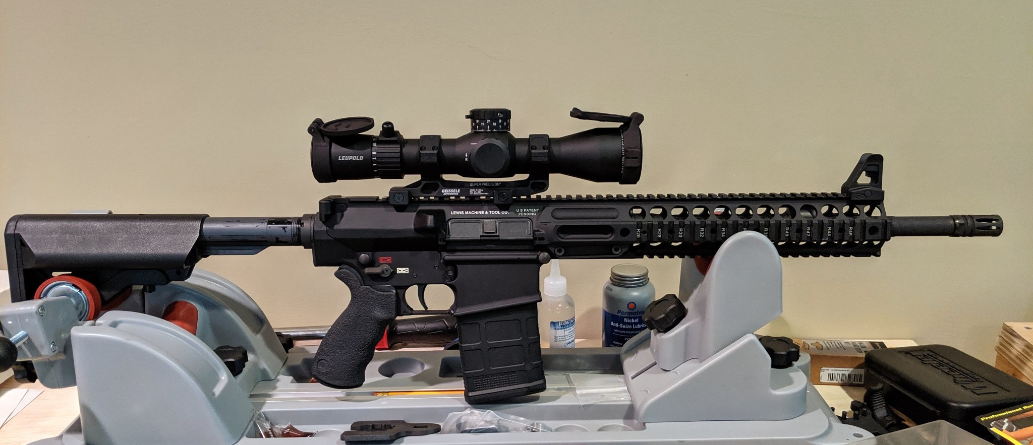

LGS had this tucked away in a corner, said they've had it for over a year and offered me a great deal on it, I had an extra scope laying around which made the deal even easier to do. Very impressed with it so far, ready to go shoot it.
It’s coming together. Still waiting on my 6.5CM barrel and DMR stock.
Upgrades:
Geissele SD-E
Tubb flatwire spring
Raptor ambi charging handle
KAC mags
