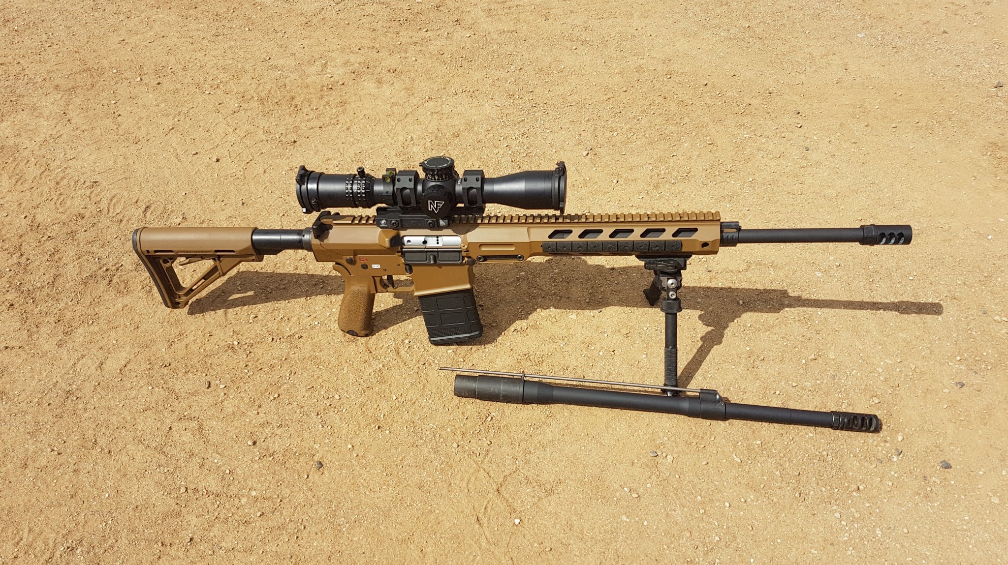

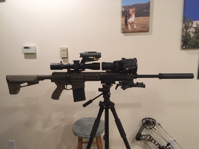

What are your thoughts on the revolution compared to the mws?

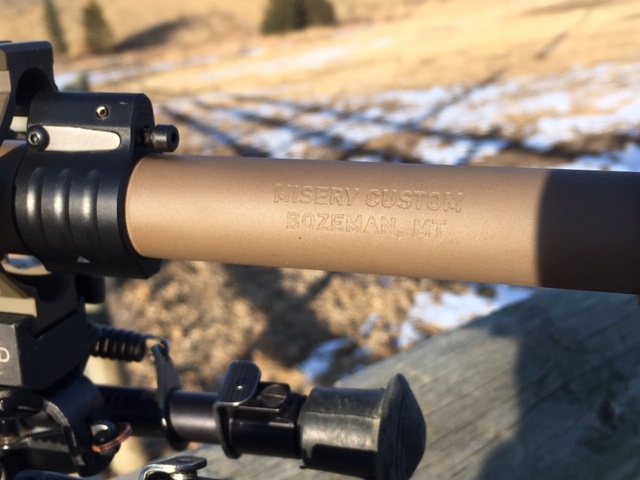

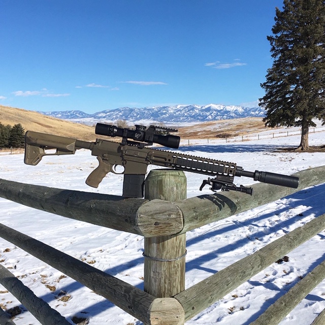

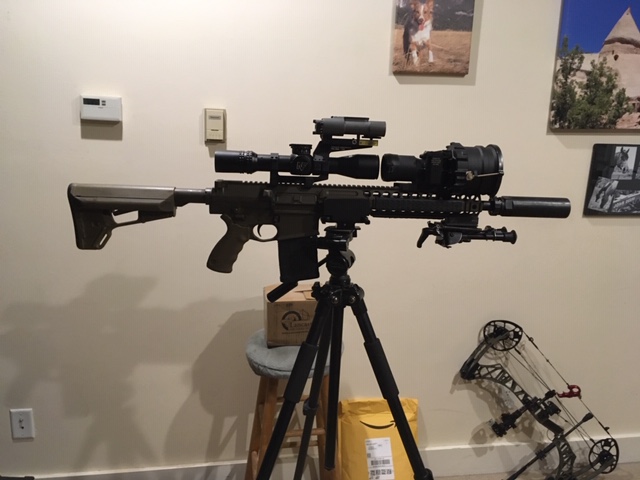

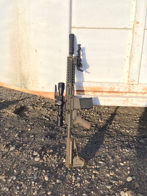

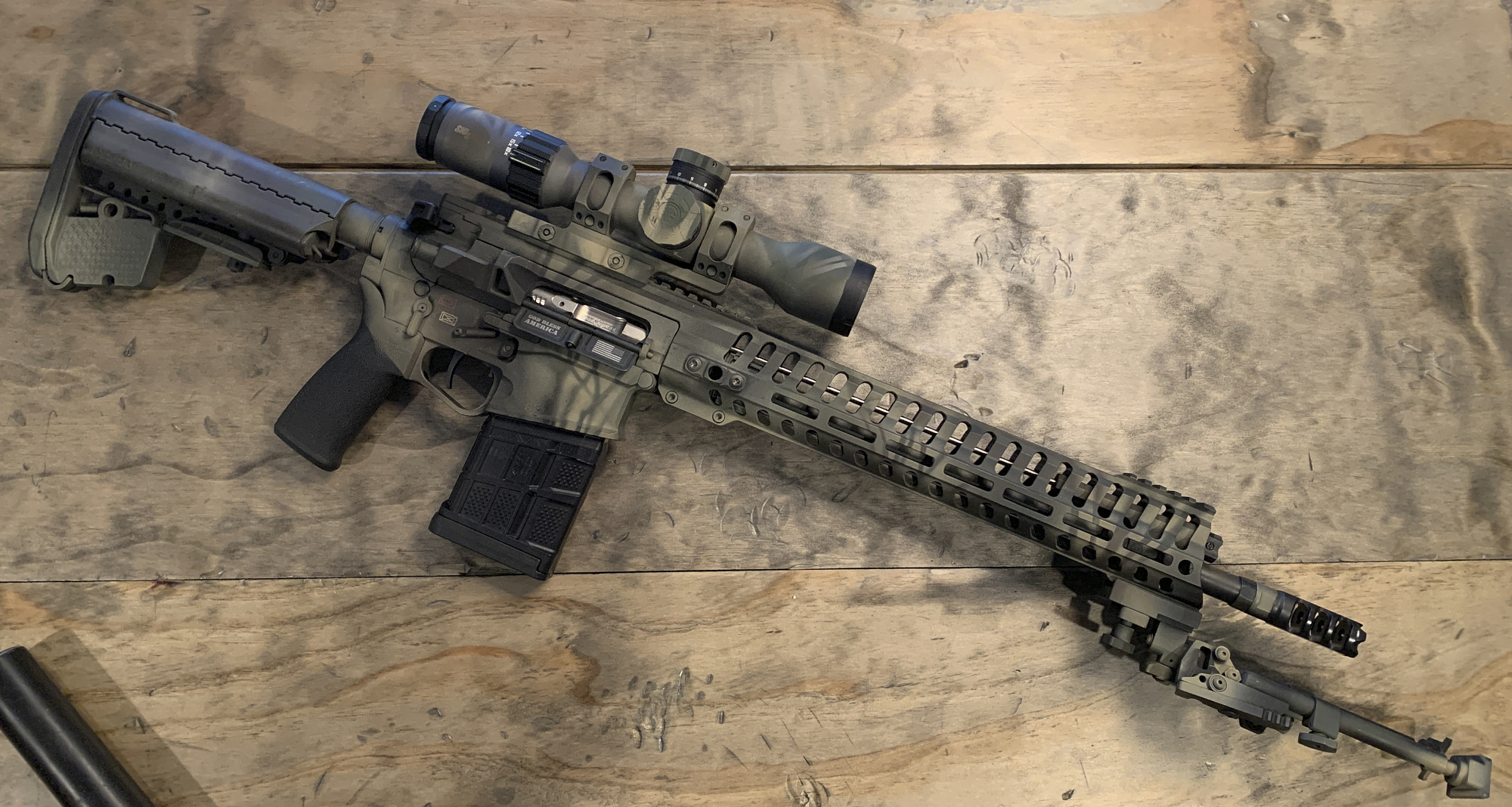

I wished I had shot enough to give you a dependable answer- i have about 600 through the POF this past year and maybe 300 through the MWS, reliability thus far- 0 problems. That's with a United Nations of milsurp, Wolf, PMC and to some mystery FMJBT I found in a ziplock.
so for that same reason+ I'm no marksman, I can't compare accuracy. I've been shooting 3 assorted magfulls at the same target at 100 and they're both blowing out fist sized holes. When I find a good amount of quality ammo, I'll try some proper comparative groupings.
With just a red dot and a mag, handling is worlds apart- the POF is well balanced, agile the difference in weight is well apparent, it does feel like a good AR15. The more stuff, scopes, bipods, cans etc I put on, the less that proportional difference is noticeable.
The fully ambi lower on the POF is nice to have, though I only occassionally use the bolt release- I do like the BHO inside the trigger guard- that is smart and I use it a lot at the range, when they call cold, mid mag to clear and hold open.
Shooting the POF from the shoulder, the recoil doesn't feel harder than the MWS, but it does feel different- it's also much better balanced than the MWS, easier to shoot strings, not as much work holding up the gun. On the bench with a bi pod, it's quite different- the POF wants to squirrel around, whereas the MWS is much more planted and easier to keep on target- its the opposite experience from shooting shouldered.
Shooting supressed through my 10 year old tech 2lb SRT Shadow XL, the POF is way better- 5 position, FAL style AGP that's easy to tune, no gas to the face, MWS got a bit sharper with the recoil and some gas- not unbearable though. Getting a new CH that will hopefully help a bit.
Like both rifles, but they're each purposed very differently, Revolution with a red dot or LPVO makes a handy field gun, scoped MWS is fantastic on the bench.
YMM of course, V

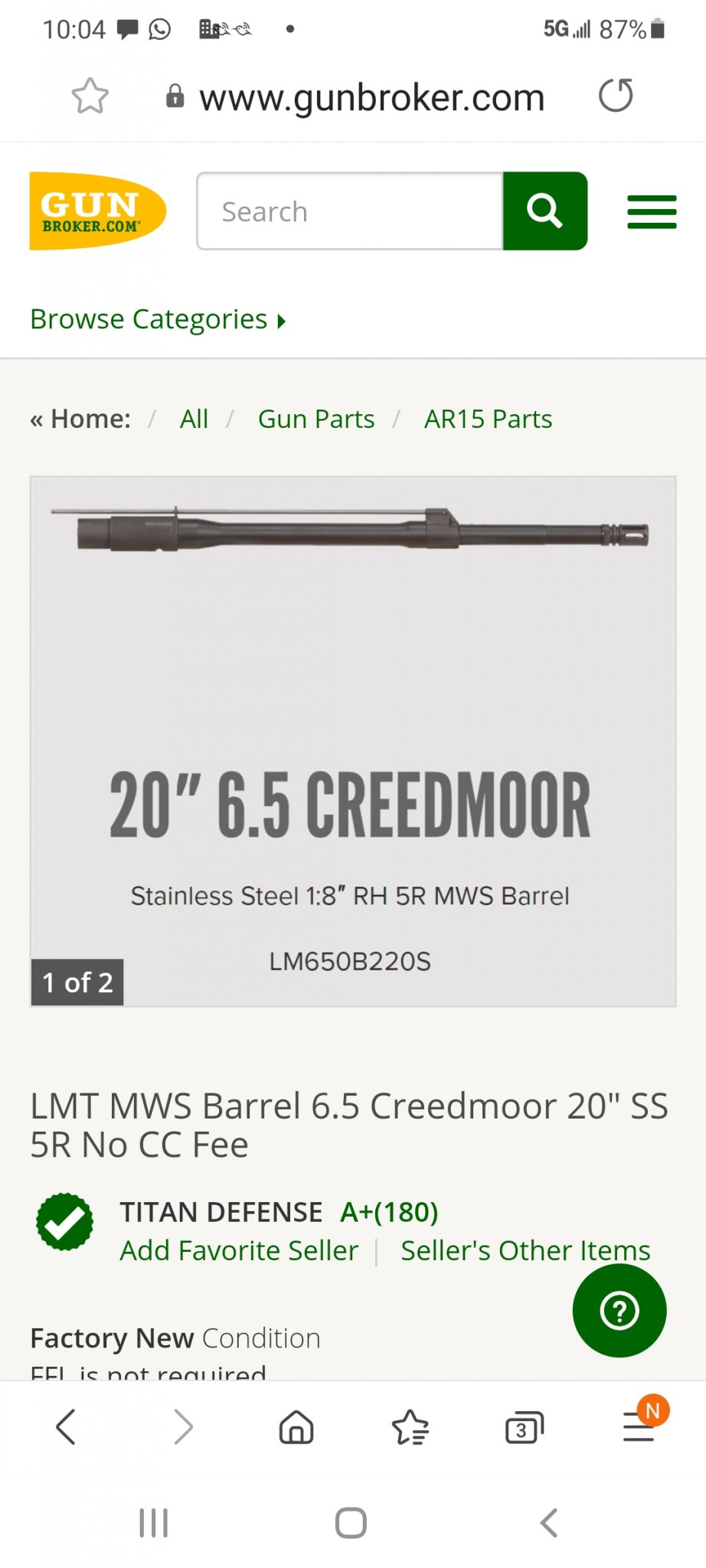

did you get the 6.5 20" from V1? Saw they were selling a bunch of them way above retail on gunbroker few weeks back.
Titan has been making good profit not putting his items in his online store and only in gb. Atleast as far as I've seen, makes sense though.
Reactions: Junkman768
I've talked to Russell at Titan a few times after seeing some items on GB. Asked if he had extras for sale at the Titan site price. It only panned out once but his suggestion was to pre-order whatever I wanted. They fill pre-orders before listing on GB.

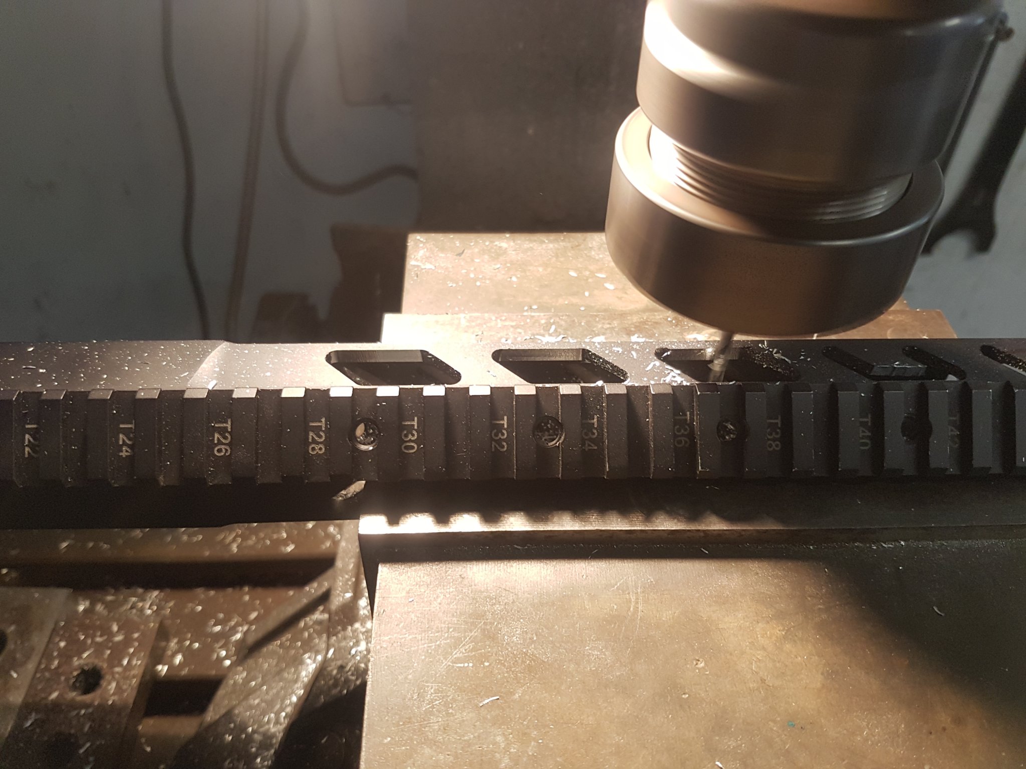

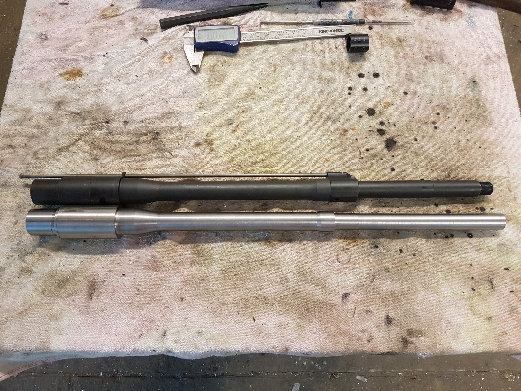

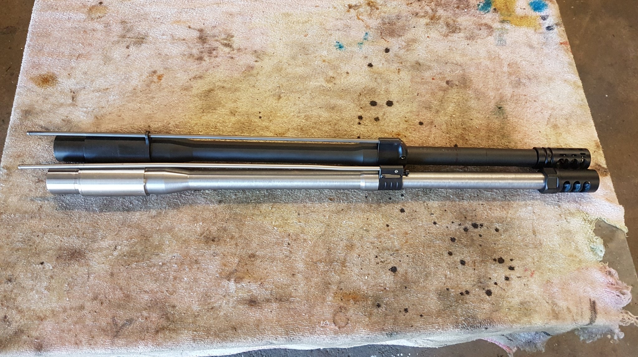

Been busy spinning up Bartlein blanks into MWS barrels. Keep in mind some of these barrels weren't designed to be used in this rifle as can be seen with different colored cerakote. Ill attached some pictures showing a couple 14.5" .308 pin/weld jobs with mid length gas, 16" .308's with rifle length gas, 18" 6.5 creedmoor (FDE cerakote), and 20" 6.5 creedmoor. They are all shooters. There is also a 33" .308 picture I took as a joke once I cut the chamber before chopping, contouring and threading the rest of the barrel. Thought you guys might like to see what a Bartlein on an MWS can do.

View attachment 7561856View attachment 7561857View attachment 7561858View attachment 7561859View attachment 7561860View attachment 7561861View attachment 7561862View attachment 7561863View attachment 7561864View attachment 7561865View attachment 7561866View attachment 7561867View attachment 7561868
Will you do then for MRPs too?

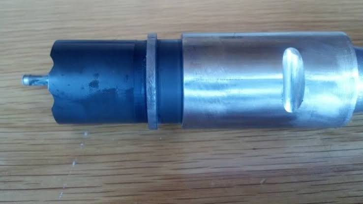

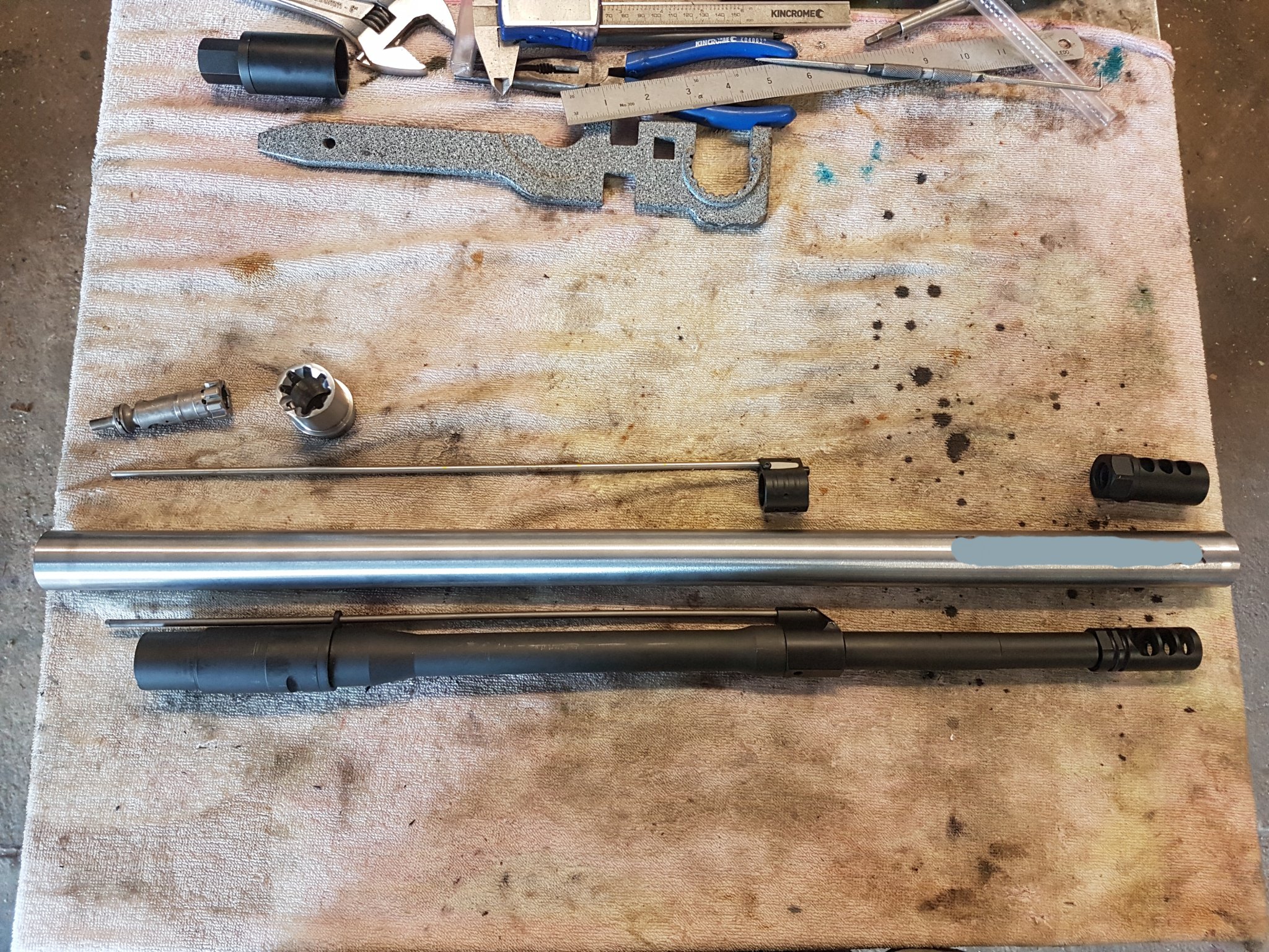

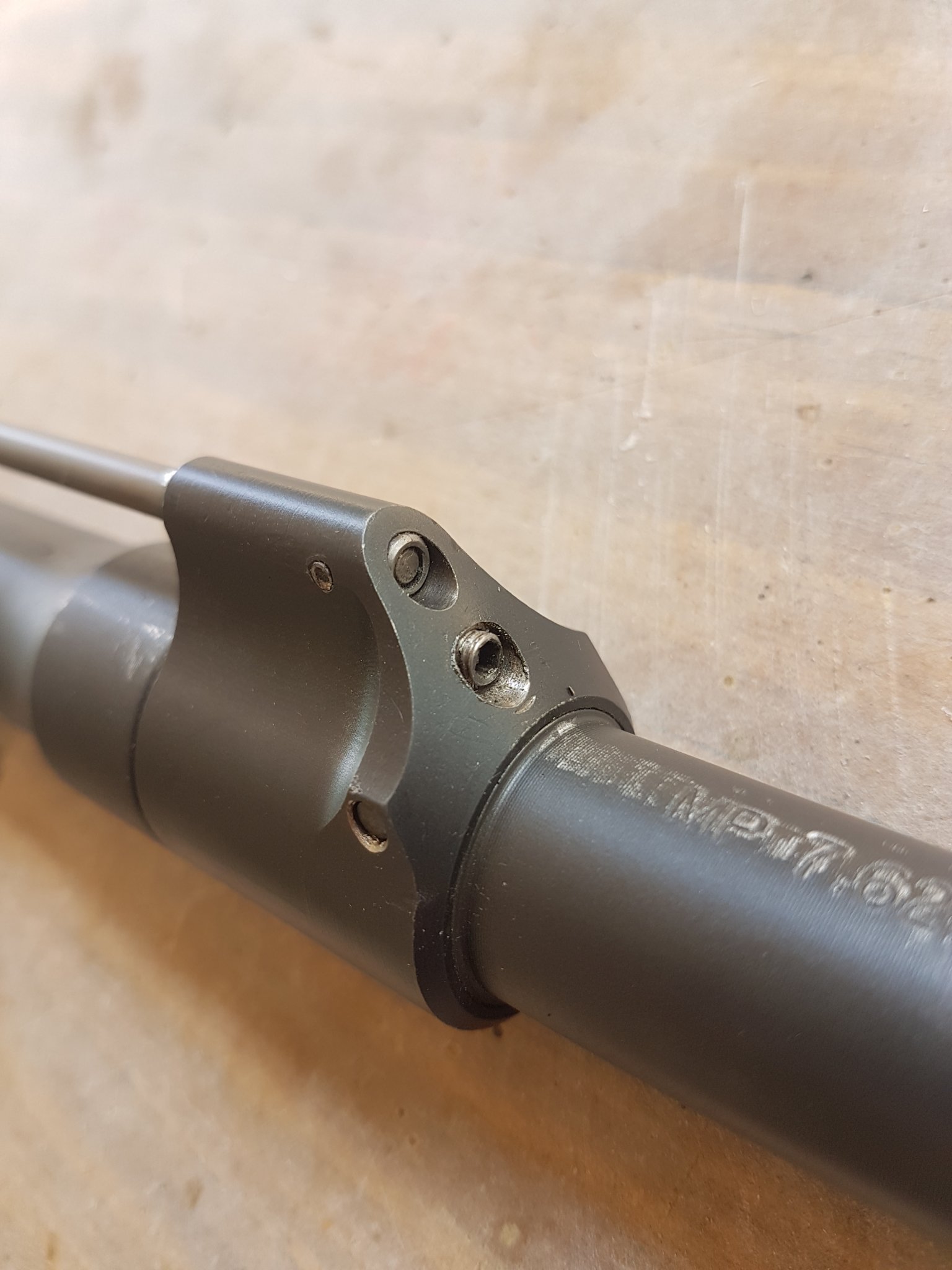

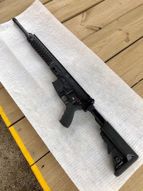

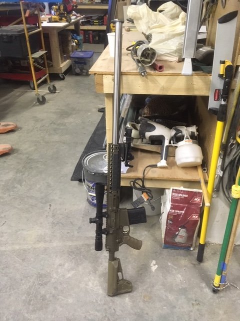

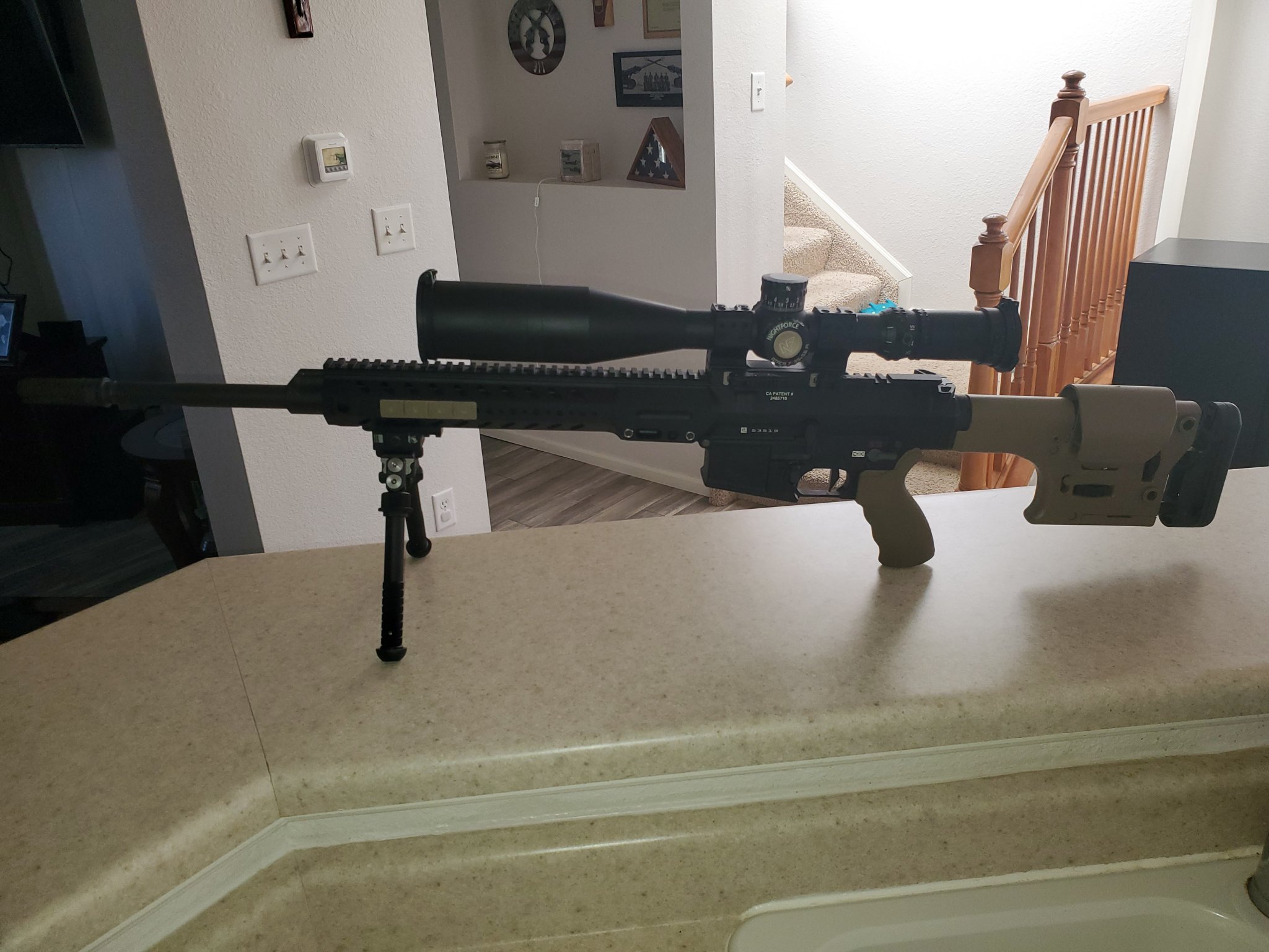

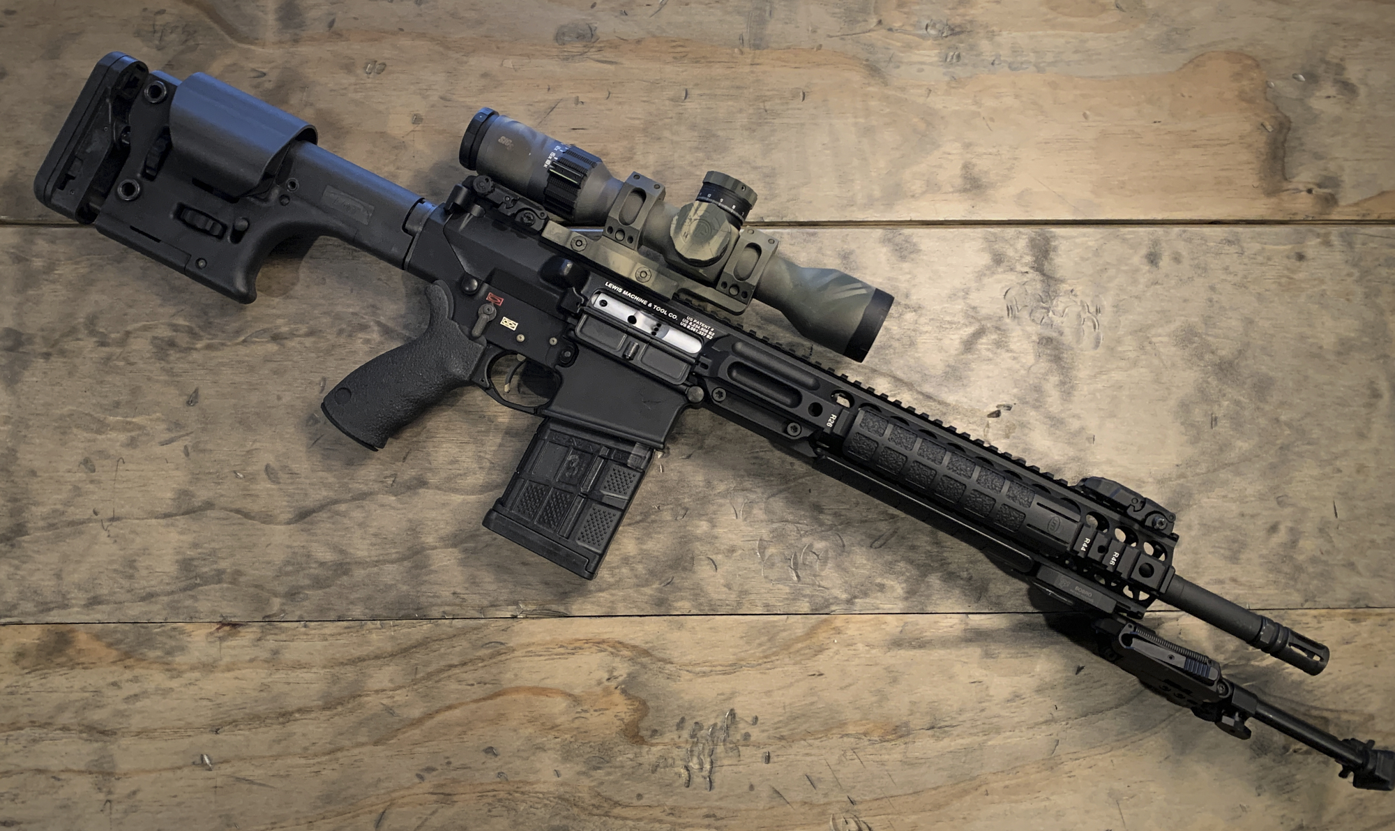

Here's my LMT MWS 308 i purchased last year in original factory configuration
To address over gassing I drilled and tapped the gas block.
Not impressed with the 'Slick' forend and seeing heat wafting out the front of the forend i opened it up.
I purchased a 26" 6.5mm 1.250" parallel blank, a BAT machine receiver extension, SLR adjustable gas block and spun it up a 6.5CM barrel.
Chambered, BAT extention fitted, semi-profiled at 20" and press fit collar fitted.
Profiling completed, gas port drilled, muzzle threaded and ready for Cerakoting.
While i was at it i Cerakoted the entire rifle and fitted it with a NF 4-16x42 ATACR.
Now for the important question; How does it shoot?...
Its shooting 3/4MOA with Hornady 140g American Gunner. I'm happy with the restults and it should perform better with reloads.

Really cool to see that people are machining their own extensions for these rifles... And the results are extremely impressive!

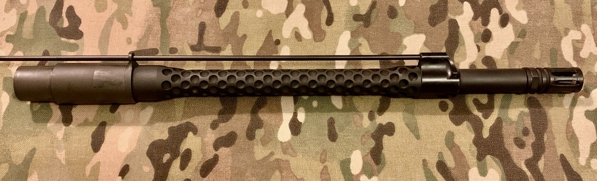

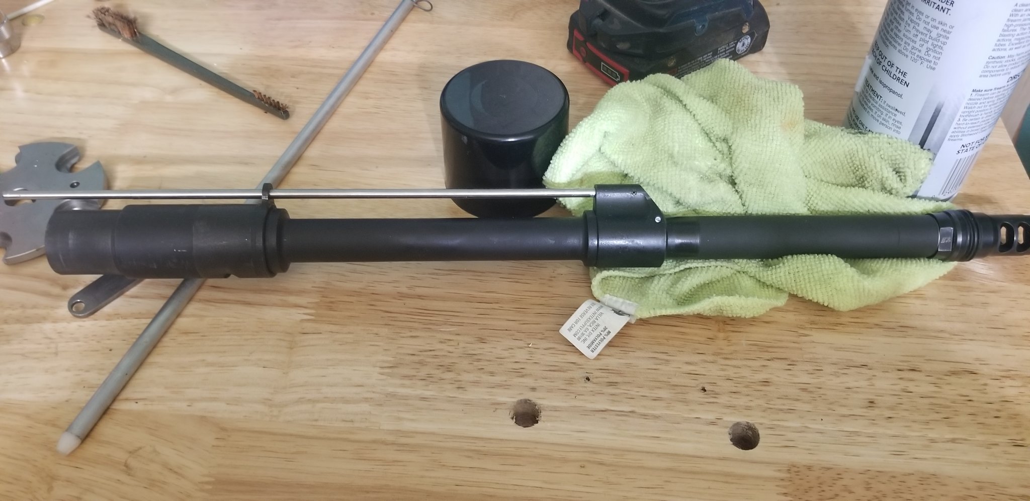

Has anyone re-profiled a 16" 308 barrel to save weight? I'm wondering how much weight can be taken off. I have a 20" 6.5 creedmore barrel, so for me, I'd like to make a 16" 308 configuration as light as possible.
I’d rather dimple the barrel than re profile. Marvin Pitts at Nefarious Arms performs this service.
Thorbeast,
I had my barrel to be the same thickness through out the barrel length. Only regret I have, was not weighing it before I turned it down.
Although I will agree above that dimpling the barrel looks pretty slick 🤙

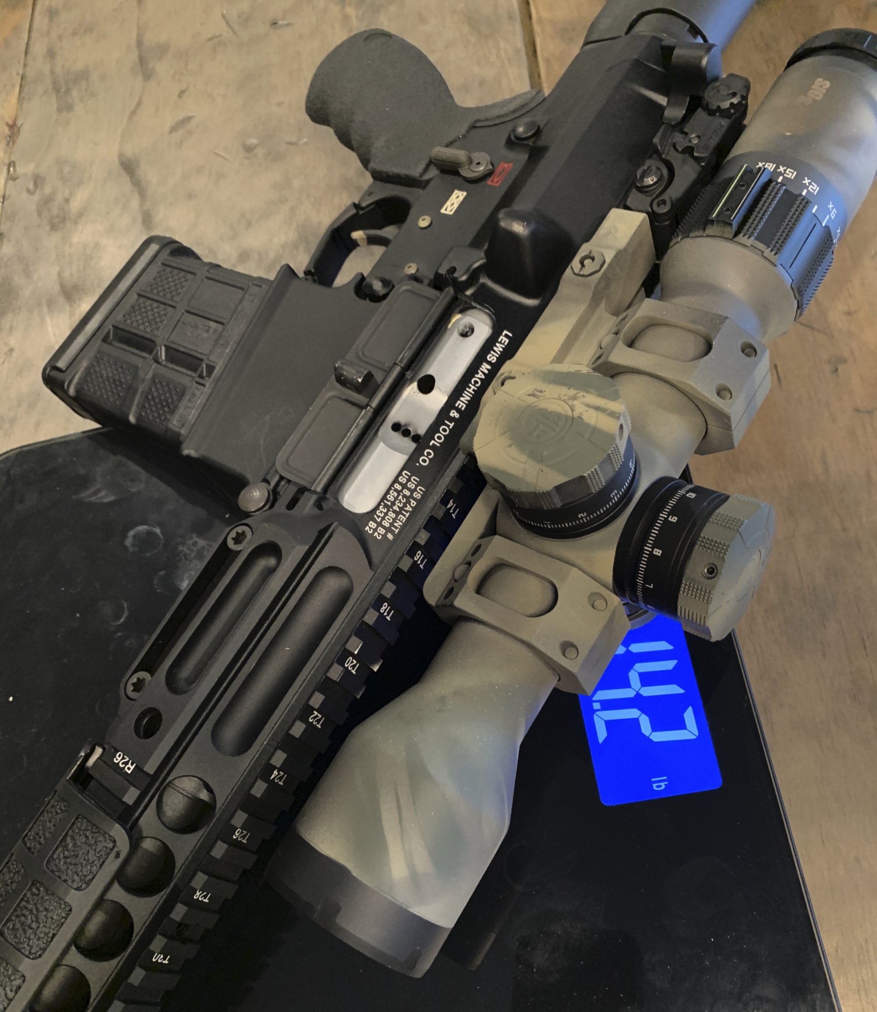

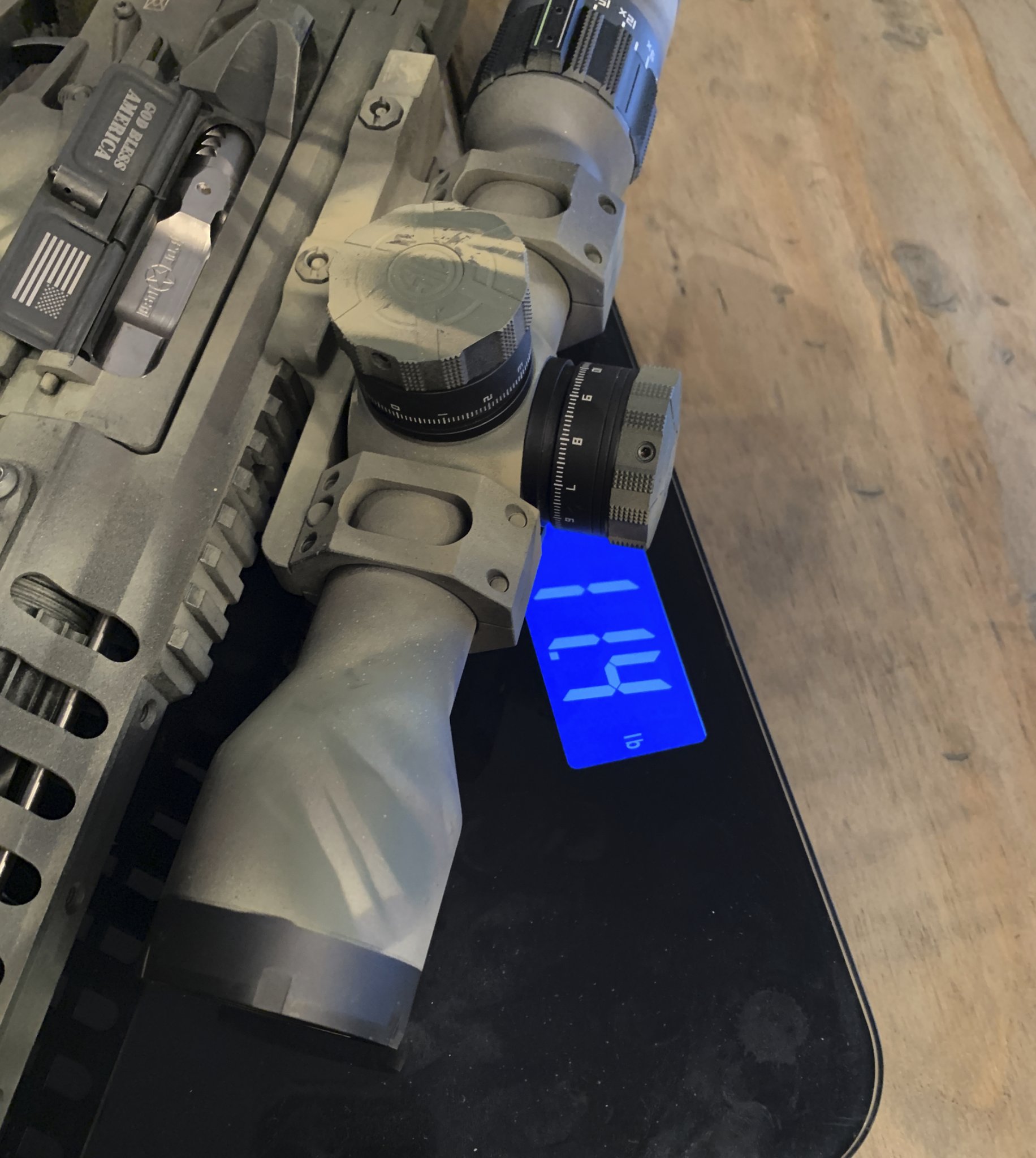

My 16" factory LW barrel weights 1284 grams (2lbs 13.3 oz) including the VG6 gamma.
Originally I was hoping to take 8oz off... but I don't see how that's possible with the huge barrel extension. I'm thinking 5oz might be more realistic.

Looks like you only had the barrel taken down before the gas block? I was thinking about getting mine re-profiled after the gas block.
Thorbeast,
Yeah I only turned it down behind the gas block as I didn't really see the weight savings from gas block to muzzle. I don't believe it would be worth turning your factory barrel man. But that's my two cents 🤙

Got a 6.5 blank coming next week to play around with converting over to the MWS extension profile. Anybody else do one themselves and have any tips? Trying to decide on a gas system length too, looking at 18” with a suppressor most of the time. Think a rifle length would work out?
