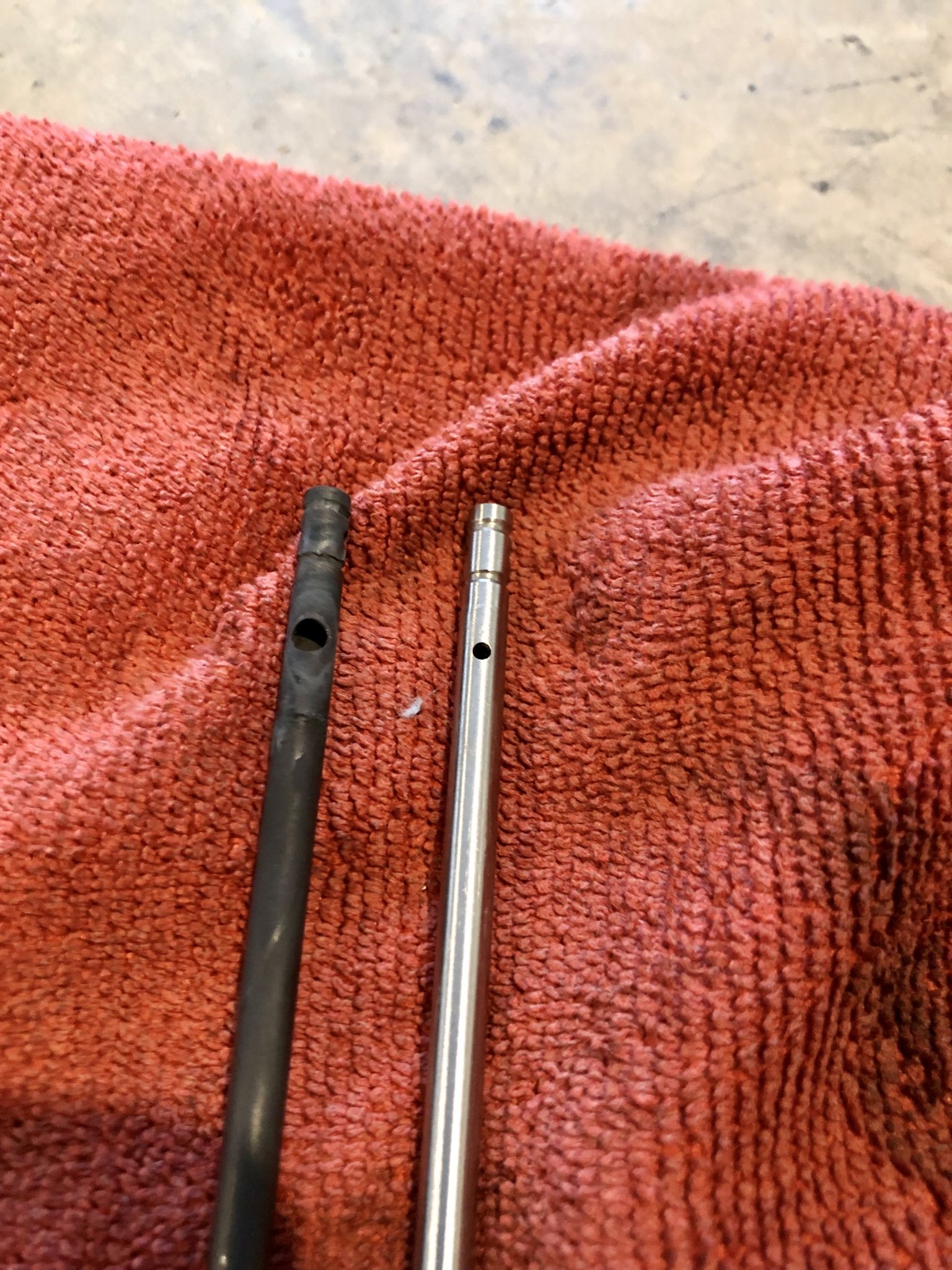

Black River Tactical EZTune gas tube for the LMT vs factory LMT gas tube.

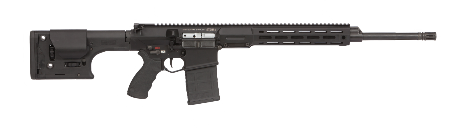

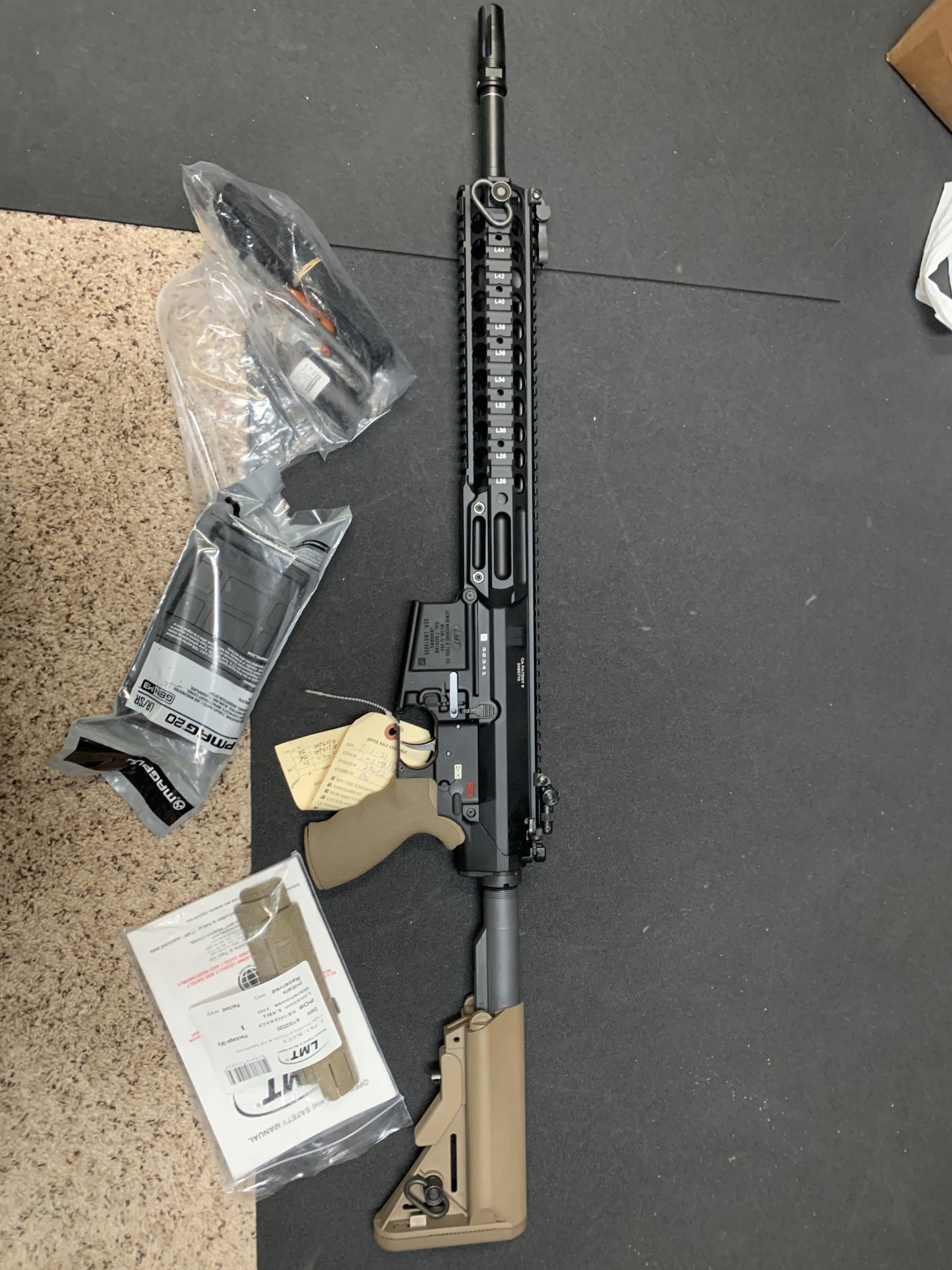

Lol that was mine I sold. That’s the 12.5” Handguard. I am looking for the longer 15.5” upper reciever.
Hilarious! I was at work and on a break when I read your post. It didnt even register that you said 15.5" when I read it. Secondly I didn't even know 15.5" MWS uppers existed.
Well I guess I learned something in the process of trying to help you find your own listing 🤣🤣🤣. ^^^Inserts foot in mouth^^^

They function flawlessly and will cycle absolutely anything due to the monster of a diameter gas tube hole, which causes them to be grossly overgassed.
Your BGC, ammo, and mags will be absolutely caked with blow back when using it factory configured.
I have switched to the BRT EZTune gas tube, as seen below on the right, and hope this helps. I have yet to use it in the current configuration. This is my last ditch attempt before rebarreling and going with an AGB.

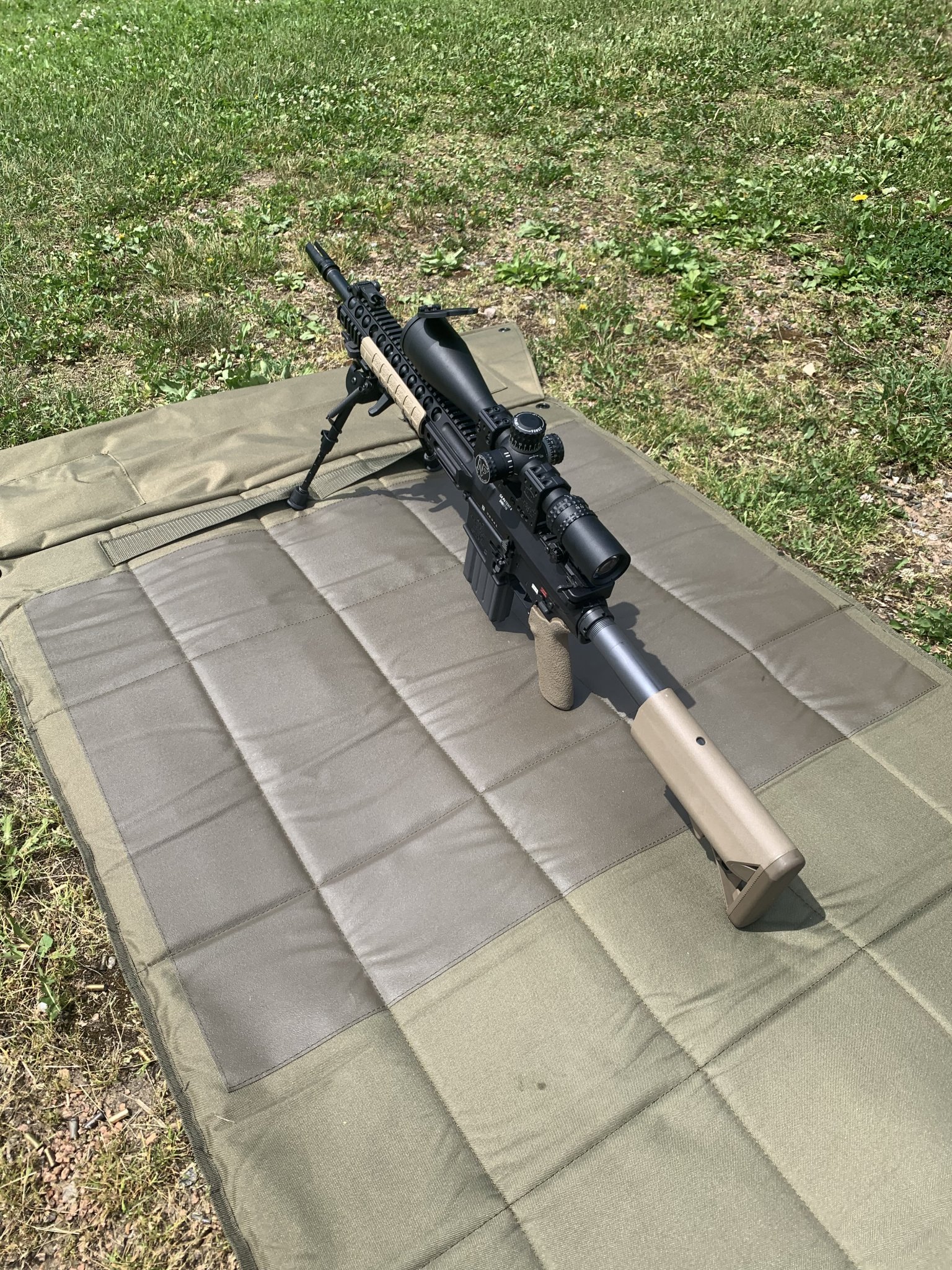

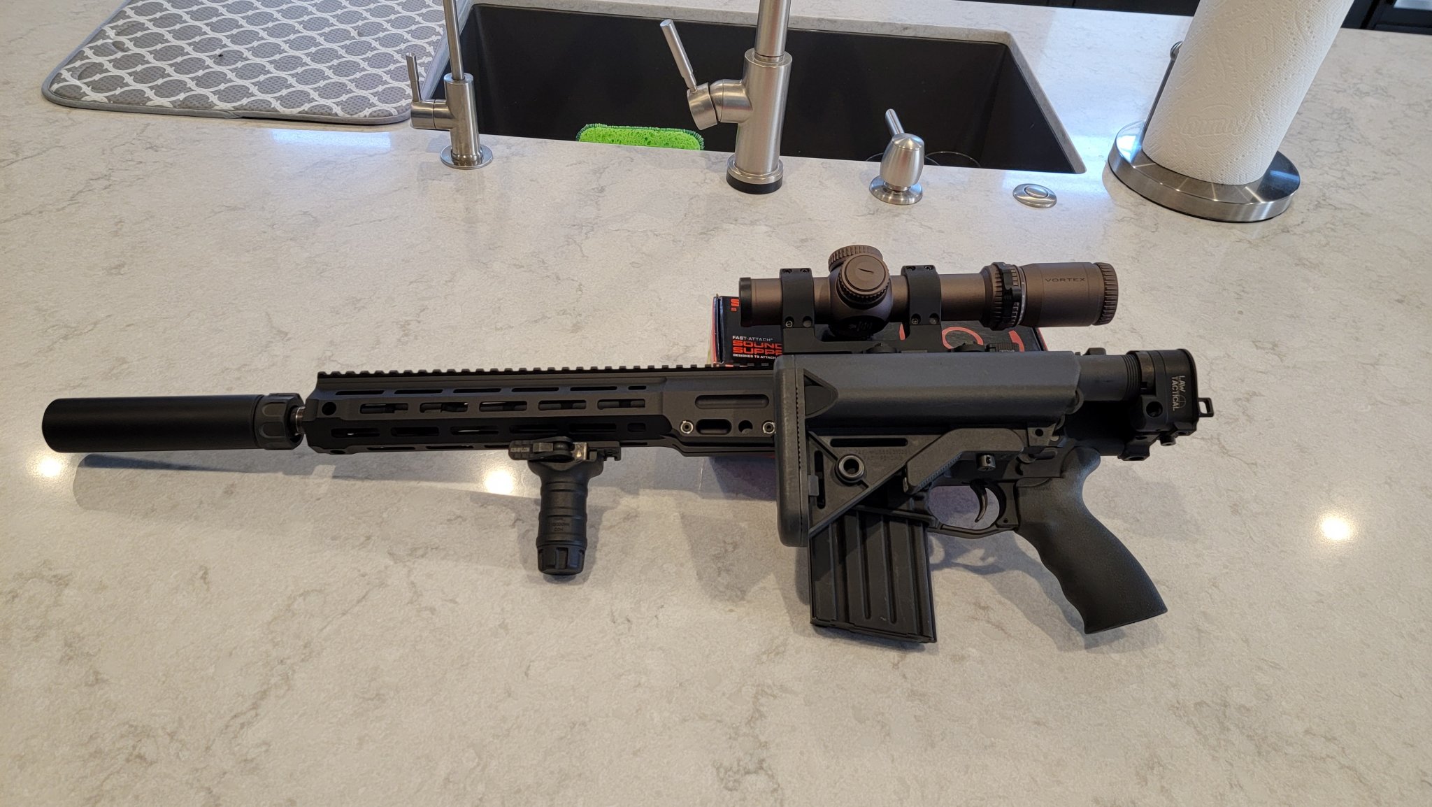

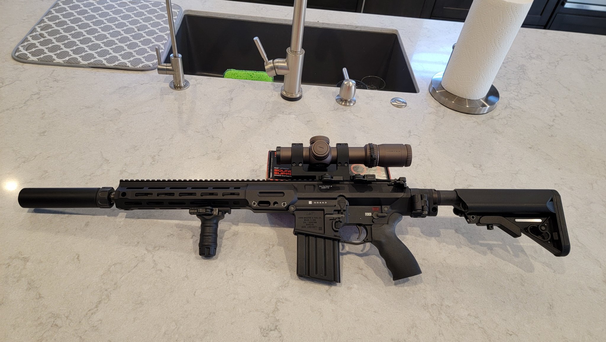

Got my 13" barreled LMT .308 finished. Law folder, Surefire Socom 7.62 mini can, and Razor 1-10 Mrad scope. I was hoping it would be lighter, but still came in almost 12lbs fully loaded. Will get it out as soon as they lift the stage 2 fire closures here in Az.

Upper receiver didn’t show up until last night, so I haven’t tested it out yet. Unless I can track down a 15.5” receiver, this is the finished product. Might add an offset red dot but that would be about it.
I looked at the 15.5 upper as well. Shitty thing is, it won’t work with a 16” barrel and can. Your choices would be to cut the rail back or get a longer barrel :cautious:(n):cautious:(n)
Sounds like LMT is making some changes to the 15 rail design though. One can hope…

Is that with the standard barrel or the lw contour? I can't help but think that mini is going to be LOUD on there. Mine is on 10.5 5.56 and 300blk

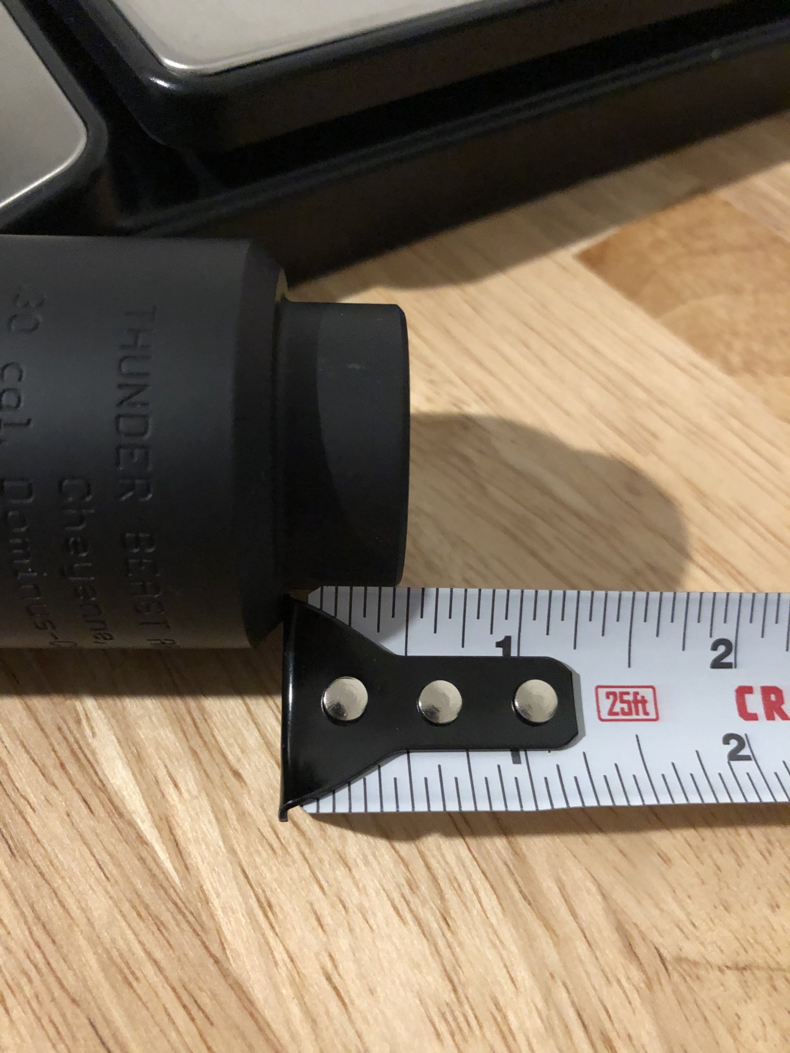

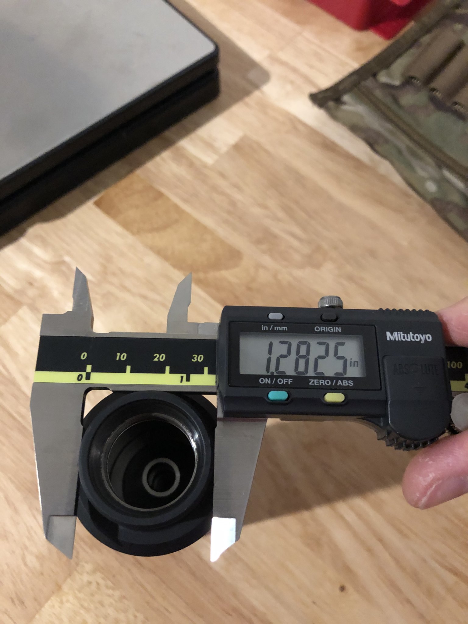

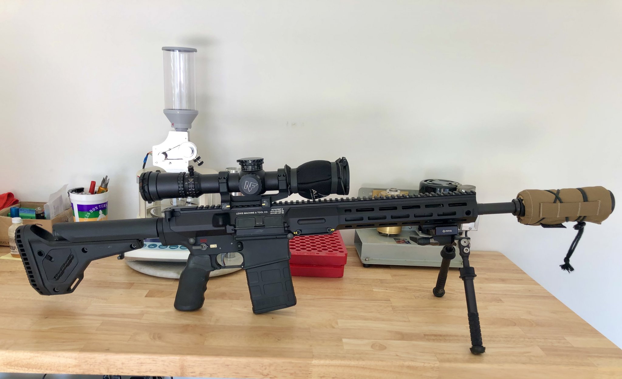

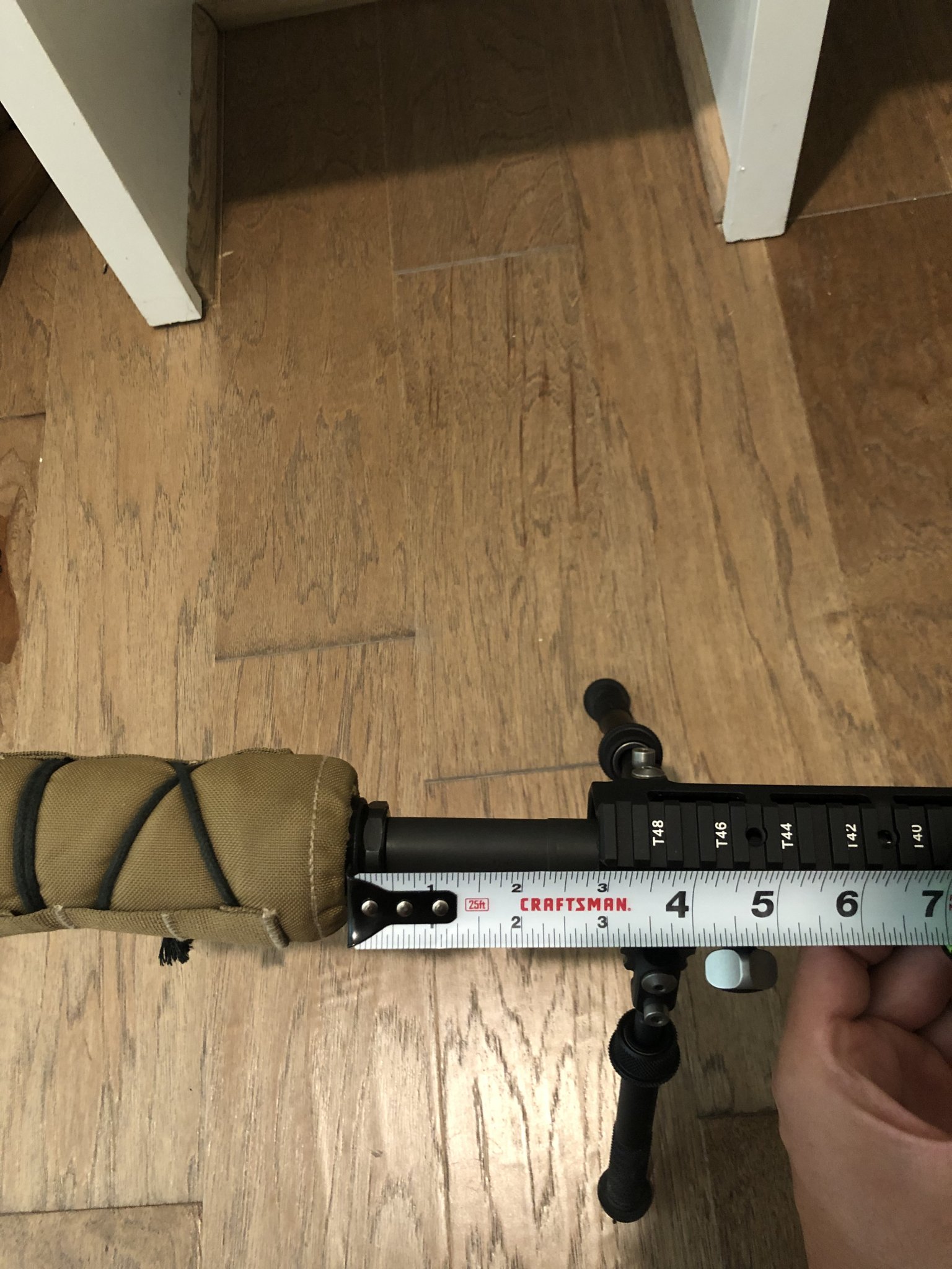

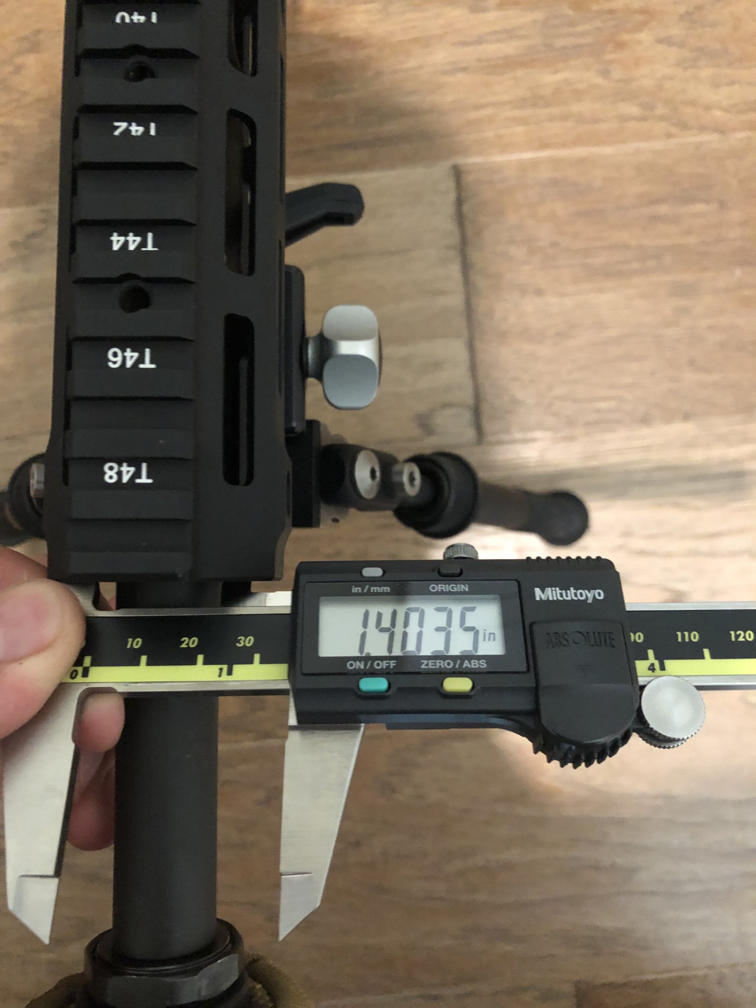

@mrtoyz 15.5” rail and a 16” barrel will work for me with the Dominus. I have 1/4” to spare it looks like.
Interesting there have been a few people have tried this and it didn’t work. In fact when I contacted LMT, they said they knew it don’t work and that that a slightly shorter hand yard was one of the changes to the design they were planning.
It looks like you have a brake there that allows for the extra 1/4”
It’s not a brake, but the design of the Dominus. The Area 419 adapter also gives me some wiggle room, ~1/8”.

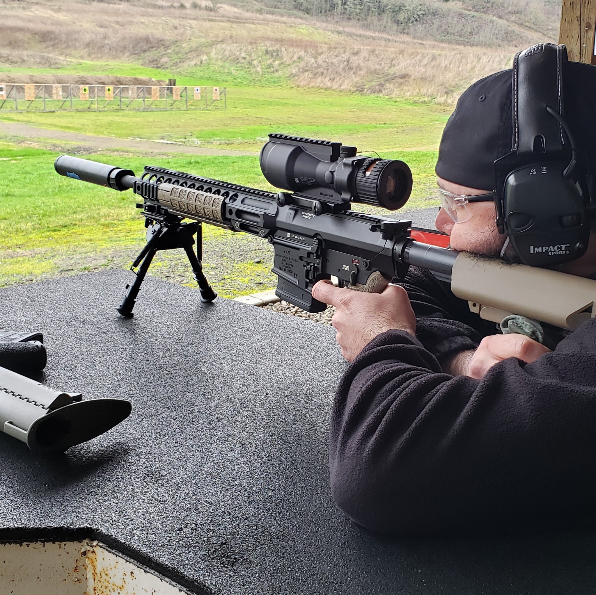

I don't think any suppressed 13." .308 would be hearing safe, but the can should cut down on the muzzle blast and drop it 25 db's. I'll have to check on the barrel as far as contour. I usually wear ear pro when I shoot suppressed rifles. My .300 blackout with subs and my .22's with subs would be the exception.
My Sandman Cuts down the blast significantly at my ear. Experimented with foam earplugs all the way in, halfway in, and out for one shot, and While I definitely would not recommend sustained fire with out hearing protection, If one need to take a single shot say for hunting or to dispatch an injured animal I think it would be ok. If I was going to go out to the range or mountains and shoot for a few hours, I would absolutely wear plugs or ear muffs
The two port brake alone is pretty bad with a loose earplug, would not considering taking any shot with that thing with no protection on.
Very nice set up,
Just remember that the MWS is modular and just because its currently 12lbs, does not mean that it can't shed 3 pounds pretty quick depending on where your doing.
Pull the can, swap out the LPVO for a T1/Eotech, and Sopmod for CTR and that thing is going to rip as a heavy carbine. Maybe depending on what barrel you are running, you could probably knock off a pound going to the the lightweight barrel and losing the Law folder.
If you are going to do more accuracy type stuff, or something that may ride around in a vehicle most of the time, I see no issues with 12lbs.
MWS's are fun and spare parts tend to grow into complete second rifles.
