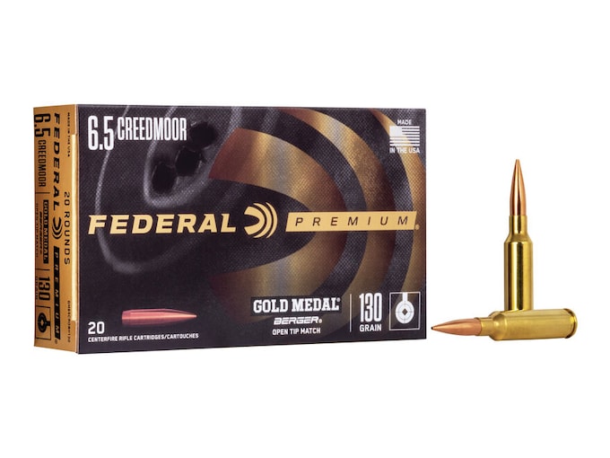

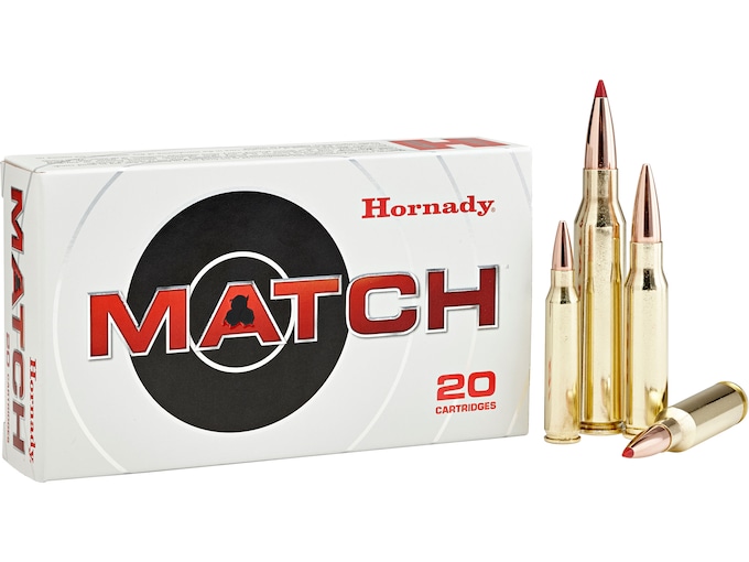

Top 30 in what discipline? Some disciplines do not require super precise/accurate performance to do well. The quality of barrels and bullets help some of those factory loads perform very well. I had a Savage in 6.5cm that consistently shot .5 with factory loads, plenty enough for some disciplines.
Reactions: ironpony52
PRS NRL
Hornady ELDM 140 & 147
